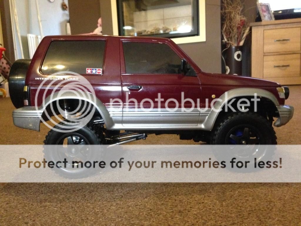

So I set about the forums looking for a Pajero 2nd hand as I figured that would be a good base to start from.
A week later and this is parked on my desk -
Notice the hella-rake body fitment!

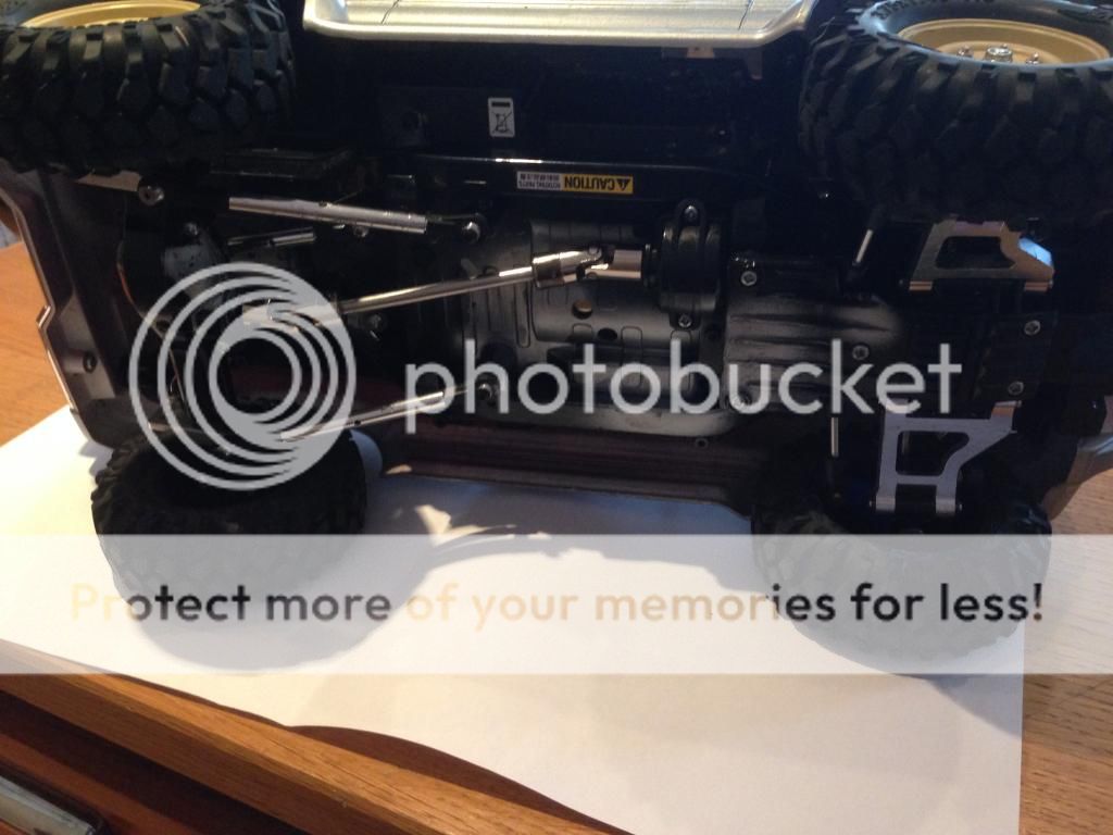

It came with some GPM 'upgrades' but I'm not keen on one of them in-particular, that being the 4-link rear setup -
I'm not keen since it doesn't seem to offer much articulation? There's also a mish-mash of different hardware/screws on there too which is a pet hate of mine, so they're slowly all getting replaced with stainless hex-head jobbies.

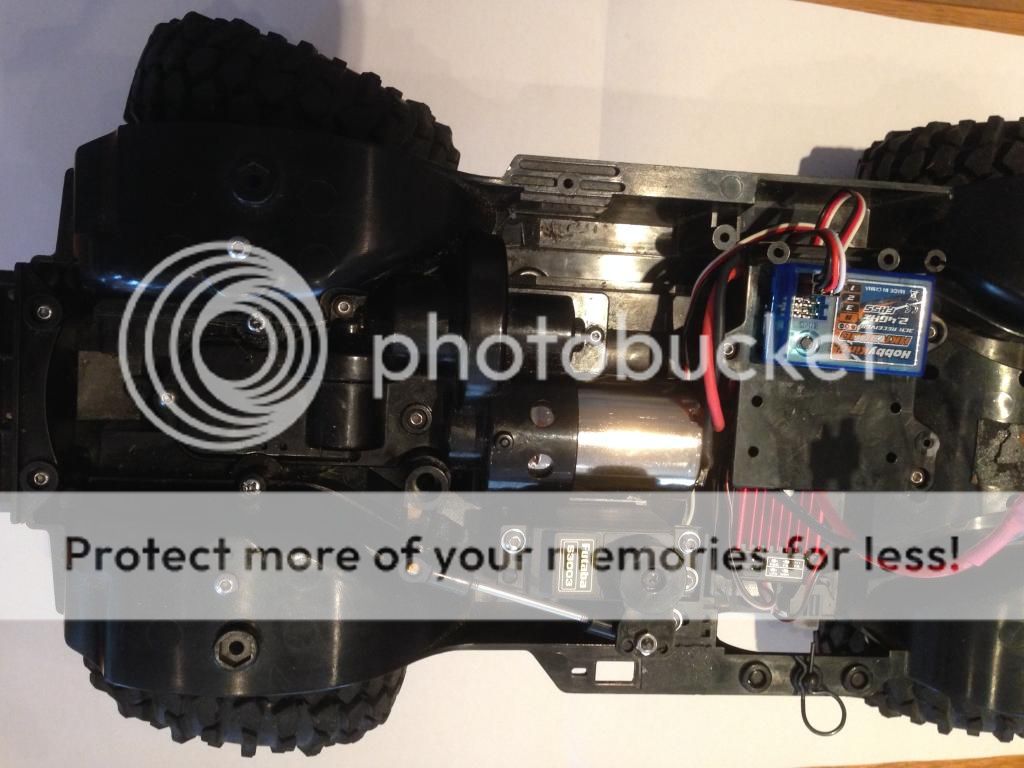

I've also put on some Tamiya 54541 Aluminium oil shocks which have a silky-smooth operation, using the stock springs. Running Lipo this setup still seems a little stiff though, can anyone recommend some softer springs? Perhaps when the body mods are complete the added weight will make some difference.
Next up was the electronics.
I don't want super-fast steering and a metal-geared servo seemed like overkill too, so I've just gone with a nice Futaba S3003 servo for now. Motor is standard silver can for now, but even with the 16T pinion it's way too fast! Not sure 35T will be slow enough, so looking into other solutions right now. I've installed the ESC in the battery tray as Lipo cases don't fit in the slot properly anyway. The ESC is a Hobbywing 1060 waterproof item, hopefully this will be a good test for it as it was incredibly cheap for the quality you get. Finally a Hobbyking receiver sits on the radio tray.
Batteries will sit longidtudinally and held down with a strap.

Can't decide on wheels either, have the following 5-spoke options:
Or
Leaning towards the second option as they also afford me a bit more offset which looks better. Either way they'll be painted green like the body.

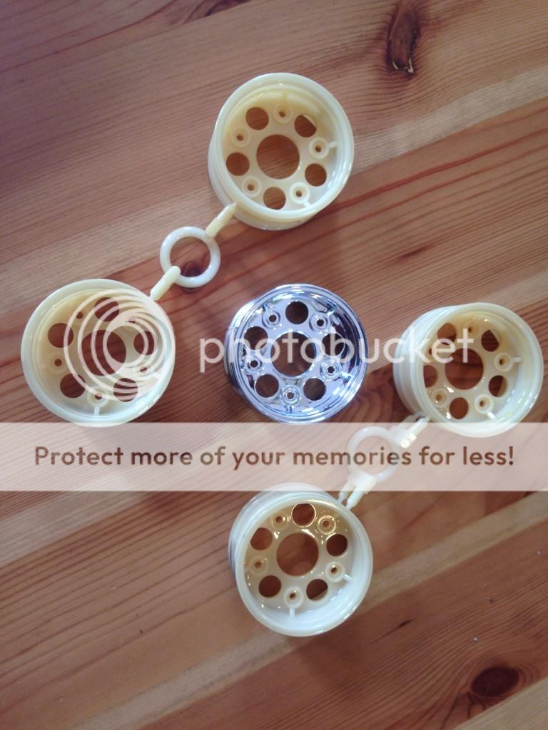

If I go for the second option am I right in thinking that a quick go in the dishwasher will take the chrome finish off?

On the wheels, I too prefer the second ones, they suit the Pajero body much better IMO
I think the second option for wheels looks more like those in the photo of the Pajero mentioned in the first post. As an opinion, I am inclined more towards those.

Stuck the split rims in the dishwasher to strip the chrome off, worked like a charm...sort of...
...on all but one rim! Totally unaffected by the dishwasher (apart from being extra clean now!). What do we reckon then, different playing process maybe?

Mr Muscle oven cleaner in the grey aerosol with an orange lid will remove the chrome. Just pop it in a sealable sandwich bag, give it a quick squirt and seal the bag for 15 mins then rinse with water.

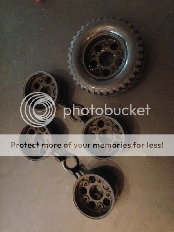

I also started painting the wheels.

Wheels are black, will get a coat of green next but didn't want the green behind the spokes (if that makes sense?!)
I like these tyres, but they're really hard. As such they don't offer up much grip (I was testing the Pajero the other day on the laminate floor. It drifts really well!)
