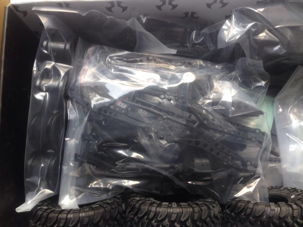

Well the box is a bit bigger than I thought it would be (on par with a Hotshot one) and the bundled parts bags are tough polythene. No plastic smell as such but most parts seem to be tough reinforced plastics.
