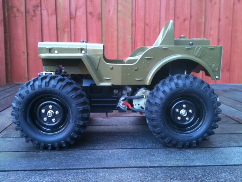

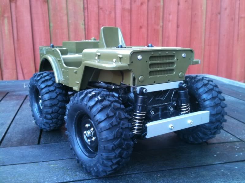

Here's my WW2 low rider, still a work in progress.
Here's the adjustable ally suspension. You can just make out the top arms
I share Nodtec's concern about the hight of the body over the WR-02 chassis - unless you are able to cut away some of the interior (which is a shame)... although I can see where' you're going if you've dropped the chassis on the suspension, as the effect will be the wheels are closer to the shell now anyway...

I'm thinking you'd be better off fitting the body onto another chassis, perhaps an M chassis? I shorted a TL01 to fit a WW2 body, I wasn't trying to go for a low rider look I just wanted a little more scale look and 4x4 (this was long before the GF01).
703B4012-1800-43CB-B413-6325B1F9F2F8-235
7611D3E4-BA0A-4267-B883-3F35312545D8-235
2D3F90F8-DAE8-45DB-96B5-2FD1A8B96F30-235
Think you did a great job with this Jeep. Have you finished it? Is there a specific tread for it to be seen?
ok follow my thinking here . if you can fit a Pumpkin onto a M chassis then surely its not that hard to do the same with a Willy ?????????
(mongoose1983 wrote
Think you did a great job with this Jeep. Have you finished it? Is there a specific tread for it to be seen?)
Not done a build thread but I will pull some photos together and do one when I get around to finishing it. I was about to do that but the Winter Build-off got in the way :)
This chassis was last seen under this :D
