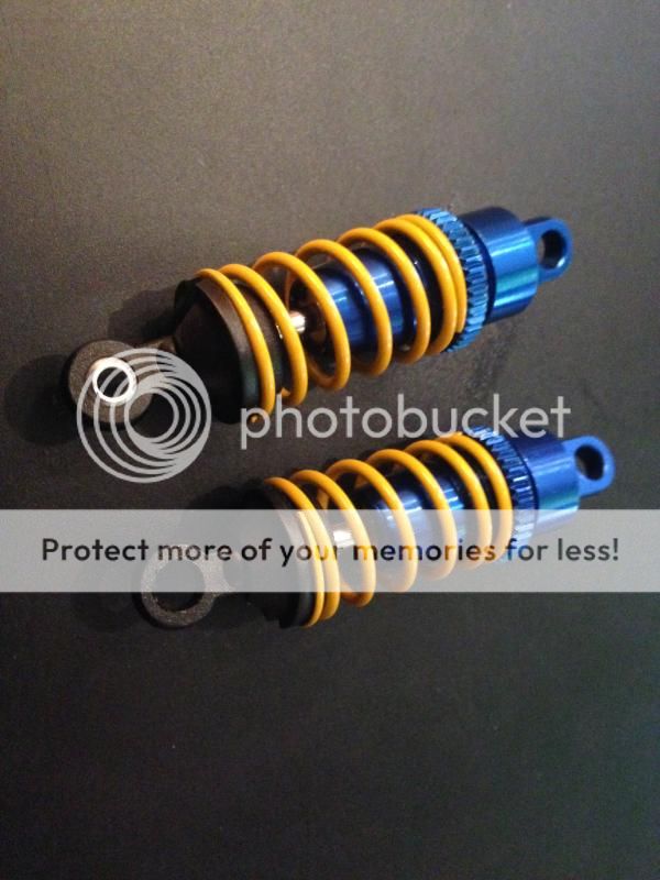

I have a nice shiny set of Ansmann Racing adjustable aluminium shock absorbers which I have re-sealed with tamiya parts (oil went everywhere on original seals) and had intended to install on my FF02.
I've had to change the bottom ball joint connector to get the correct shock length, but the top eyelet is too big for my Tamiya 5mm ball connectors.
Does anyone know what size these are?
I've taken a measuring caliper to it and it's quite awkward to measure, but the inside eyelet size appears to be 4.7 / 4.8mm?
Tamiya 5mm ball connectors are nowhere near 5mm across - I'm guessing the actual ball diameter is closer to 3mm?
Standard ball connectors are supposed to be 5mm. I've just measured a used one, and its 4.6mm. If you are measuring one at 3mm something is not right. 3mm is the width of the screw thread.
If you are measuring the opening of the hole at the top of the shock, remember you are measuring at it's smallest point, and that it will open up slightly in the middle to fit a ball connector.
You will probably find that its 6mm fitting. My 3-Racing shocks for my M05 used a 6mm ball at the top, but a 5mm ball at the bottom.
I think I recall the same 3Racing shocks on my M-03, I replaced the ball ends on those too for the same reason!
I'll have to do a re-measure.
If anyone else has these shocks and has successfully fitted them on ball connectors I would be very grateful for the info!
