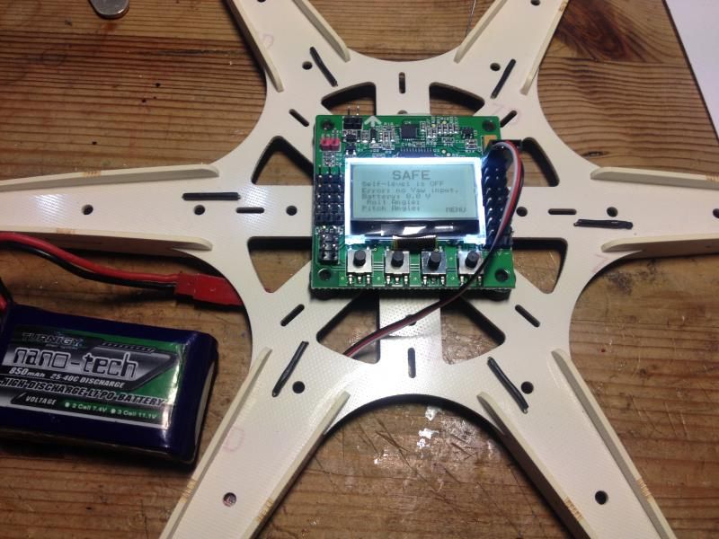

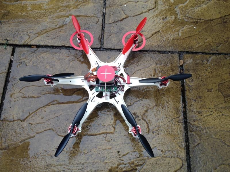

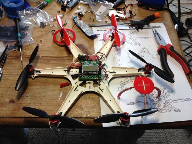

So I have had a little fly.

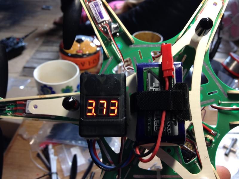

On 2 cells it was sluggish and the battery could not deal the required current peaks
On 3 cell its a different beast..
More testing to do and LED to fit but I have had a few beers now and flying is not recommended lol
Took it out for a flight in the park... Upped the gain a little and turned on auto lvl... Used an 800ma 3 cell pack
It was awesome... Nice and smooth and I got 5 mins flight time with spare capacity
Need the LEDs to be fitted as orientation was a bit difficult
