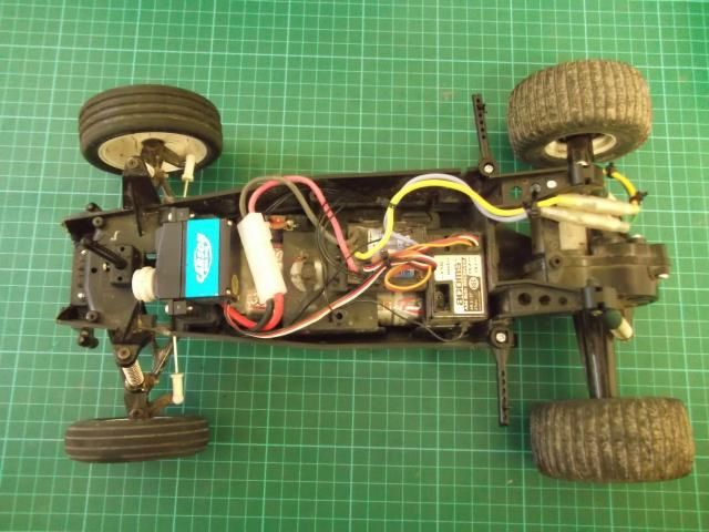

To begin with then I started with a slightly damaged Grasshopper, only a broken wheel and spotlight so nothing serious.

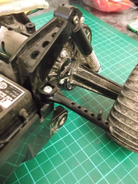

I'm a bit stumped trying to fit the rear engine cage but I'll get it on some how. Many more pics of the work so far will follow but I wanted to introduce the project first!

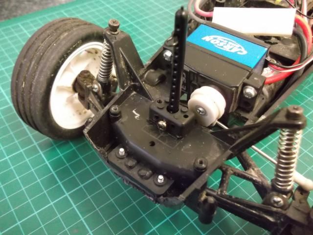

Here is the slightly modified chassis as its sits right now, you can see the missing front end and the body posts. The front needed to be cut so the wheels looked right in the arches, without trimming the front the body sat way too far forward and looked odd. As I said some tl-01 rear body posts were cut down for the rear and screwed into the Grasshopper body mount holes. They line up really well with the blitzer bodyshell's locating holes so that was handy! The front was also quite simple again using a cut down tl-01 rear body post and a mounting block from another project I had laying about. I need to sand down the ends to make them a little neater.

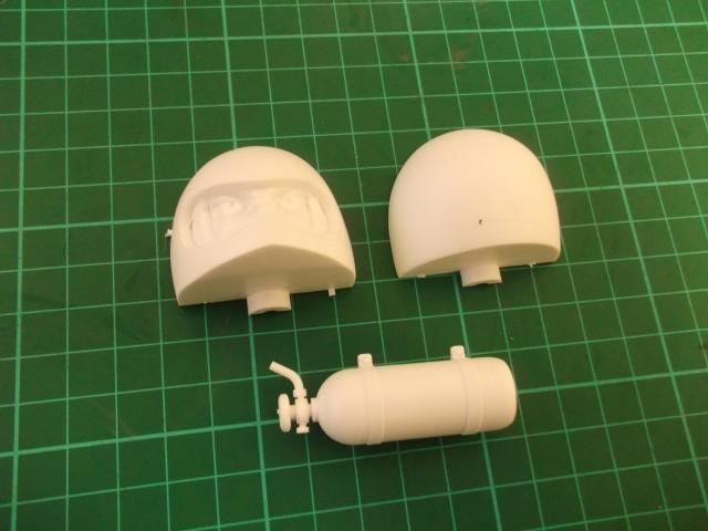

Interior wise I have started building a rollcage for it. I'll be using the original drivers body but Willy's head will replace the standard one and I really couldn't leave out a nitrous bottle!

While I let the paint dry I set about mounting the sand scorcher's rear cage to the grasshopper chassis. This has had me scatching my head since I started the project. My solution was to use parts from another hobby of mine, Lego!
I had to trim the cage a little but using some of Lego's Technic parts I came up with this-
10712856_10152481840691158_1313571051464
10702199_10152481842856158_2020865865799
It need's a little fettling but the fit is good on the car, the side arms sit very close to the rear shocks but they don't touch.
I'll be gluing and Q Bonding the cage tonight to make it nice and solid.

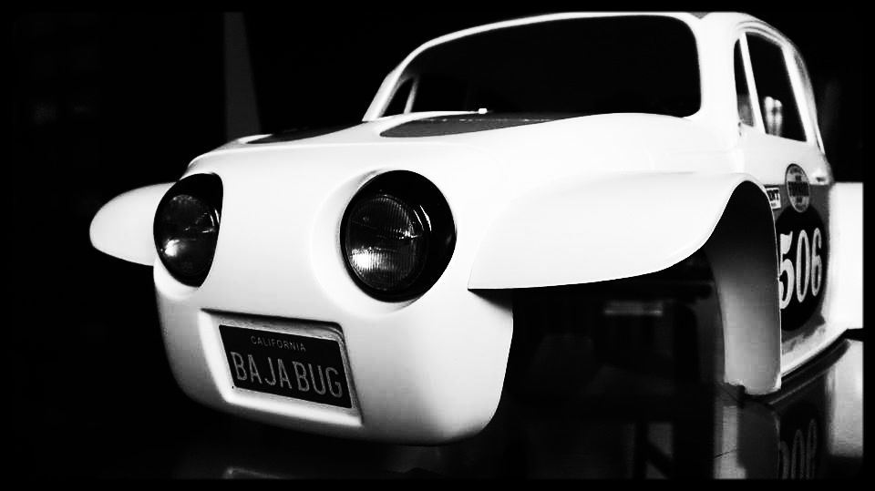

Ta da! Body is all done now, just have to fit the drivers head in place. I decided to use the monster beetle glass and headlights as they are darker than the regular sand scorcher stuff.
