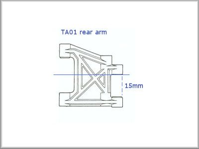

Looking at the manuals, I would think the gap to mount the rear arms is too wide. But if it's not a whole lot, you may be able to use spacers.
Another idea could be FF01 front arms and TA01 rear arms - it looks like the FF parts will make the wheelbase slightly longer.

It looks like indeed the TA02T uses flipped TA01 rear arms (that I did not realise).
Once again scouring the manuals, this seems to make a 15mm difference in wheelbase.
So compared to a TA01, the wheelbase will be 15mm longer but when put on a TA02 it will be 5mm shorter.
