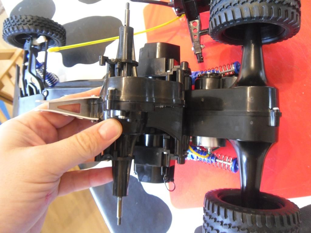

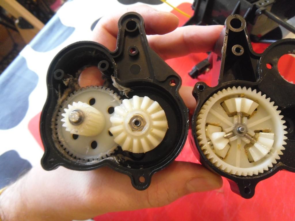

I thought it was about time I took a look at the diff and drive. I did not build this so I thought i best check it was all steel.
Looks like the back end from a DT-01 would fit
Gears look good, not much grease but I will solve this :)

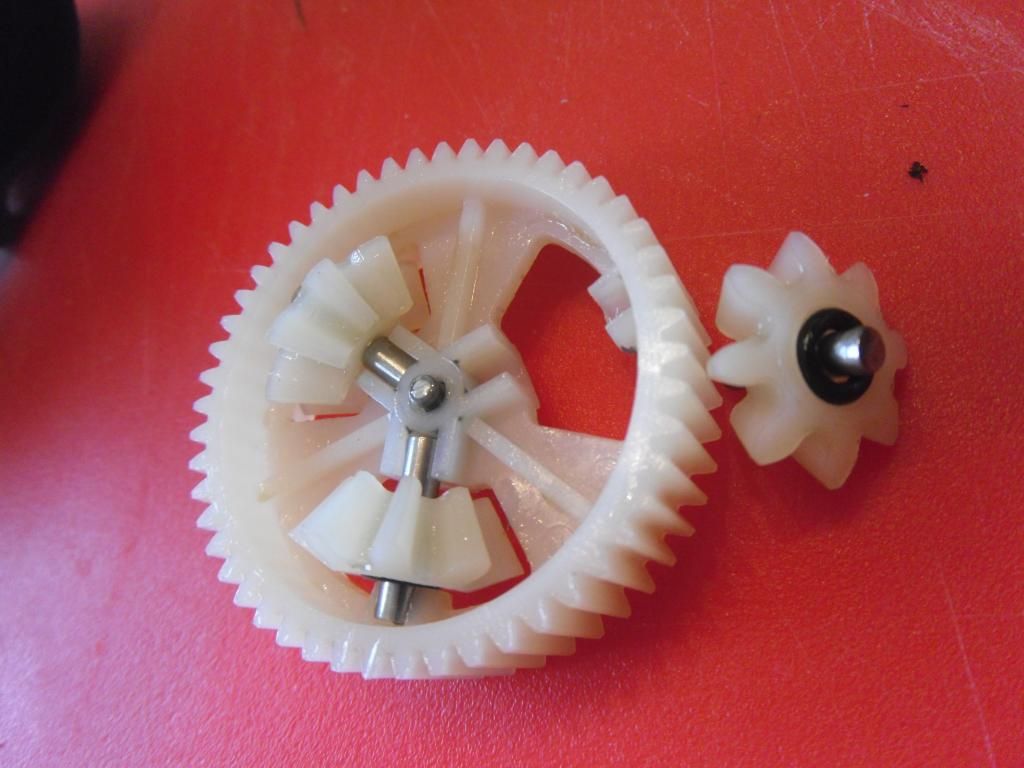

Reassembled with a O-ring on each pinion. Should give an amount of limited slip without total lock up
All back together and the axle seems to be good but we will not know to I get to back on the wet grass
From your photo, it would appear that the gearbox has been adequately greased. One doesn't want a large quantity of grease creating drag in the gearbox and weighing it down. As long as there is a thin layer on the mating surfaces of any moving parts, that is fine. Some racers don't use grease at all, instead opting for a dry lube or light oil.

The o rings on the diff worked perfectly day 1 and the rear had real traction on the wet grass. It wore off today though and went back to spinning one wheel and failing to put the power down. Will have to strip it and see what has happened.

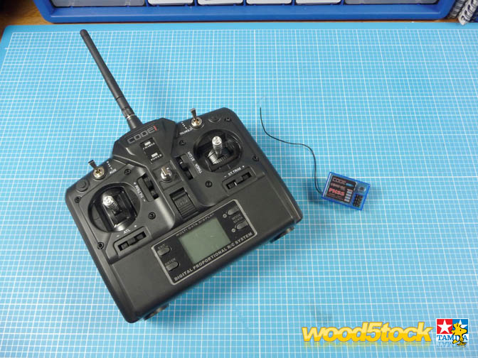

I realise that you have got them kinda used to the stick type of TX but what about a lightweight pistol type such as the ones that come with the RTR/XB kits. The one that came with my Lunchie only has four AA batteries
I thought about that but not sure if I can get my head around how you learn to use one. Sticks are very much self explanatory.
I feel the same, in fact one of the reasons I wanted the Lunchie XB that I got last Christmas was that I could see if I got on with the pistol grip without having to lay out for one. i'm glad I did as I still prefer the stick version. hence I did lay out on one of these :D
