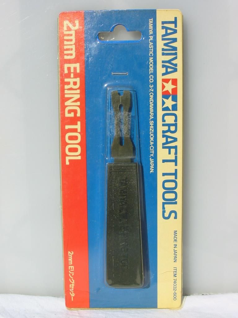

I'm a Tamiya tool addict and the E-Ring tool works really well for me. Both for picking up and putting on.
There's a version for 4mm E-Rings as well.
Yup, tool addict here too :lol:
I have both the 2mm and 4mm, and they are pretty much indispensable for building Tamiya products.
