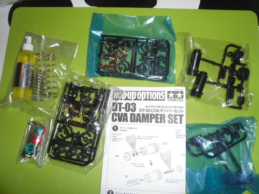

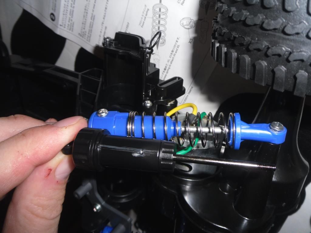

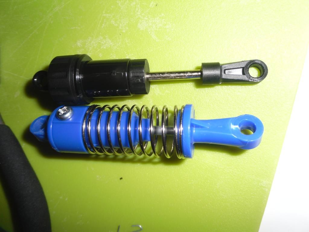

Well I ordered a cheap set of Tamiya shocks for this one. Two reasons, I am cheap and I fancied building some from parts

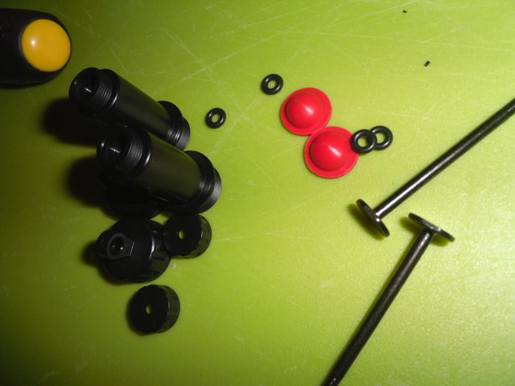

The parts a very easy to understand

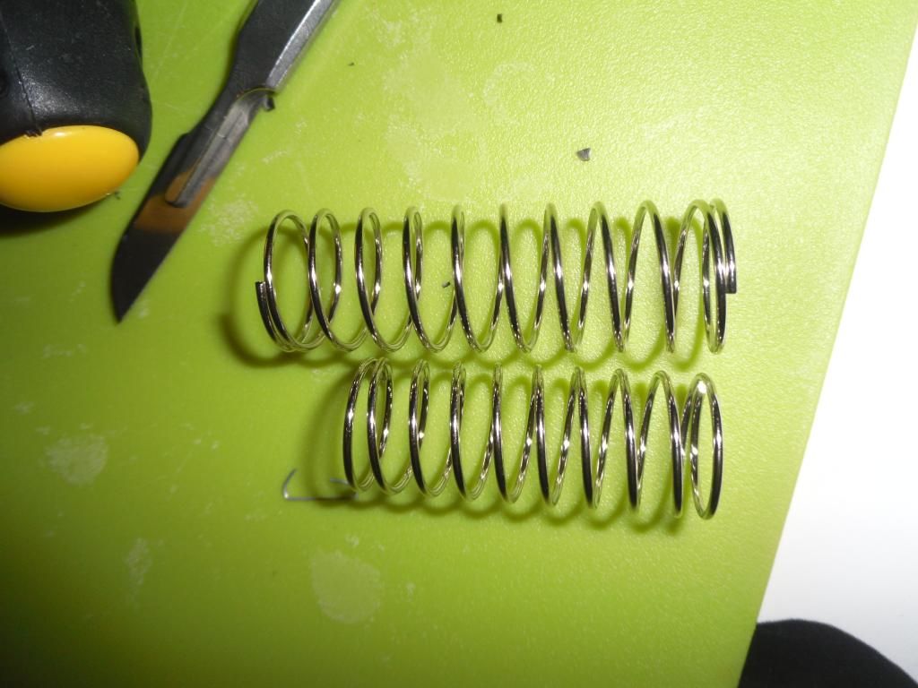

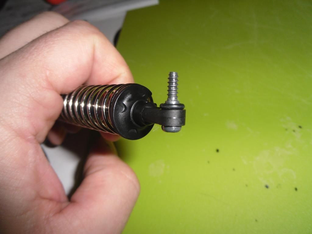

I fitted the longer ends, they look about the right length
The DT-01 springs might have been a better length but they are a bit wider so would not fit

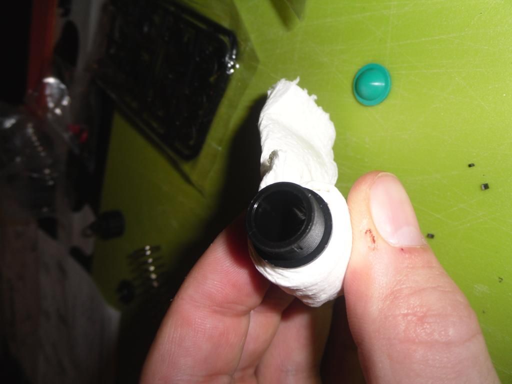

Filling with oil
Parts for rear
About the right length

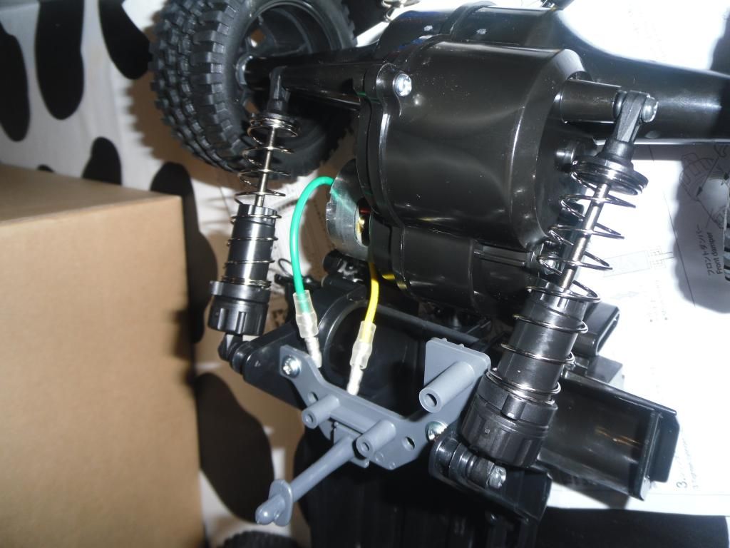

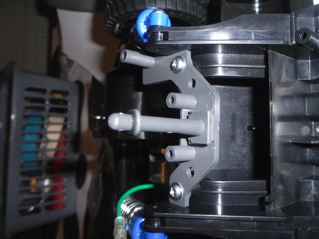

Used an O ring to space the fitting bolt to hold the damper to the outer side. kept it well clear of hitting the shock tower

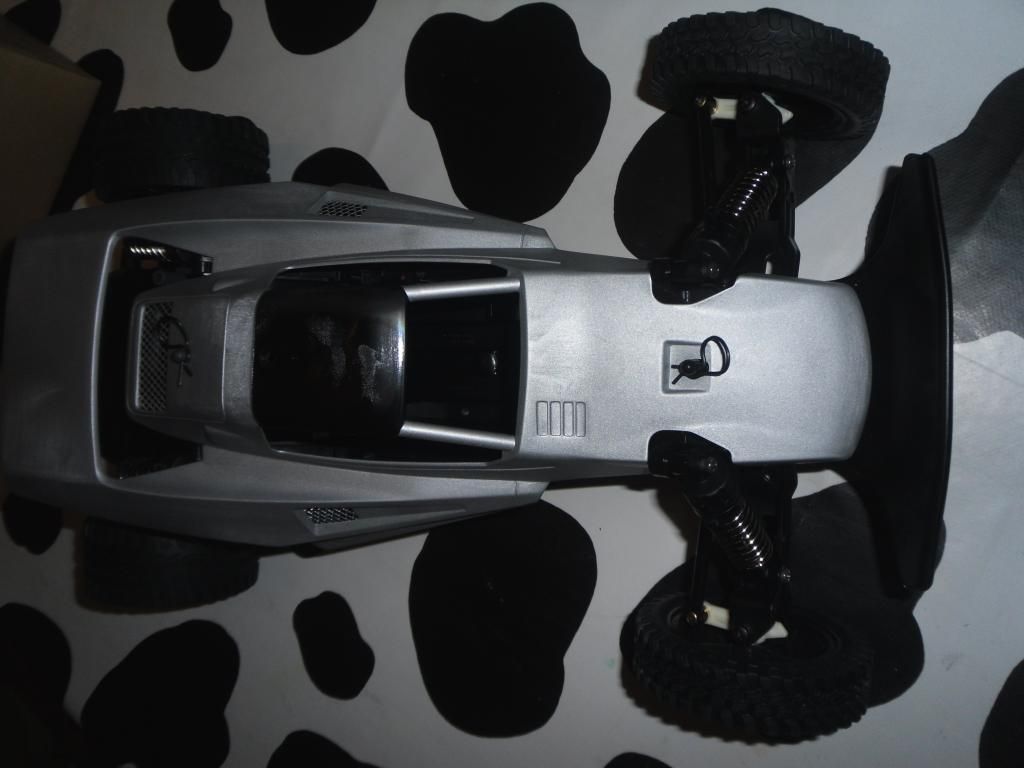

All done and they are much better than stock. The rear end does not seem to lock up on compression anymore.

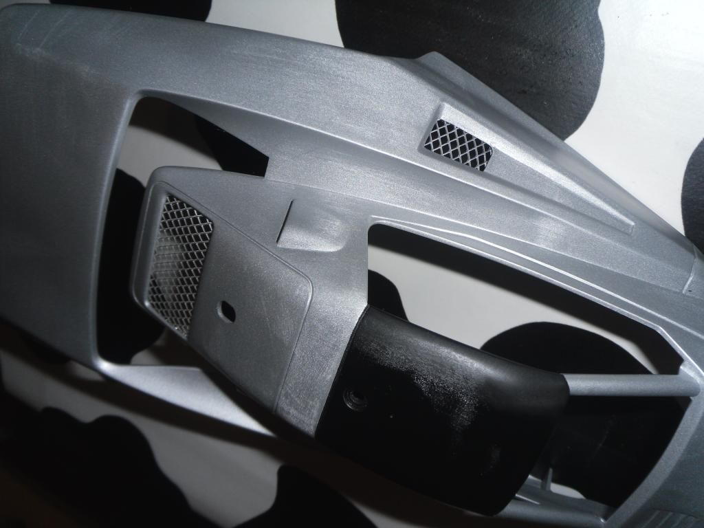

Added some mess on the vents as well, I quite like the look
You should use brass 5 mm ball joints on top and lower ends of the rear dampers. For sure the work better than with the screws.

I have some in the bits box, I will look after the weekend. Thanks
Looking good! Tamiya plastic dampers may not look as bling as the alloy ones, but they work well and should prove reliable.
Good idea with the mesh - I did the same with mine. I think it does improve the look, especially at the back where it fills the big resistor opening nicely. It looks like something is missing otherwise.

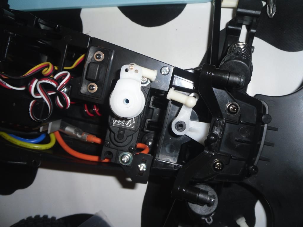

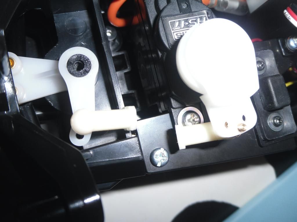

I could not even consider running with the standard servo linkage, the wheels did not feel connected to the controls at all.
I have added a couple of small ball ends, i had to re-drill the steering arm to clear the shock tower. The saver will need redoing but it just wanted to try it with the ball as far out as possible. Just need to wait for my length of M2.5 bar to go in the middle and it should be ready to go
Connected the servo up this a length of m2.5 threaded bar and took it for a run. It might be a bit direct now, flipped it on the first turn. Might have to adjust the position of the ball on the servo.
Apart from that it went well but the rear shocks are way to hard so softer springs needed.
