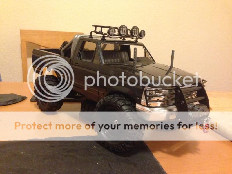

Here it was last year before I (stupidly) sold the chassis on-
D2287F95-6964-46E5-9503-4C9AEE5BBD49-962

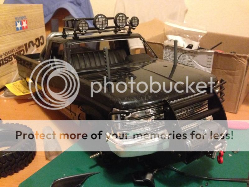

Today I assembled the CC01, which will be stock for now with the exception of full bearings. It's bad that I've already completed this stage in just 1.5 hours, all it needs is shocks and it's done...
I've also pinched the Pajero bull bar because I was never 100% happy with it and think it deserves a good battering on the front of this truck. It's already flaked some of it's paint and has genuine rust underneath! At least it looks good. I might lose the winch., what do you guys think?

Tonight I did a lot of cutting. The welds on these roof racks are incredibly weak and sadly mine has snapped on one of the legs just through tightening the nut on gently. Bummer.
Hilux interior etc all trimmed and fitted. Will need to relocate the steering servo for this to work but I have plans for that already. There's gonna be some serious arch-trimming on this for the 90mm tyres to clear, if only 1.55 wheels and tyres were more cost-effective :(
Araldite the snapped weld and then make some scale Duct tape to wrap it with. 1/10 scale running repairs as seen on any Zombie Masher :D
