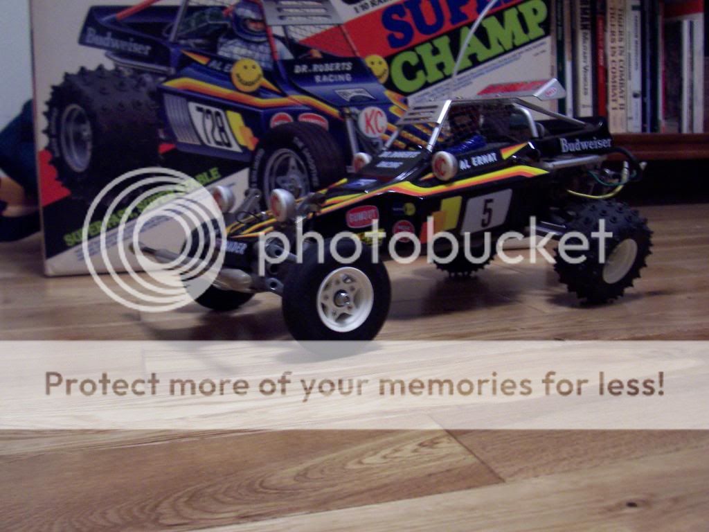

So, I've had this Super Champ in my family since about 1982.
It's pretty beat up
I have all the original parts and about 10 years ago I slapped a newer motor (labeled Roar 96 on the metal can) and a Duratrax ESC into it along with a new battery pack
Then it went back into a basement
I now have a 5 year old and he wanted an RC car for Christmas
I told him we already have one in the basement if he's interested in fixing it up with me
Here's some photos of it:

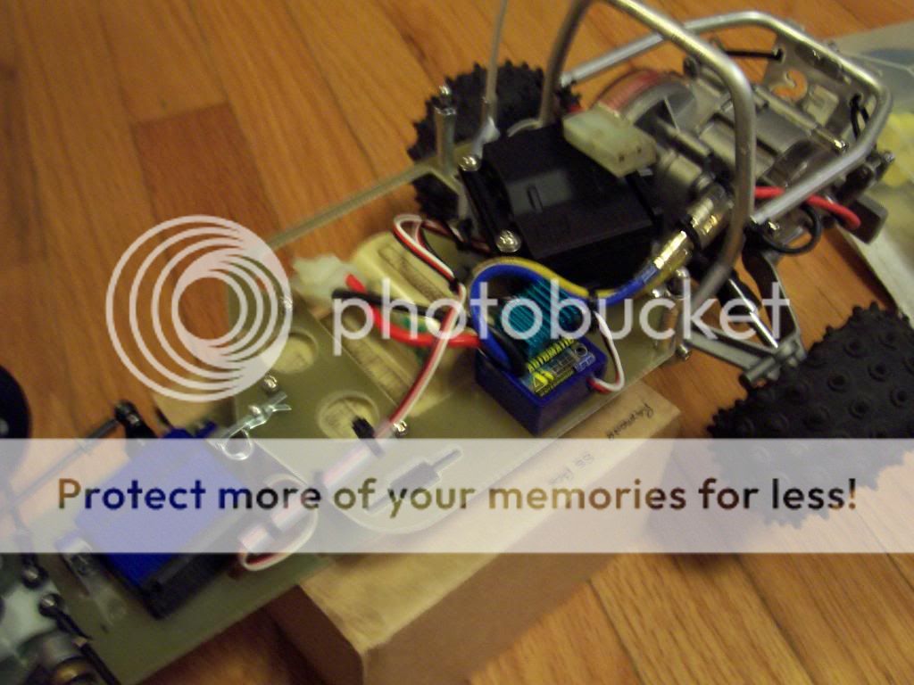

Ok, so I've got a LiPo saddle pack on order, a Traxxas XL-5 on order, a new radio coming tomorrow and a bunch of screws to replace some missing ones

Good news:
battery fits with multiple options
Plenty of room for some Command DualLock velcro to secure it to the chassis

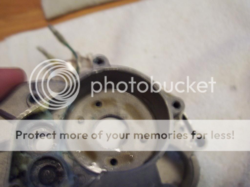

The rear shock also leaked badly, picture showing the leaking shock oil inside the gear case!!!!
