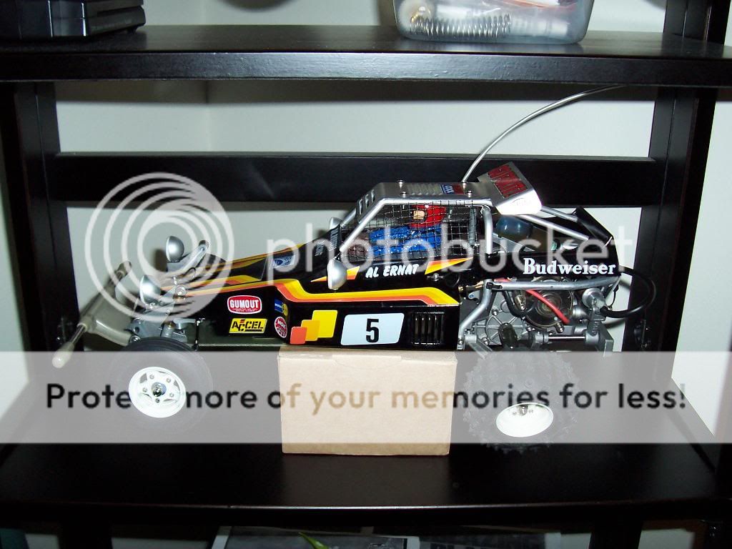

Compared to my original Sand Scorcher, the Super Champ is a much better runner, stock vs stock B)
Well, that's what Tamiya wanted to achieve with the Super Champ. The car looks and runs like a champ, but a 1982 Champ.
Anyway, that's one GORGEOUS example you have there! I always loved Super Champs in black. Awesome stuff!
Appreciate it :)
Another picture, ready for action, but stuck on the shelf :P
