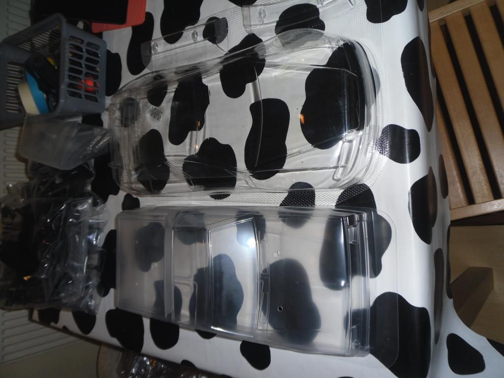

A random ebay search threw up a couple of possible basher bodies for less than a tenner for the pair.
Volvo S80
911 GT1 (200mm so might be a bit wide)

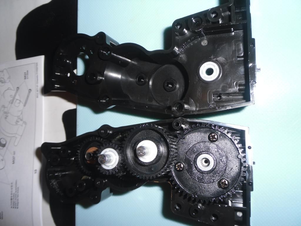

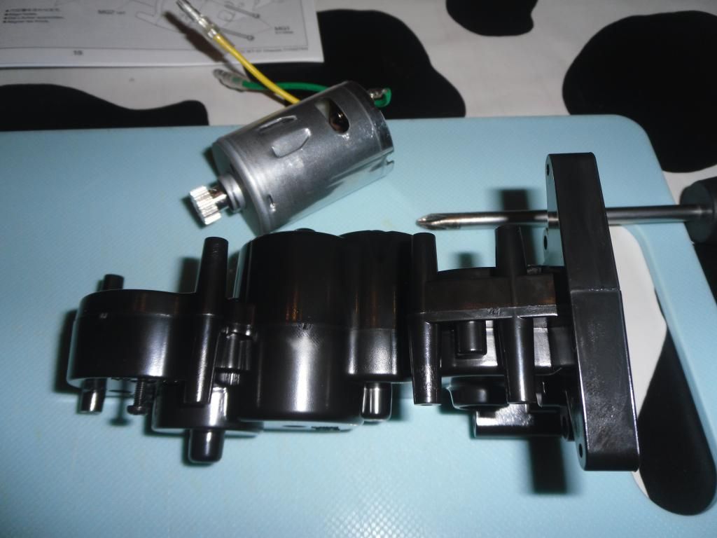

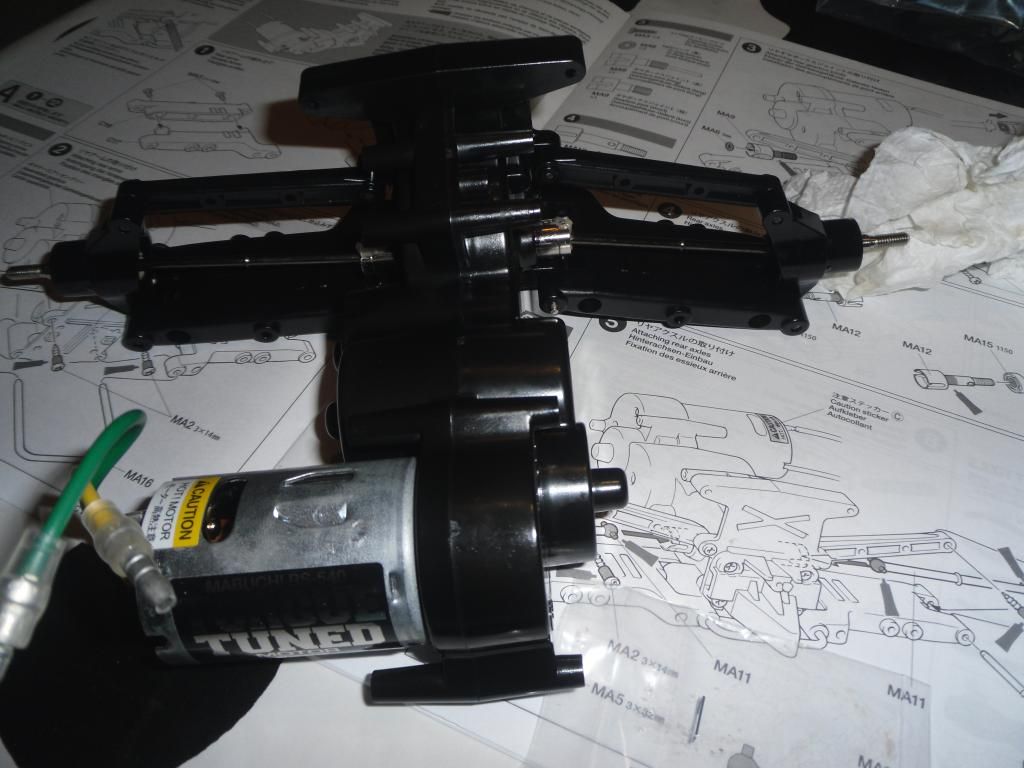

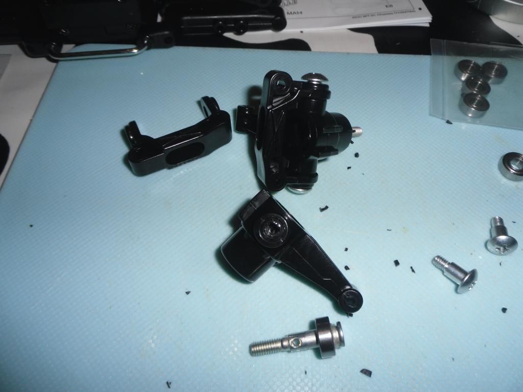

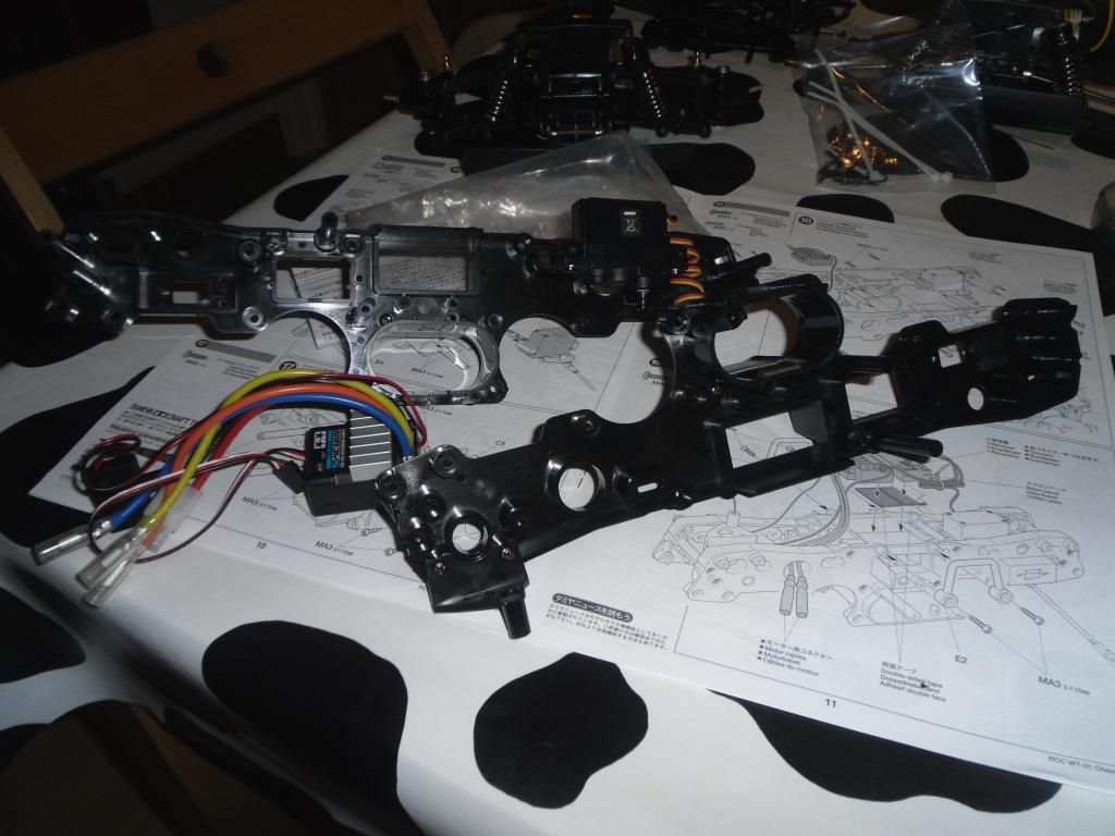

First thing to do is strip the pre-built gearbox and take all the plastic bearings out
I did not strip the diff, looking back I wonder if I should have.

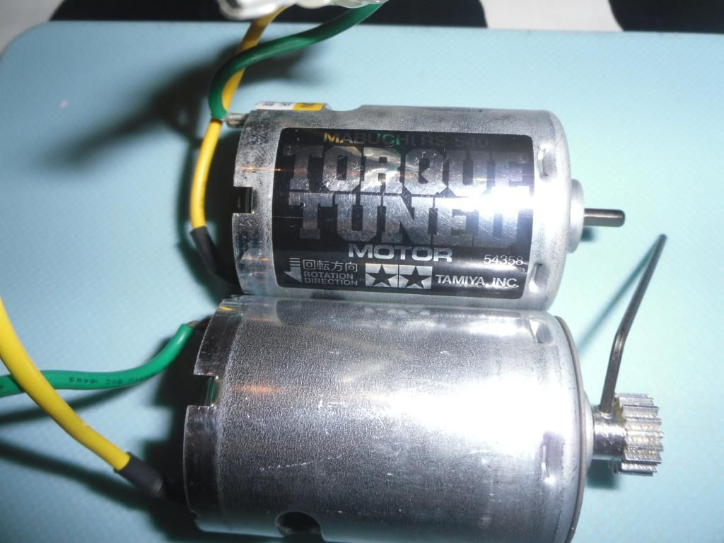

Torque Tuned in for fun

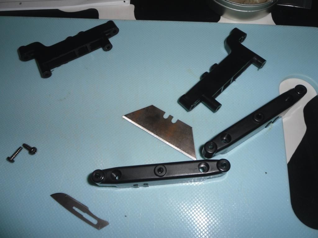

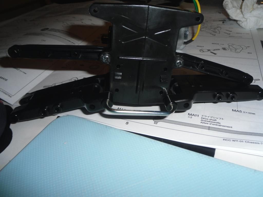

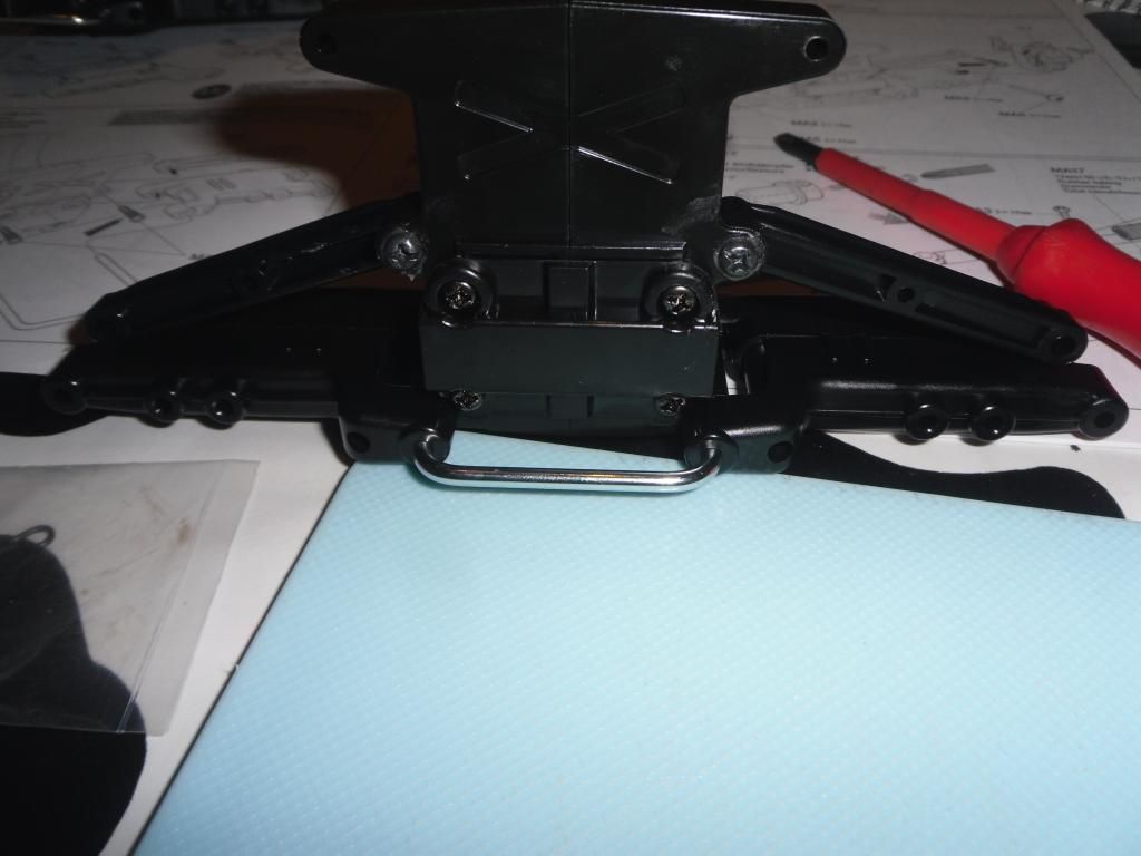

Building arms
Fitted

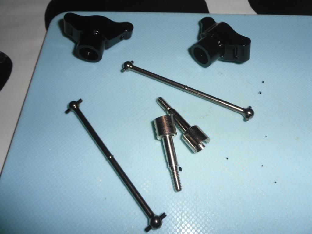

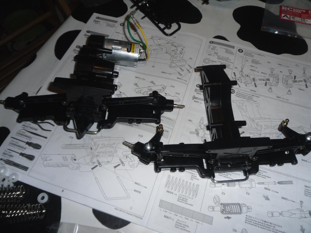

Drive shafts, impressed they were metal and not plastic
Rear done

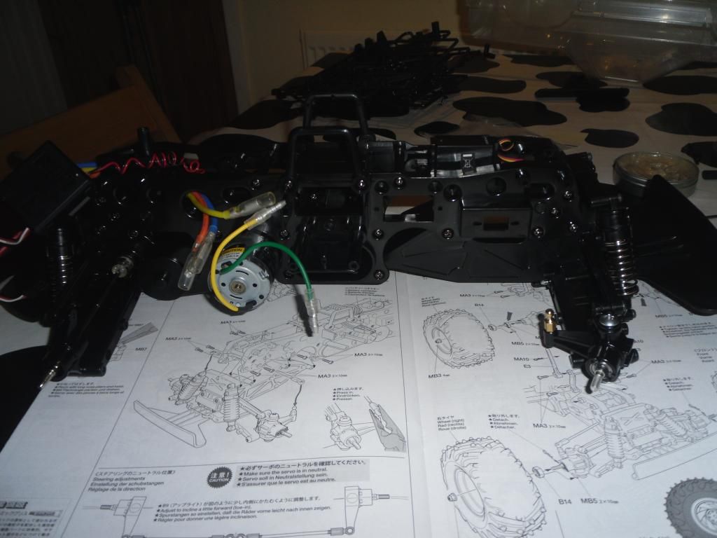

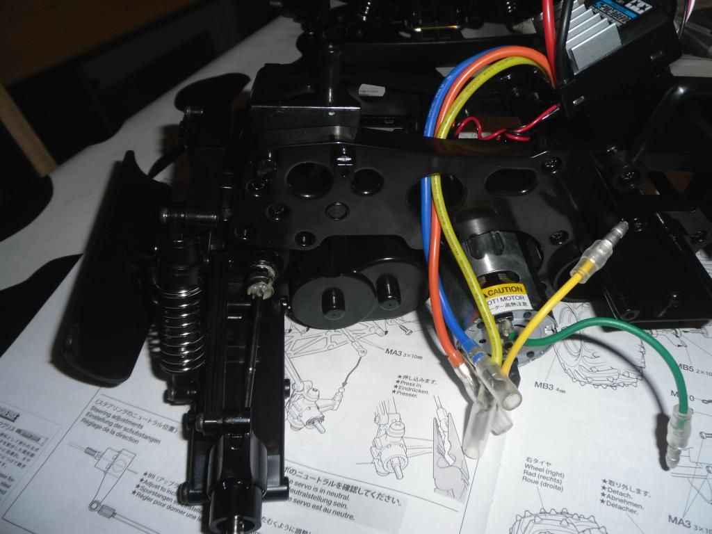

Front "fake" motor
Building steering

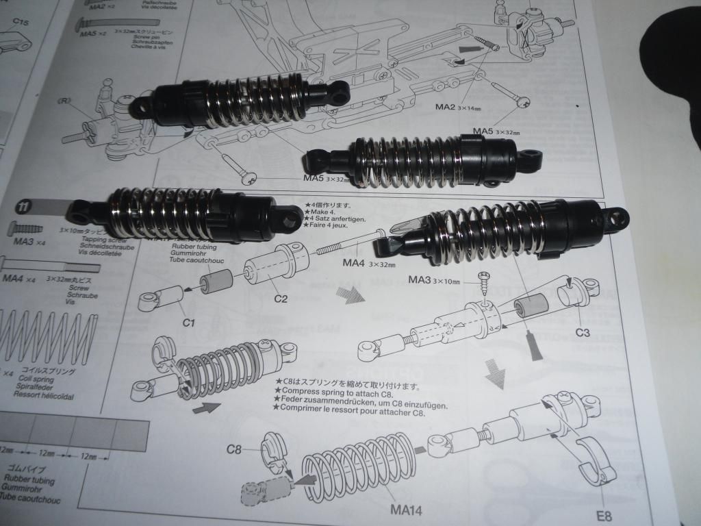

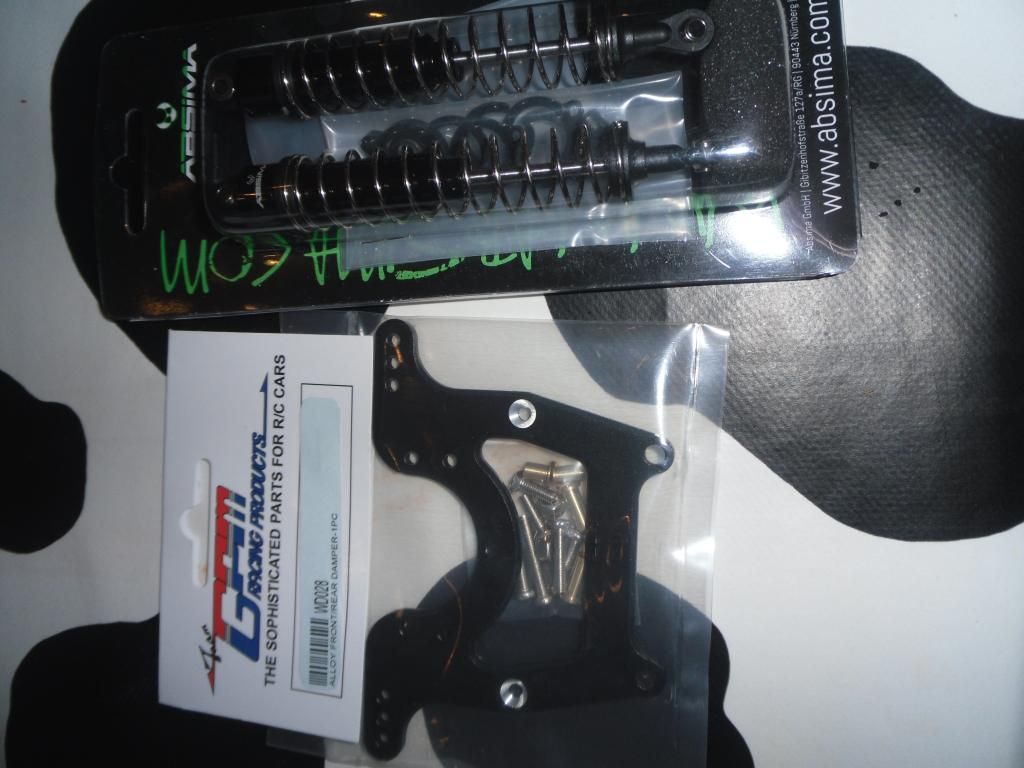

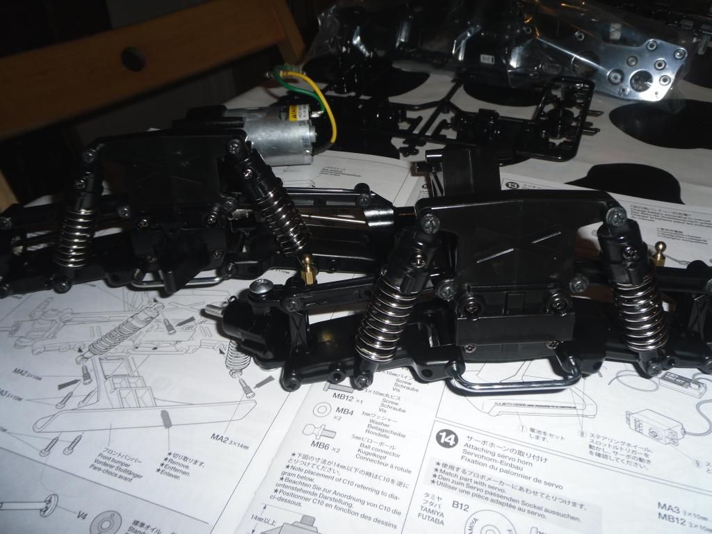

Shocks built (they are truly shocking but I need something to keep it up until the nice ones turn up in the post)

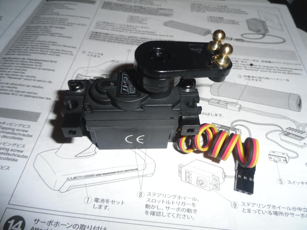

Servo part built. No radio gear yet so cannot set it

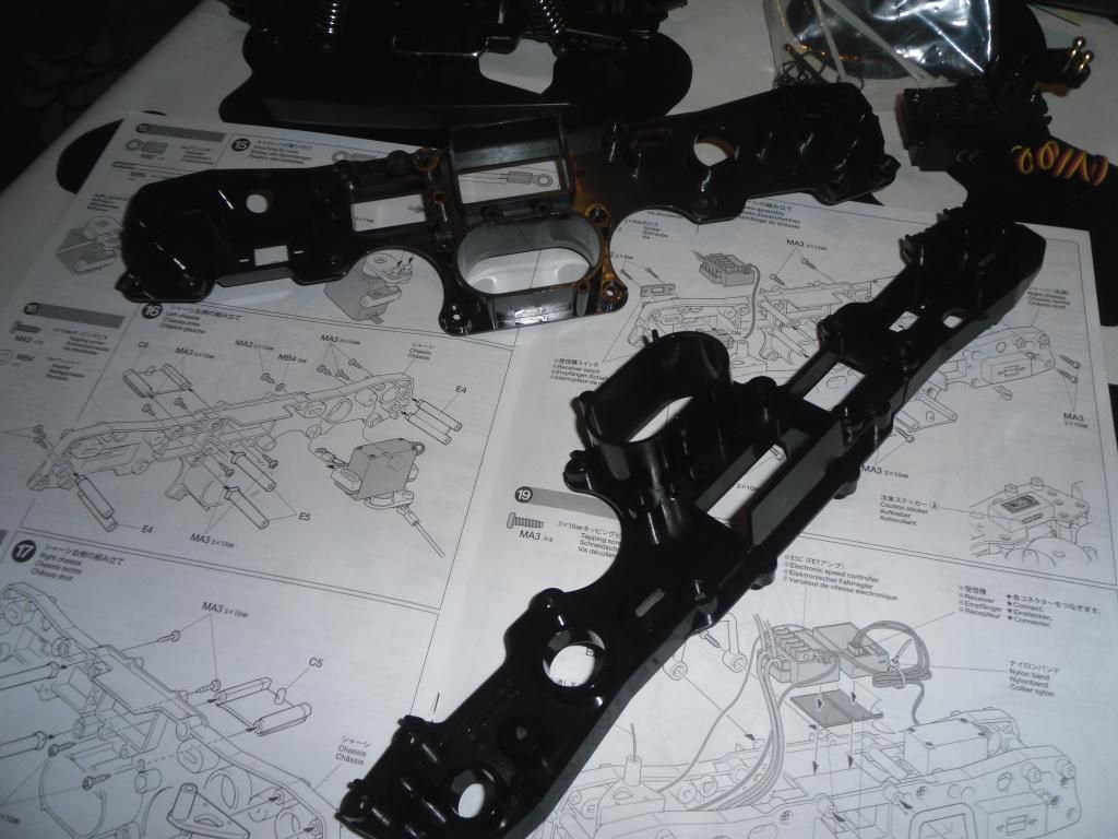

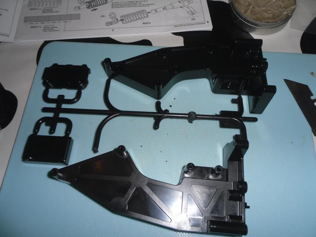

Chassis parts
Servo fitted

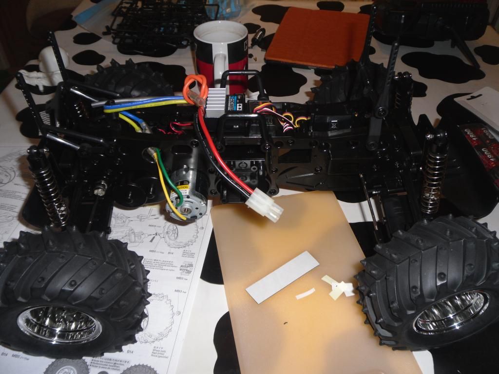

The kit came with an 04 or something ESC but I had a brushless one so thought it would be future proof

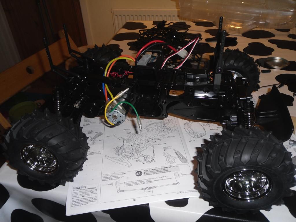

I cannot fit the front properly until I set the servo. I cannot set the servo until i get radio gear.
So I fitted the wheels anyway to see what it looks like. I LIKE :)

Other than the shocks and shock towers, which I take it you already have in hand, there isn't really anything else you need to do in order to make this a fun and reliable runner. My WT01 runs a 21t motor, steel pinion, full rubber sealed bearings, GPM shock towers and 95mm shocks, but is otherwise stock, and it runs great!

XV has summed it up well . The sky really is the limit in terms of what can be done with this chassis . To ensure you will never twist a dogbone i highly recommend these replacement universal drive shafts . Far stronger than stock Tamiya parts . I have had them fitted to my 4x4x4 wild dagger for around 2 years now and despite lots of abuse they are still going strong .
http://www.ebay.de/itm/Tamiya-DF-03-Universal-Shaft-Strong-Type-Tobee-/350507624646?pt=Radio_Control_Parts_Accessories&hash=item519be1e8c6
As I was building I was looking at the front motors on EBay. £20 plus a set of drive shafts it seems rude not to do it.

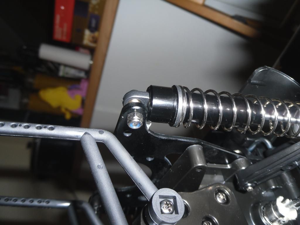

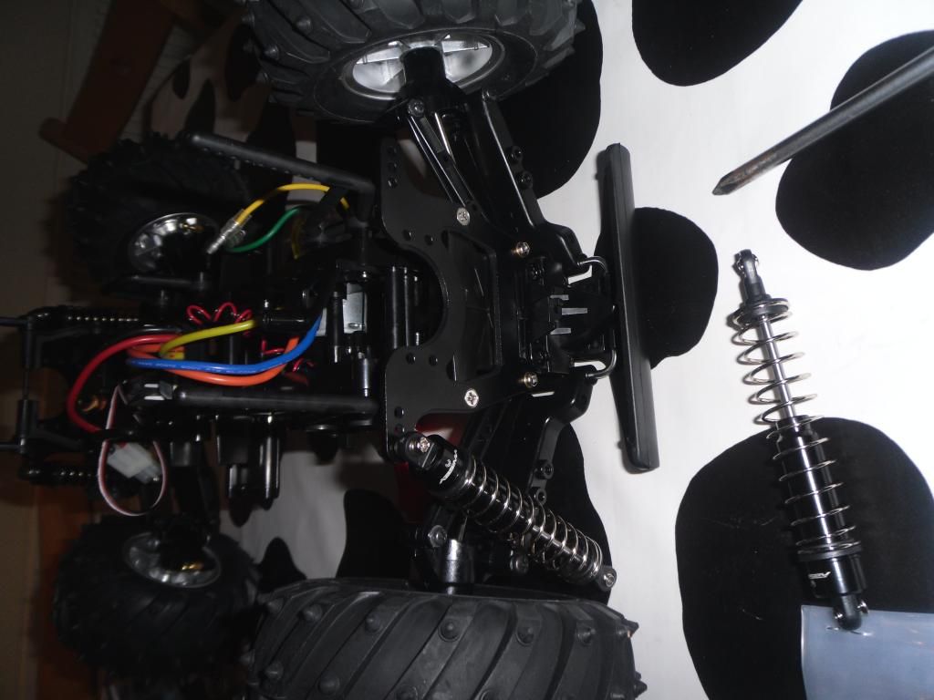

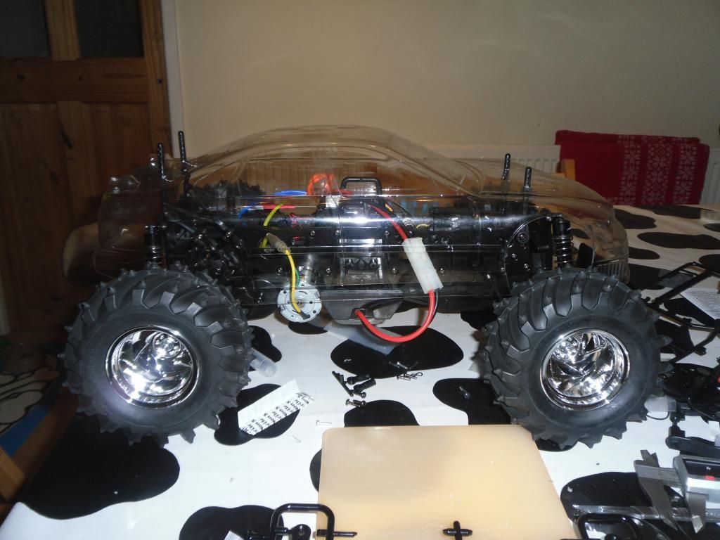

Small issue - the shocks are hitting the tower plates
Not sure what to do, others have reported using this same set up so not sure why mine do not fit.
Bit more clearance if I loosen the bottom a bit. Need some spacing out

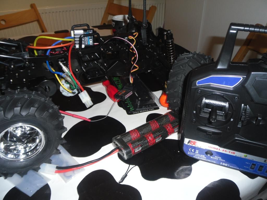

Quick YouTube to see how to set up the radio gear
Wires tidied up a bit

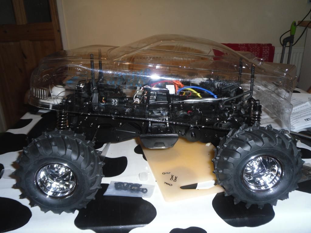

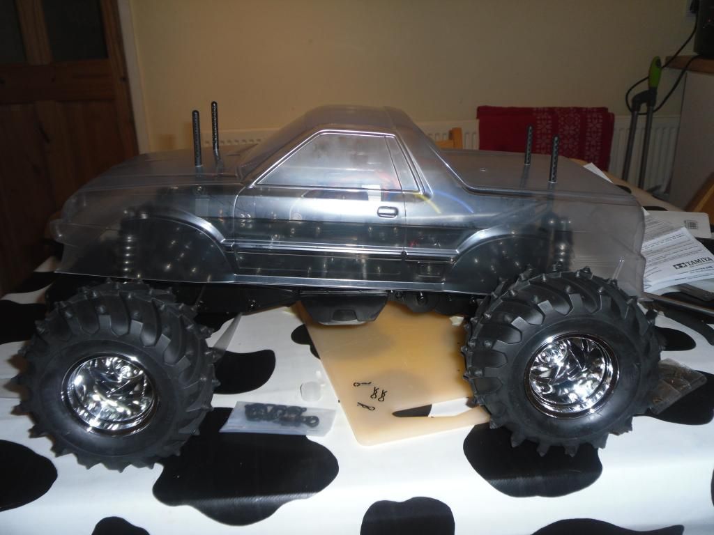

Trimmed the bottom off the body for a quick fit. Not using this body yet but it's nice to see it on
Sticking a Volvo touring car body on. It will look out of place but that is sort of the point
This seemed like a good idea but it was not great to use
Needs jacking up higher but not as high as the BRAT body, that sits a bit high for my liking.
Had a quick crawl around the kitchen. Need to adjust the steering arms but apart from that it is ready to rock
I see you have your shocks attached to the inner holes on the lower arms. Perhaps try the outer holes instead? That is how I have mine mounted, and they fit fine without clearance issues (just).
I will give it a go tomorrow, thanks.
I tried moving the shocks to the outer holes with no luck. Someone has changed specs slightly and now the dampers clash with the tower. I have a solution, not a great one but it will do for now.
Posted Image
I'm not sure but I think some real car performance shocks are mounted like this (in the upside down position). With the weight lower down its meant to help with handling etc. They might be better like that.
I would give that go - flip the shocks before trying anything else . If not you could always file the mounts slightly for clearance . Iwould also consider a small spacer and longer screws to move the mounts away from the lower arm .
I thought about spacers but the arms are so soft I think the screws would work out. I could drill through and bolt them though.
that sounds like a decent plan .
