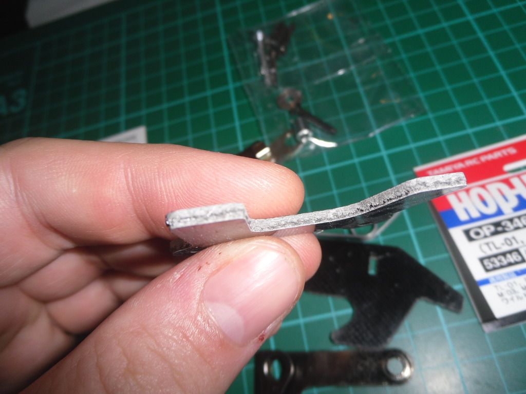

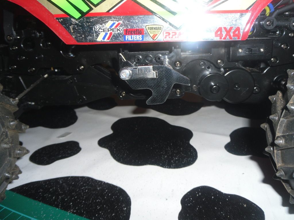

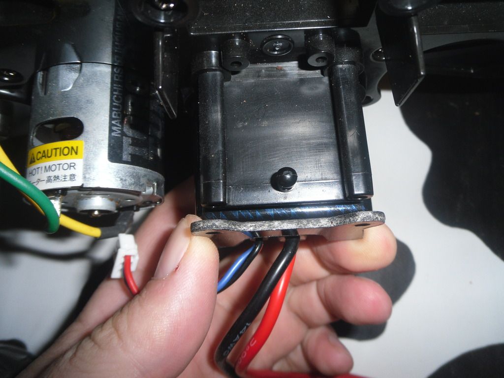

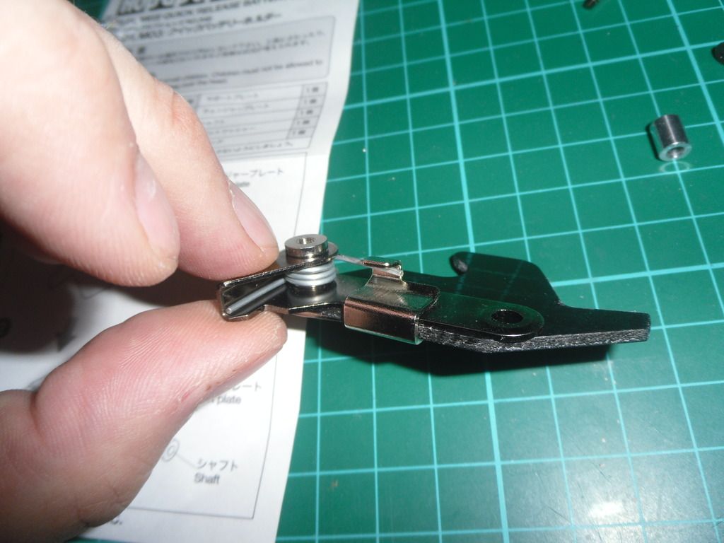

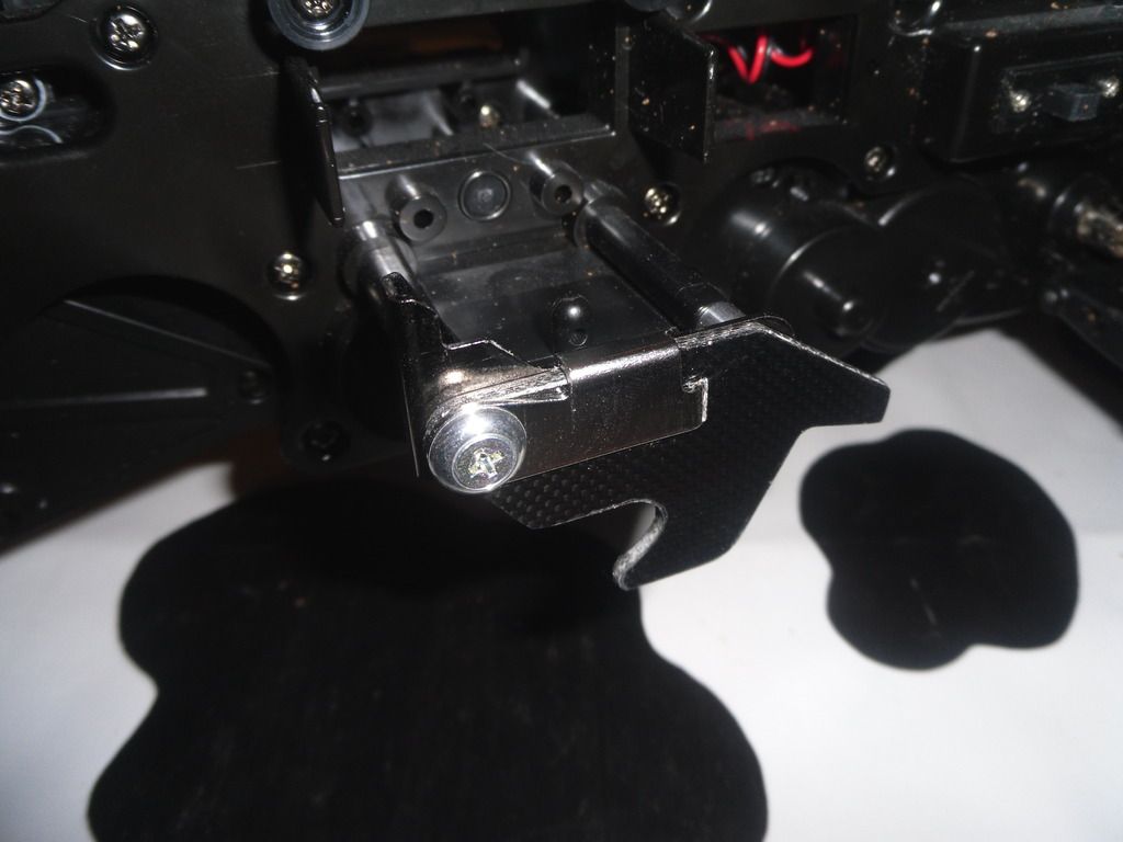

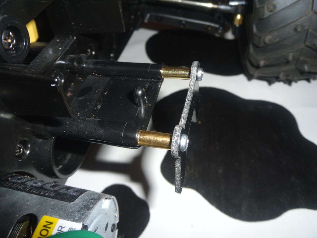

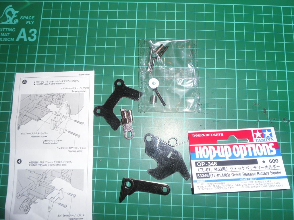

M03 Quick Release Battery Holder
First impressions not great, very rough edges
Sandpaper and super glue later and I am more happy
What I am taking off
First parts together

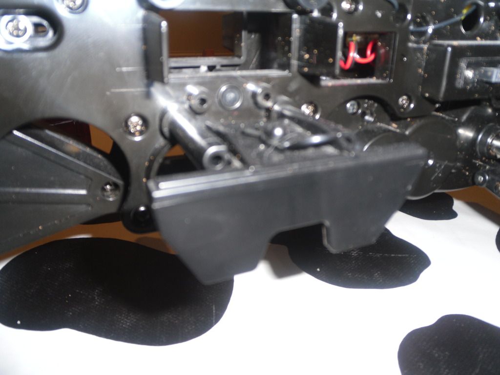

Fitted

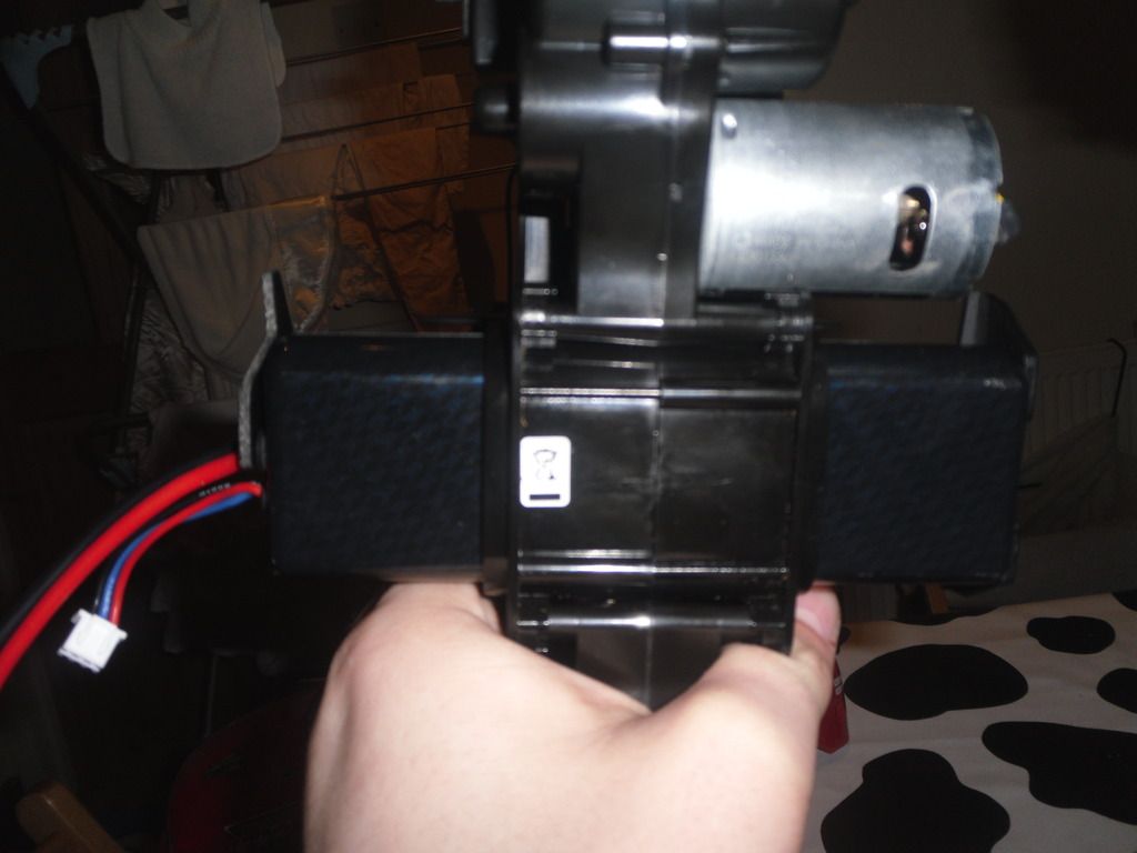

Not a bad fit
Looks like the length will be great

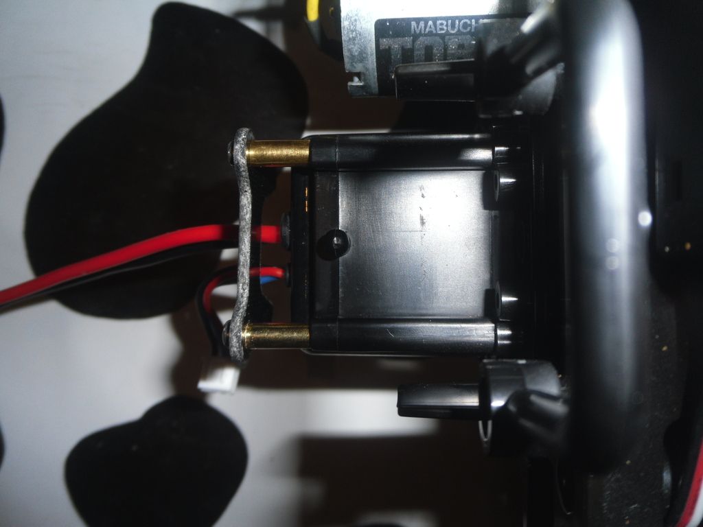

Other end, fixed plate. Need to make some spacers
These are far to long but they will do for now. Ends cut off 4mm bullet connectors

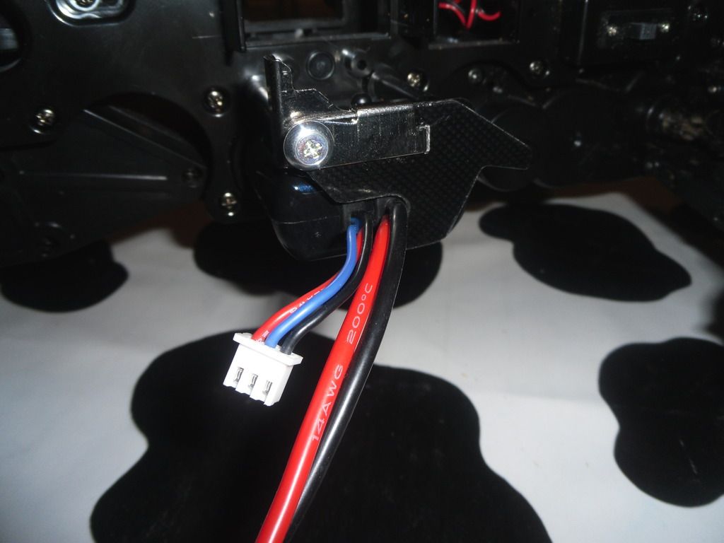

Just as I was finish tidying up I noticed this needs to be on the other side. Hook facing forward could end badly
All in all this is a great mod for fitting LiPo to this chassis

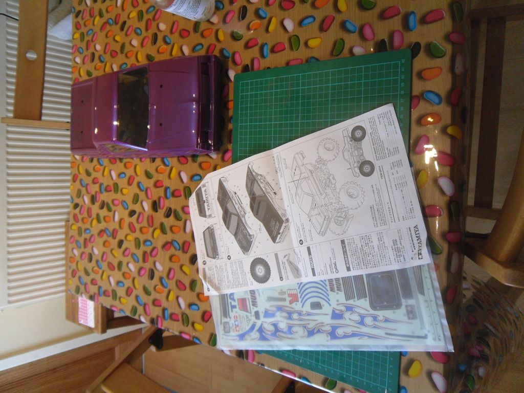

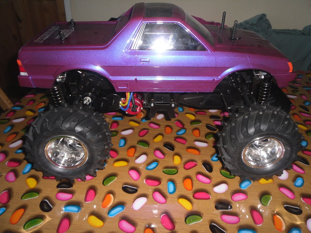

I have been running my Wild Dagger body on this so I had no need to paint the BRAT one.
As a runner I decide to put in the least effort possible so I am not afraid to run (and roll) it at ever opportunity

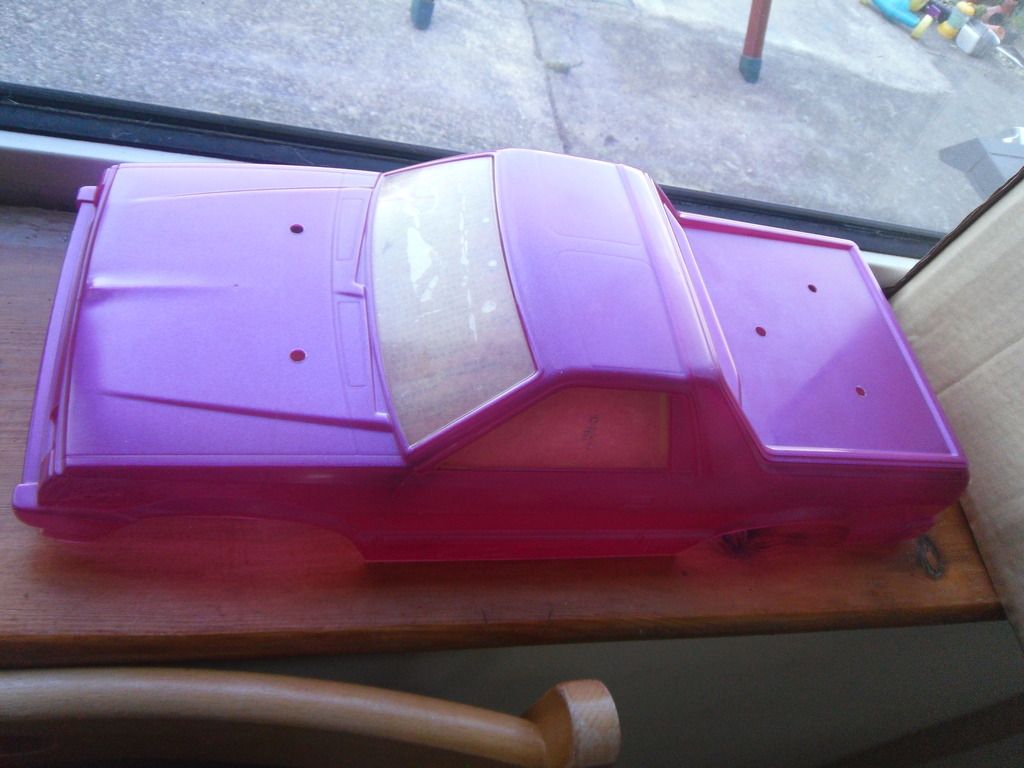

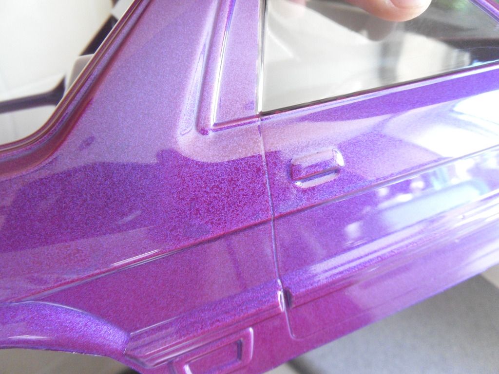

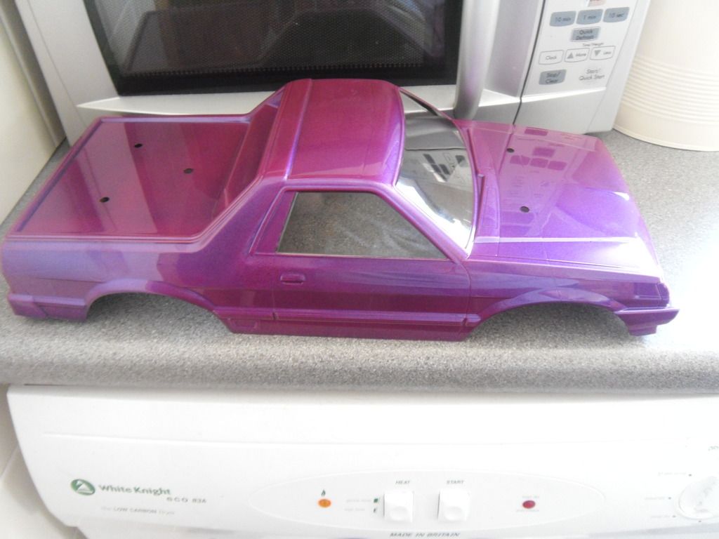

First coat, looking a little pink. Rosa thinks this is for her now. I gave this a badword of a good wash but there was still areas the paint would not stick, I had to wash in alcohol and do a second coat

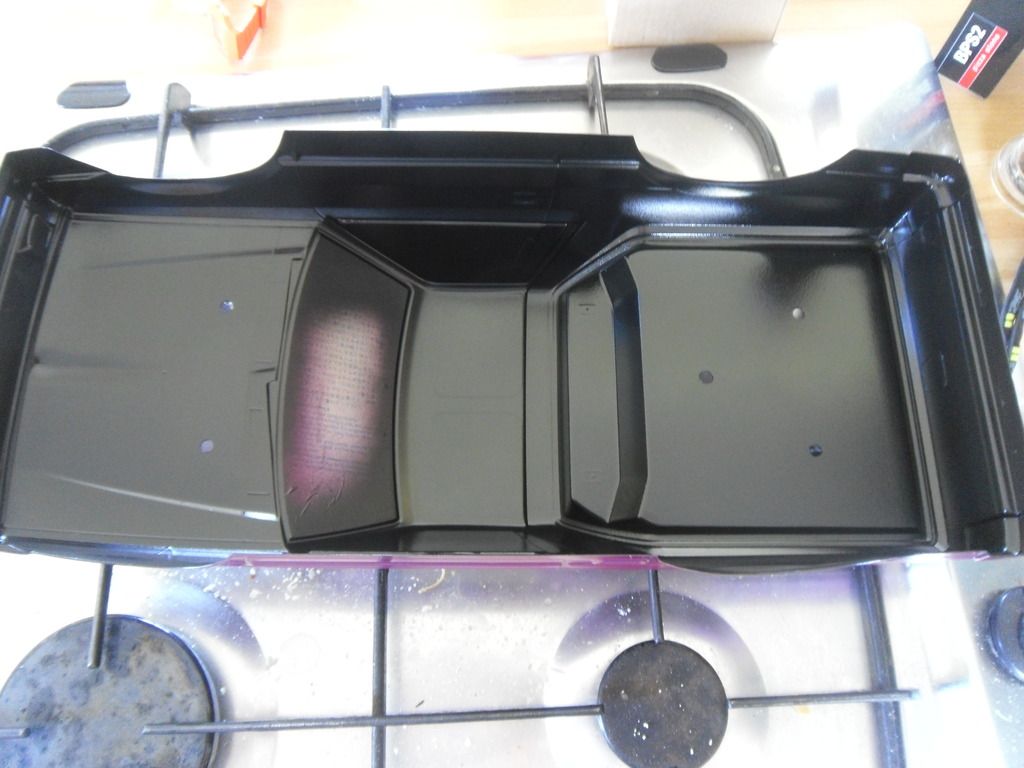

A few coats later and a 50 mile round trip to get a tin of black for backing
Windows off and looking good
Couple of places the pearl has not taken to well
Just need to decide how far to sticker it now

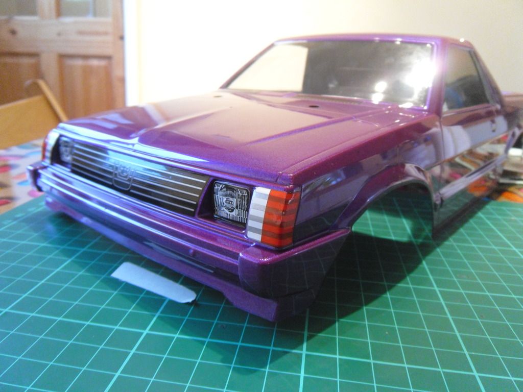

Is that Pactra pearl grape? Similar at least, I had similar issues with the paint on my TA03 drift rx7 shell, looks blotchy up close.
Looks cool though and is more than good enough for a runner.
Faskolor Fasescent Candy Red. It is not very red!!!!
I am going to try multi colour on my DT-03, this "red" over a pearl white

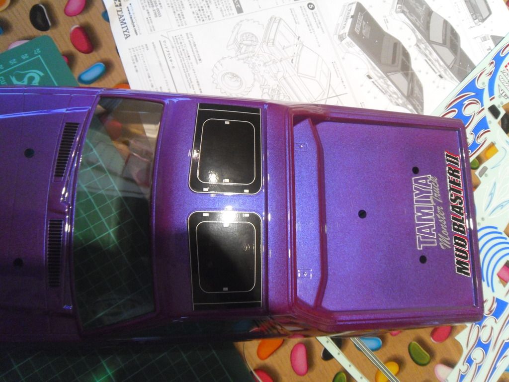

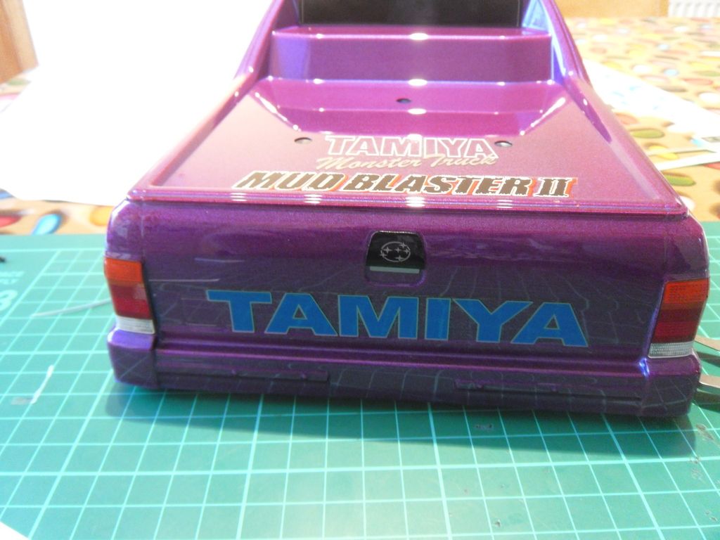

Sticker time
Going low effort, high bashability so not going with a full set
Front not looking to bad
Top
Rear

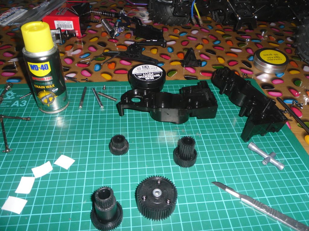

Time for this to go, for no other reason than I got a better one cheap

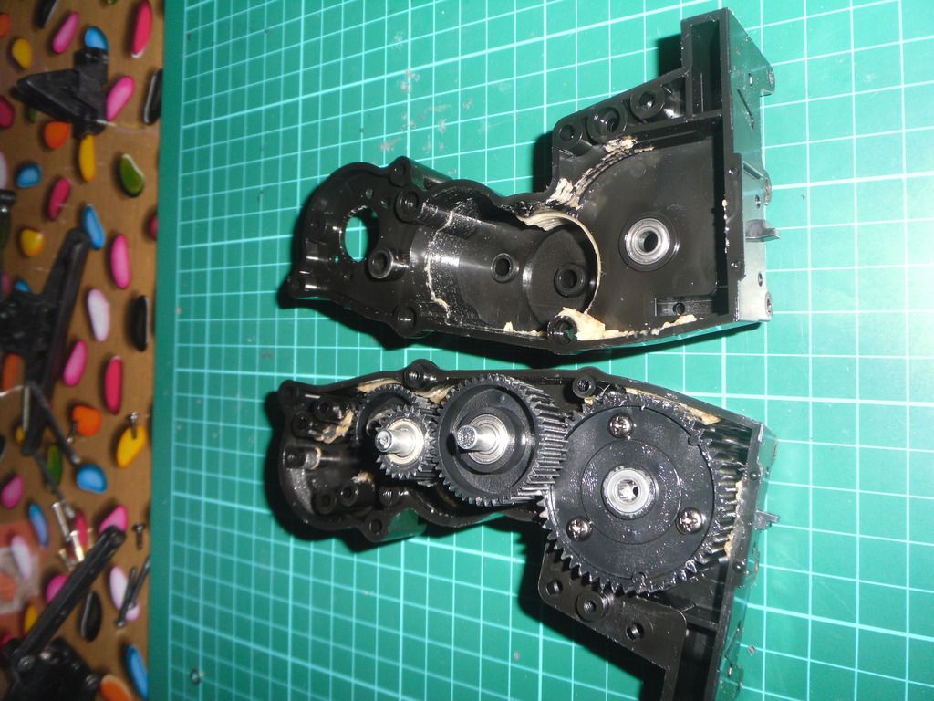

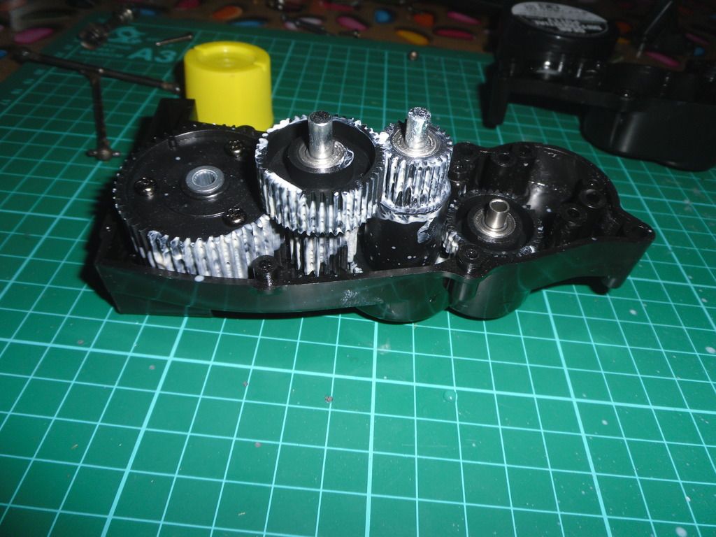

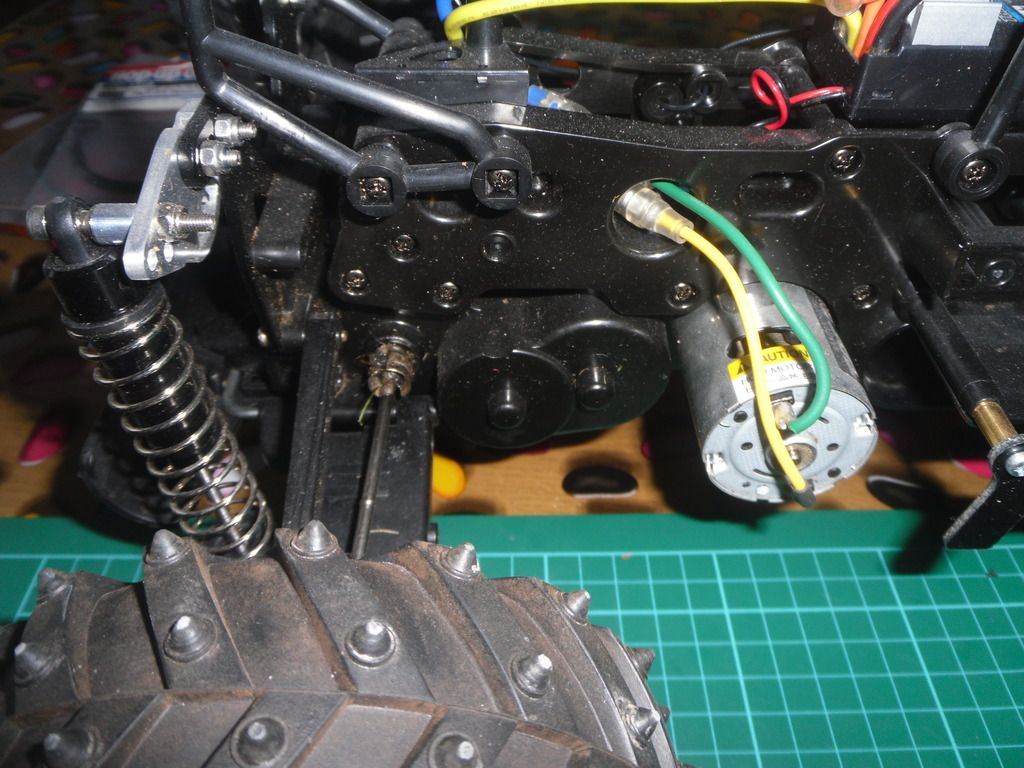

First time to tighten up the diff a bit
Tamiya but plenty of grease in as stock
All clean
Chain wax as lube

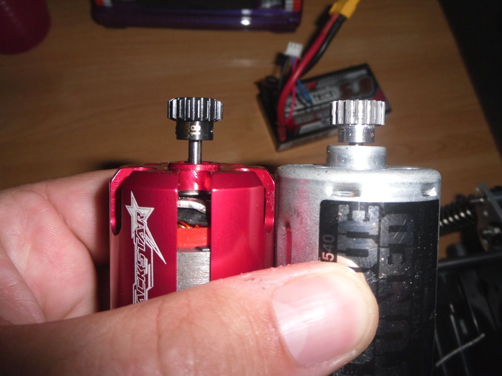

New toy
Real Steel
In the right place I hope
Spot on length
Love the fitting holes options

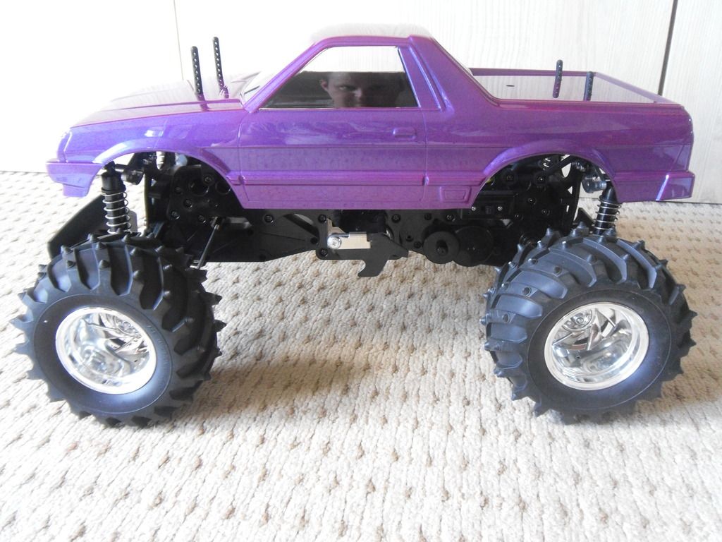

Looking sweet and fast :-)
Quick run around the garden and I think this one will spend a lot of time on its roof

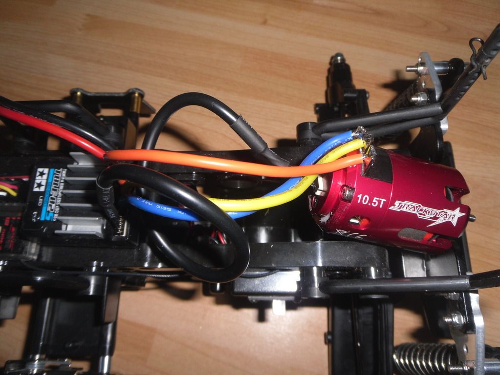

Yours is now a very similar spec to mine! I also run a Trackstar 10.5 sensored motor, albeit with silver finish not red (not sure if there is a difference other than cosmetic)
It will go like the clappers :)
It will wheelie from a standstill and I actually found opening the diff up to stock spec made it a lot more driveable with the high grip the tyres generate. I've got some VG diff grease on the way that I might try next, but I definitely wouldn't recommend locking it if anyone is reading this and thinking about it!
