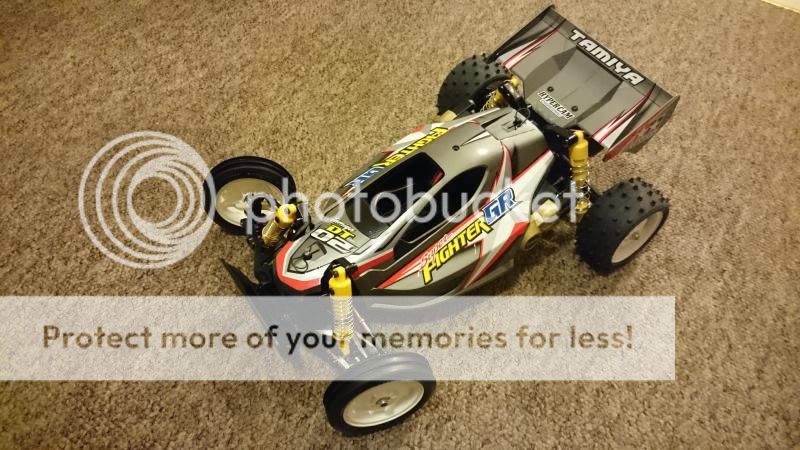

This build has an accidental and problematic birth.
I ordered two DT-01 chassis from a place in Germany. Turns out they did not have two left so they sent me a DT-02.
Sounds great but the C spur parts and the C parts bag were missing.
They were very good and sent the bits but while I was waiting I sort of ordered a few Hop-ups
No body as of yet, I might try a few things out. I thought about lobbing big wheels on and trying for a hi tech Madbull but I have heard this can cause motor and ESC issues.

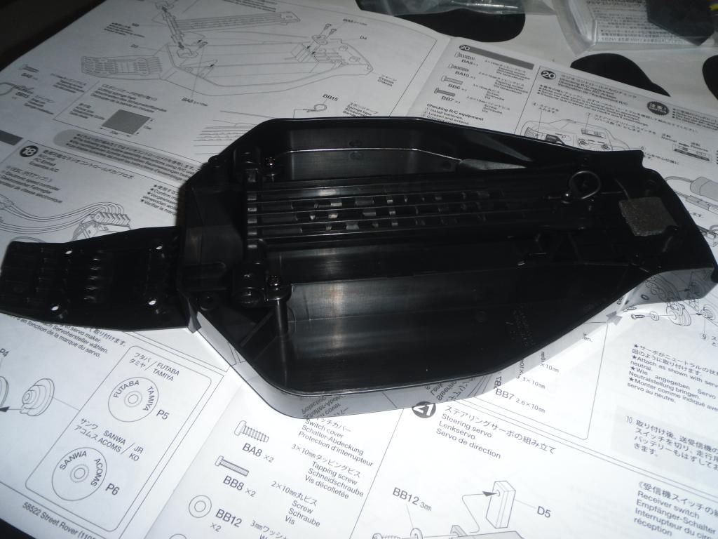

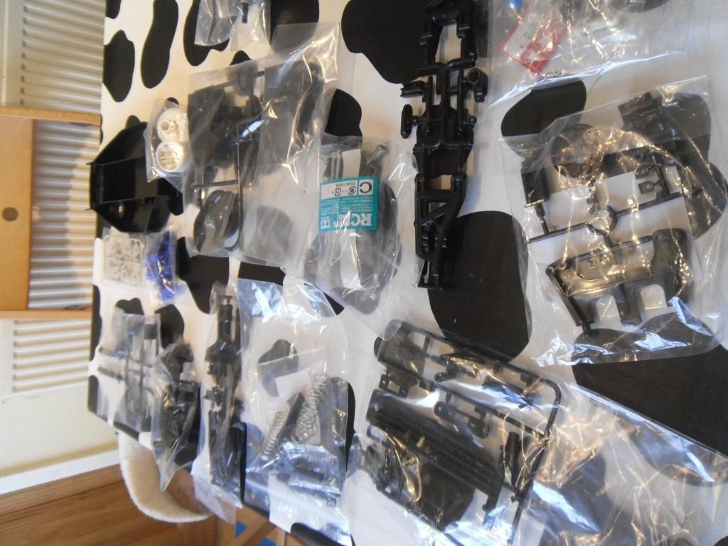

Spent a lot of time ticking off every part to make sure it was all there
Ready to start

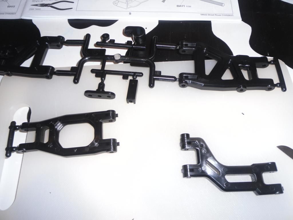

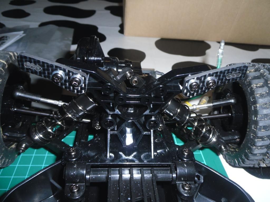

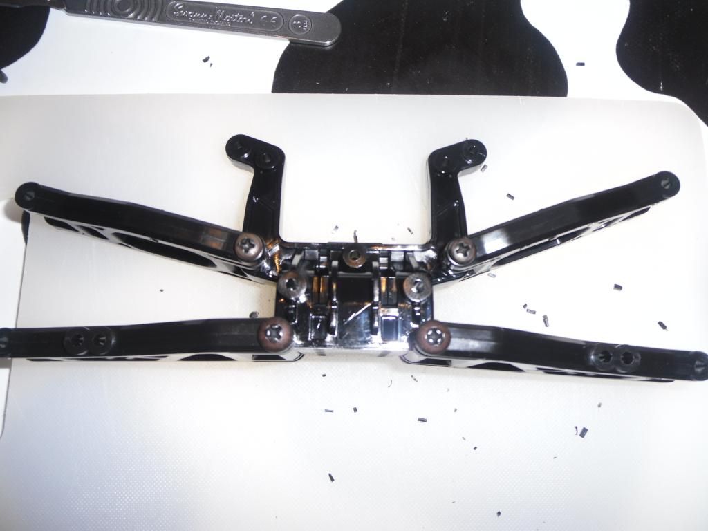

Trimming arms
Fronts fitted
Built up (poor photo, sorry)

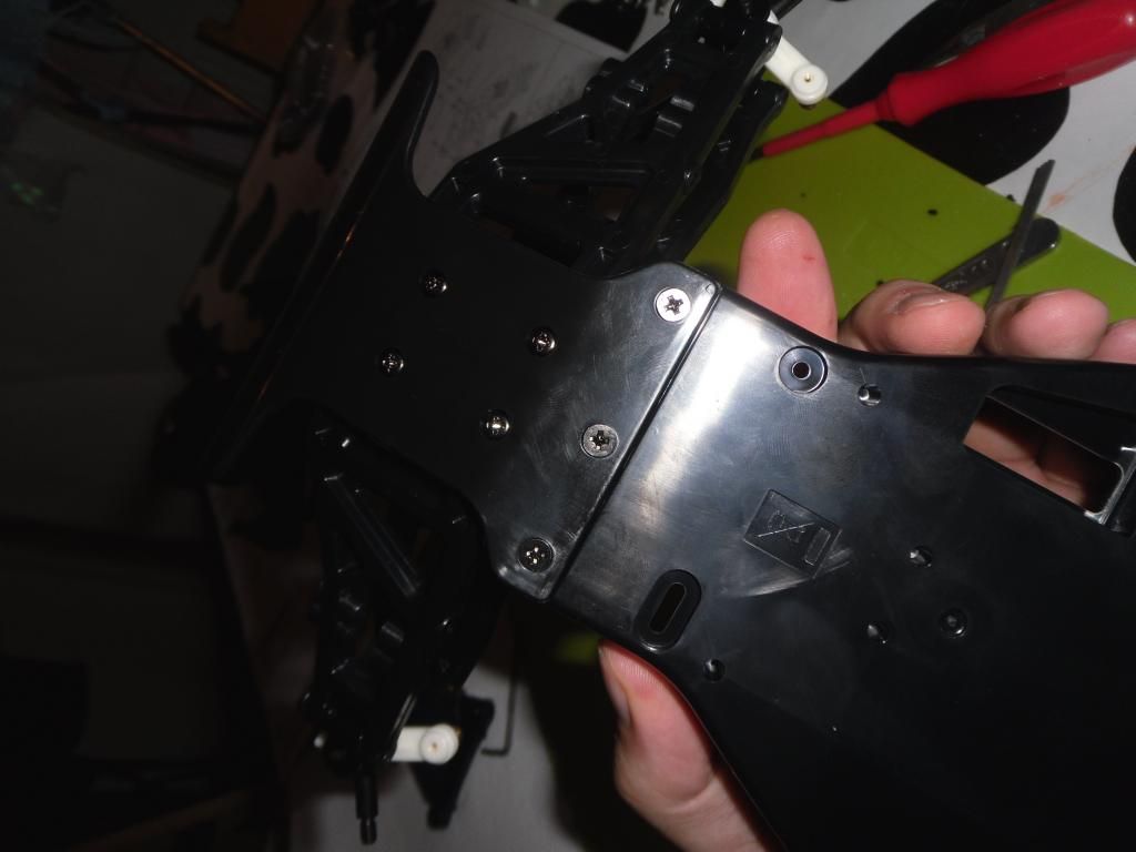

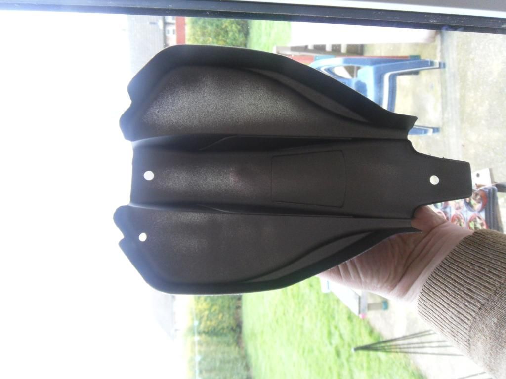

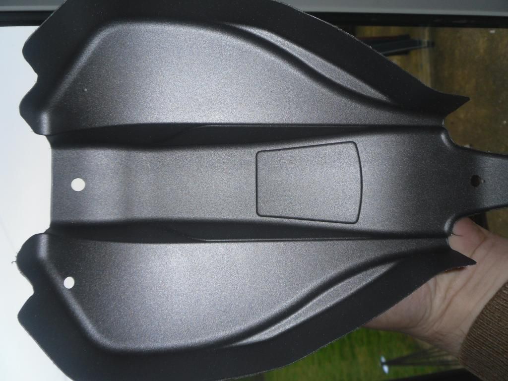

Body tub is nice on these, feels much nicer than the DT-01 one

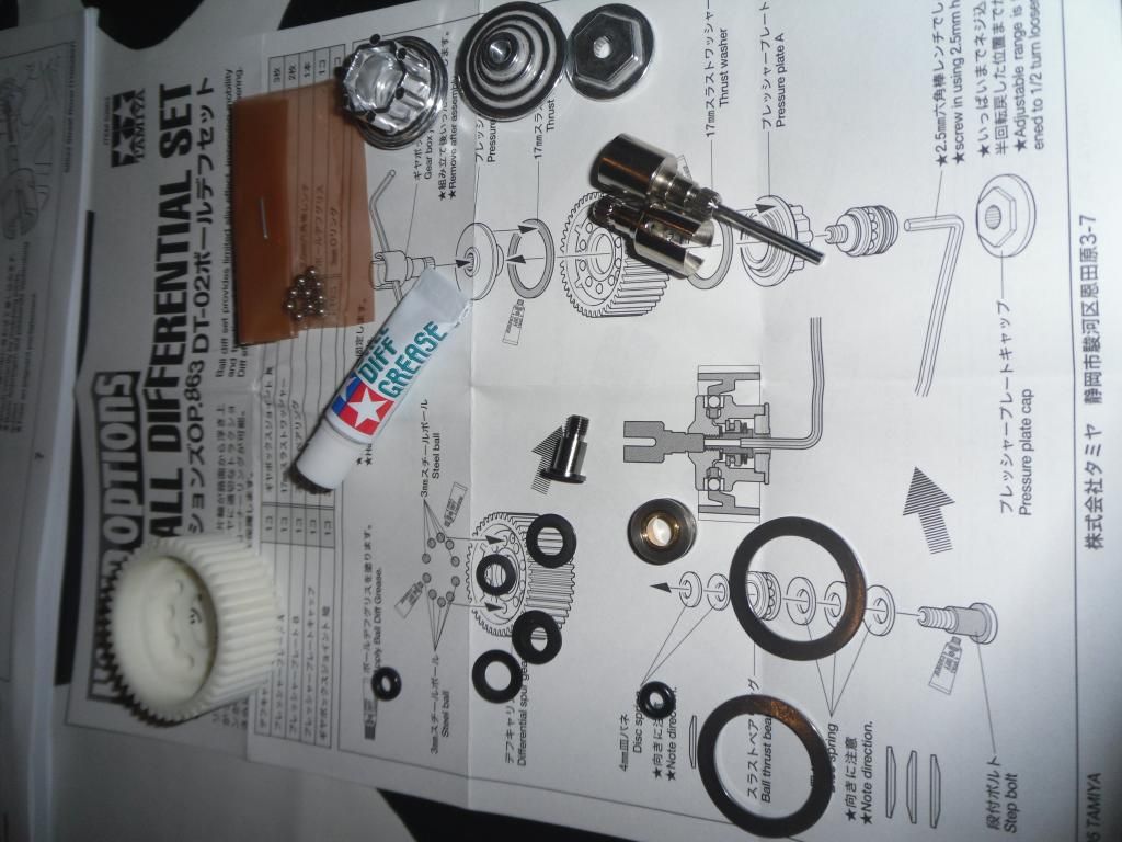

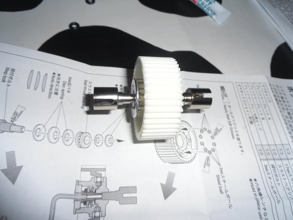

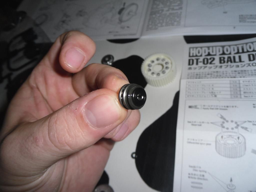

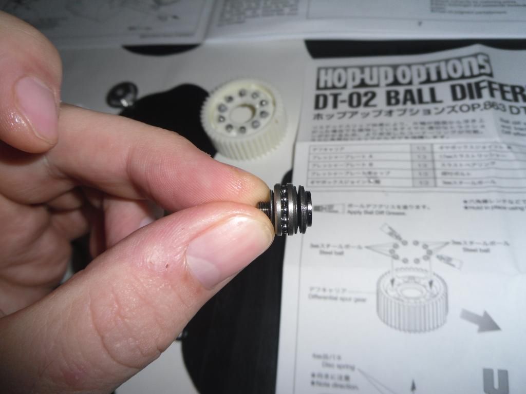

Ball Diff - no idea about these but some limited slip seems to be needed on most of these 2WD's
Following instructions, for once in my life

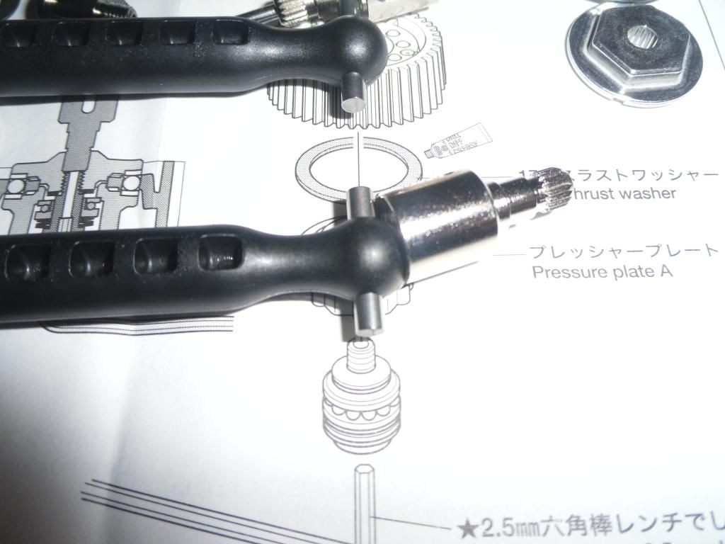

First issue - standard drive shafts will not fit the cups from the ball diff
Balls greased and in the holes
Center shaft spring thing all built
All build up
I have adjusted it all the way up. It did not feel that tight to me but maybe it does not need to be to limit slip. I will run it in for a bit and then adjust if needed.

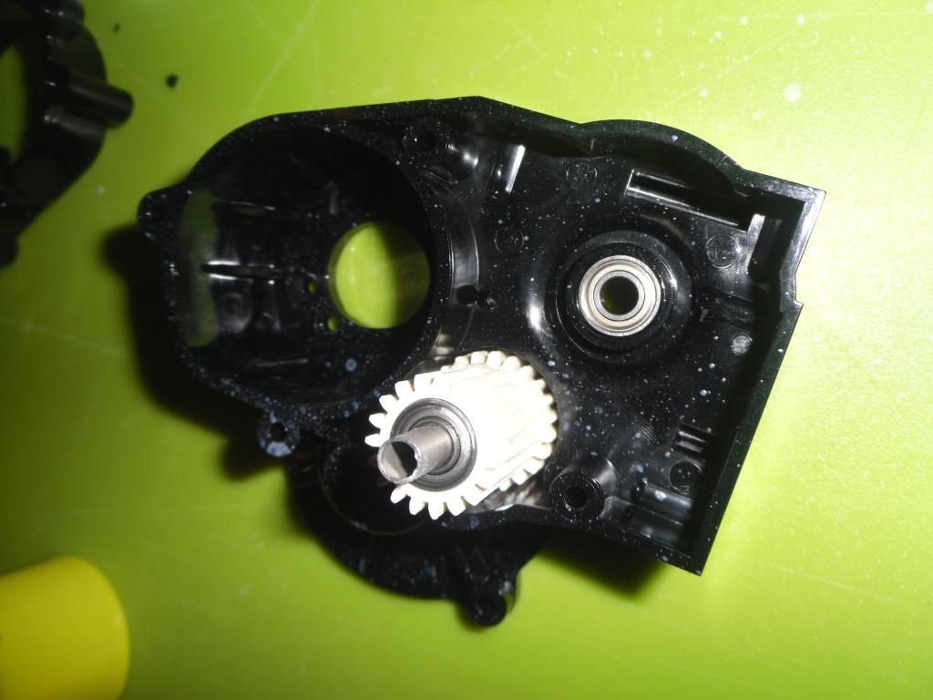

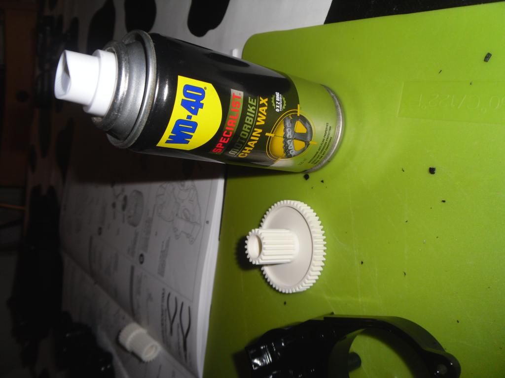

I have over greased my first couple of builds so I though I would try something else. A couple of people have reported minimal wear not using lube so I thought I would try a bit of wax. If it good enough for a 160MPH bike chain then it should be ok on a little car
100% sure these are a total waste of money but £3 so why not

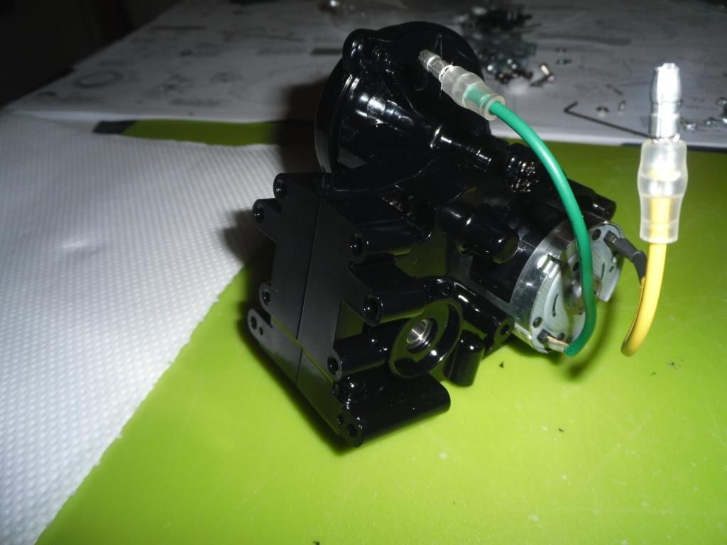

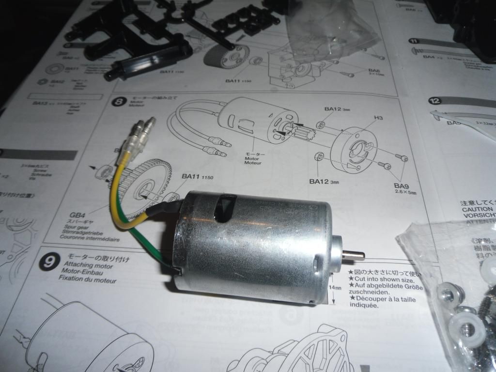

Slightly tuned motor
This confused me
Worked out this is supposed to be for a smaller motor
Fitted

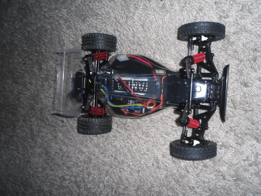

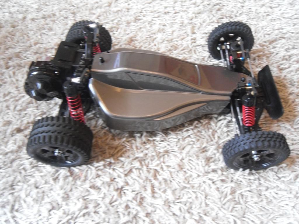

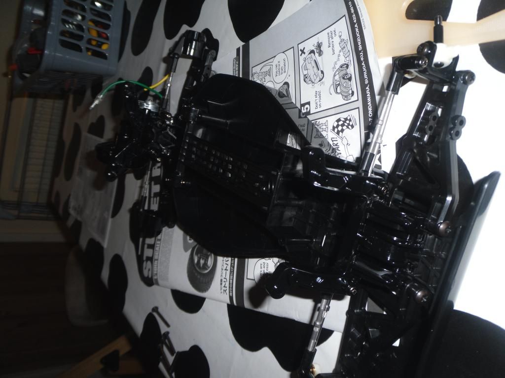

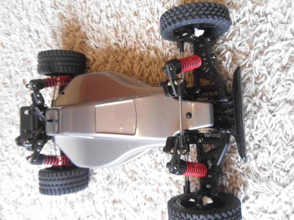

Built up ready to go

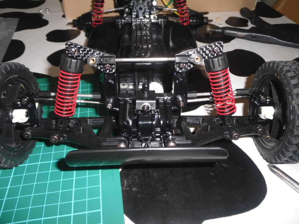

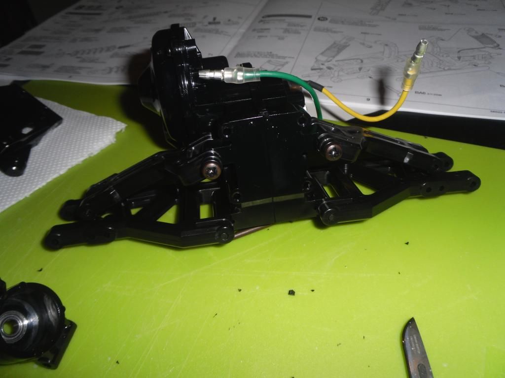

Arms fitted

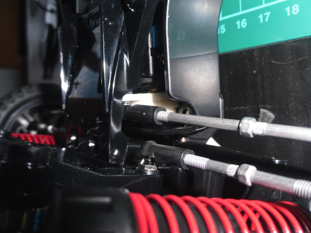

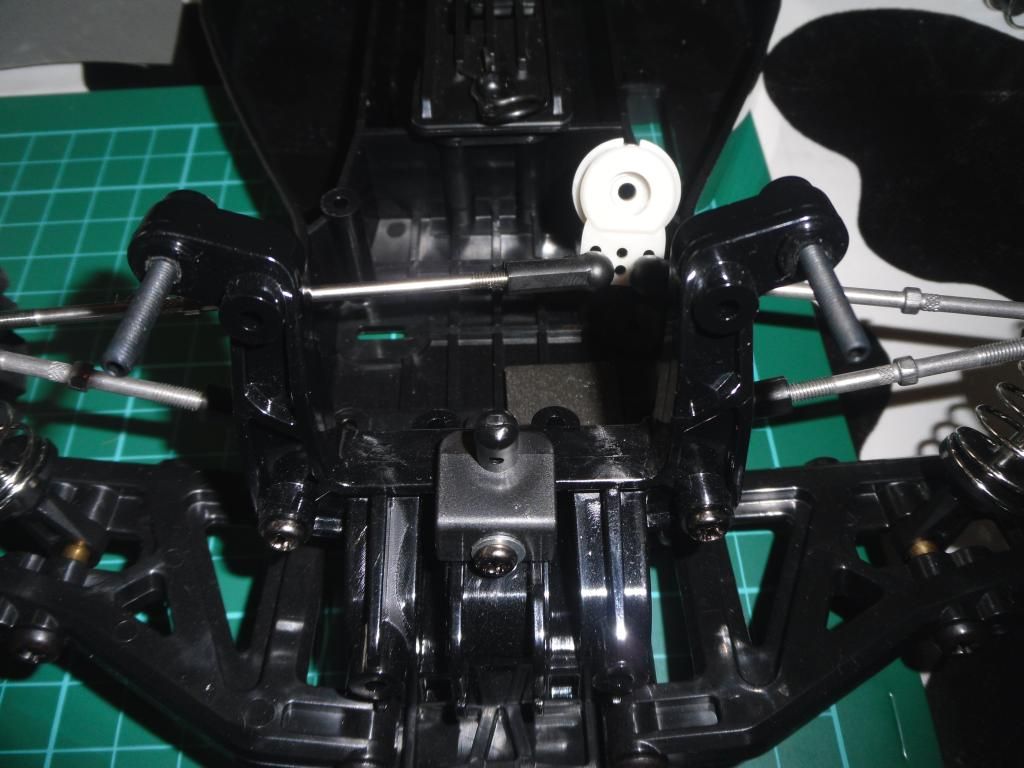

Steering arms measured

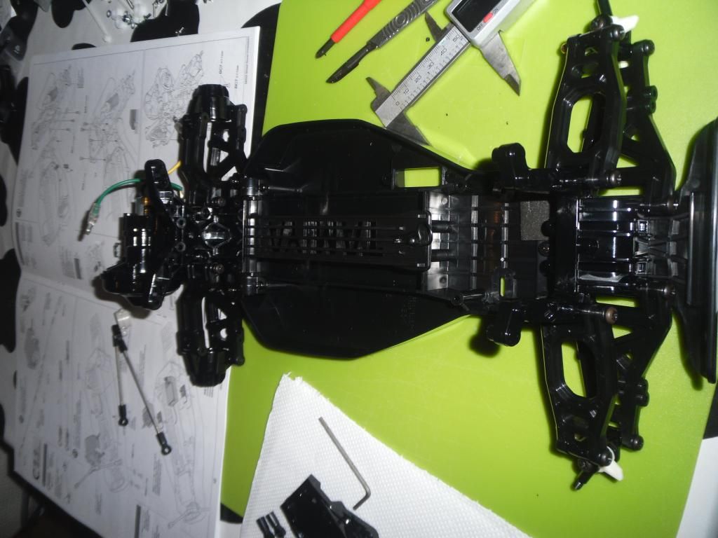

Front just bolts to the tub as one unit
As does the back

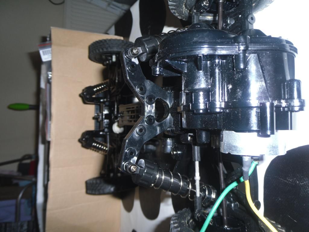

Found instructions for fitting for motor and got paranoid so it took the cover off and adjusted the pinion a bit

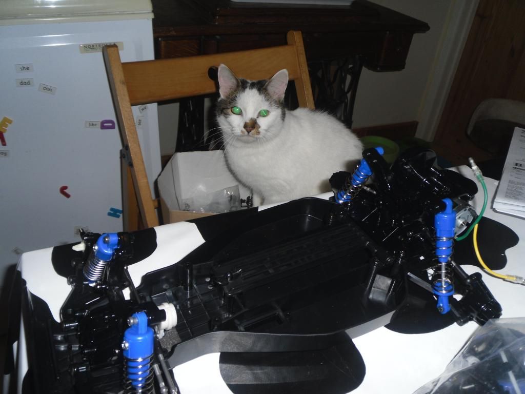

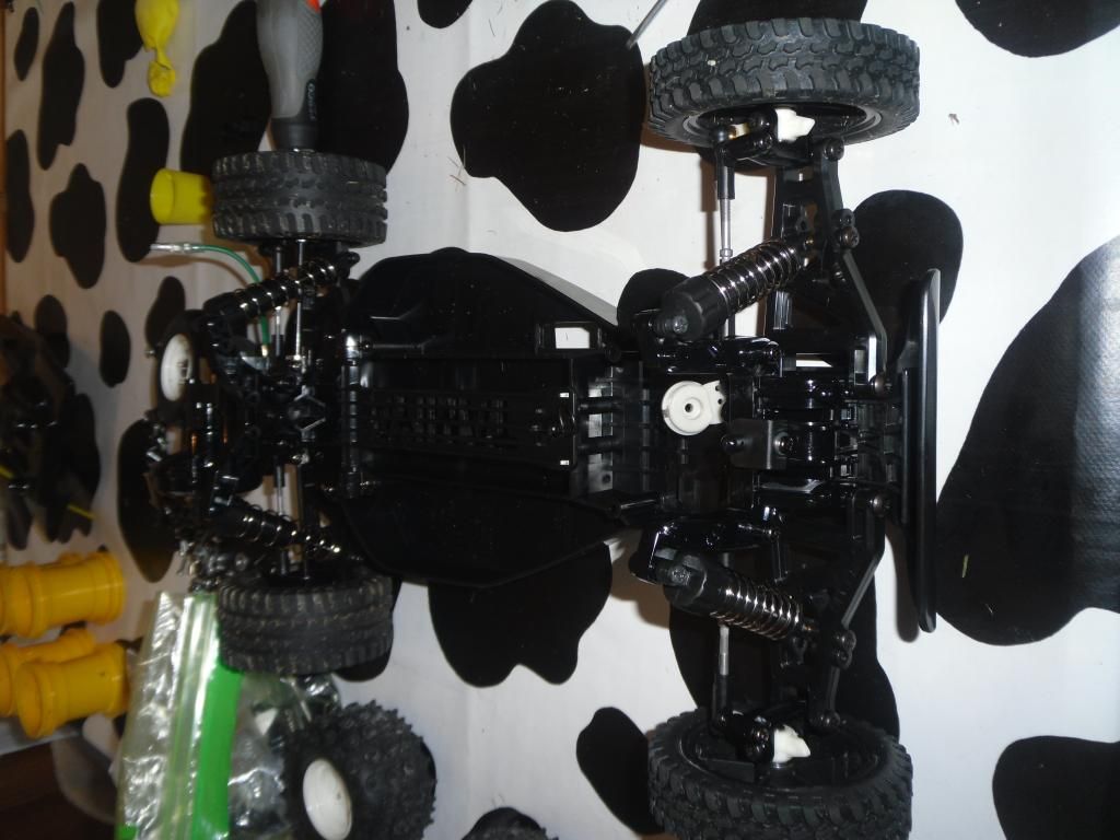

I built the shocking standard "dampers" just to hold the front end up while I build. I had some help from a friend who thinks she is getting a new box
That is it until the drive shafts turn up
The Water Displacement 40 is not a lube but a cherosene based anti humidity product.
It was used to keep water free the nuclear missile launch tubes.
It is a terrible lube for gears, they will shoot it out your gearbox after the first 20 seconds of use. It will evaporate quickly and the gears will rotate without lubrication and you will worn out them.
At the end it is cherosene and your plastics will break in few time.
I strongly suggest you to re-open the gearbox and wash it with dish soap, then you will lube the gears with the ceramic grease that is a light grease made for this purpose that will not leave the gears without lubrication and will not ruin the plastics.
Max
I had the same reaction to the WD40 but after a second look that appears to be a chain wax lube not your normal WD40. I've had good results with a Castrol chain wax on plastic and metal parts so as long as it's safe for use with O ring chains you should be fine.
I'd agree though keep the usual WD40 away from plastics and rubber seals as it'll perish much quicker.
You probably already know but you'll just need the metal dog bones and drive cups that are in a lot of kits like the TL01B, WT01 (Blackfoot 3, Mudblaster 2) to fit the ball diff drives.
Yes WD40 is not a lubricant, great for polishing plastic bodywork though. This is a new product, I got a little can free at the bike show last year. It sprays on nice and leaves a waxy film, it is also designed not to fling off so might stay on a bit longer than ceramic grease.

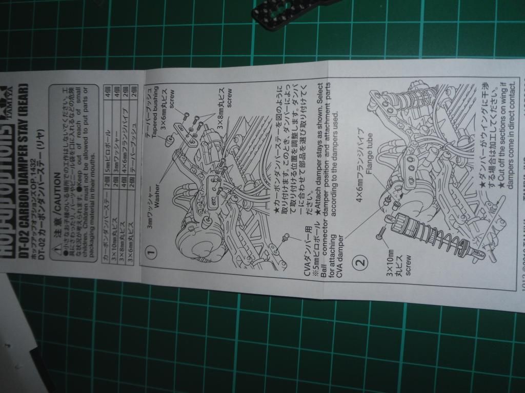

I had some dampers on order for this build but I ordered a DT-03 and it came with CVAs so they are going on this and the shiny ones will go on the DT-03

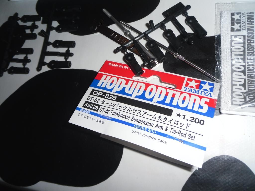

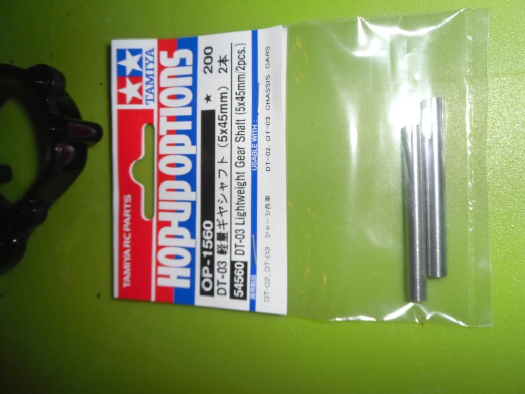

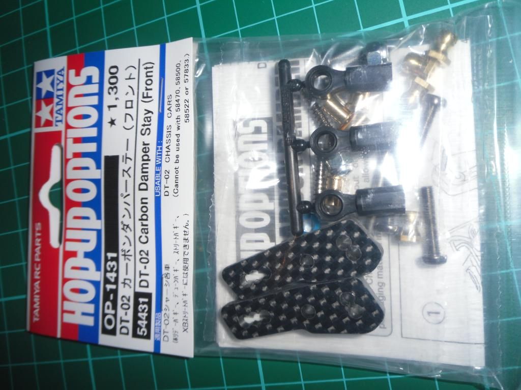

Banzai strikes again. I was browsing for some other bits and ended up with a few Hop-Ups for my "budget" basher, this hobby is addictive.
Before
Instructions are easy to follow
Not a happy bunny with the brass balls, I wish they had used black ones at least

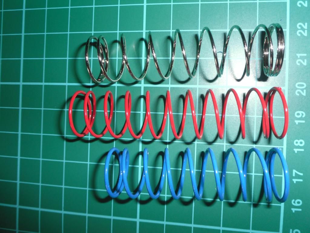

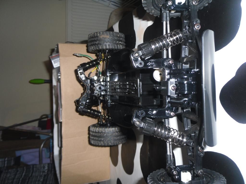

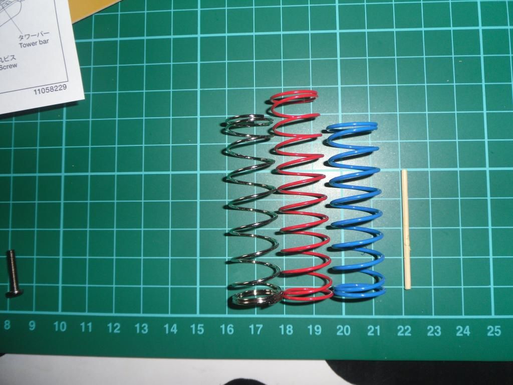

Fitted the soft springs, they were perfect until I fitted the battery. I will have to run it and see
Soft, hard and standard
Added stick. I put them all on the scales and pushed them down to the same level
Soft = 700g
Standard = 750g
Hard = 1kg
Not scientific but it gives an indication

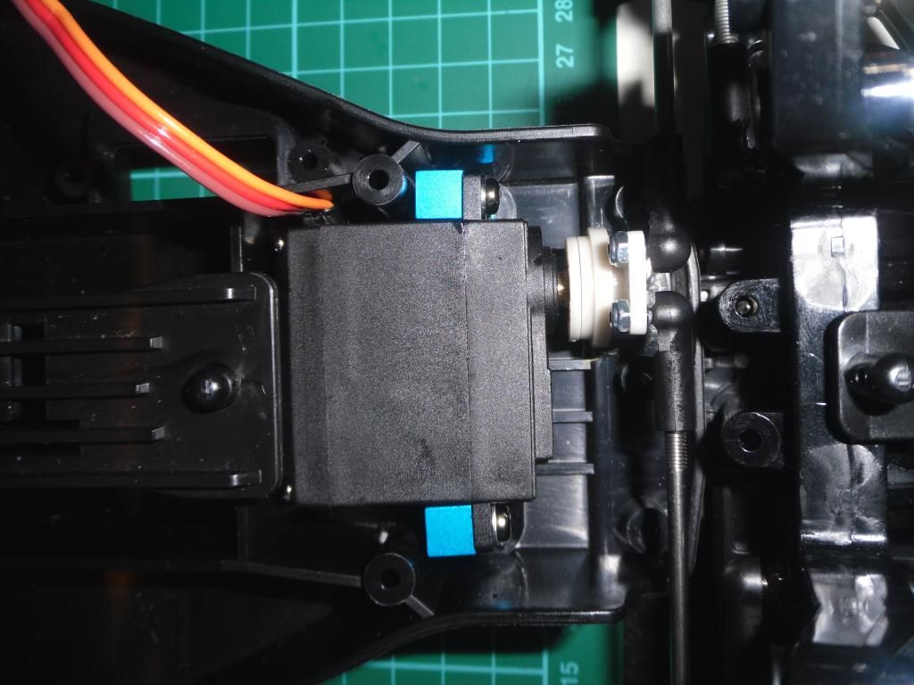

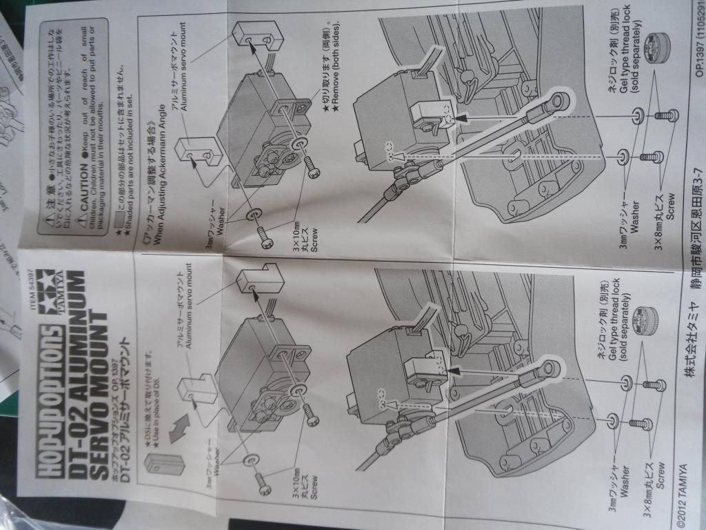

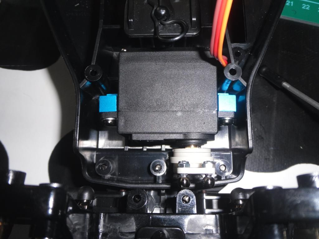

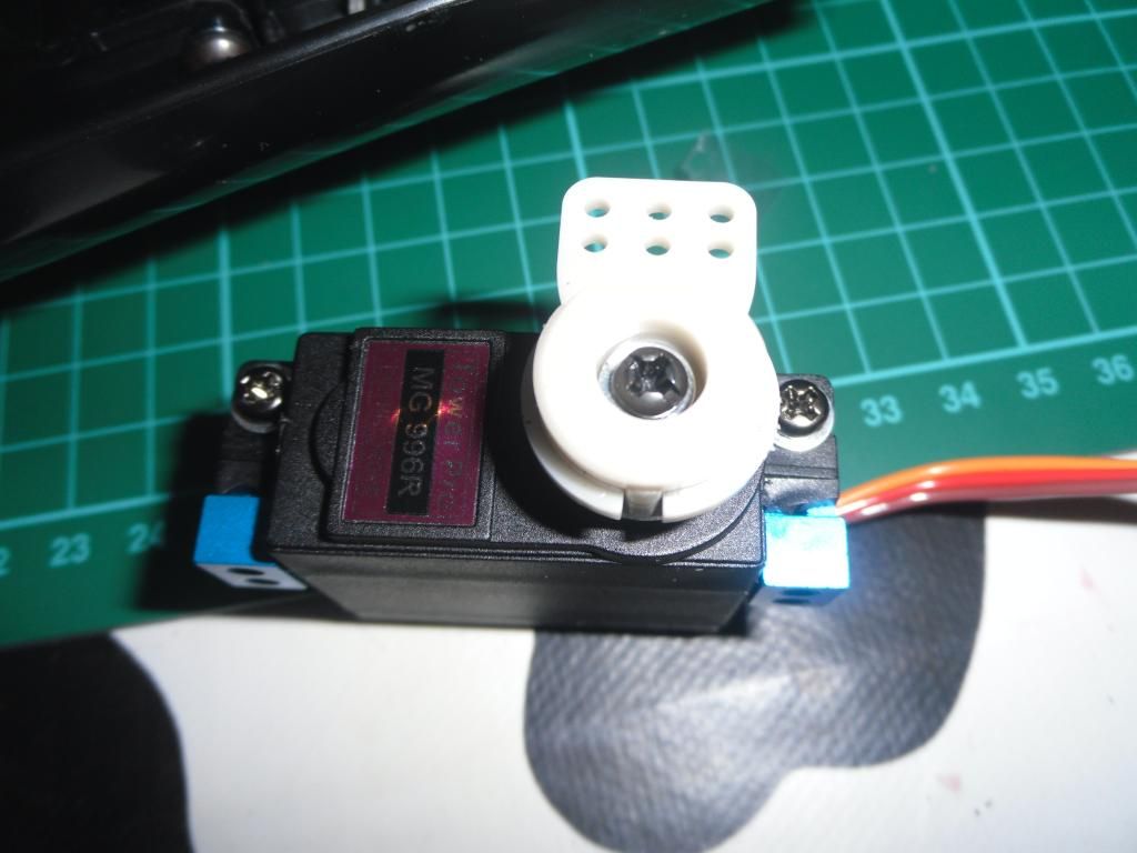

Servo to be fitted

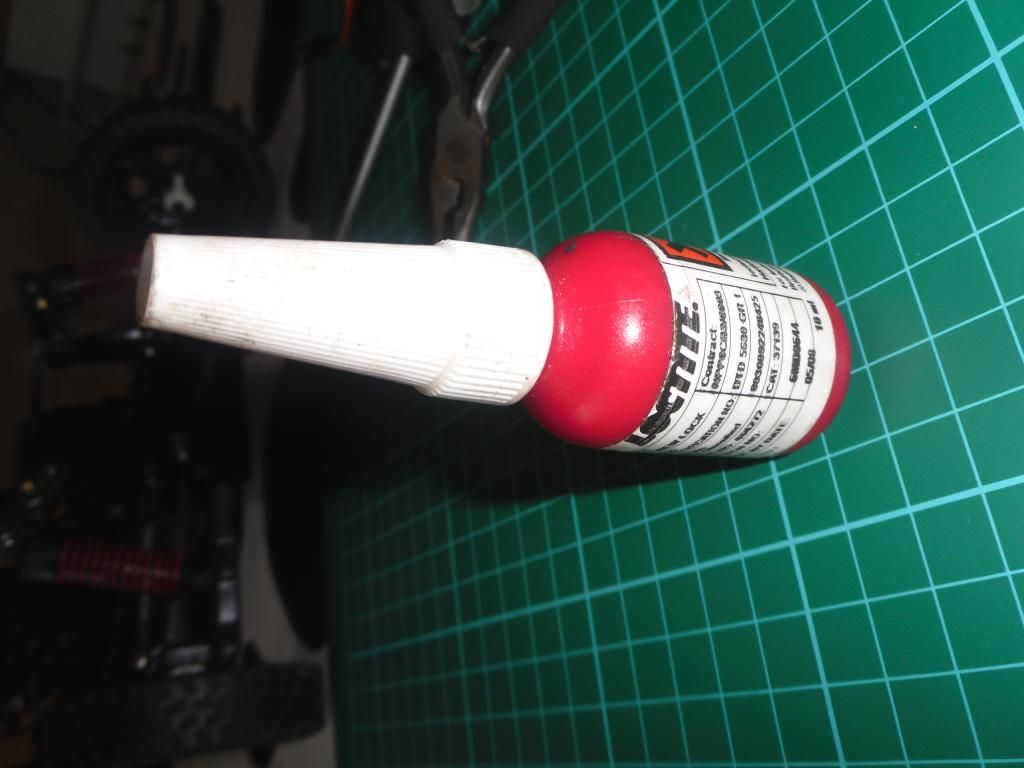

Thread lock not included, I had to use my own

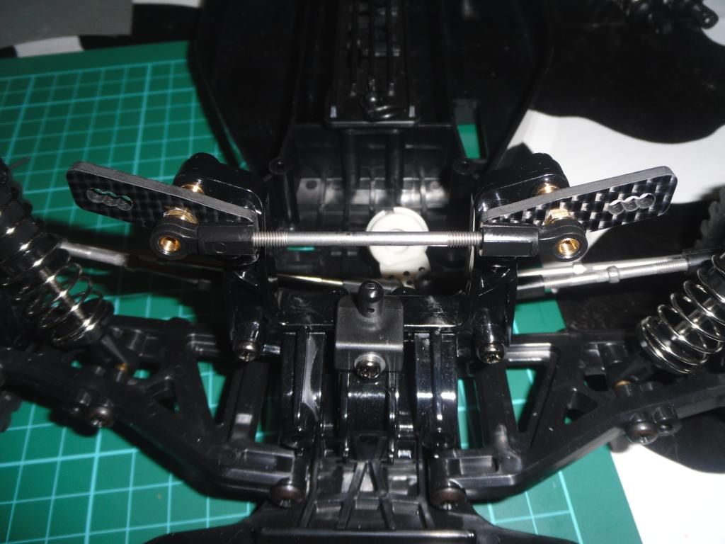

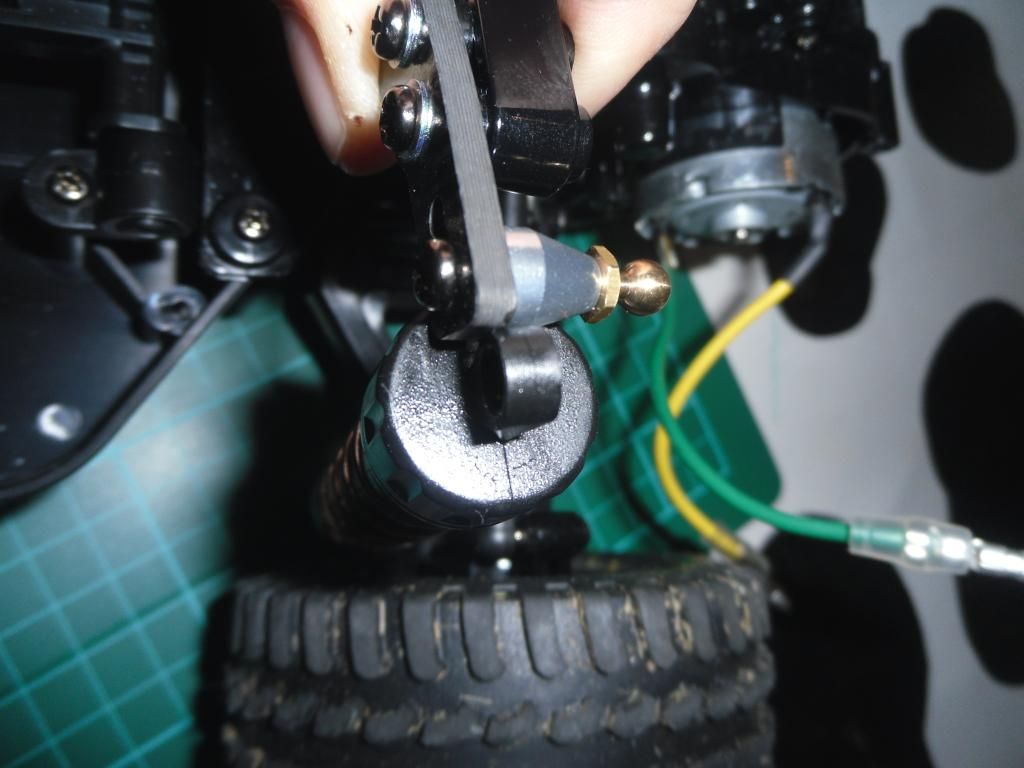

First try and not fitting :-(
A hack and a spin and we are there. This is in the instructions for altering the Ackerman angle, no idea what that is.

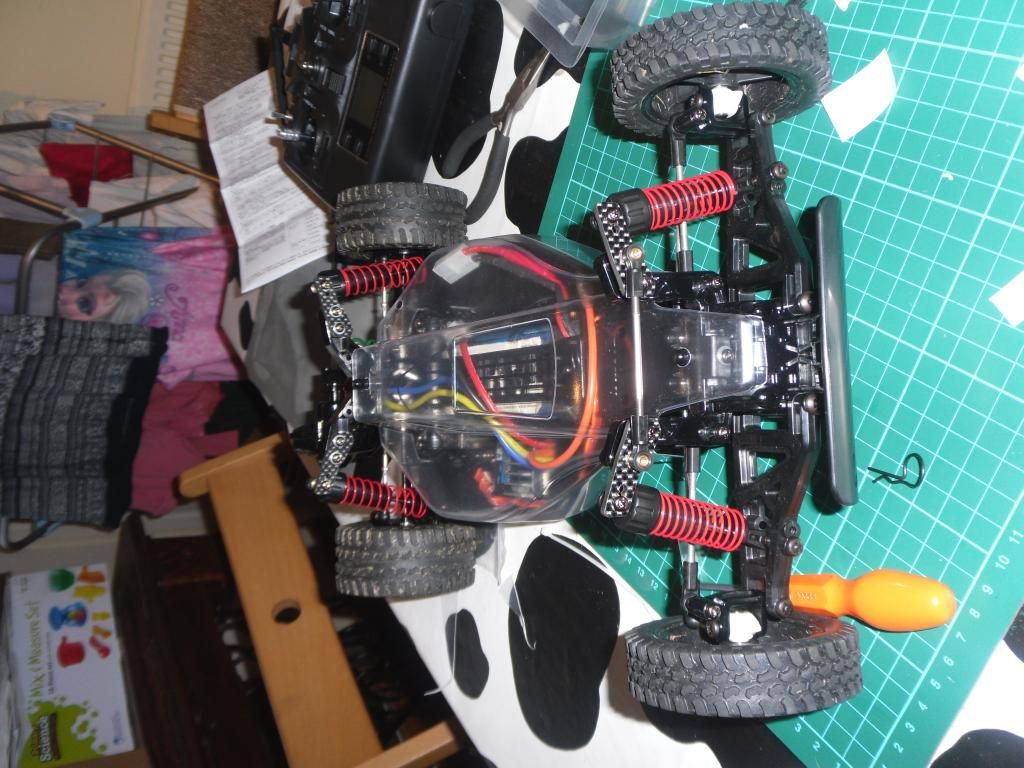

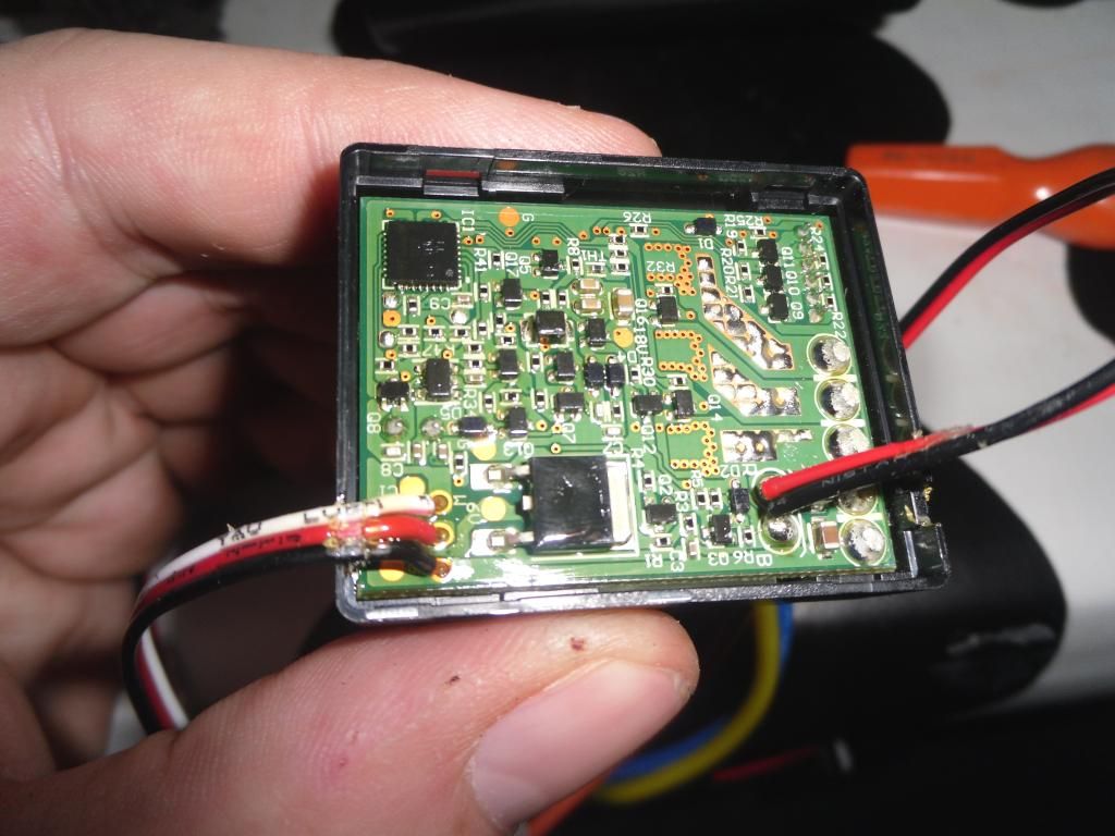

Popped the bottom off the ESC to wire the switch up.

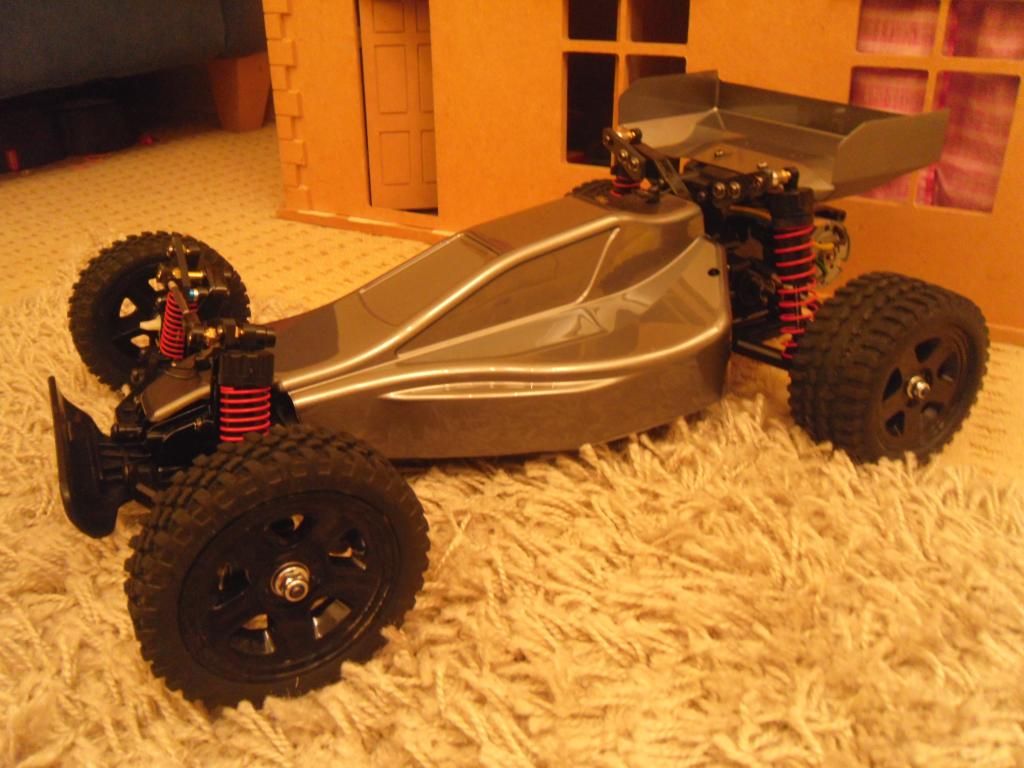

Body trial cut and fitted

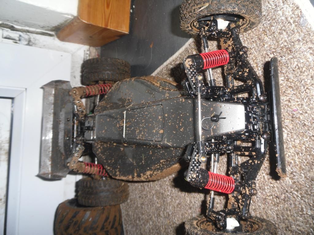

Well today was my first bash.

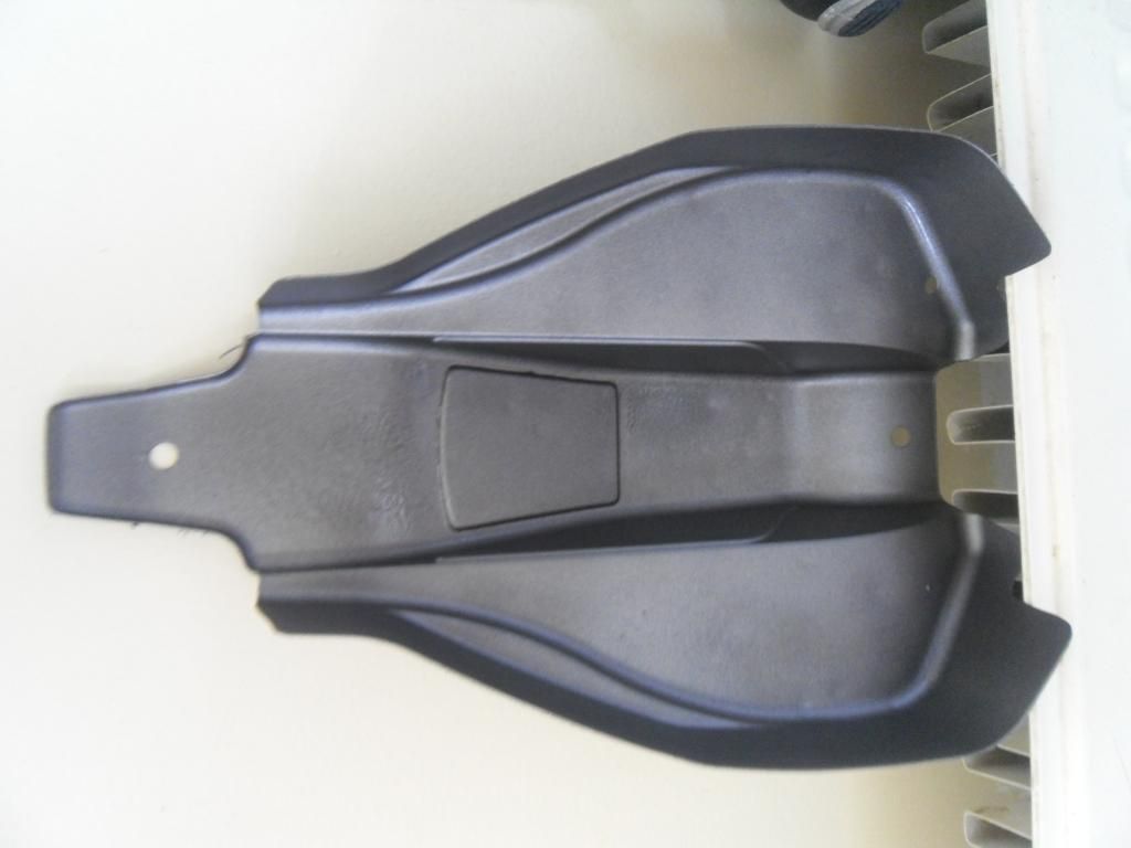

I covered the base in plastic to give it a bit of protection.

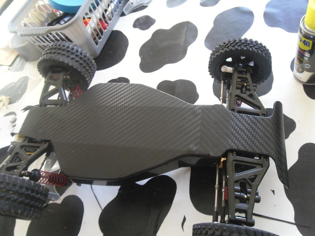

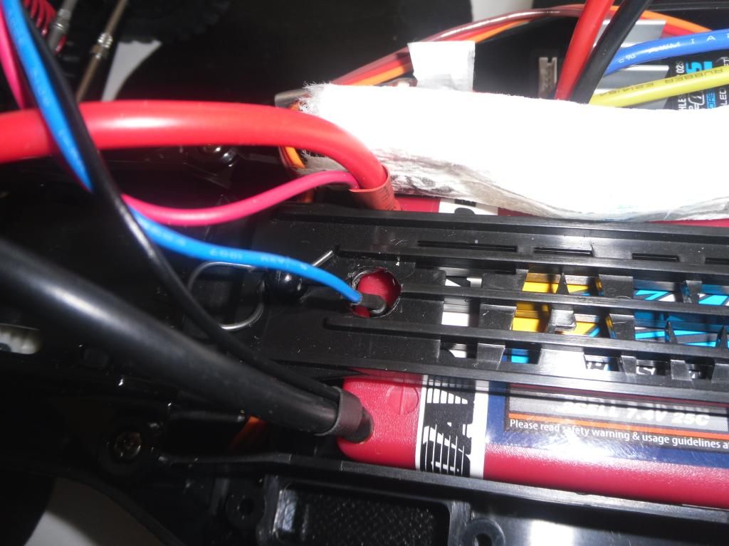

Needed to make a couple of changes to fit a Li-Po pack. Hard to remove a couple of bits from the bottom of the battery tray and add a hole for the balance cable
I cannot believe how fast this thing is and how well it handles, it is totally beyond my skill level. After an hour of hitting everything in sight the protection did its job but now looks a bit tatty
Nice build nobbi. It moves pretty quickly with that torque tuned. What colour scheme have you got planned for the shell?
Not sure about the shell yet, I have an air brush and a few pots so it might end up crazy. Might sound silly but I do not want to do a great job and then not want to run it. The decal sheet I have not got includes black window stickers that go on the outside, I might replicate them in the carbon fibre sticker sheet and then just spray out the inside in one colour.

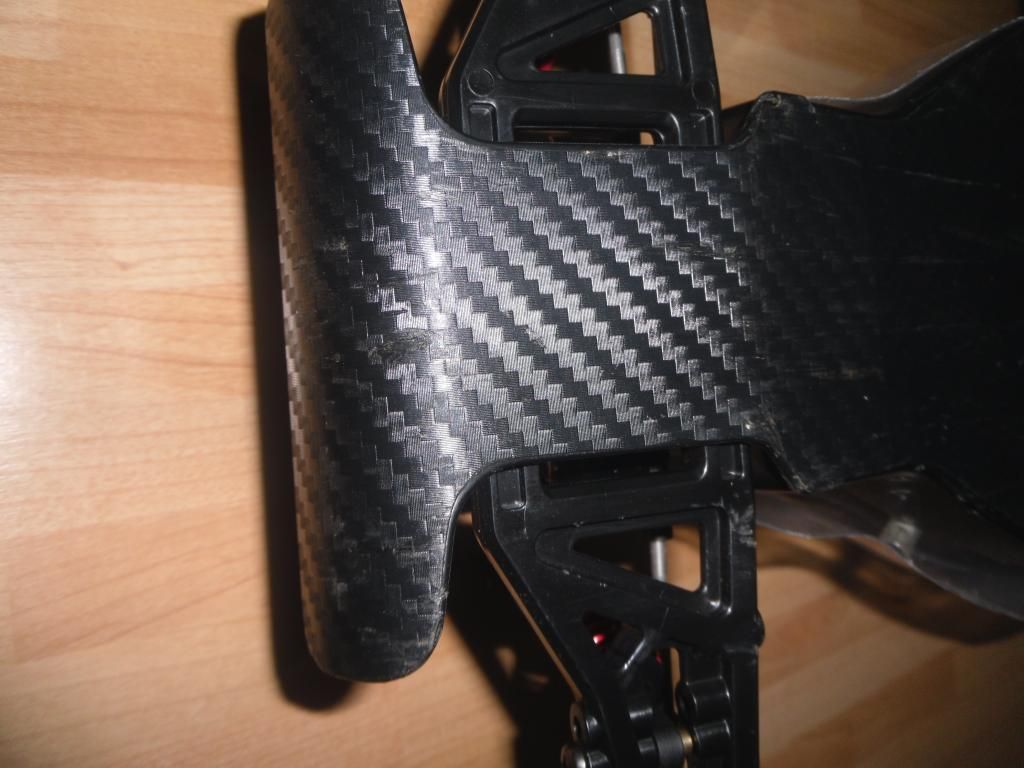

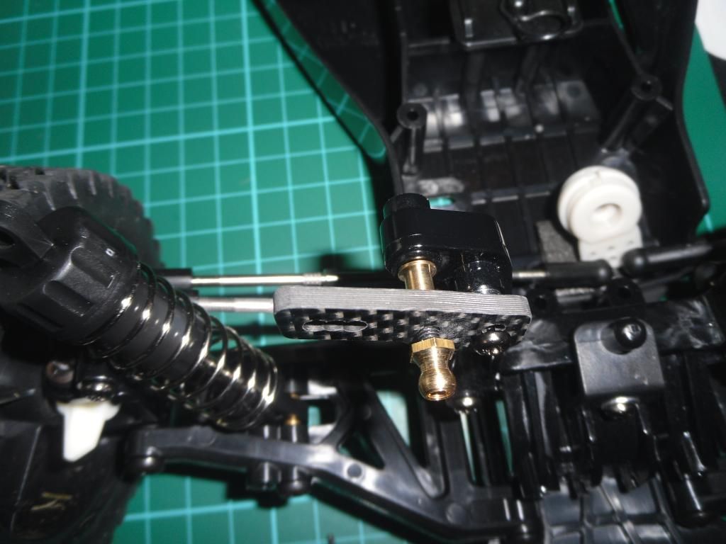

I need to look at the carbon shock mounts as well, they look great but at the first things to touch down when it goes base over apex.
