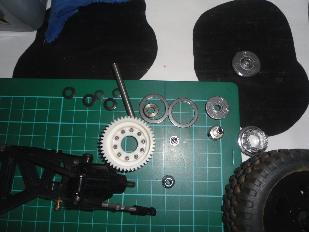

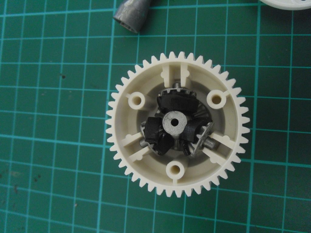

After asking about ball-diffs I released A. I was out my depth and B. I could not see if I had ruined my current one without opening a new one.

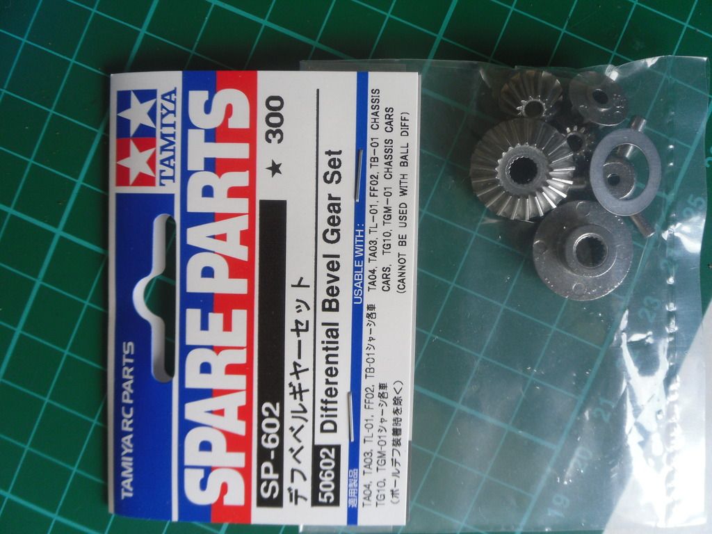

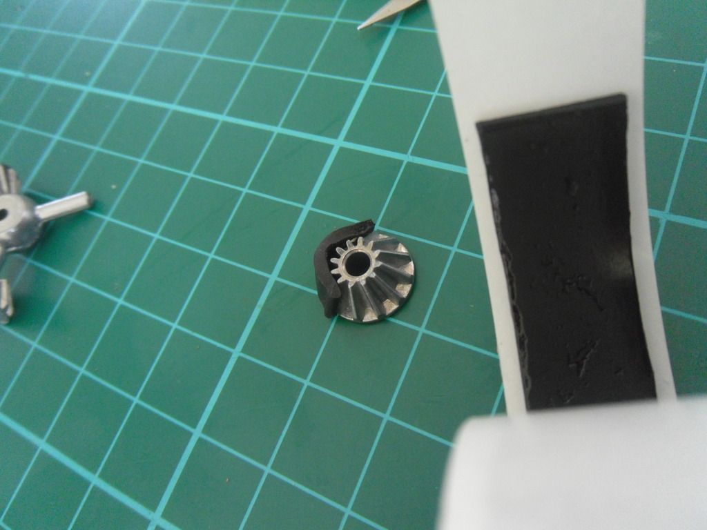

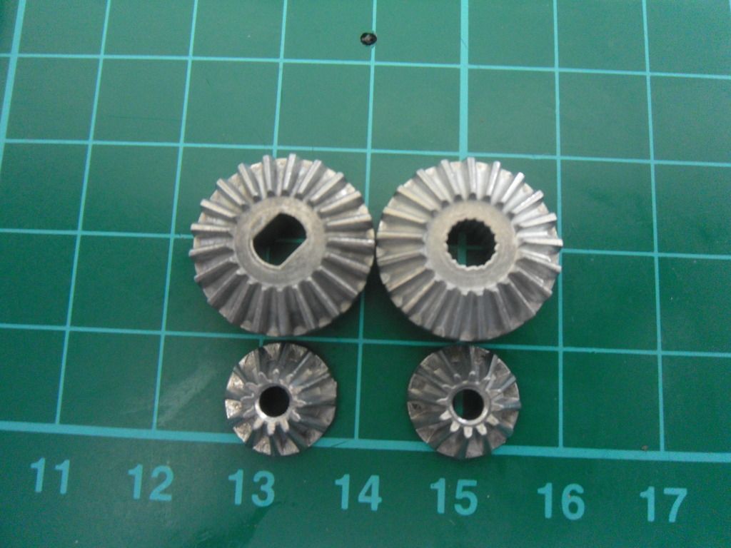

I pulled the diff and decided to to fit a normal one one with a bit of Tamiya diff putty

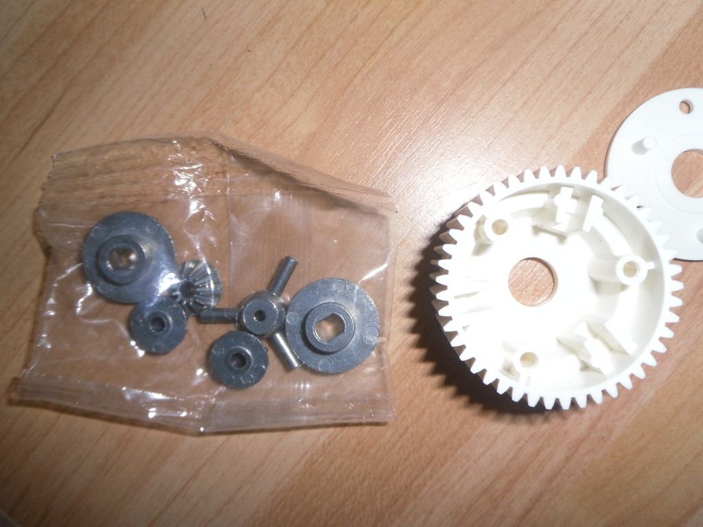

Problem one. The DT-02 comes with a diff that takes square drive shafts. Luckily I had a diff bag waiting for another build.

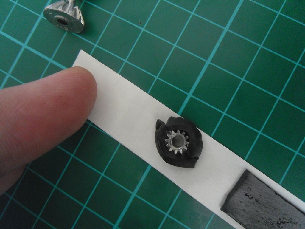

Two bits on each cog seems to be about right

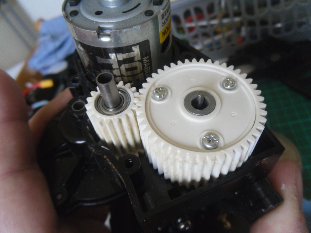

All fitted

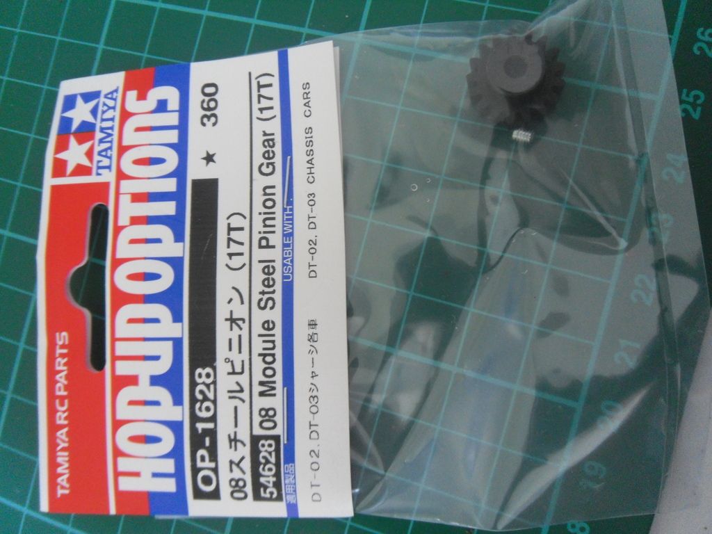

New pinion

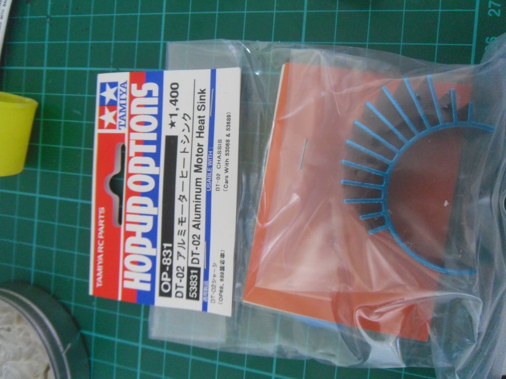

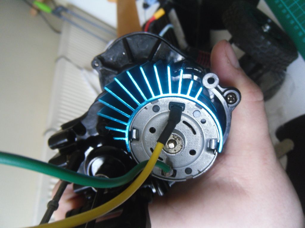

Additional cooling
I followed the instructions but I am not happy with the way it is built. The heat sink spacer ring goes after the gasket on the motor, I think it should go before to allow it it absorb heat.
I agree. I built mine with the gasket between the heatsink and gearbox, with the motor in direct contact with the heatsink, and it worked far better that way.
