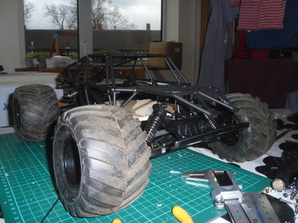

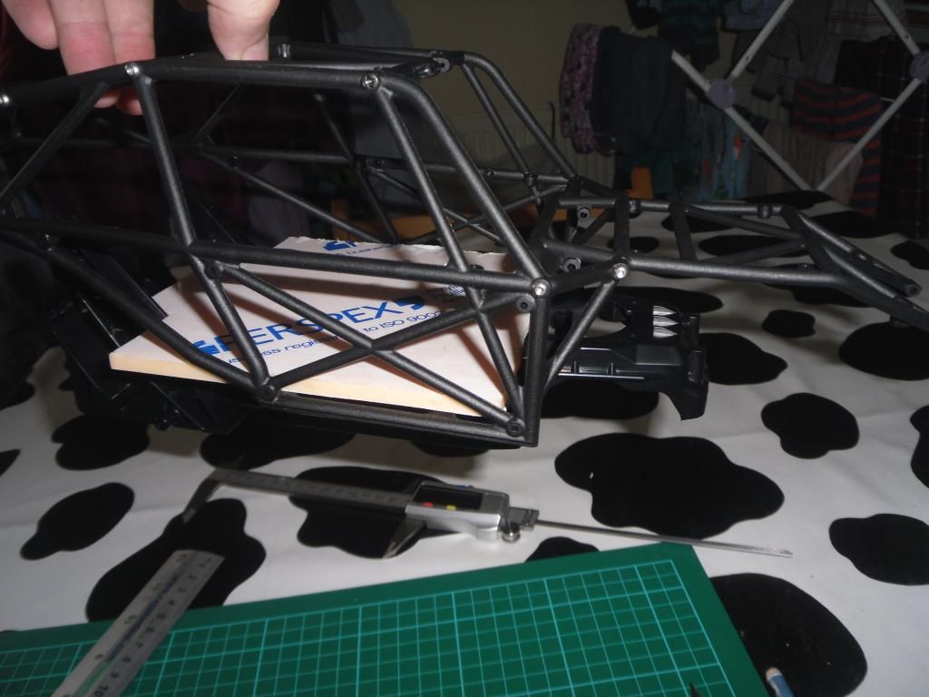

No just sat on. I was surprised what a good fit it was. Wheel base and width are good. Needs some out riggers for the shock towers to move the shocks more upright I think and then some way of mounting it. Lots of playing to be done.

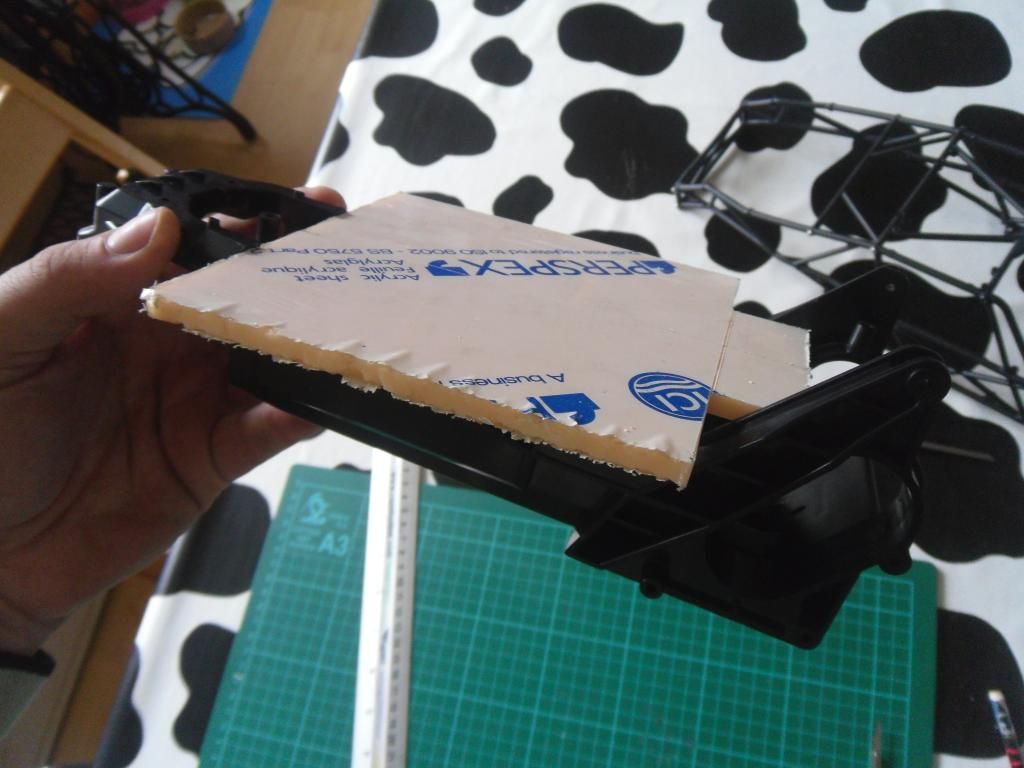

I decided to do a bit more on this, partly to try and create a waterproof chassis.

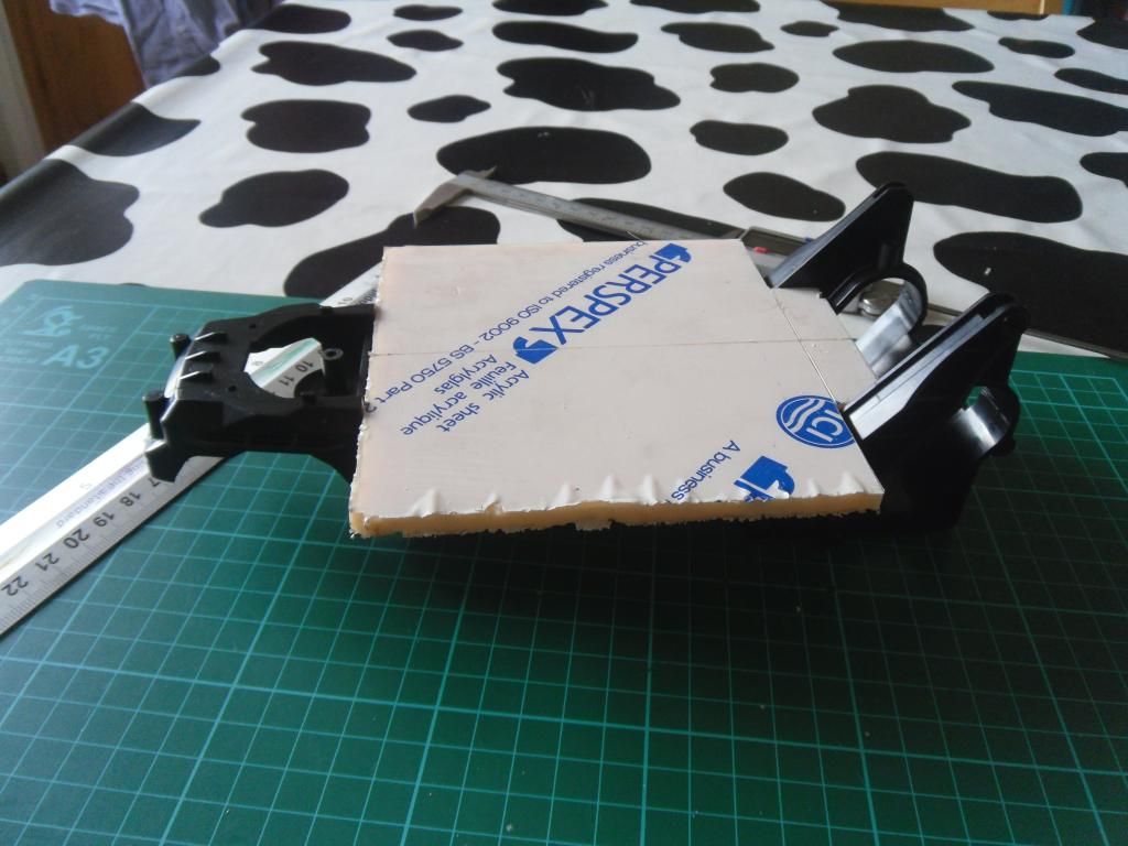

Sheet of scrap plastic from work. Marked out with what I think will fit
Couple of lugs cut off chassis
Almost on the first fit
Slight trim and we are there
Body test fit

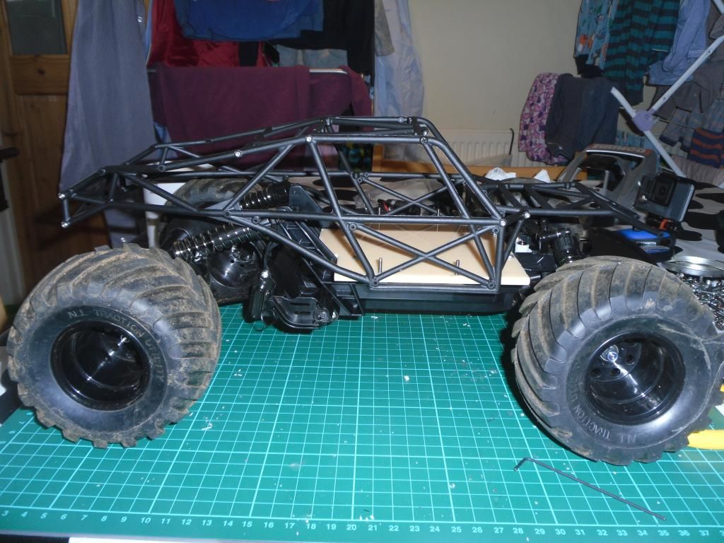

The main purpose of this is to be a camera car for my Go-pro, the cage should offer some protection

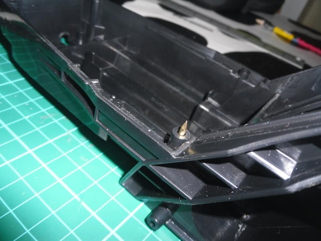

Half a nail to find the screw holes
Test fit, one hole is slightly oval to get it all tight
Body bolted to base. I can leave the body on the base and just remove the base if I need to get to electrics.
Camera test fitted again
Loads more to do but I think the basic project is sound

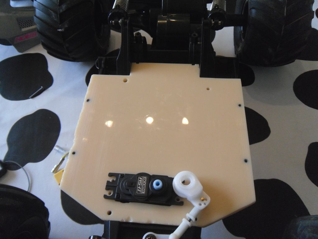

Couple of new pics

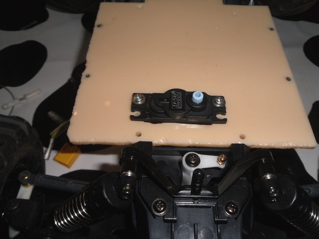

Base tray almost finished and servo in. Need a bit of silicone now to waterproof it all

That looks great. The dimensions of the cage make it look like a well-proportioned, larger scale car. Really impressed so far. Might have to try something like that with my mad bull too.
