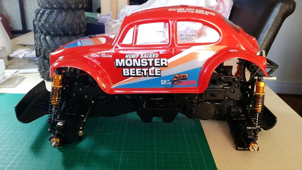

Just looking at your ride height measurements I think you'll be fine at 55mm ride height. Mine with 103mm shocks was 60-65mm ride height which made it barrel roll, you could be ok. Have you measured those shocks eye to eye to see if they come up at 100mm or shorter?
Hi nito. Measured the shocks eye to eye today. They measure approx 100mm when off the ground but approx 95mm eye to eye under the weight of the car when on ground. Still not tested the roll yet. With the snow it won't give a true indication of its handling plus it's slushy and I haven't protected the electrics yet. Soon though, I'm itching to test it. Preferably in the dry with no snow.
Edit : After its first run it felt great :) . The new shocks took the bumps and jumps really well. I tried to test the shocks to the limit as nitomor mentioned that they can roll easier with the larger shocks. I tried hard cornering and running at full speed into brake turns on grass and a paved area but it stayed on all 4 wheels and didn't roll. Obviously with more powerful motors or lipo power this would be tested further but with a standard 540 and nimh power the shocks handled the car brilliantly.

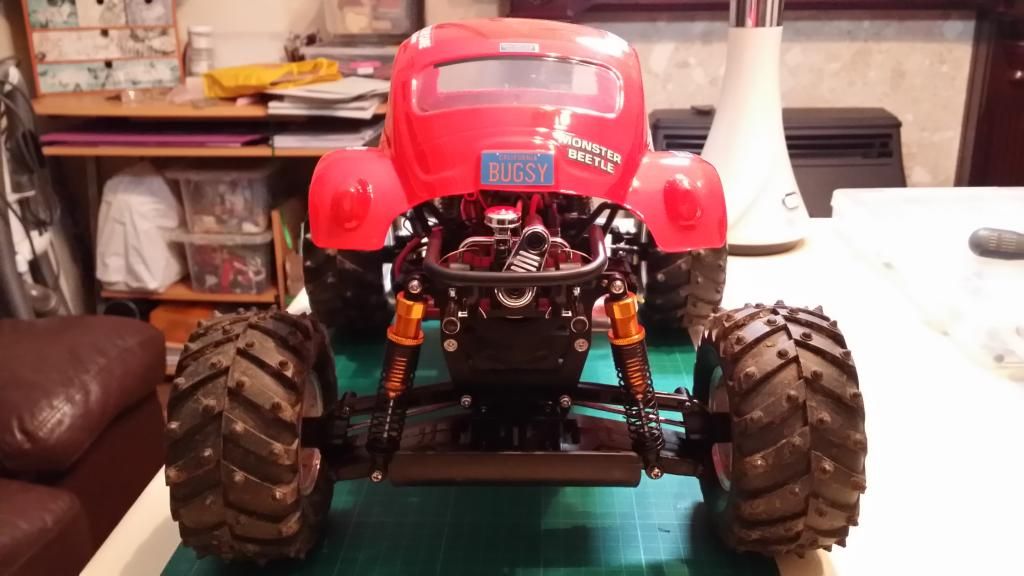

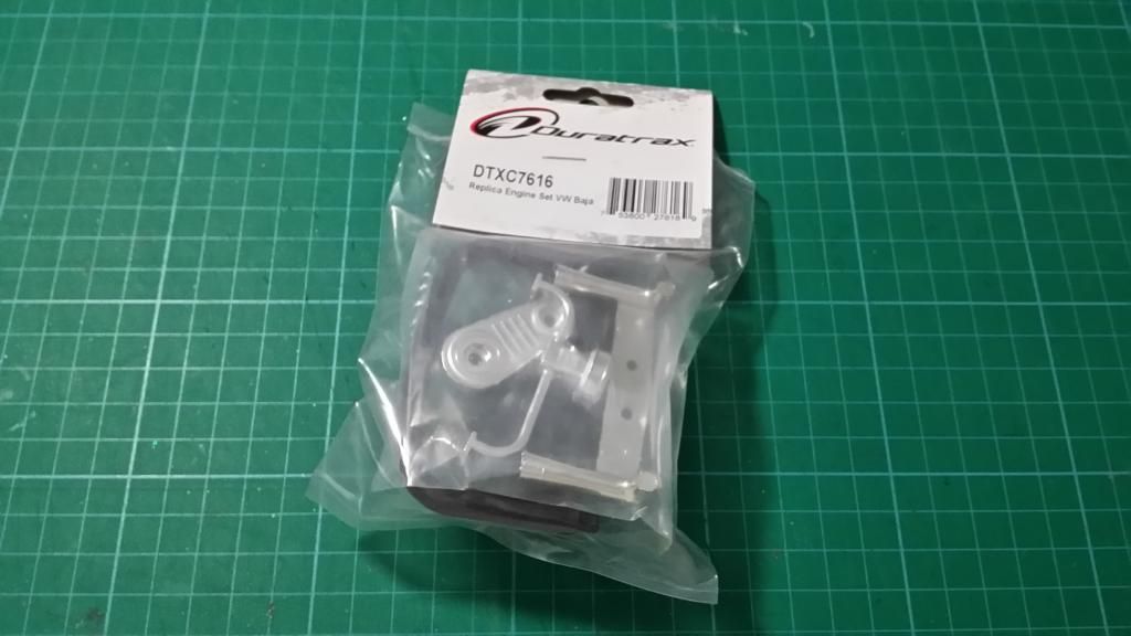

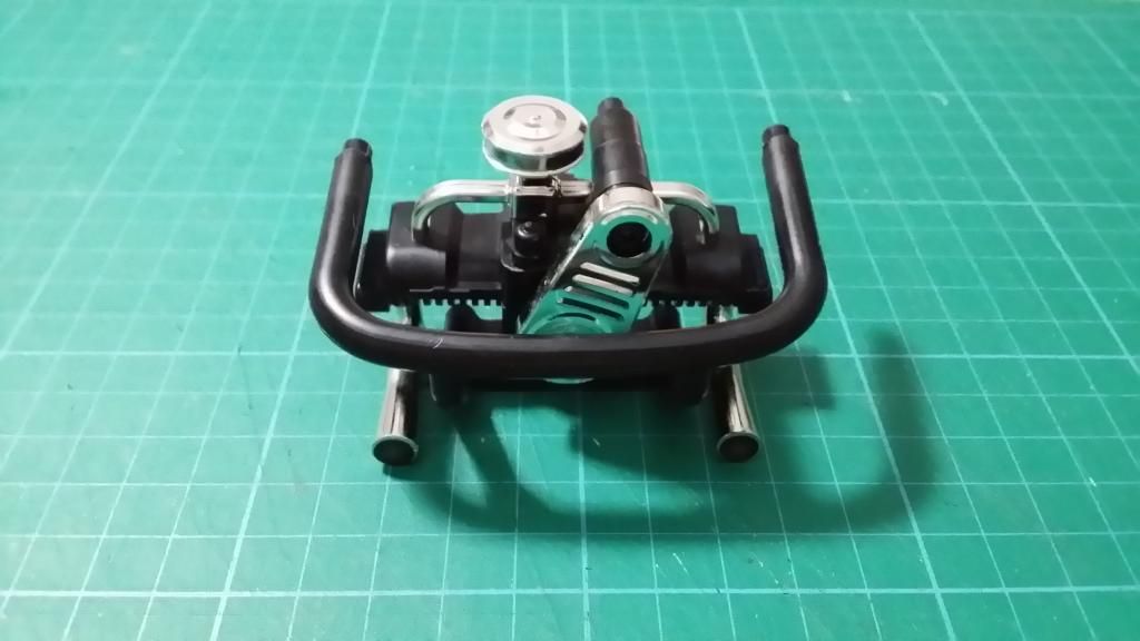

Hi guys just another quick update. I never liked the gap between the chassis and the shell at the rear. My plan was to make a piece up at the back replicating the original monster beetle rear extended bumper which has the words 'MONSTER BEETLE' on it in large graphics. I think it was mr crispy that suggested a duratrax vw baja engine would look good in that gap. I looked into it a found a thread were bromvw and mr crispy were discussing it and it had some great pics too so I had to get one. :)

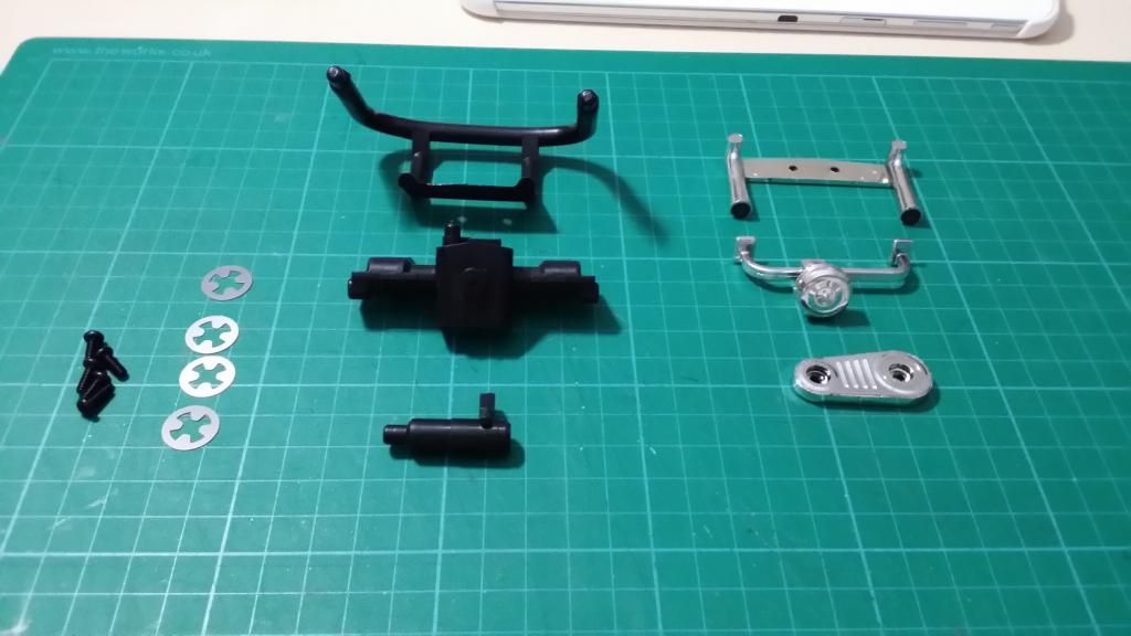

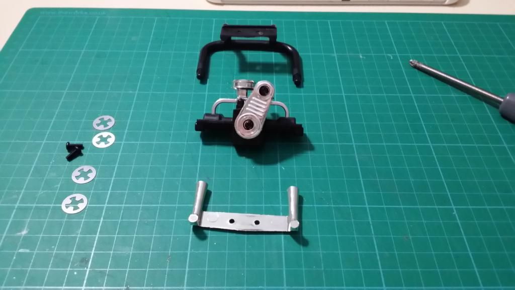

Here's a few pics of it packaged up and through various stages of build. There are no instructions but looking at the pieces it's pretty easy to put together.

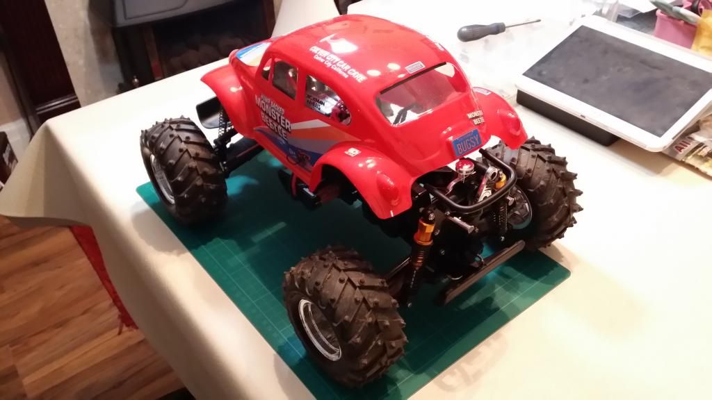

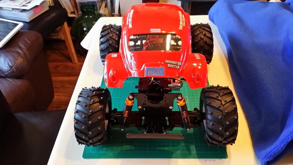

I fit the new engine onto the chassis and was really pleased with the result. It fills the gap nicely :) . Here are some before and after pics.
Before vw Baja engine
Engine fitted
Before engine fitting (rear 3/4 view)
Engine fitted (rear 3/4 view)
Think it looks much better at the rear now. It's only a basher vehicle but there are just a few things that I'd like to change and I've got a few more lined up. If anyones thinking of getting a duratrax engine I definately recommend them. They're a nice bit of kit.

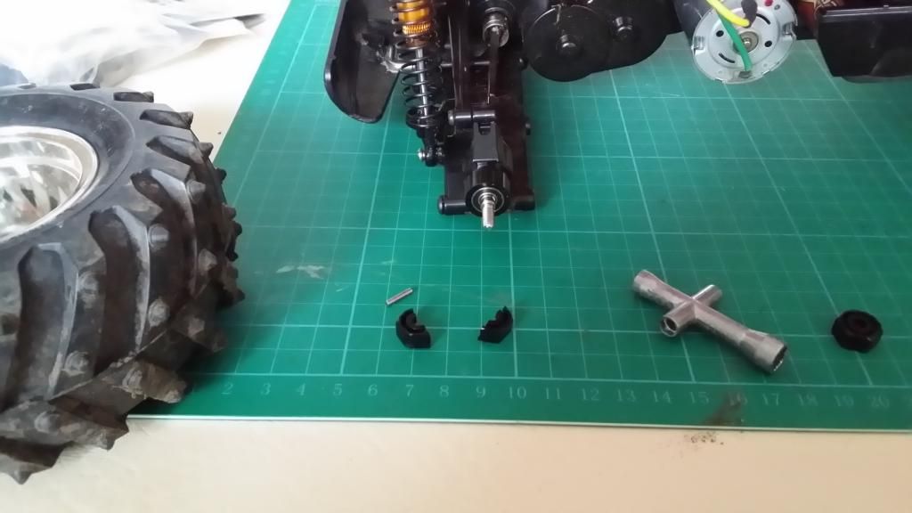

I've done another couple of mods and additions recently. I made a post about hex drive nuts as after it's first couple of runs and less than an hours run time I took the wheels off and one of the rear plastic hex drive nuts fell in half. It hadn't had a large impact and with the plastic being brand new I was really surprised it happened. Feedback in that post came up with a few reasons why it happened.
Firstly it was freezing outside and apparently it can make them prone to cracking. Secondly a lot of sideways action can put a strain on them as someone said it happens on drift cars. I had been testing it by turning at full speed and also doing full speed brake turns to see if the larger dampers would make it barrel roll (they didn't :) ) . And last but not least I could have tightened the wheel nuts too much forgetting that it's only holding a plastic wheel on :rolleyes: . It could have been one of the above or any combination but it's not the most expensive part to replace and it's part and parcel of the hobby.
Split hex nut

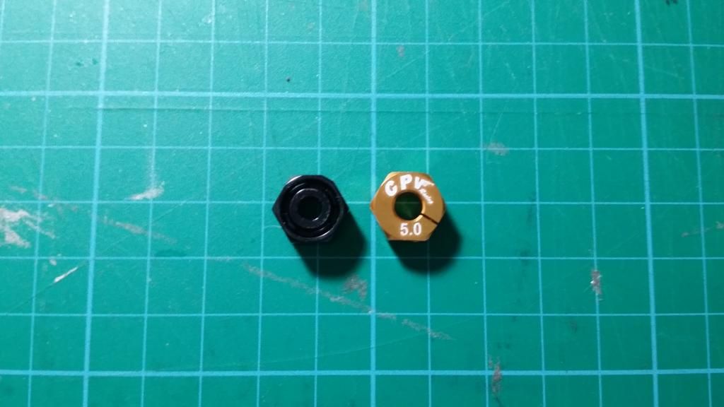

Here's the comparison of the old plastic hex nut to the new aluminium one

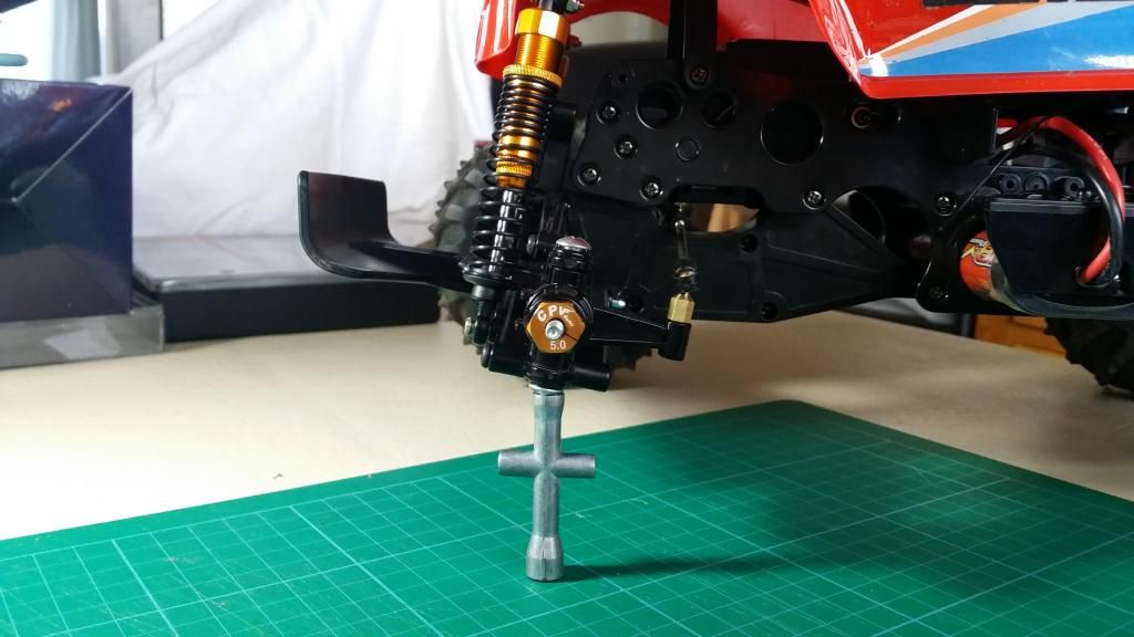

All fitted. Found another use for the tamiya hex spanner. It's like a mini axle stand. :)
I shouldn't break these, plus I think they look nicer too. :)
