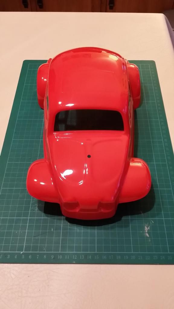

Not sure what was used on the car you linked to, but talking from my experience, the Tamiya PS-34 Bright Red I used on my polycarb Hotshot shell is very close if not identical to the TS-8 Italian Red that adorns my hardbody Pajero.
That's the one I used Rich tamiya PS-34 bright red polycarb paint, the one that xv mentioned. One can should be enough but I got 2 just in case and did many many coats to get a deep finish which you can't see through.
Here's a pic when it was just finished and the nearest to how it looks in real life without any decals...

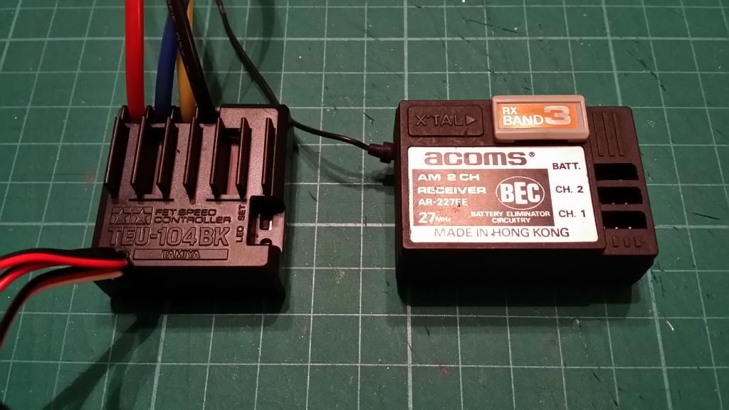

So I thought I'd bring myself into the 21st century and update the electrics on the car. This was the first time I'd used an electronic speed controller so even the little tamiya 104 esc seemed good to me :lol: .

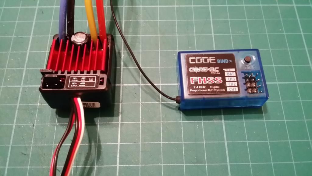

I wanted an esc which allowed me to use lower turn motors and was waterproof so I went for the 1060 quicrun esc which can run a motor down to 12t and is waterproof and dust proof, nice! Id heard good things from other members too. At the same time I needed to update the radio gear so went for the code 2.4ghz gear as it wasn't too expensive, had a 15 model memory for the fleet I was building up and was a stick controller.
Old gear....
New gear....

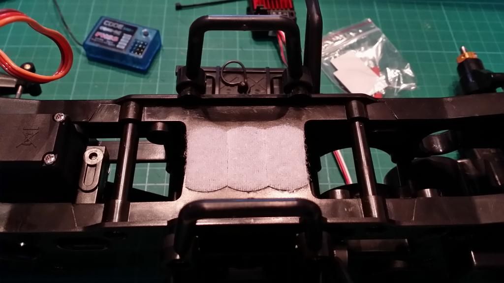

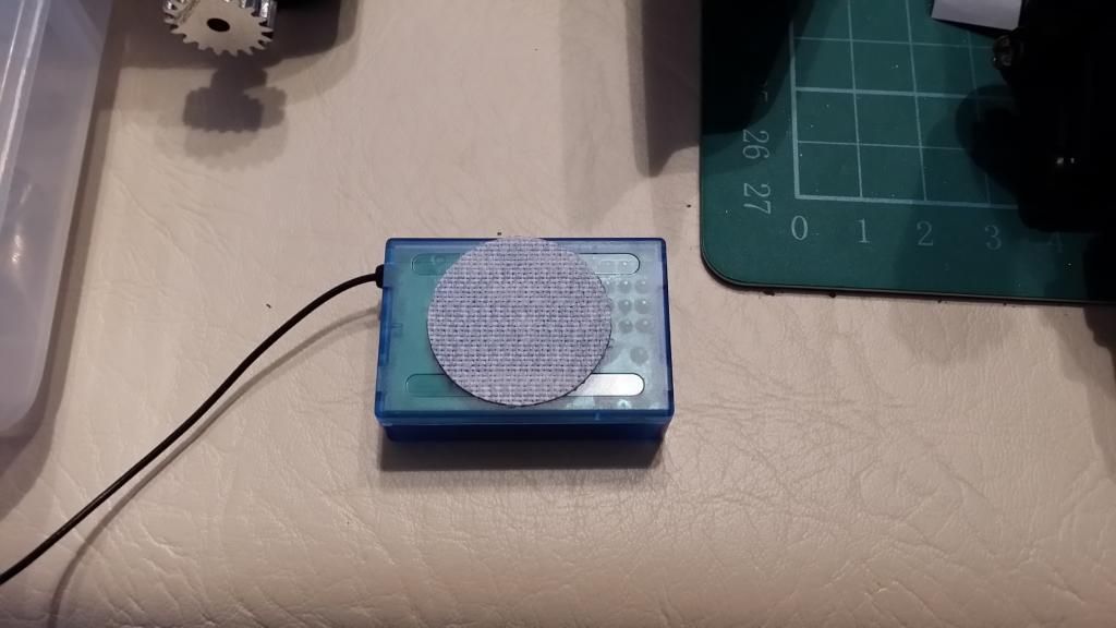

I decided to attach the receiver and esc with velcro pads so that things can be swapped out really easily. I think I'll do this with all my rc's so I can chop and change between models without much fuss.
Velcro pad on chassis....
And one on the receiver. I did the same to the esc.

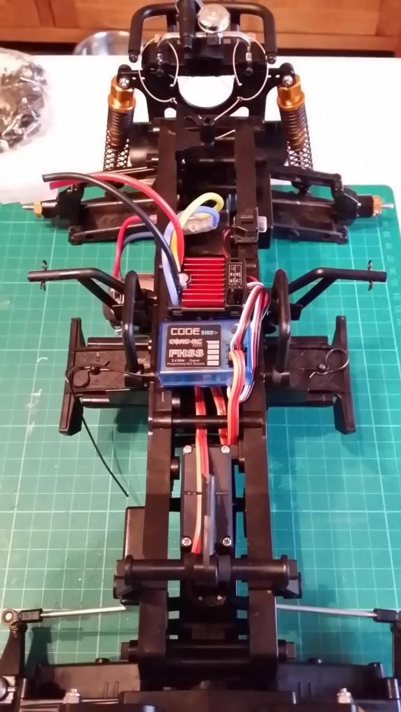

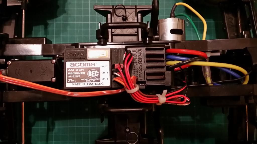

Here it is all mounted to the chassis and ready to go.

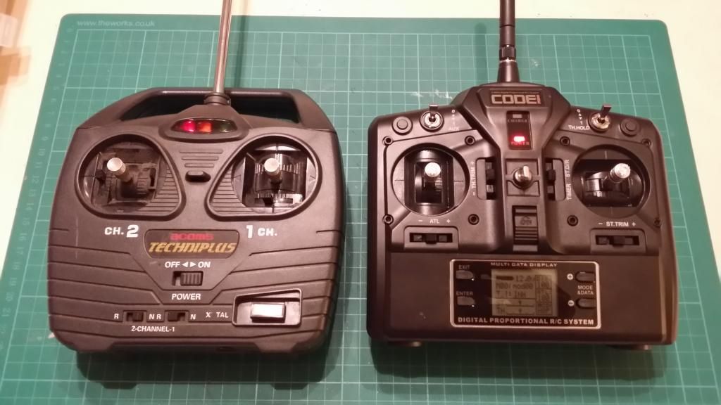

Old 27mhz with the new 2.4ghz transmitter. They look similar but the code has so many options that you can play with. Plus you don't have a huuuge floppy aerial! :D
