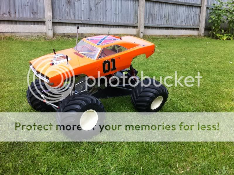

I just set my Clod up with twin TowerPro 11.5 motors, £17 each from Giant Shark. http://www.giantshark.co.uk/product/170119/towerpro-brushless-motor-bl540st-115t
I run them on two TBLE-02S ESCs which are also cheap, in fact I had some lying around that came with some other Tamiya kits. They can be bought new for £17 too, making the total system cost £68. This is a pretty nice combo for the Clod, great torque, superb brakes, good top speed but not mental and smashing up the chassis either. With sensored brushless systems like this it's important that the internal mechanical motor timing is set to zero or at least can be. That can't be compensated for in the ESC.
10929940_10155059976365167_7230105798028
providing they go the same speed in both directions. How quick is it?
It's not fast compared to a buggy but there's enough power to do wheelies with a full charge and stoppies under breaking. If you're driving on bitumen you have to take it a bit easy actually !
