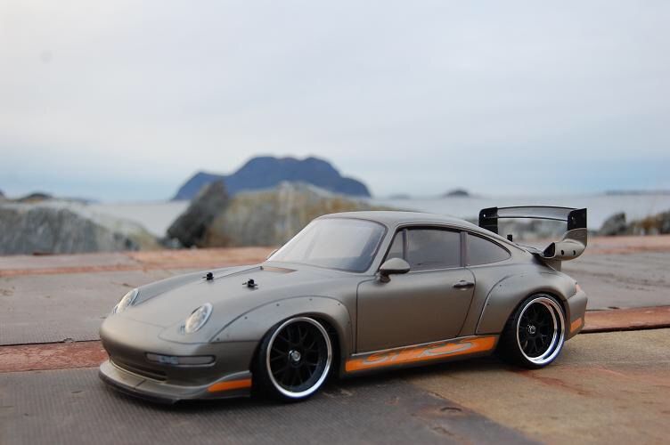

This is nice color too, found on the net so we can get an idea how matte brown/graylook like.
Ohhhh no, I think I got the GT2 bug.. I need to get couple for different paint schemes
Fantastic paint job

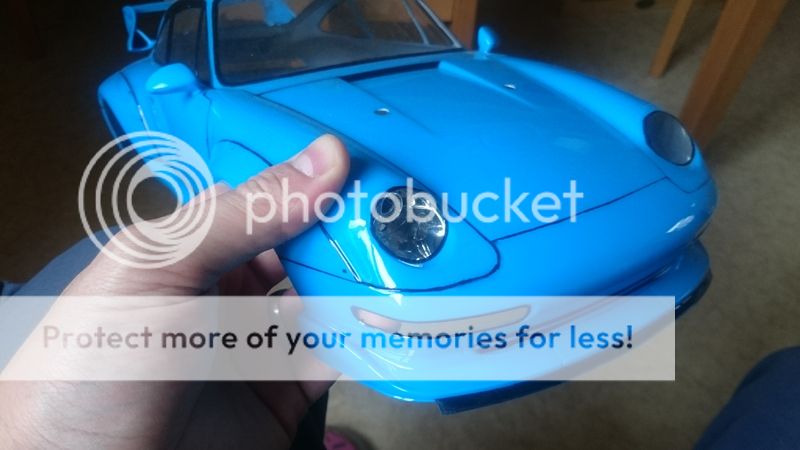

I know some people were interested in seeing what the 997 light buckets looked like so I took this rather terrible picture:

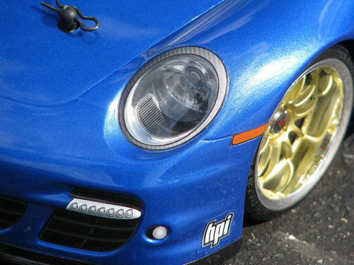

Very nice - here's an HPI
