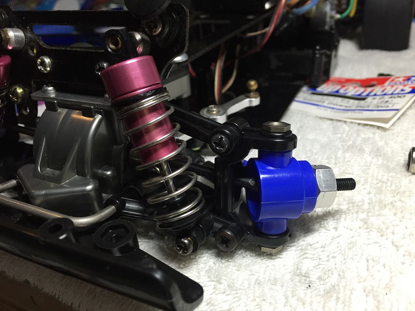

For those interested in a rear stabilizer bar, the OP-189 can be used. It isn't designed for the SW chassis because the bar itself is too short. But, I was able to use the stabilizer bar from OP-676 for a TA04 and it looks like it will work.
I chose the softest bar for now until I start running it.
