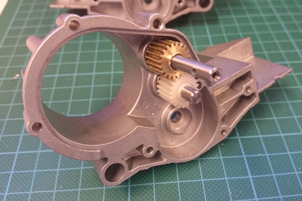

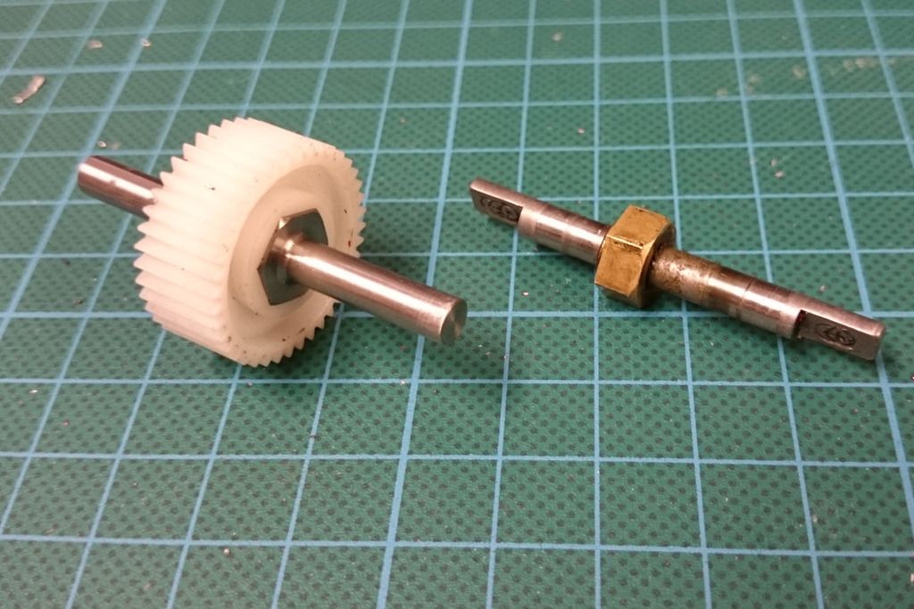

Hi guys, I'm currently building a scratch build scorcher and thought I'd show you how far I have got so far. I started with the gearbox. All the shafts have been made from titanium. The final gear drive shaft is now a one piece titanium shaft too.

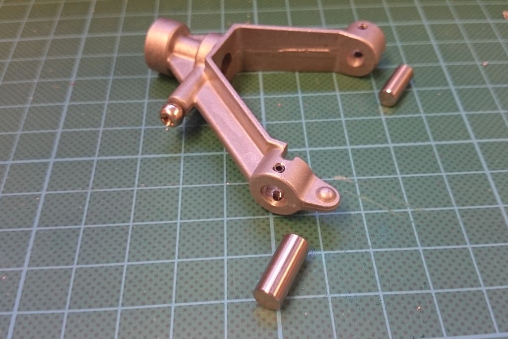

The driveshafts are also made from titanium, as are the hinge pins on the wisbones

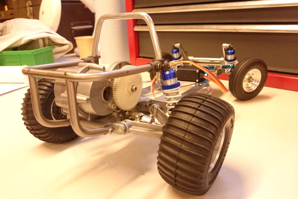

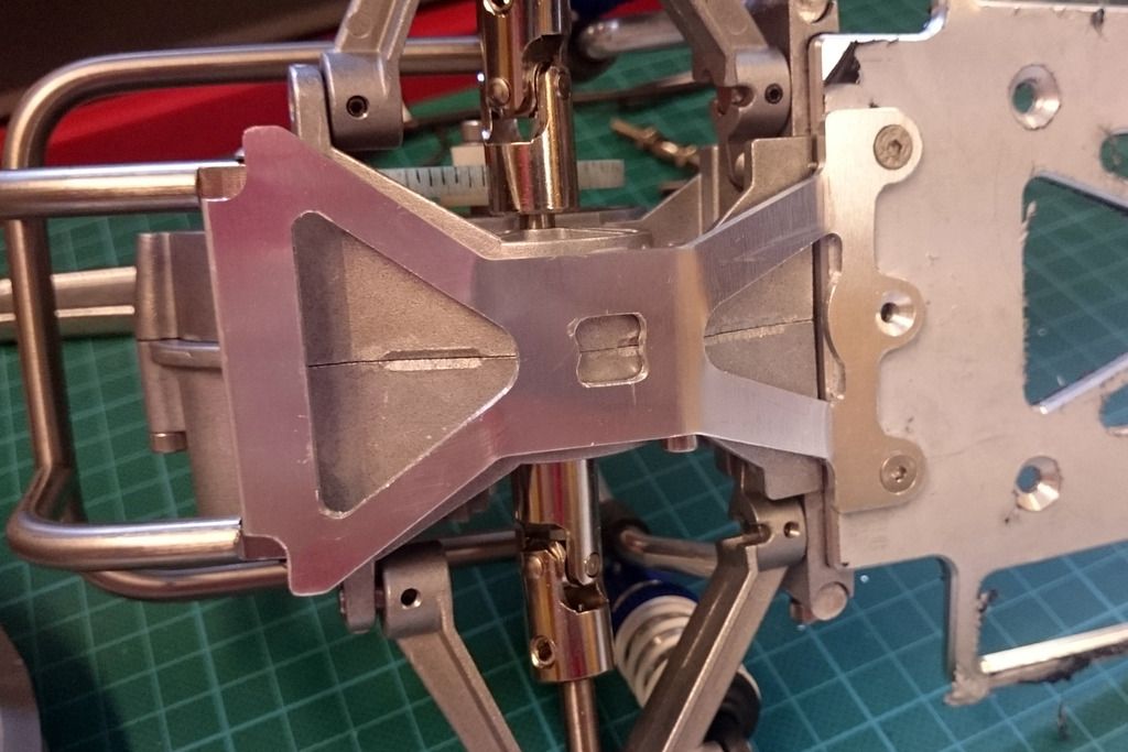

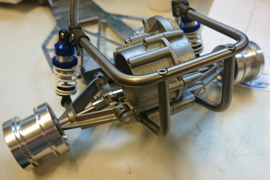

The rear cage is made from 1/4 titanium bar and was a real pain to bend and get right!!

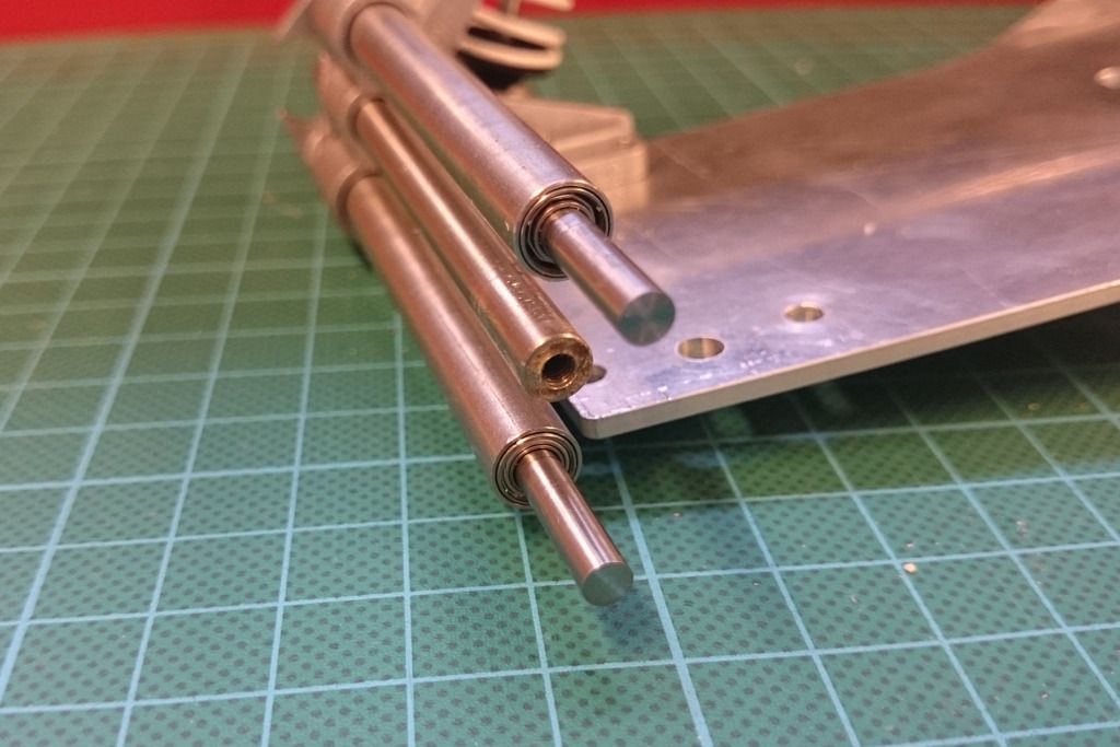

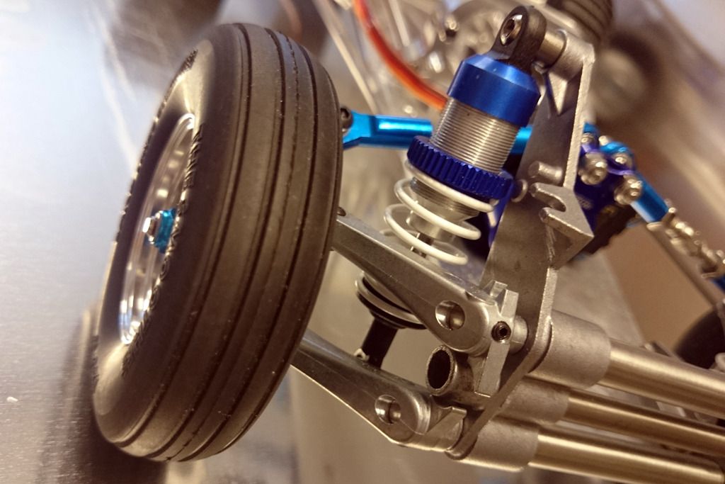

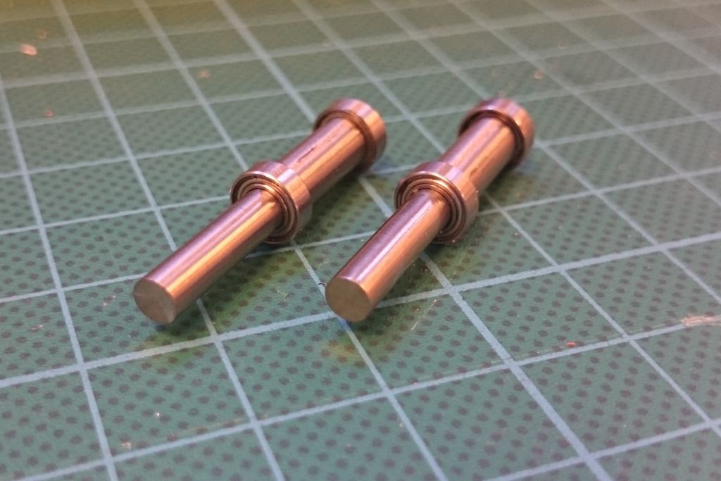

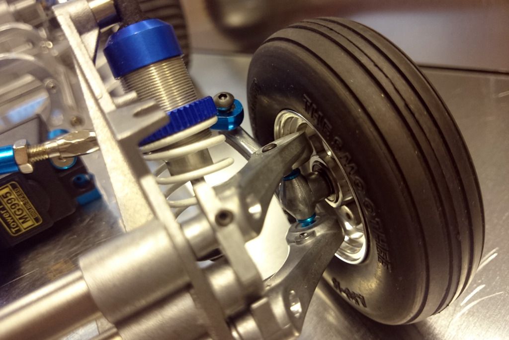

The front axles are now made from titanium and I have bored out stainless bar and fitted ballraces (ive not seen anyone else do this yet)

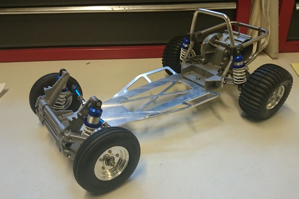

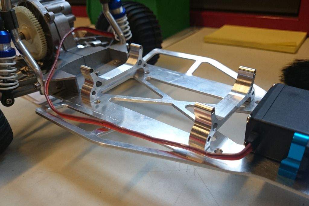

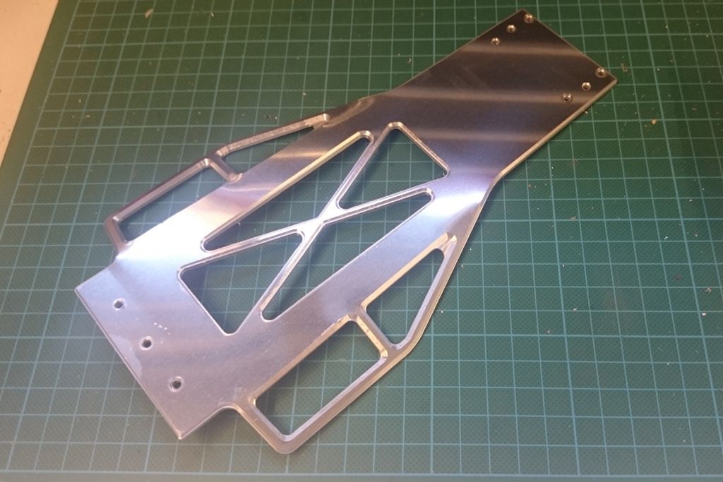

The chassis took me a while to design as I wanted it to be different to others available. I have machined it from 3mm aluminium to get my holes right. once happy I have a nice piece of grade 1 titanium to make it out of.

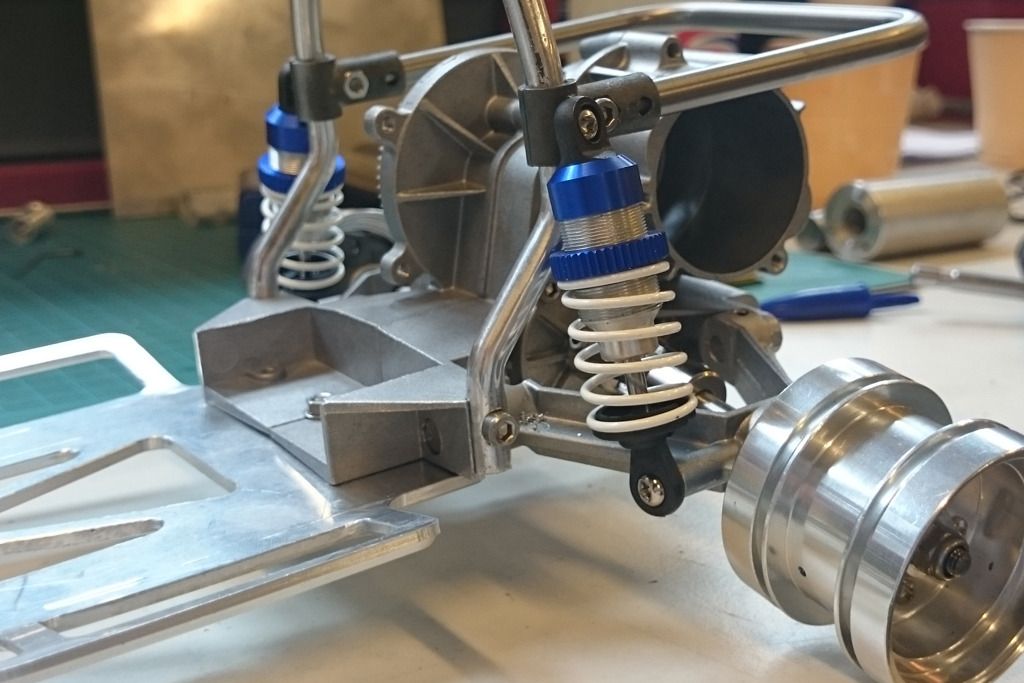

I have fitted new shocks.

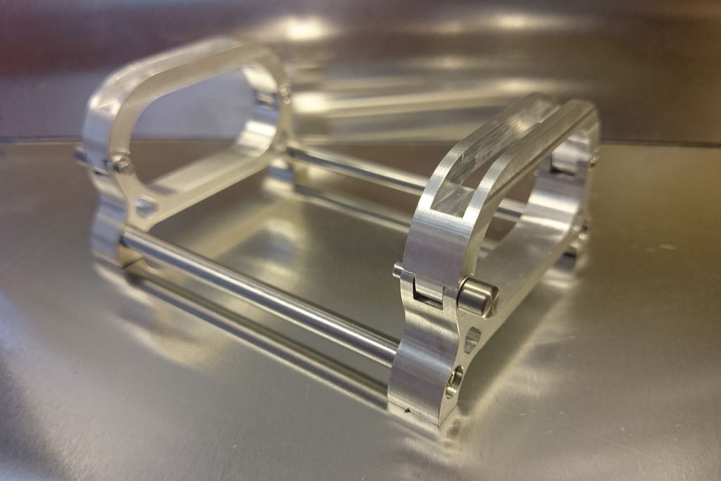

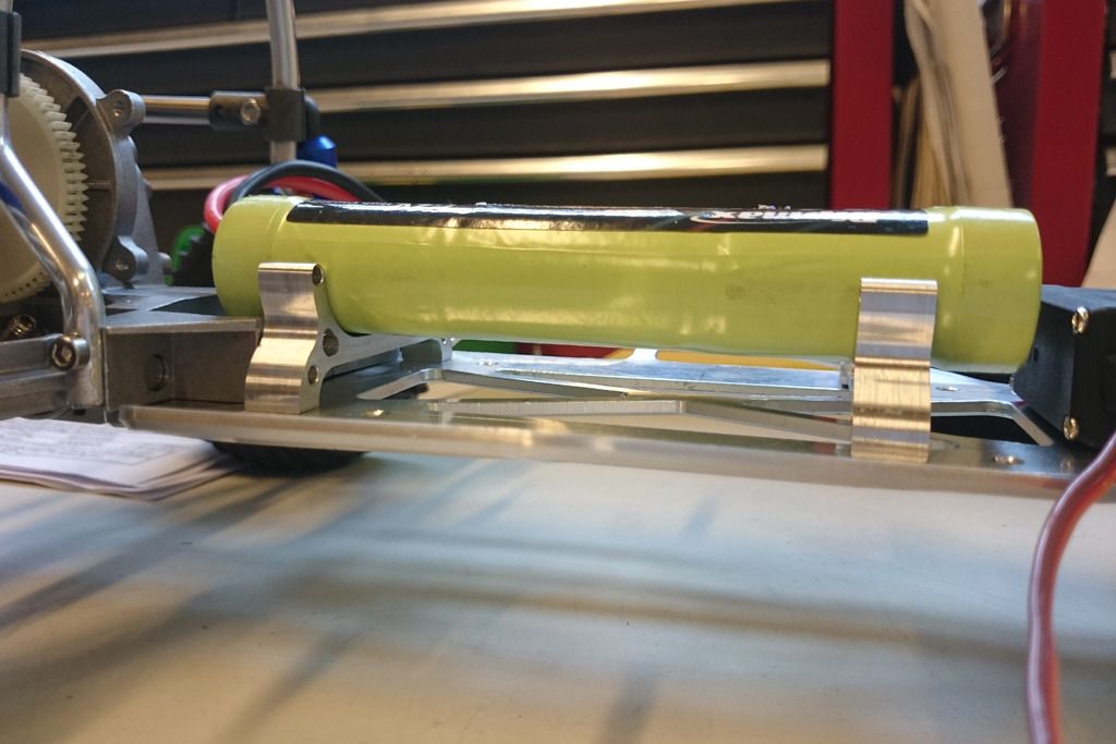

I have still got lots of work to do. I have designed a battery holder and im currently designing a titanium gear cover and front bumper.

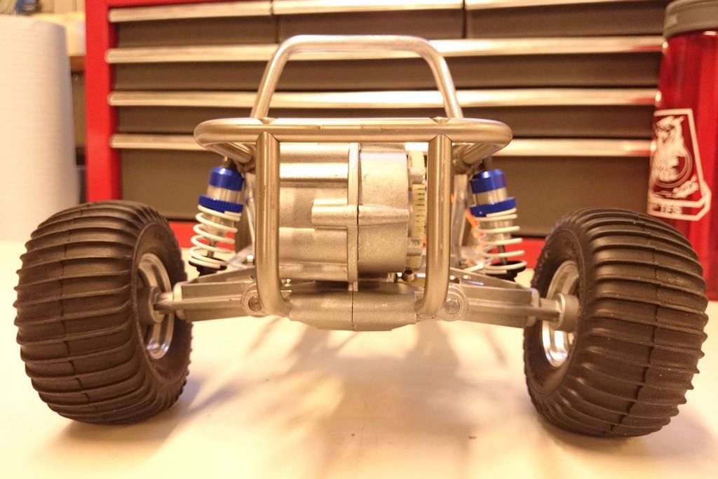

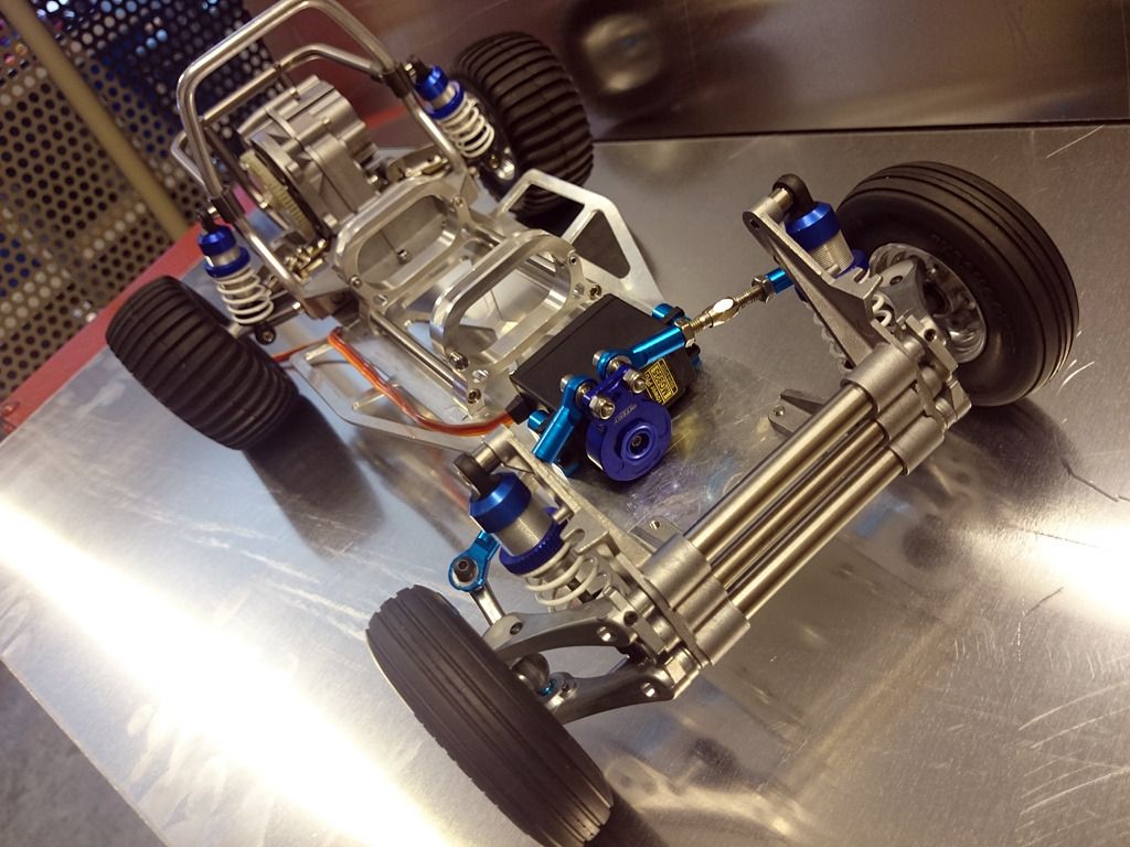

This is how the car looks at the moment...
Any feedback would be appreciated

I love what you're doing!
I'm not a huge fan of those shocks - preferring something more scale perhaps? - but your machining work (especially that rear cage) is beautiful!
Can't wait to see more!
Jx
Brilliant work love the ballraces on the front axles should improve stability - I've suffered with holes elongating in the upright which gives sloppy front suspension.
Rear cage is excellent work - will you be able to get the motor cover on?
Looking forward to following this.
Rich
Looks superb - must be nice and light too what with being made from ti?
Agree with Jenny RE> shocks, they just look a little out of place on what is otherwise a beautifully machined piece. Some internally-sprung shocks designed for crawlers might improve the aesthetic.
Thanks for the kind replies guys. On the matter of the shocks, im not really a scale modeller and went with something i liked the look of. Im really building the car to do a video as im an amateur photographer and now have hd video capability. The car will only run on sand i expect. It is coming along now though. Im currently trying to make a titanium front bumper....im on my third attempt!! Once the video is finished im probably going to sell the car to buy an astute or something of the like as my background in rc is 1/10th off road. I will post spme more pics when o have completed tje next stage of the build..

My feedback for you would be :- Make your parts available for me to buy. The ball raced, titanium shafted front end setup is killer!

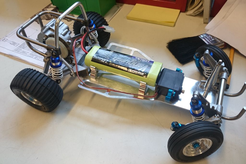

Hi guys

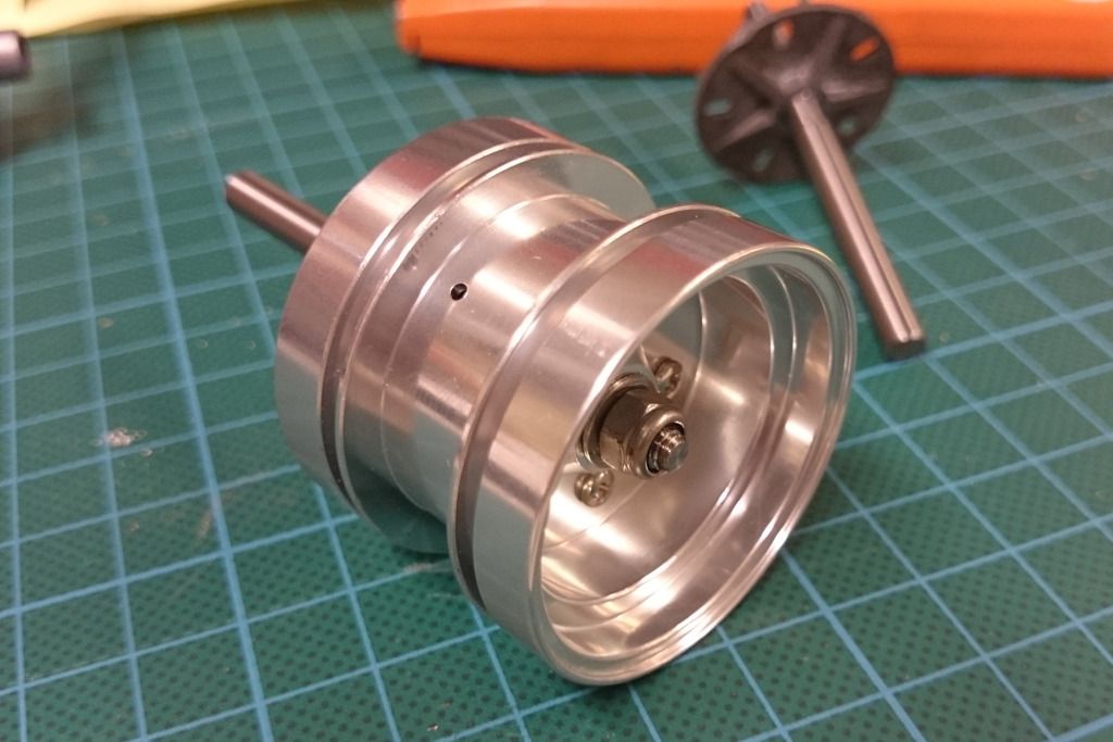

Thanks for the comments. It's still coming on, just a little bit slower now because of being busy at work. I have machined the rear arms to accept ballraces on the inside now, a dual bearing setup. Ive also made some wheel adaptors from aluminium and fitted them to the titanium driveshafts. They will be anodised soon. I did machine a titanium chassis but it is almost impossible to bend the wings on the sides without distortion. I have gone with a 3mm aluminium one instead which will be anodised. the battery cage is finished and im really happy with it. I'm currently working on designing a skid plate and the titanium front bumper...

I'm sure you can build some awesome scale shocks that fit perfect to the SRB's.
