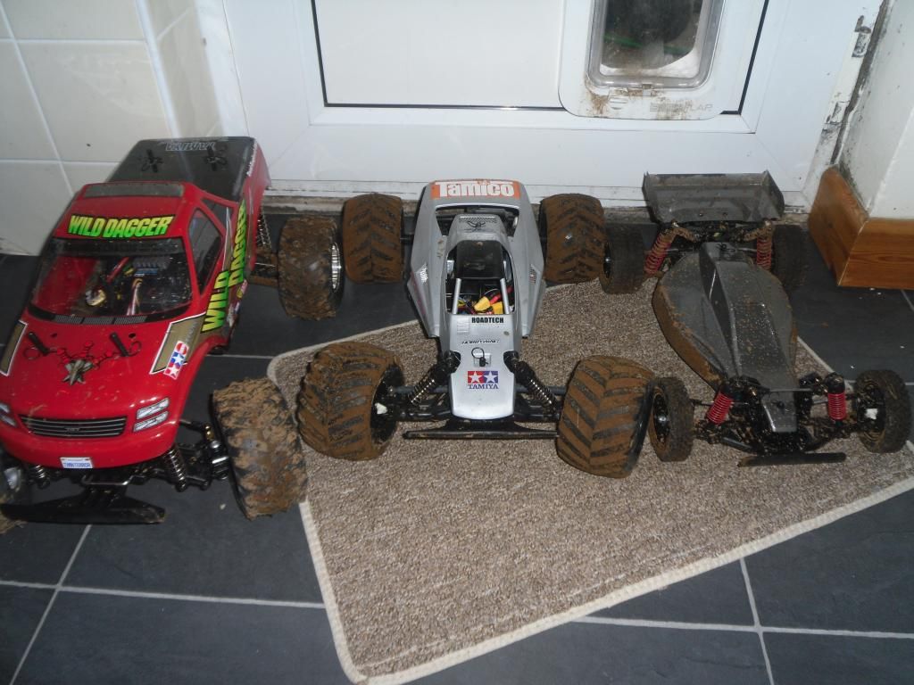

I went out to the local woods today for a play. My sister and family were up so I took a few cars and got my brother-in-law and nephew addicted.
They only issue is this:
How do I get them clean?????
Oh dear, that "By the back door" look.
:D
By the back door while they dry, they will be sleeping in the garage until they are clean
