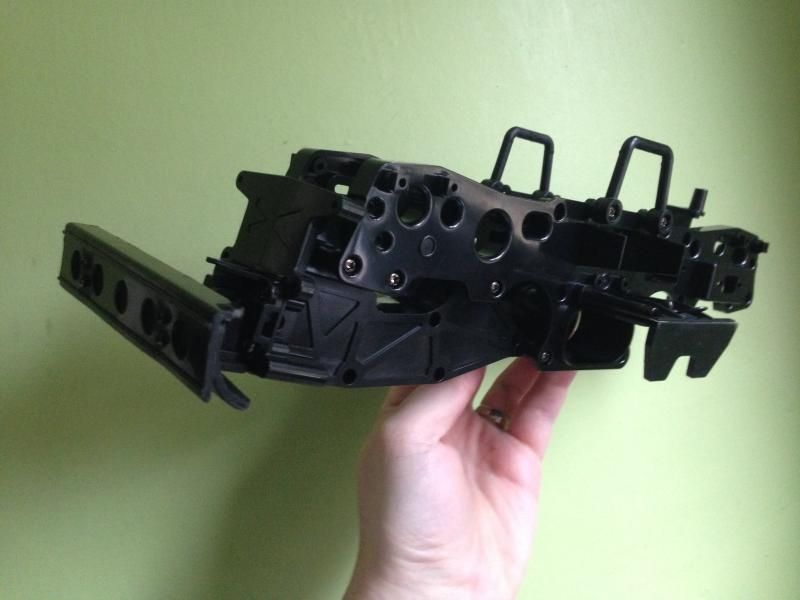

With all the love that these chassis seem to be generating recently I decided it was about time I replaced my BF3 that I sold a few years ago. So in January I put in an order with Fusion but was told they were back ordered until the end of Feb. I chose to stick with them as their customer service is great and figured Id use the time to get other projects done (yeah right :D).
But that left me with WT01's on the brain for over a month and searching the "job lots" on eBay I snagged a bargain pair of chassis sides, front end and a screw bag all for about £8. Having rummaged through my spares I found I had most of the chassis built up.
9C4D77F2-EC5A-4804-98DF-779E12D046C1_zps
I also realised I only needed another gearbox to get it finished so that got ordered up and hey presto, a virtually brand new WT01 appeared :)

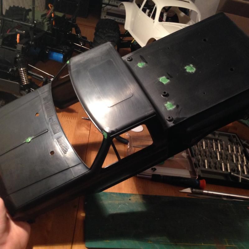

Another spares box rummage sorted out some fresh body mounts and an unused SCX10 rear mount that looked like a nice beefy roll cage. It just needed a little cut n shut with a TL01 mount and was bolted together through some styrene tubing.
F06982E1-36F3-4AAC-B442-E574DCF42270_zps
66921EA0-4B62-4321-8C00-4B204B581BDD_zps
6BA95081-F4A4-4EA1-B19B-7C5E3F03F6D4_zps
That gives me good tough 4 point body mount that should handle the rough treatment I have planned :D

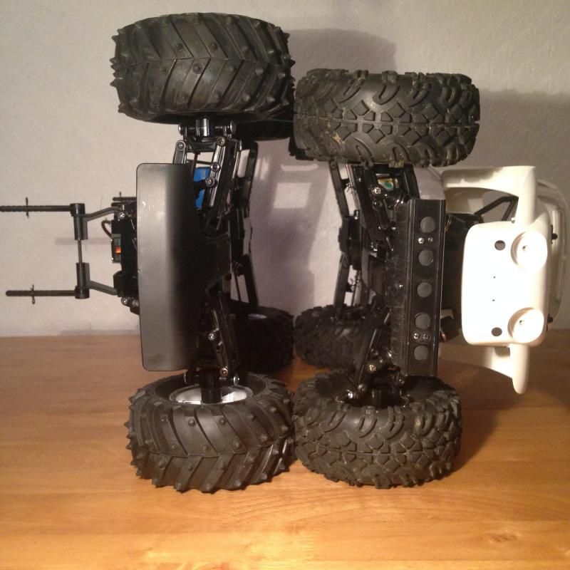

Here you can see the standard kit wheels and tyres on the right and the Maverick Scout wheels & tyres fitted to the left. The 10mm difference in offset is noticable and make the BF3 look a lot better IMO :)
C0389393-6257-48C1-BB30-C33FABE7285B_zps
Doesn't sound like much but overal it's quite a difference when compared side by side.

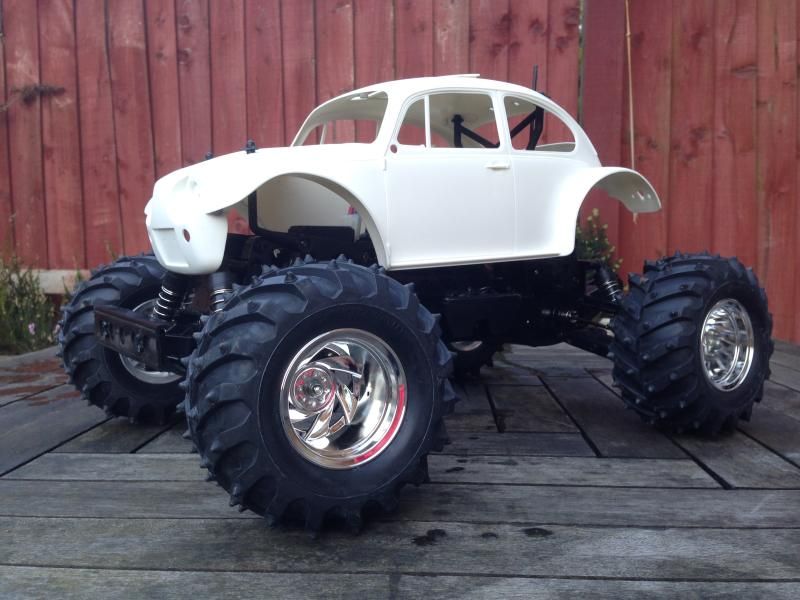

That's as far as I've got with the BF3. The Monster Beetle suits the kit wheels & tyres wide stance much better :D
BDDD0D9F-116E-47AD-B184-D2235D681DFD_zps
9BC791F4-247A-4414-8F9A-C65ECC1E58DA_zps
Paint wise the BF3 is staying black and I've ordered a set of original decals as I don't like the 3's tribal flames at all. Not sure what colour to do the MB yet although I'm hoping to use a mix of the Scorcher decals to give it a racer look.
Edit: Looking at the Monster Beetle I can't help wondering why Tamiya haven't released it on this chassis? Surely it's iconic enough to deserve a re-re and this chassis makes the perfect sense to me, following the Blackfoot family tree. Does make you wonder how their minds work sometimes?

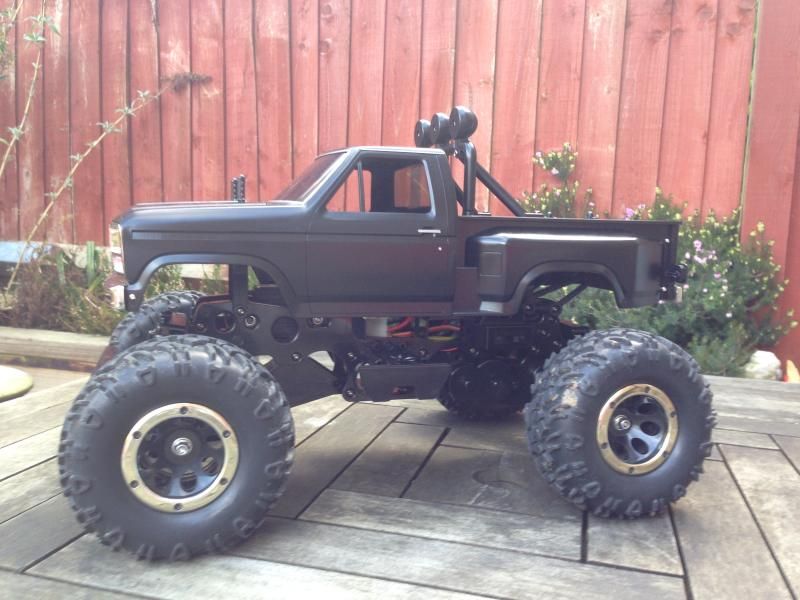

A few people seem to comment on the wheelbase looking wrong with the Blackfoot shell and I agree it's not quite right. While messing about the other day wondering what my Wild Commando wheels would look like on the WT01 (after seeing Brom's insane clod shod WT01) I messed about offering them up. I then plonked the Bruiser shell on top, although the mountings would need sorting to suit, it actually suits the wheelbase perfectly imho and maybe another take on this chassis!! The 1:8 Wild Commando wheels on the other hand would require further spacing to not interfere with the chassis!
Nito
I don't have too much of a problem with the wheelbase not matching the bodyshell, it's close enough for me and it is a monster truck rather than a scale build. Personally I don't like the amount of rear overhang on that photo above.

Good call but just looked at the wheelbase of the landfreeder at 242mm against the 281mm of the WT01. The F350 highlift is 290mm, Bruiser is 287mm. The Landfreeder shell might be 257mm like a lot of Tamiya's shells!

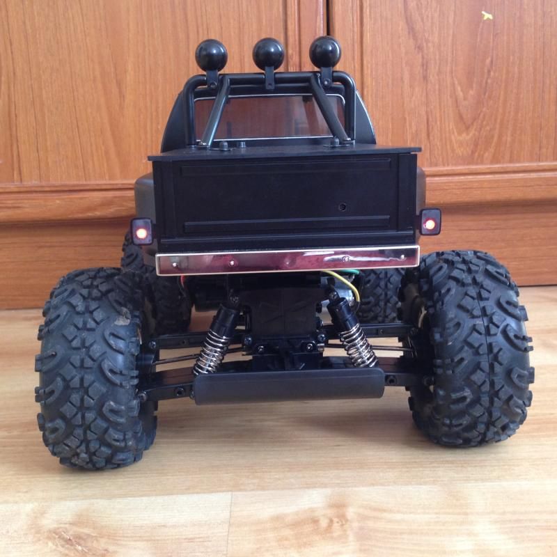

Got the wiring done and tidied away. Simple circuit with 2 white 3v LEDs up front and 2 red 2v LEDs in the rear.
7F417436-50A5-4DA9-96C3-0186CCD4451B_zps
Decided to power it from a 9v battery box on the tailgate. It's slightly under the 10v the LEDs should have but it works for me.
BA335688-45EC-41DD-BEDD-B9B2BA3AACC1_zps
5D117DEB-B310-41F9-B78E-266D038A0141_zps
Using the seperate battery means there's nothing to disconnect whenever I take the body off. Actually it's not that much of a hassle with this chassis as normal battery access doesn't require taking the body taken off. If the 9v doesn't last long I might re-wire it to run off a 3rd channel socket in the RX. That would mean running two circuits (one for the front lights and one for the rear) in parallel as it'll only be putting out 6v.
