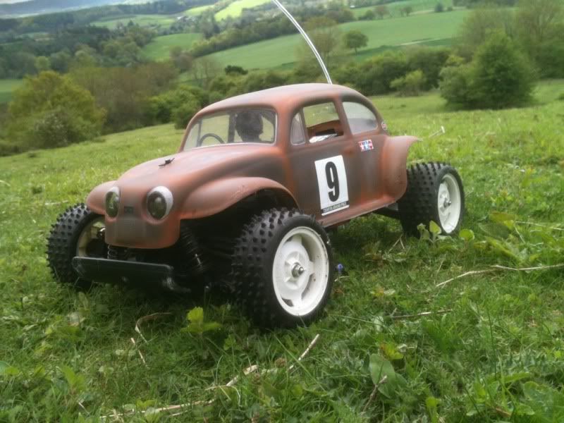

In that case, how about a Sand Scorcher lookalike based on a Grasshopper or Hornet chassis, like this:
http://www.tamiyaclub.com/forum/index.php?showtopic=74519
That's my bug right there!
It's a fun little thing but it isn't the best handling car ever. My Blitzer is a much better car for out and out bashing. I just sold my MB as I didn't want to damage it after restoring it and really didn't need another shelf queen.
I'd go for the Blitzer every time!
Now that looks the business! Do u think it would keep up with my brothers df03?
Oh yes. The super grippers gave it amazing levels of grip on loose surfaces or grass. You can see how low the COG would be but it would still grip roll if you really pushed it :D I now run it with 90mm Kongs stretched over the wheels.
