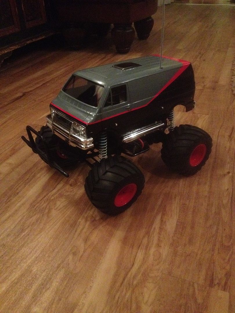

In the mean time, here is a piccy of it without the lights. He is mad about the A Team, so the paint decision was easy, it won't stay looking nice like this for very long....
It has steel bearings, foam tyre inserts, oil shocks, alloy body mounts and the 5th shock. It's for my 6 year old, so is running a standard 540 motor at the moment.... Gave it a blast for the first time earlier, he loves it....!!!
