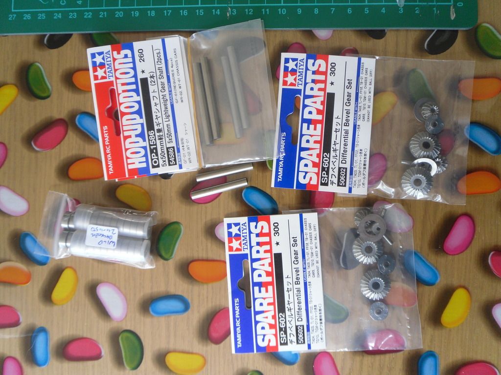

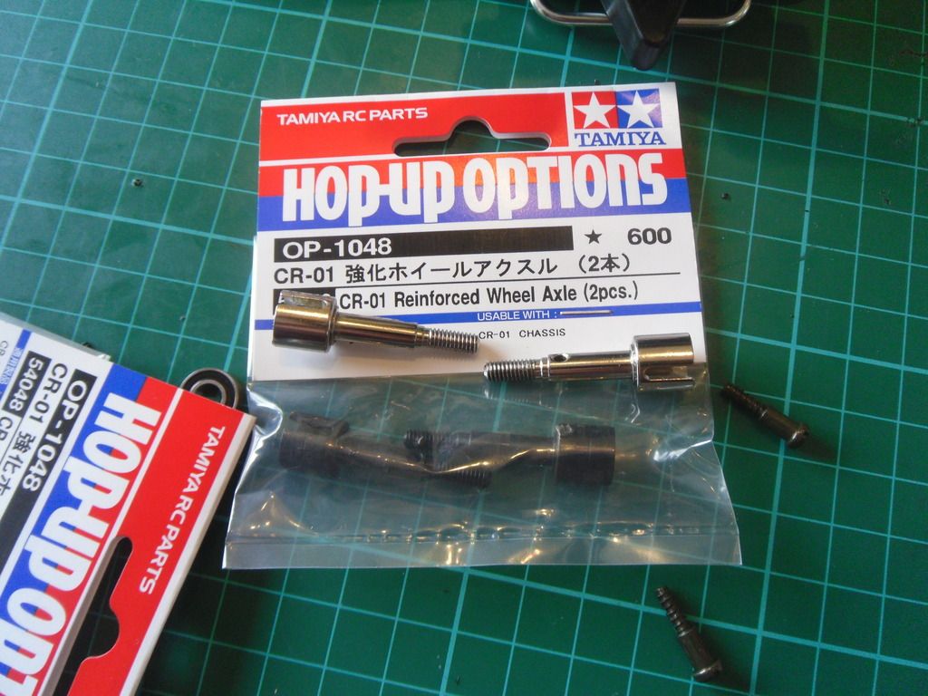

Most of a parts bag and one U clip was missing. The bag was expensive for the bits I needed so I used Hop-Ups where needed.

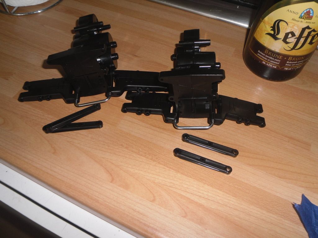

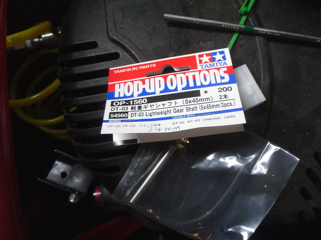

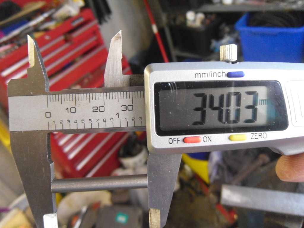

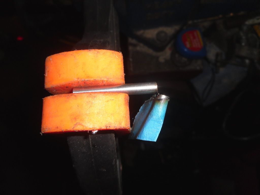

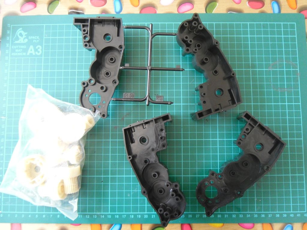

Being an old kit I have to build the gearboxes. One bit I could not get was the 34mm shafts so I had to make a pair out of longer ones

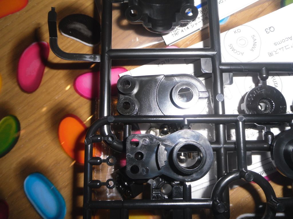

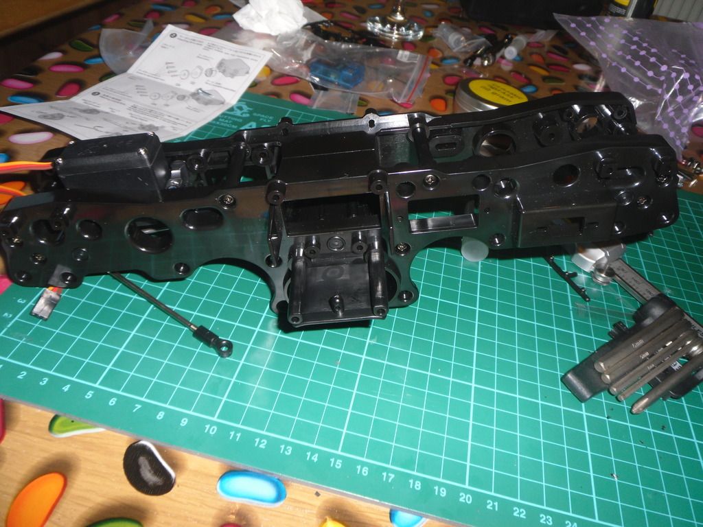

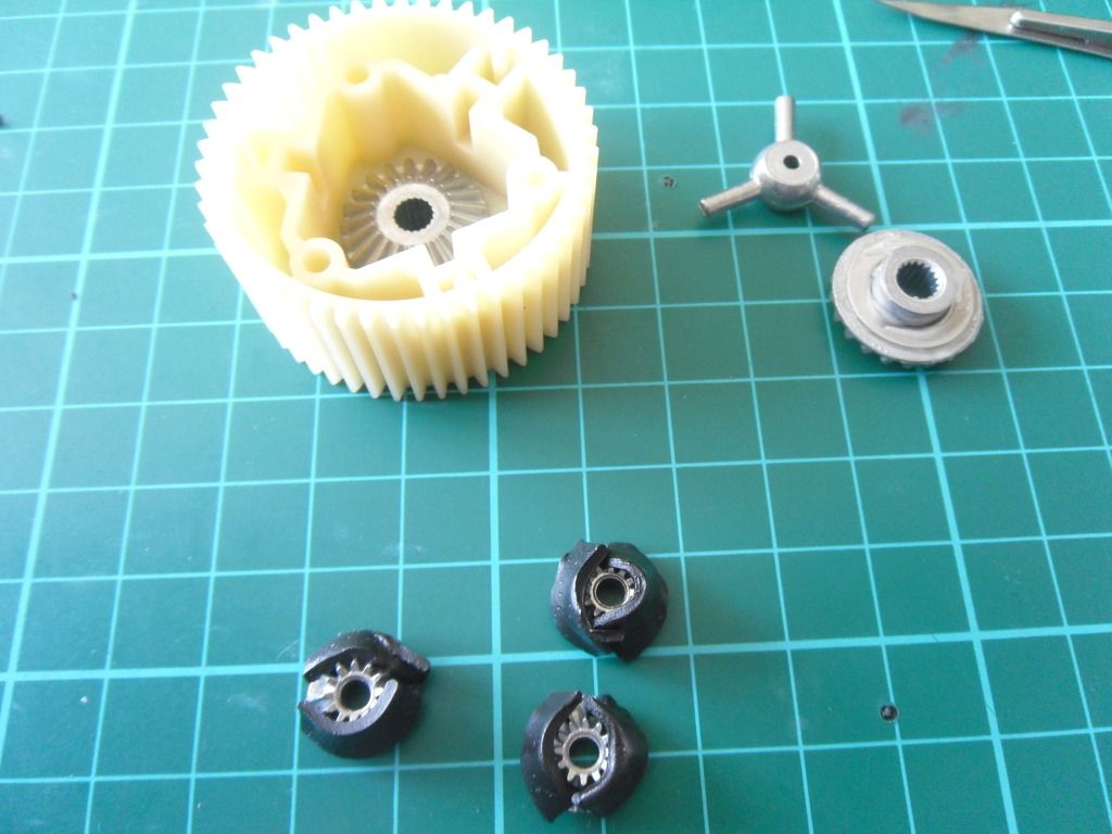

Building the gearboxes

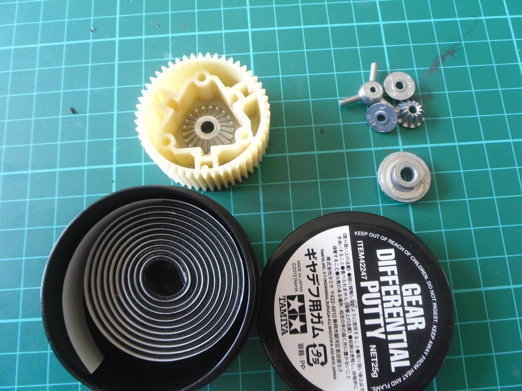

Diff Putty again

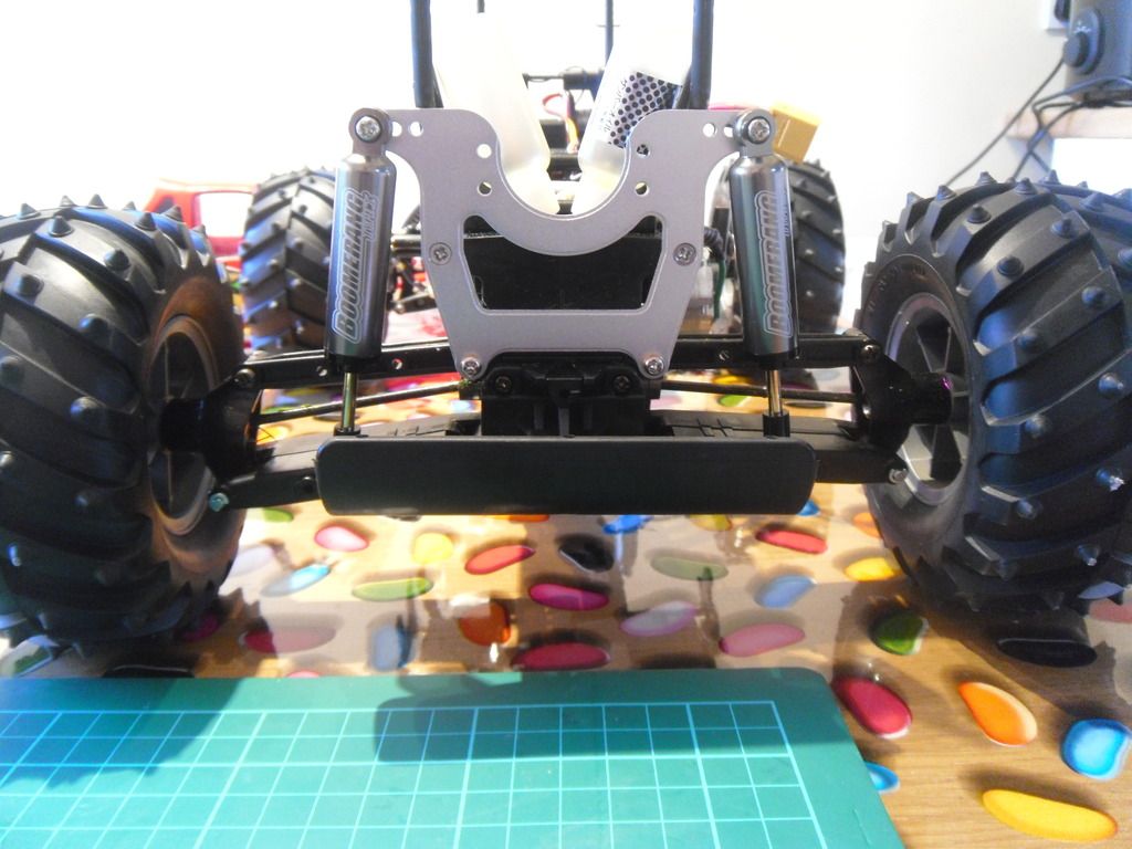

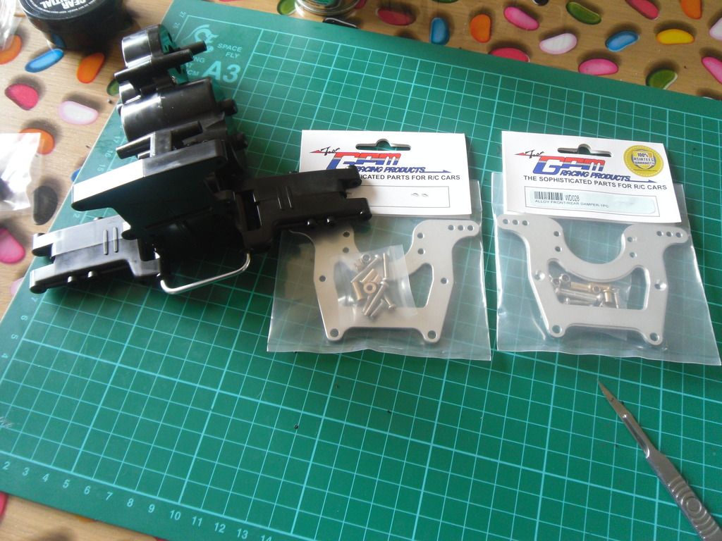

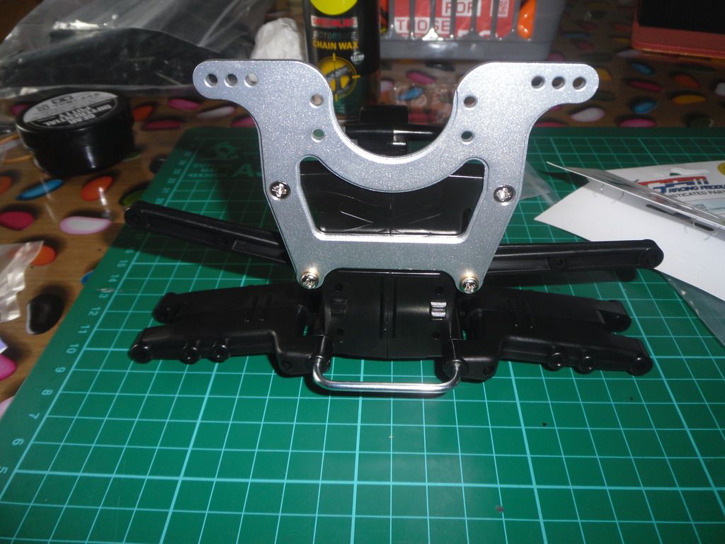

Much needed shock towers

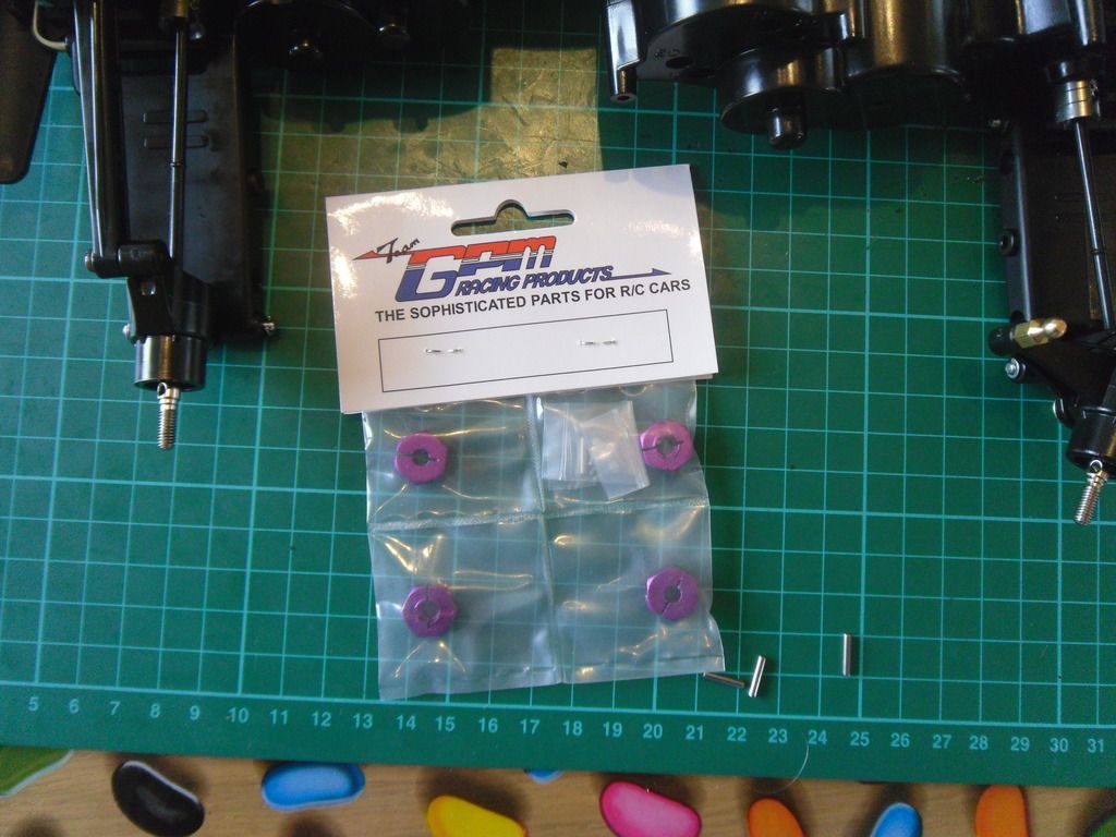

Hexes. They were cheaper in this colour

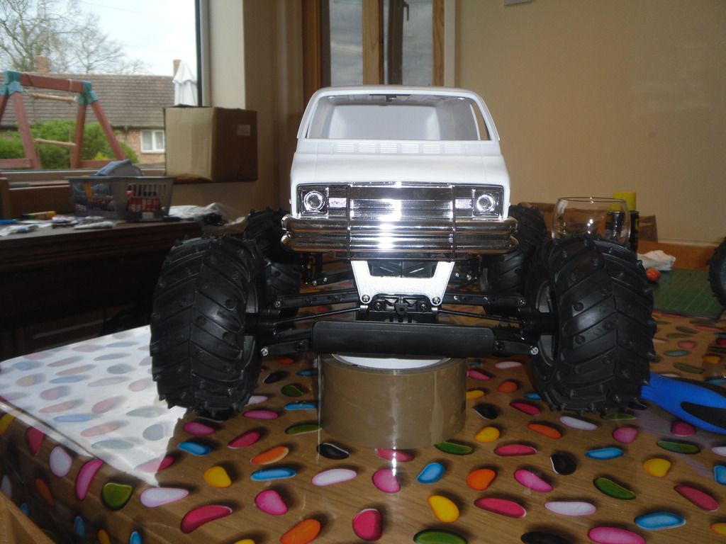

PLAN B

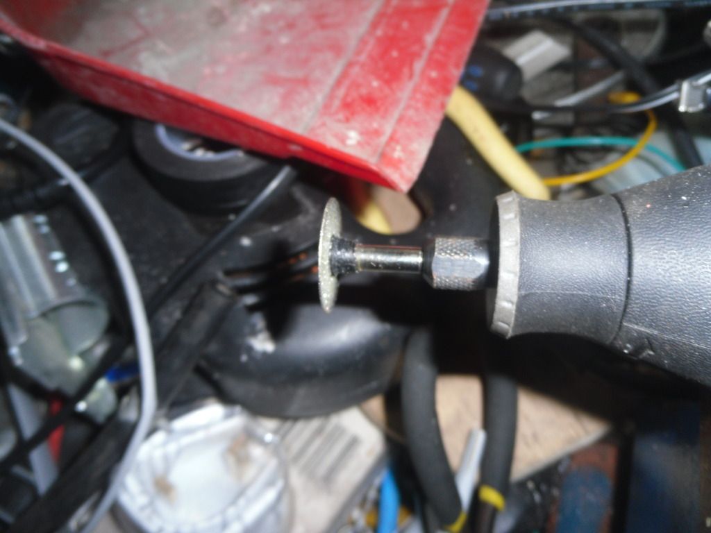

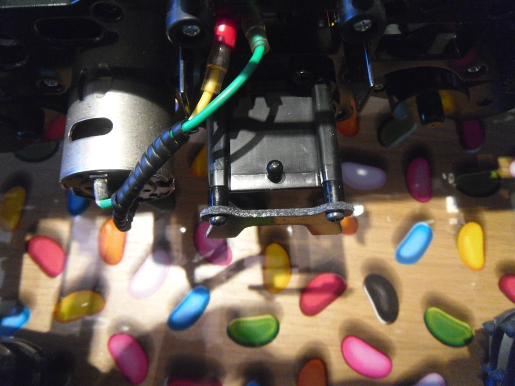

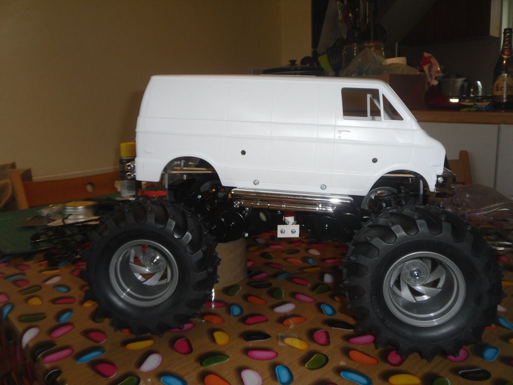

If i happen to not like this I had a plan B. Custom shortened chassis would be needed so I mocked something up.
What do you think?
Back to Plan A

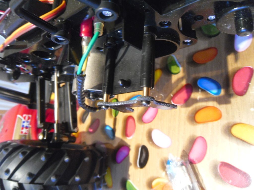

Saver is a bit shorter but we will see if it all works OK

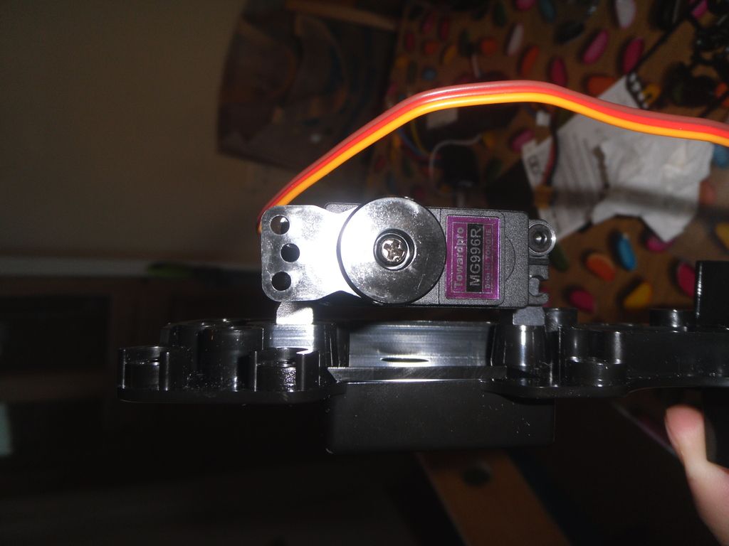

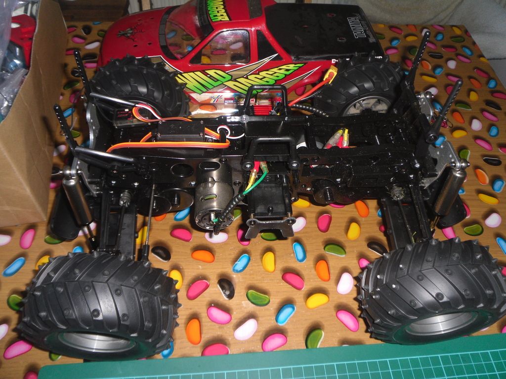

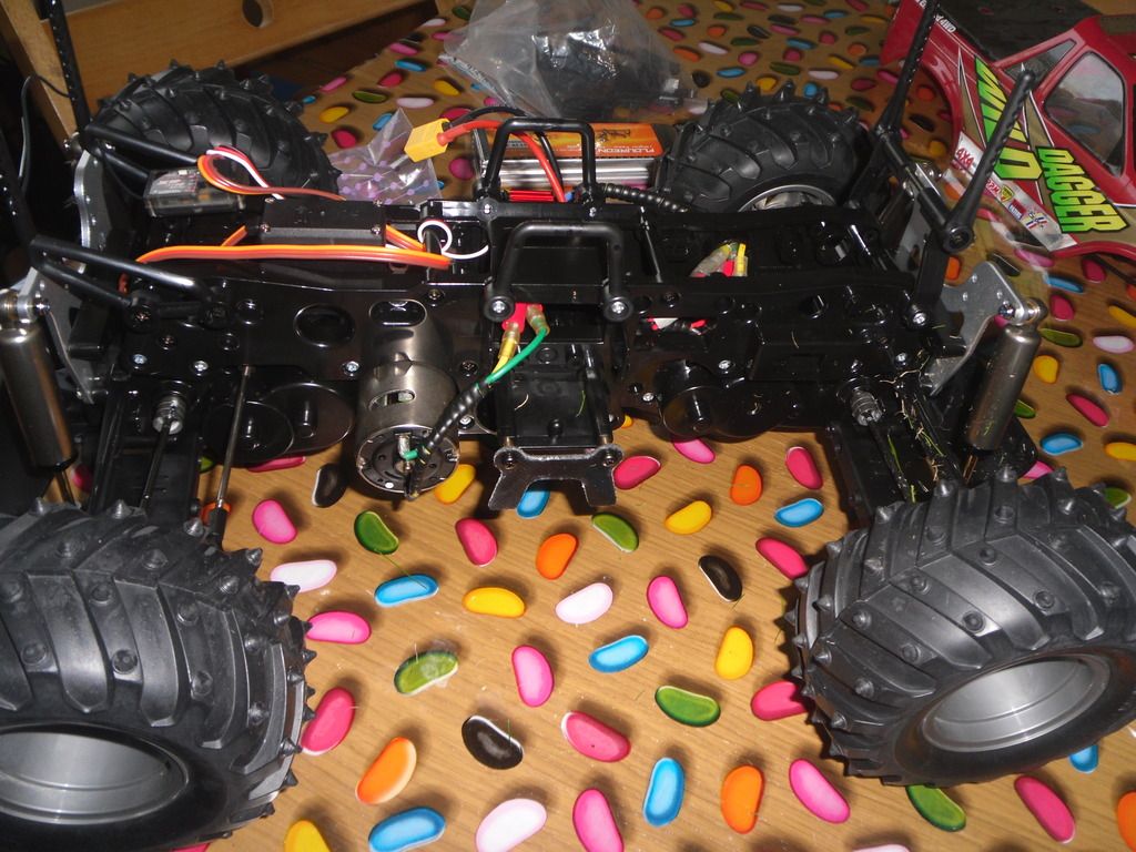

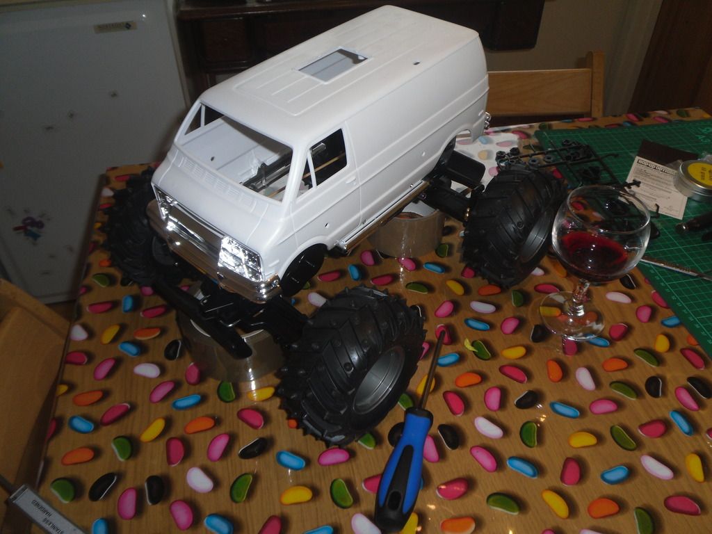

At this point I should have stopped drinking or put the model down. I will need to fit the servo in the correct place in the morning

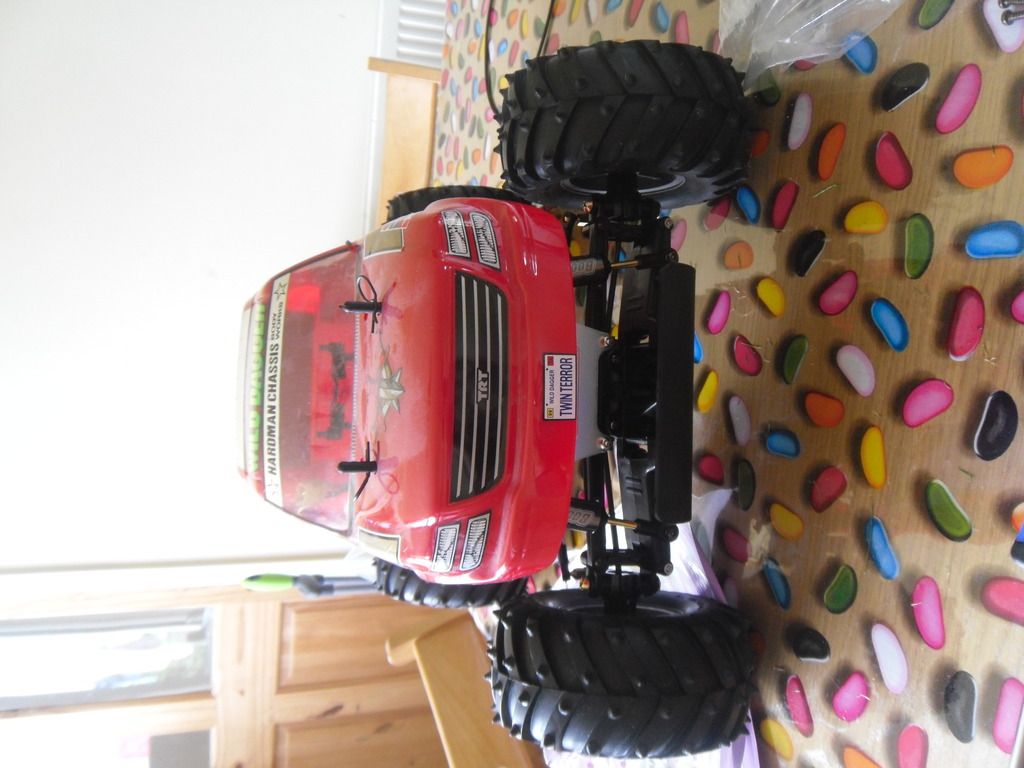

Body came painted. Not a bad job. The red is real nice but the black is the wrong type of paint so flaking off.

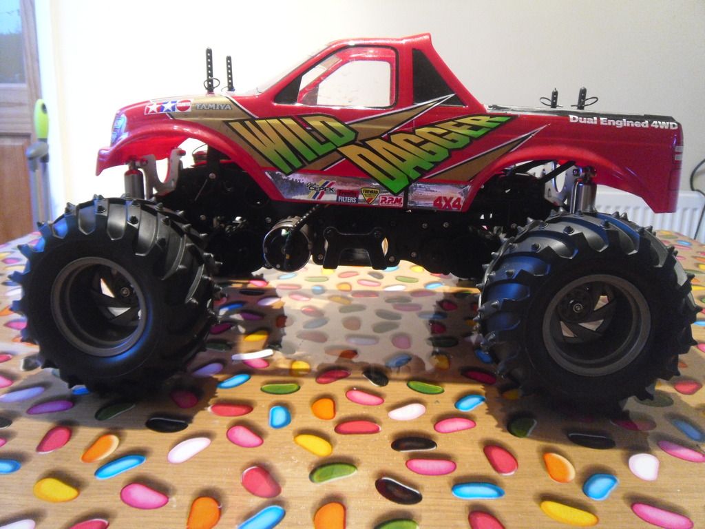

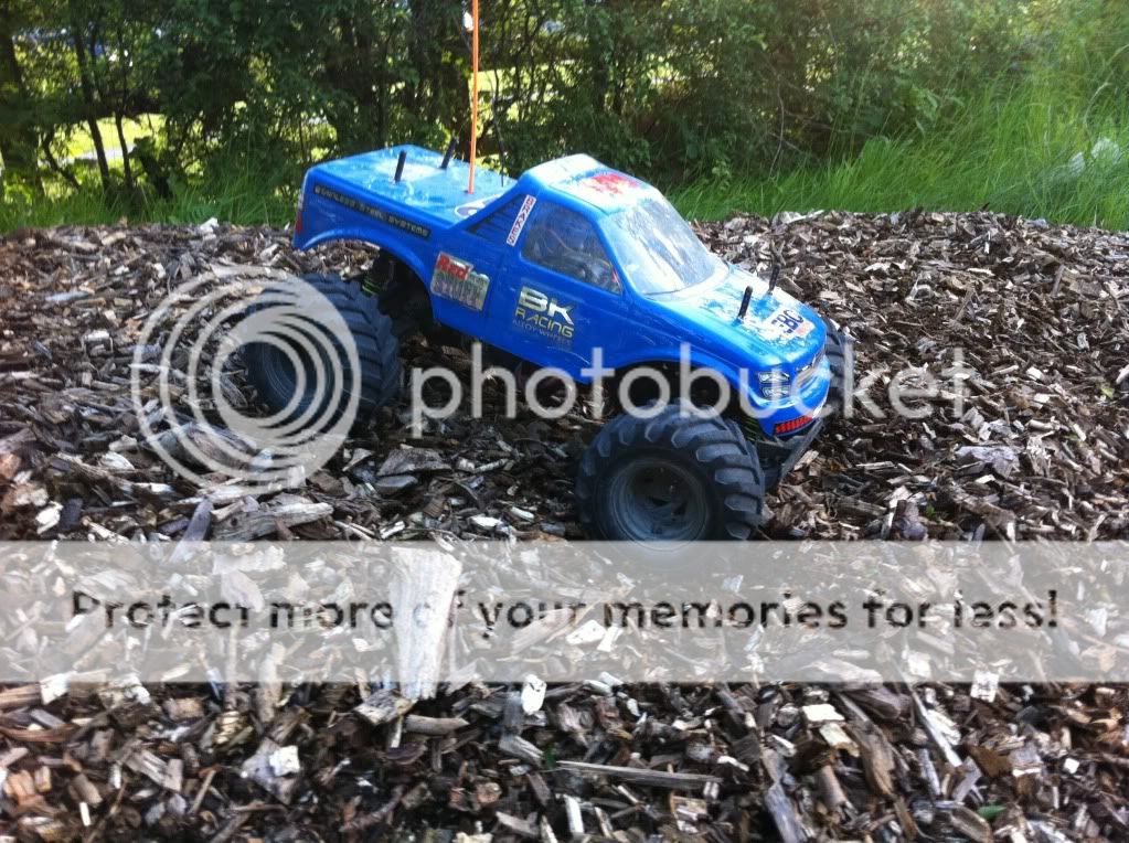

Took it for a spin around the garden and it is fun. The Boom shocks are not great so I need to work on them

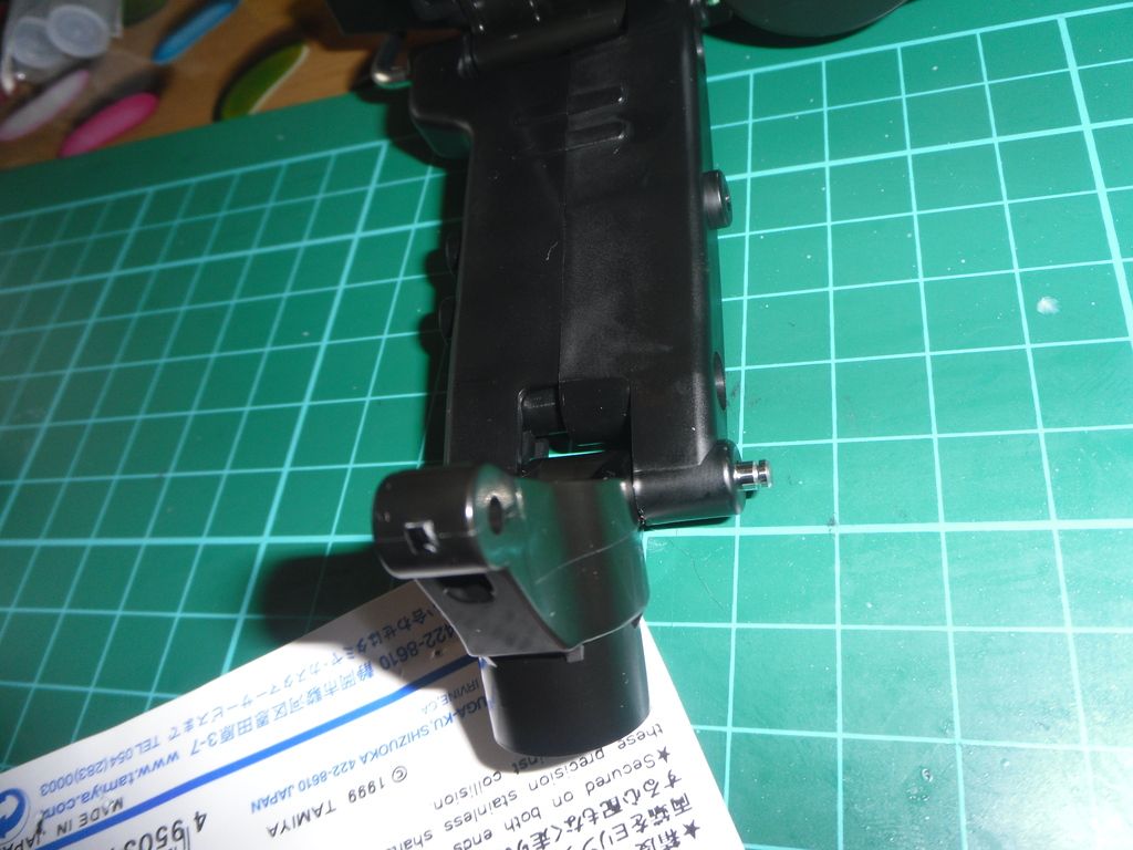

No rear wheel steering, I will check the mounts. I guess I should have printed the manual rather than doing it from memory.
With the chassis being basically symmetrical, there is no shame in getting things back-to-front, especially if working without a manual. :)

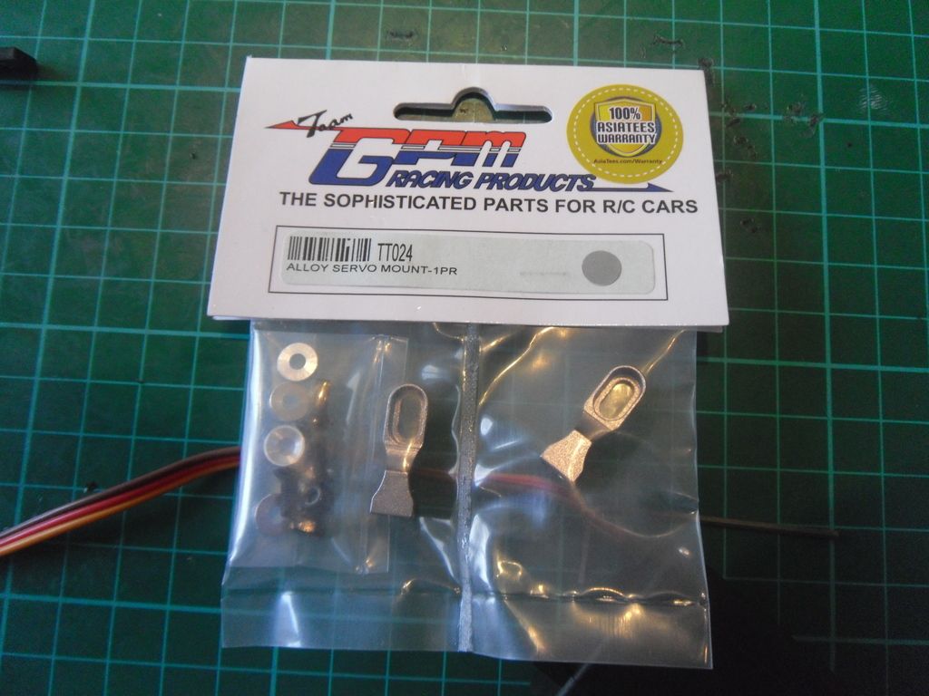

Looks good. My Mud Blaster is my favourite runner, it takes an absolute beating. I used the same hi-torque servo saver and it's fine - Obviously adjust the tie rods so you don't end up with too much toe-in though.
The servo posts are much more than just bling on this chassis - they're pretty essential as the stock plastic posts aren't beefy enough for the big wheels acting on them, introducing lots of flex.
Only thing I'm finding with mine is an incline for rolling over under anything but minimal throttle - partially my fault I'm sure for fitting the 11T brushless system, but I also run the widest stance setup and I'm considering adding some adjustable upper arms for some negative camber...
I did a couple of good rolls today and a forward flip when braking turned in to reverse. I need to get used to the quickrun ESC, it engages reverse a lot easier than the Tamiya ones. I have left the top deck clear as I was considering running 3s on the silver cans for a giggle.
I did find it does not jump as well as my Mud Blaster, with the extra gearbox at the front and the servo it is a bit nose heavy

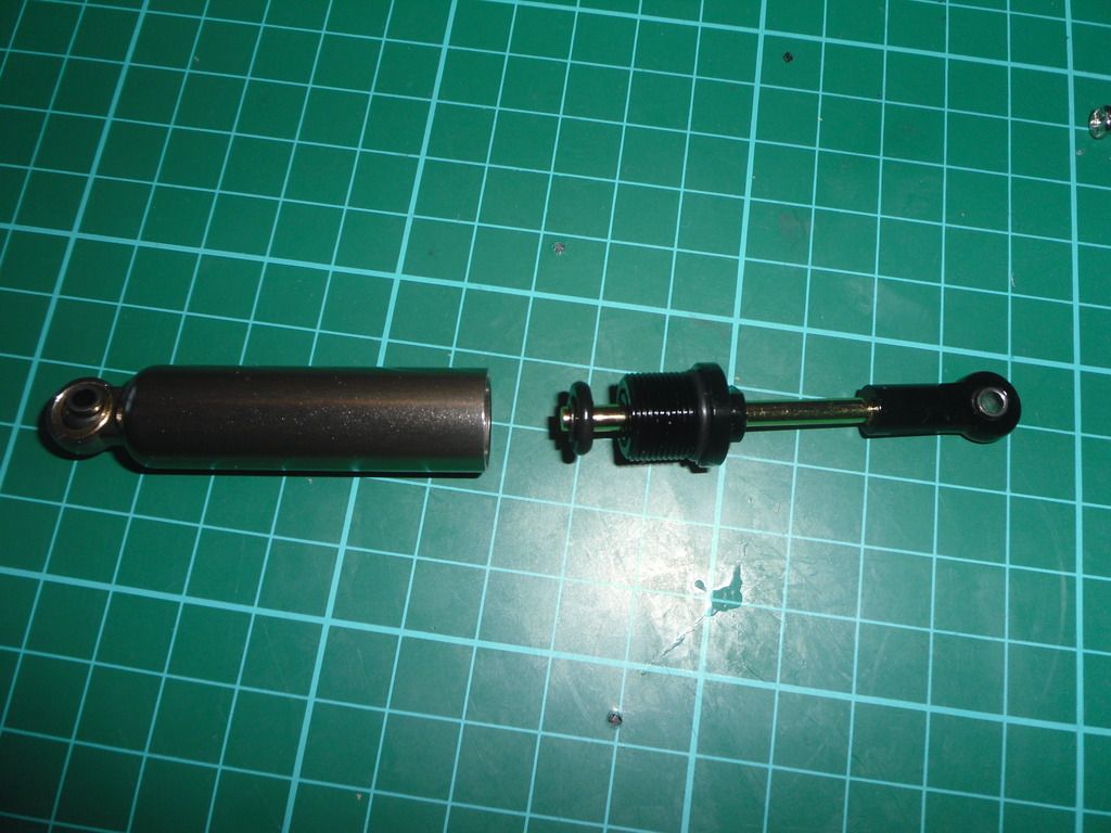

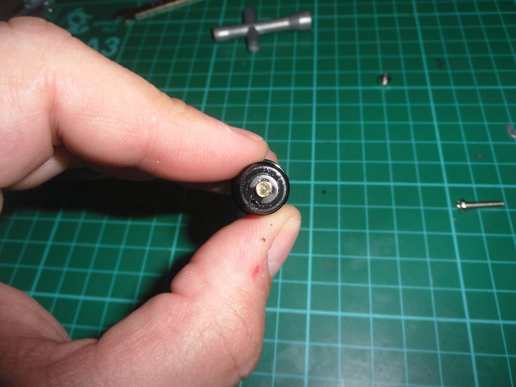

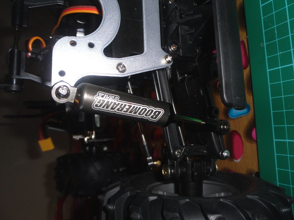

Boom Racing shocks are awful as stock. I was going to swap them out but they were not cheap so I though I better fix them.
Hard to see here but when I stripped this one the holes were blocked where they had not been drilled properly
All the four shocks had different size holes in the pistons and the E clip covers a bit of the holes on all of them. One shock had different size holes in one shock.
All the holes were far to small to work properly so I re-drilled them all the same size. I picked a size close to the Tamiya pistons in CVAs.
The springs are weak in these as well, I am running the hardest but they are still soft. Because they are progressively wound they give a lot of sag, I think this is good for this chassis.
Refitted and ready to go. I have moved the bottom mount in one hole, this should let the body roll a bit more in the turns.

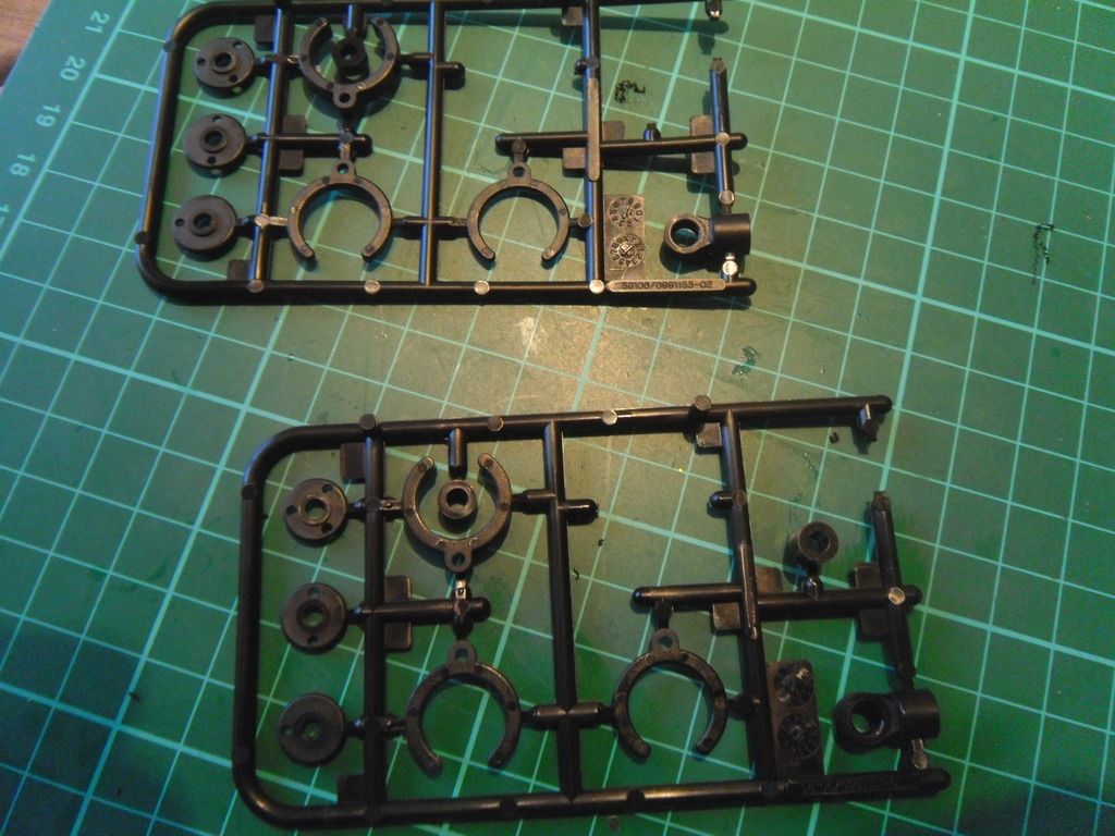

Next job. While I was playing with shocks I noticed the spacers on the sprue
Perfect

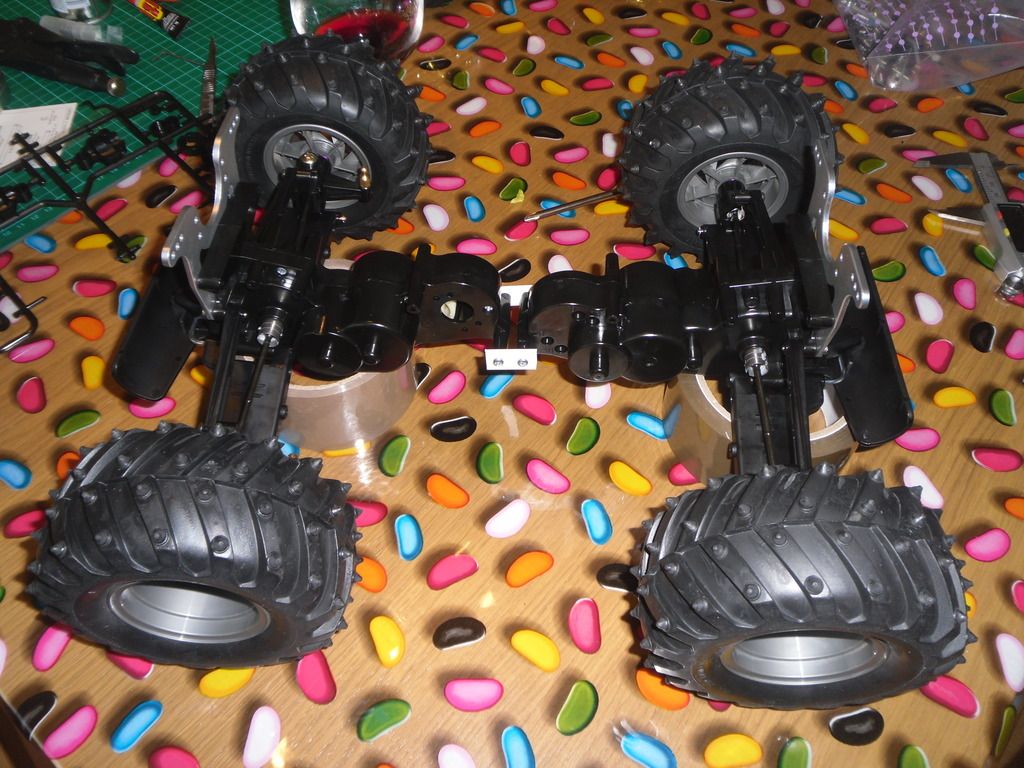

The stance looks good!
Is it my imagination, or is the back wheel mounted wrong way round relative to the tyre? I have a feeling it may belong on the other side of the vehicle, and one of the wheels from the other side might belong in its place. The tyres aren't glued I hope?
I had never thought about the wheels being directional....
... Just checked and you are correct.
Tyres are not glued but they need to be, I can hear them squeaking.
Just had a run around the garden and the shock set up is better but it is still easy to roll. I moved the shocks to the outer holes on the arms and I got a bit better.
I think these shocks need stronger springs for a model of this weight.

Just be wary of the alloy suspension arms - where they attach to the chassis is quite a major part of the car, so adding rigidity to the arms increases the likelihood of damaging the mounting points. It's a royal pain having to dismantle an entire gearbox just to resolve a breakage in that area. The stock plastic items are very good at absorbing a lot of impact.
Straight out of the box they are strong enough - many recommend the alloy suspension towers as per this thread, which do look good, but to be honest I've never managed to break a stock plastic one yet - doing plenty of jumps!
As Chris said, the alloy arms look good but you will break the gearbox cases if you have a hard crash. The stock ones don't look very bling but they flex enough to absorb pretty much anything.
