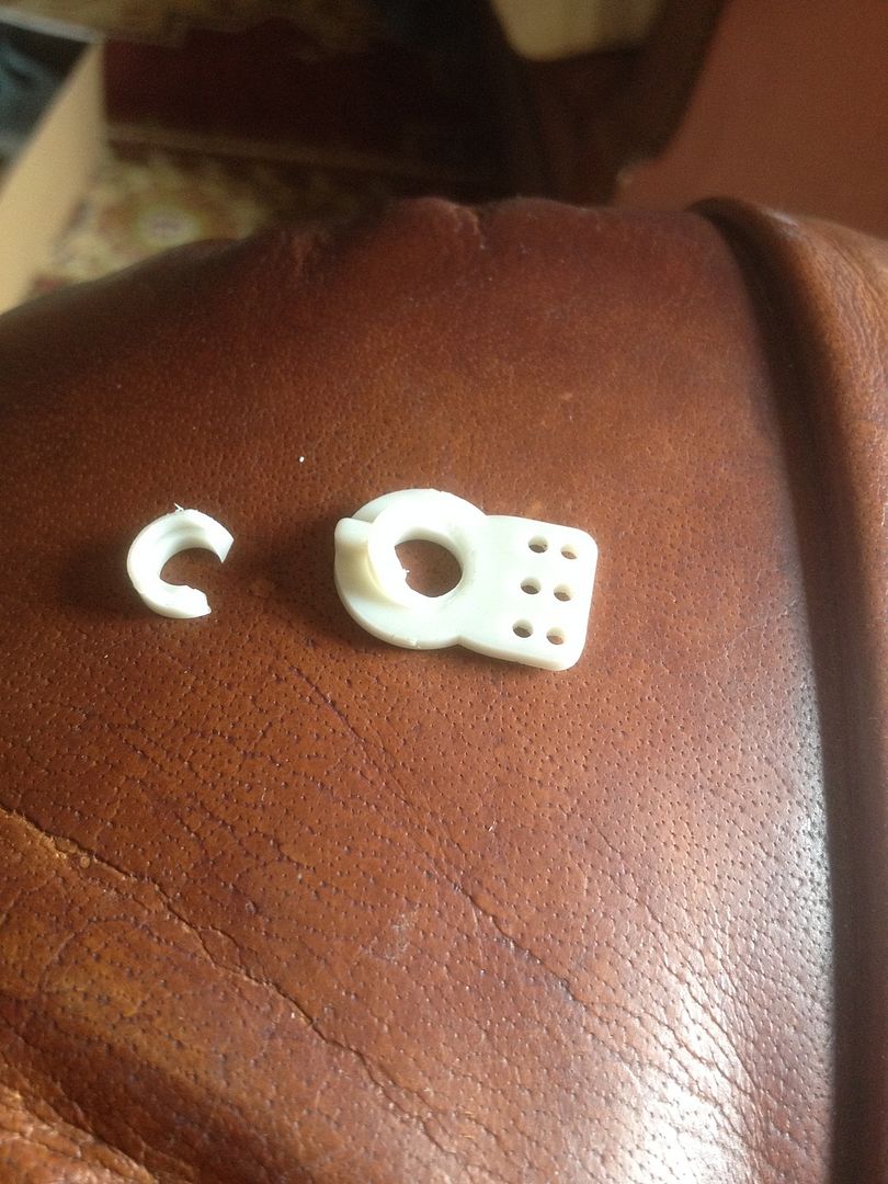

What are you breaking... the big white C?
Grab the 2 broken bits and place back where they should be... then wrap a ziptie around it :D
Don't worry, small ziptie usually pops before the servo does - even with basic 40oz stock servos with plastic gears.
The bit where the screw goes through is snapping. So the screw stays in place, along with the smaller bit in the picture, but the big bit in the picture above is coming off....
wired, that's an odd place to break - never done that meself before :) best get the hopup then
Doubt it'll glue too well.

Bad batch or lower quality plastic..? In all my years of bashing I have never broken a servo saver like that...
Likewise. Once or twice I have lost the screw that keeps it attached to the servo, but even when racing every week on a track bordered by hard wooden battens, my Tamiya kit servo savers haven't broken. Is there perhaps something up with your suspension geometry that my be overstressing the servo saver?
Well it's a midnight pumpkin with standard geometry, but they are pretty big wheels connecting to the servo. The second time it broke, my son drove it into a kerb from a stationary start about 1 foot away. I was not very impressed when that little knock snapped it...!!!

Ok, so the new ones have arrived from Hong Kong today. Must say that the 3 racing ones look the best, so this is what I have fitted. They have a built in spring system that absorbs any impacts and will hopefully prevent any more breakages.
The new ones arrived just in time, as I broke the 20 year old one today that I have been using for the past week or so....!!
No idea what you're doing to wreck so many servosavers :P my Lunchbox managed to rip its servo mounting points off the chassis tub but the servosaver survived fine :)
No idea, my son has a lunchbox that he has absolutely trashed. It has slammed into numerous kerbs, benches etc and hasn't broken anything apart from the windscreen. Mine breaks every time it hits something....!! The 3racing one I have fitted looks a million times better than the tamiya junk, we will see soon enough!!
