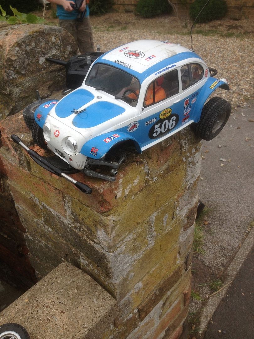

Hi folks, my neighbours kid brought his RC car out today when he saw us playing with ours, apparently it's a sand scorcher

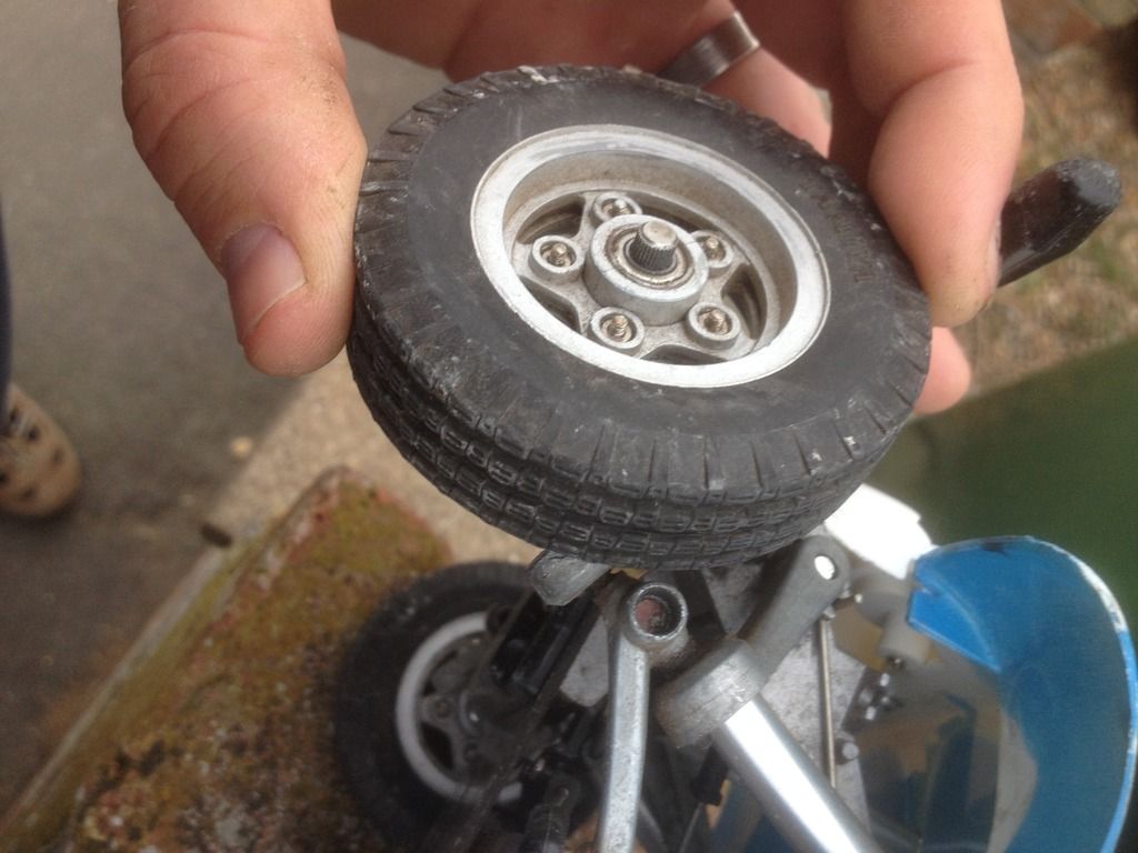

The front wheels kept coming off, something doesn't look right as they just seem to push in. Is there something missing...?
The axle shaft sticking out of the wheel bearing is supposed to be factory pressed-in to the front upright (steering arm / hub) and shouldn't come out , so a new arm ( or both arms ) is needed unfortunately , it's not unusual for this to happen (looks like the car's had an arguement with something and come off worst which hasn't helped)
Yeah, it's had a lot of abuse I think....!! All 4 wheels fell off at one time or another. Most annoying...!!!
I'll have a go at pressing them back in with my vice and some strong thread lock glue. If this doesn't work I will tell his mum what to get... Cheers Kev

Had the same issue with my SS...very annoying (and embarassing) I had to degrease the joint and use some high strength epoxy to keep the axle in there. I didn't see any grub screws so that is the only way I could conteplate keeping the wheel on =)
