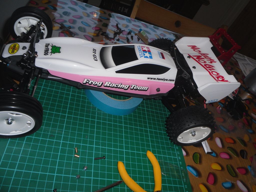

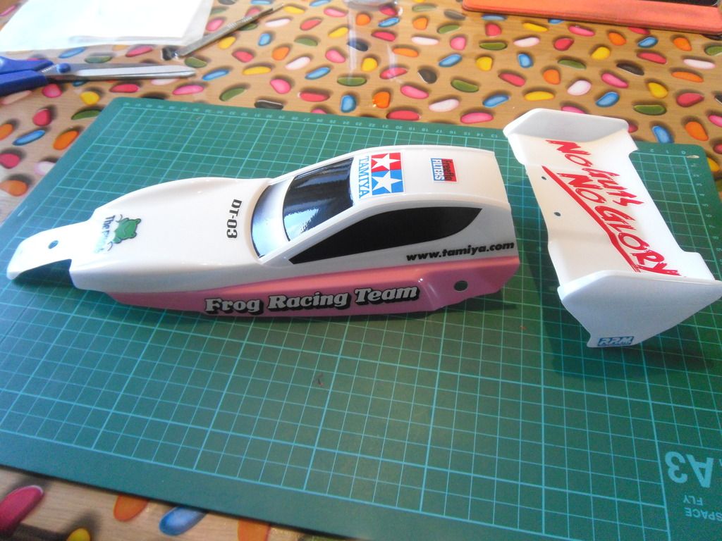

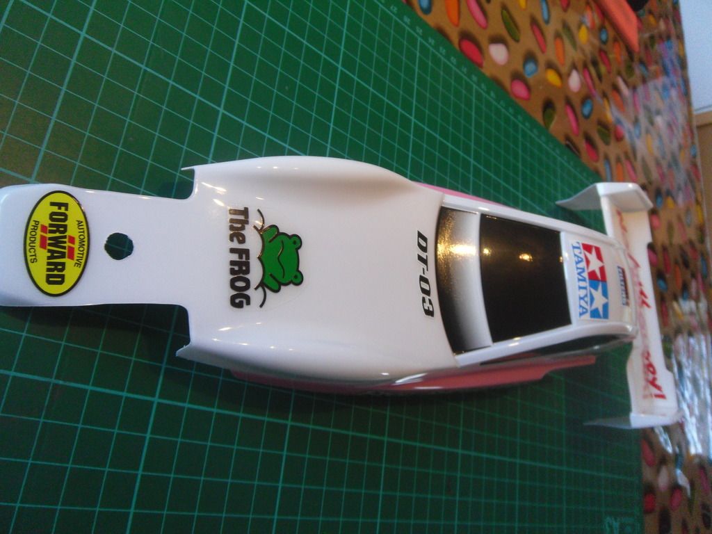

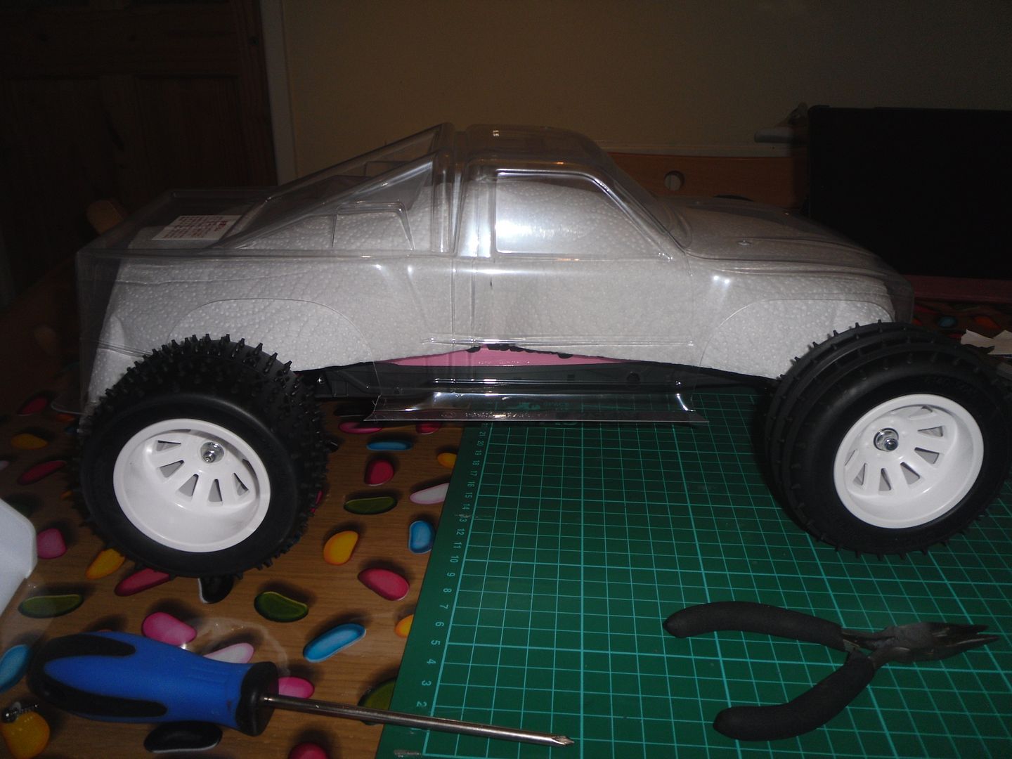

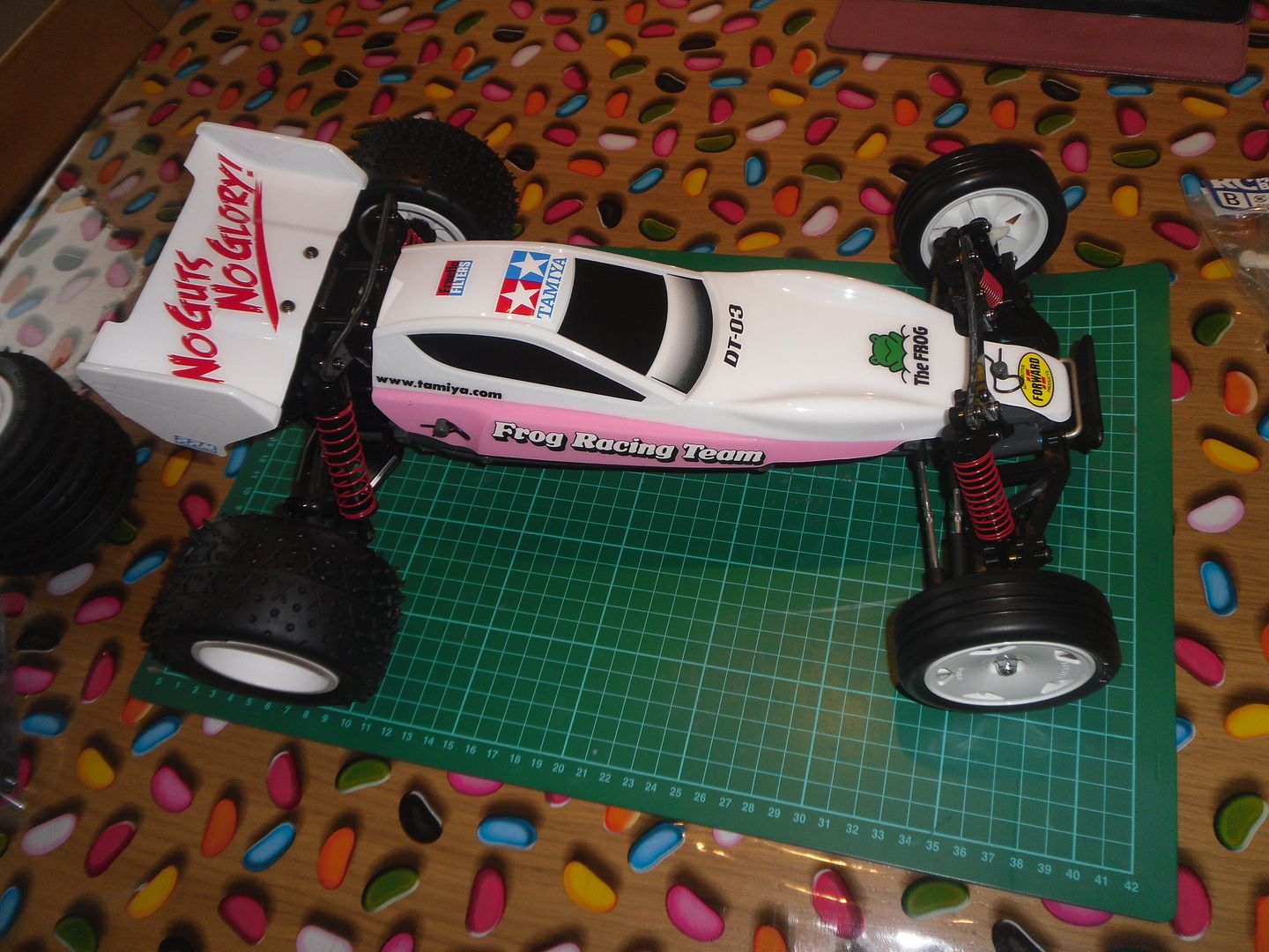

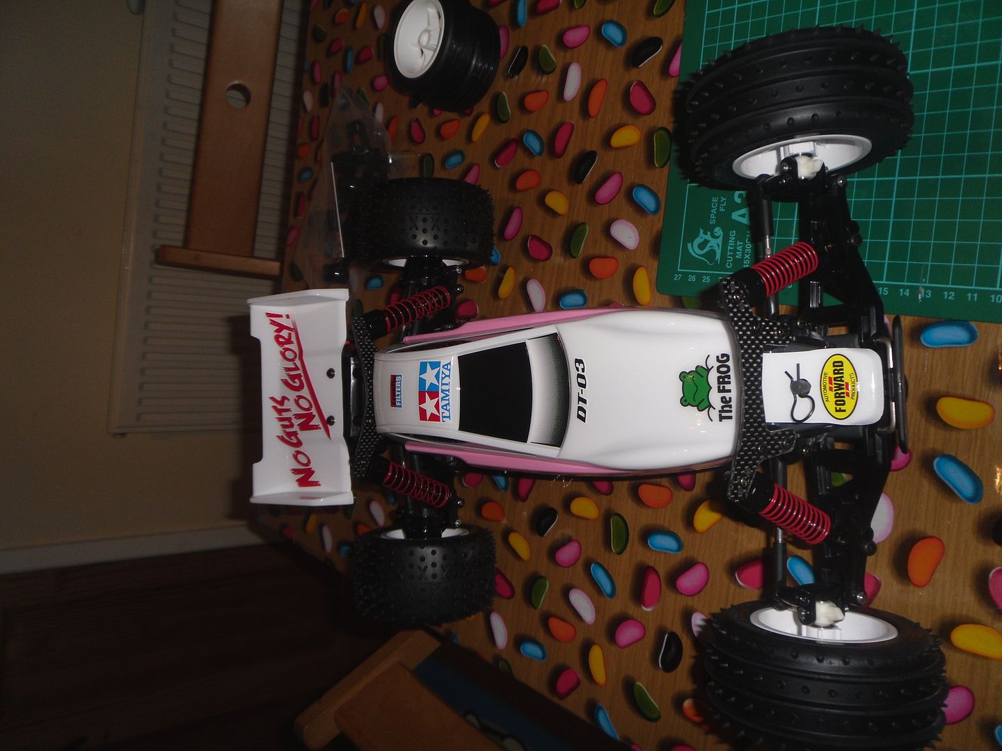

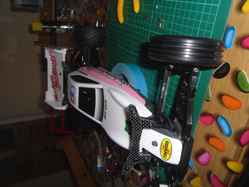

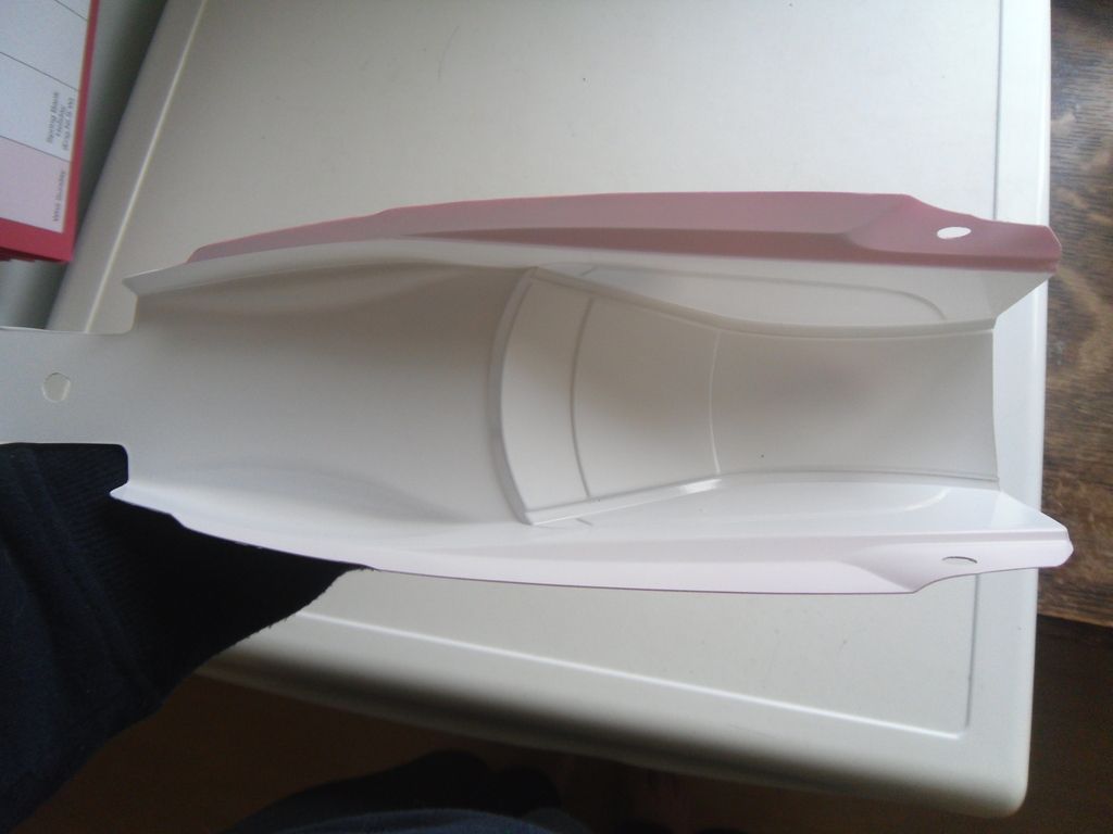

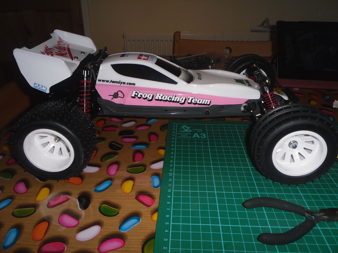

Inline with my new ethos off doing the body first i gave this an hour or so today
Going with Frog ish White over Pink
Not a perfect job but I want a basher I am not worried about running, my driving is appaling.

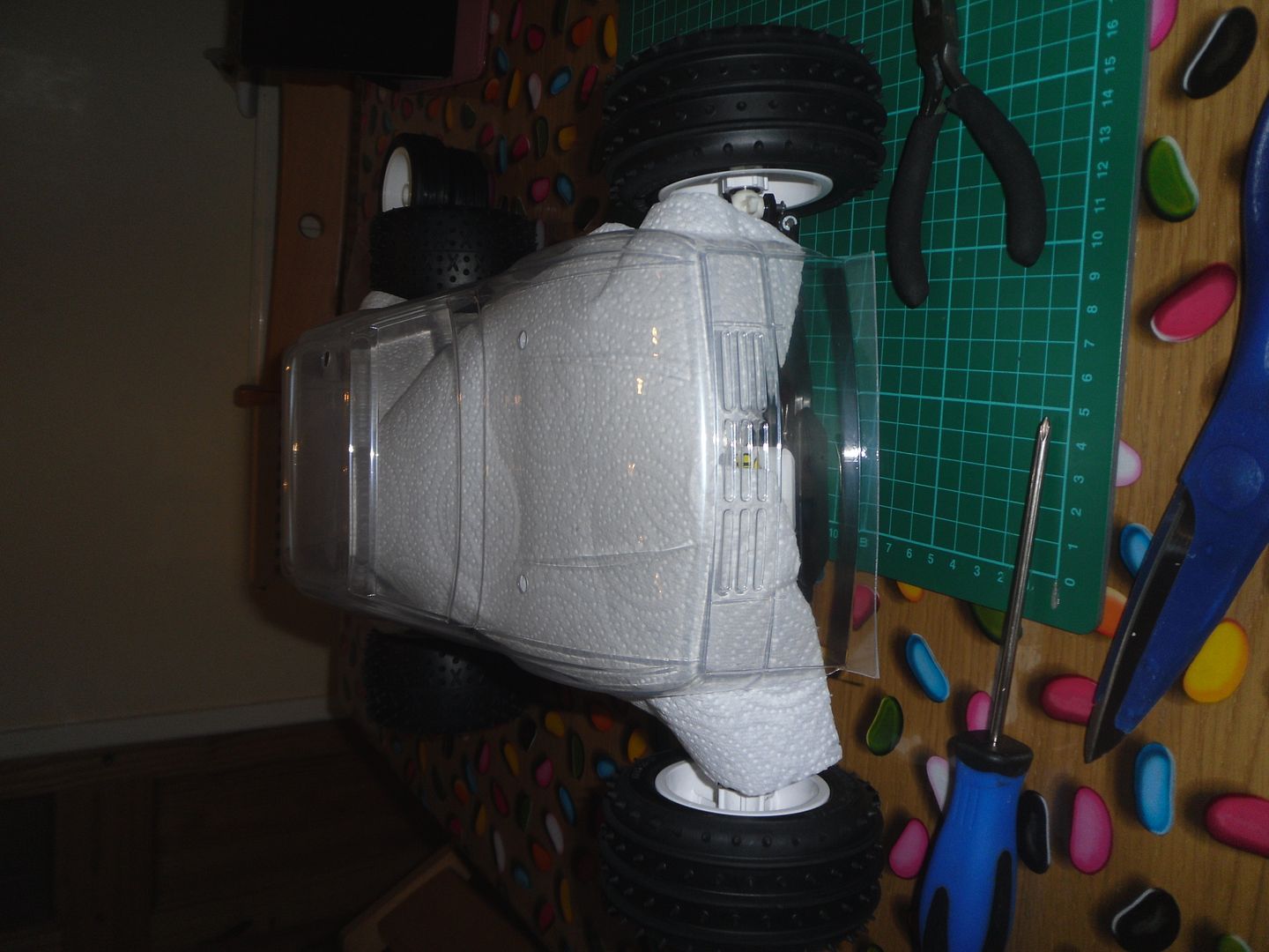

Little rough from the tape
And a small de-greasing accident
Stickers and chassis to follow
Radio Control Car Action has a great article in the July 2015 issue on the new DT-03 Aqroshot and the Neo Fighter Buggy is also mentioned:
I'm not sure I'm too keen on the DT-03 chassis so I'm really looking forward to your build and driving impressions. Subbed. ;) You didn't mask the windows? Are there stickers for blacked out windows like with the Desert Gator or do you just not care about clear/translucent windows given it's basher status?
There are black window stickers in the kit. This might get Aqroshot wheels by the end of the build but I will try stock first.

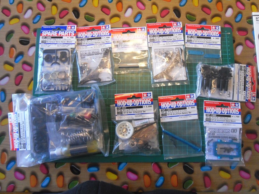

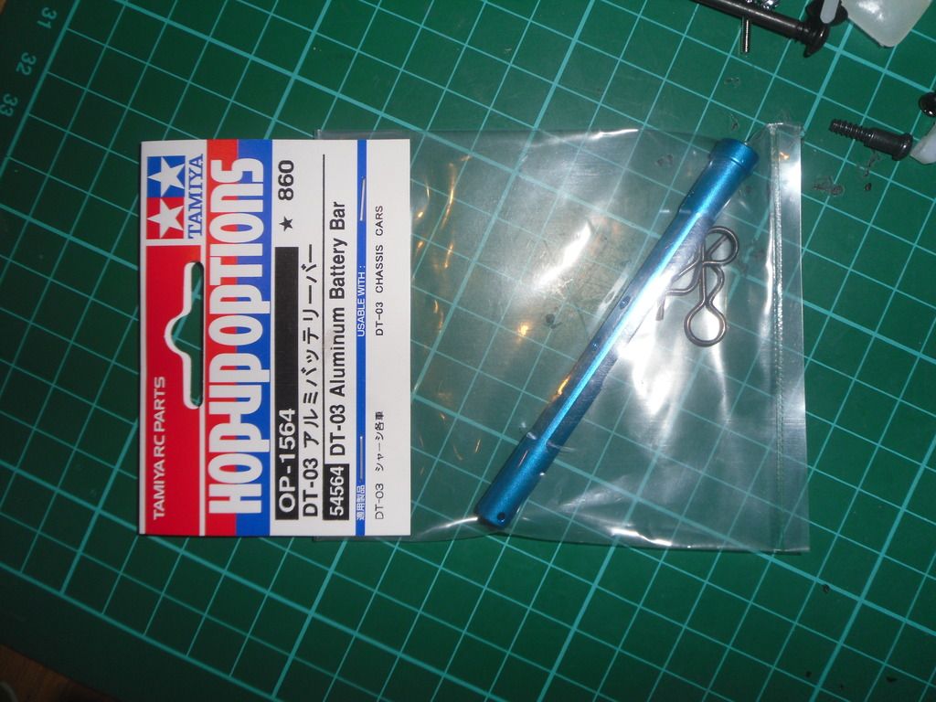

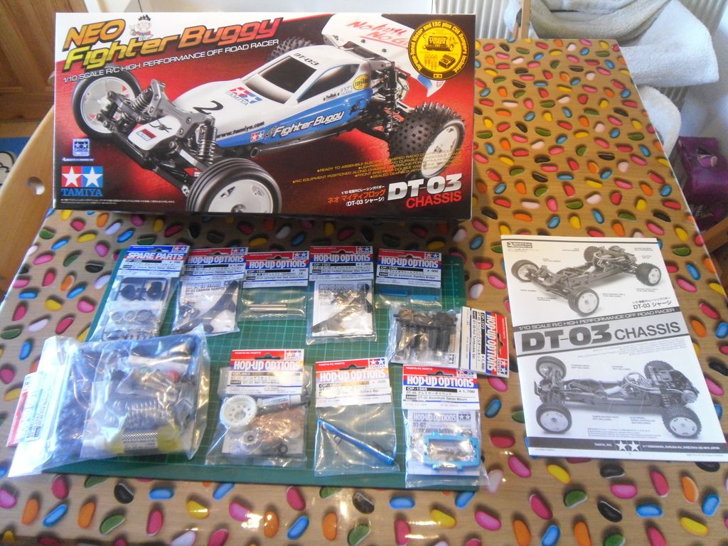

I have had this for a while so have amassed a few hop-ups

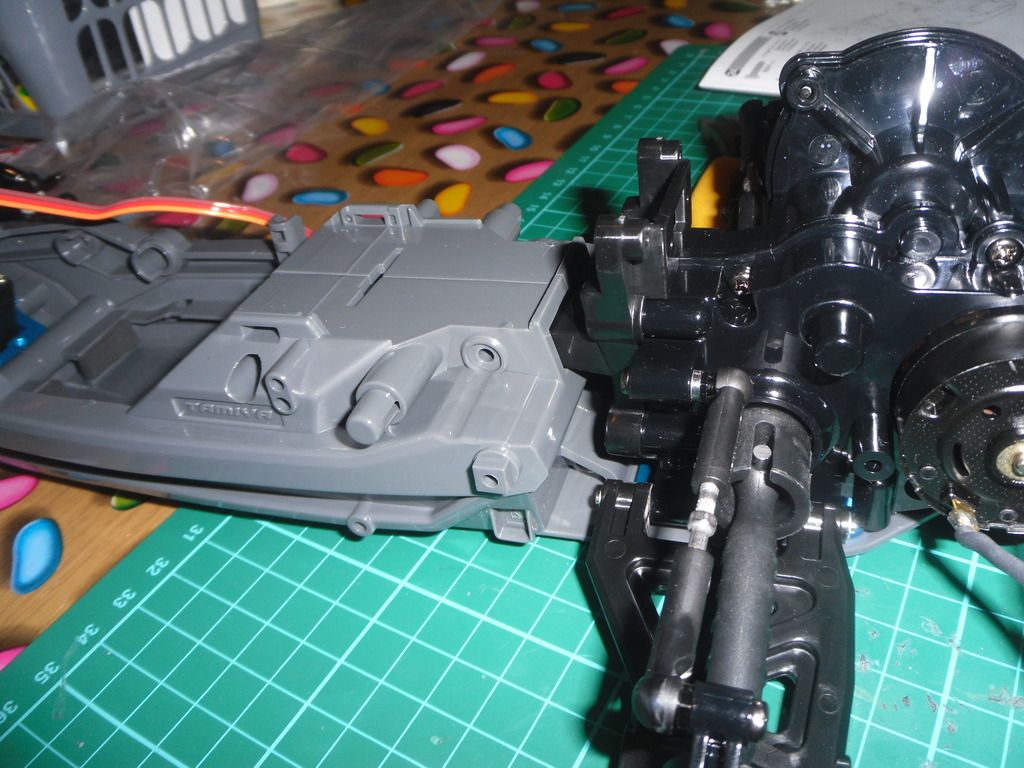

First things first, the boat like chassis
Spongy stuff to hold battery I guess
Must have forgotten to take a pic of the finished article
Front mounts. Shame there is no alloy hop-up for these

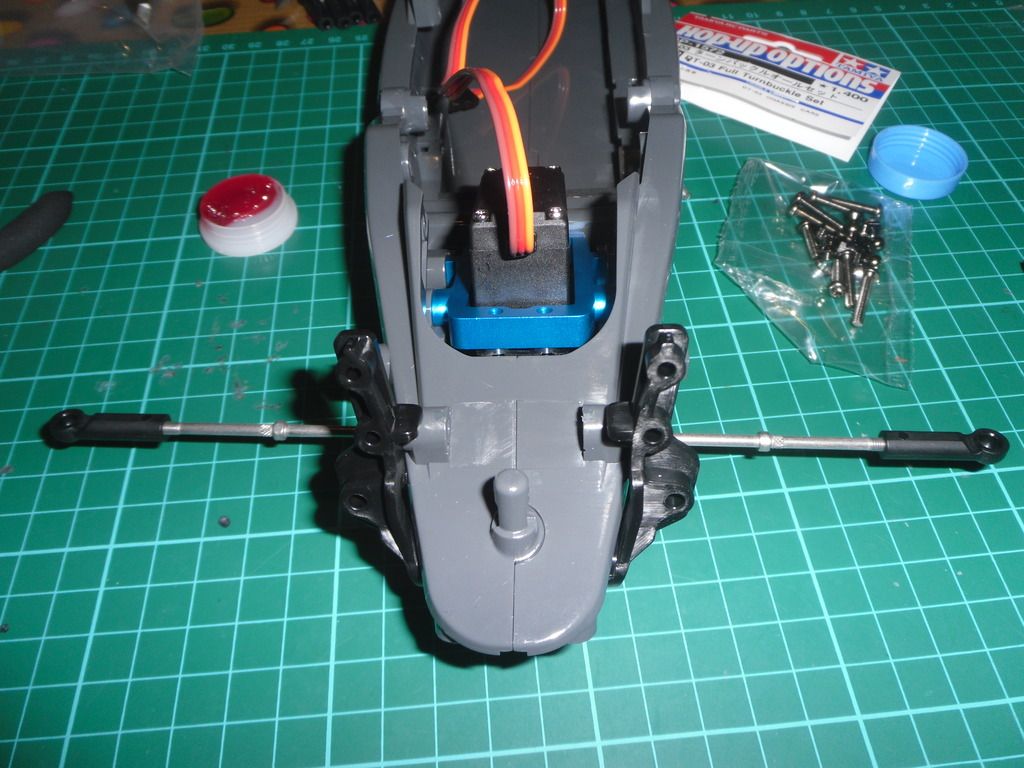

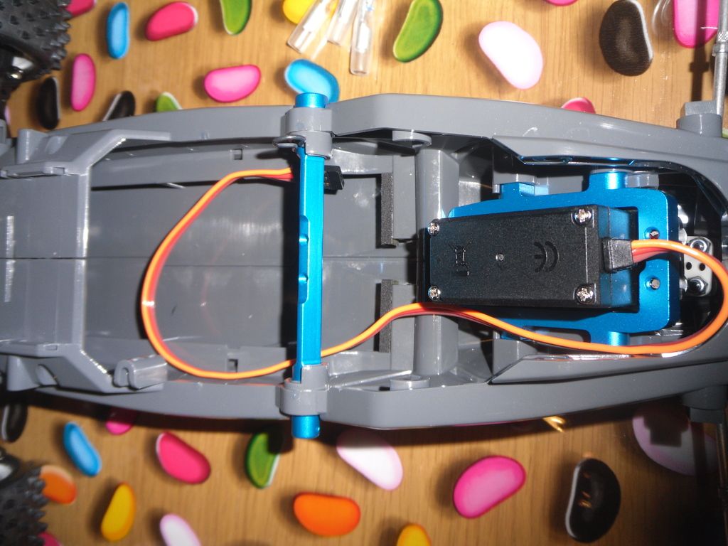

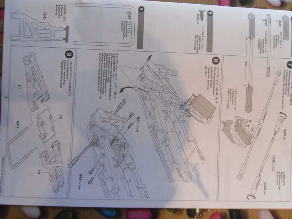

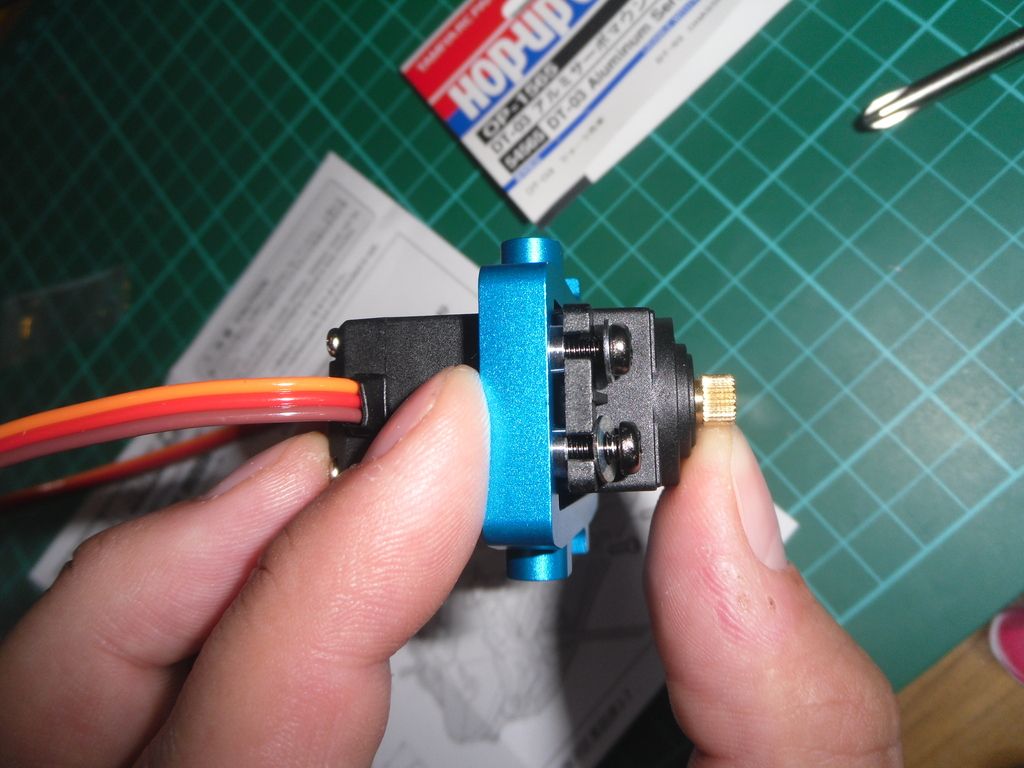

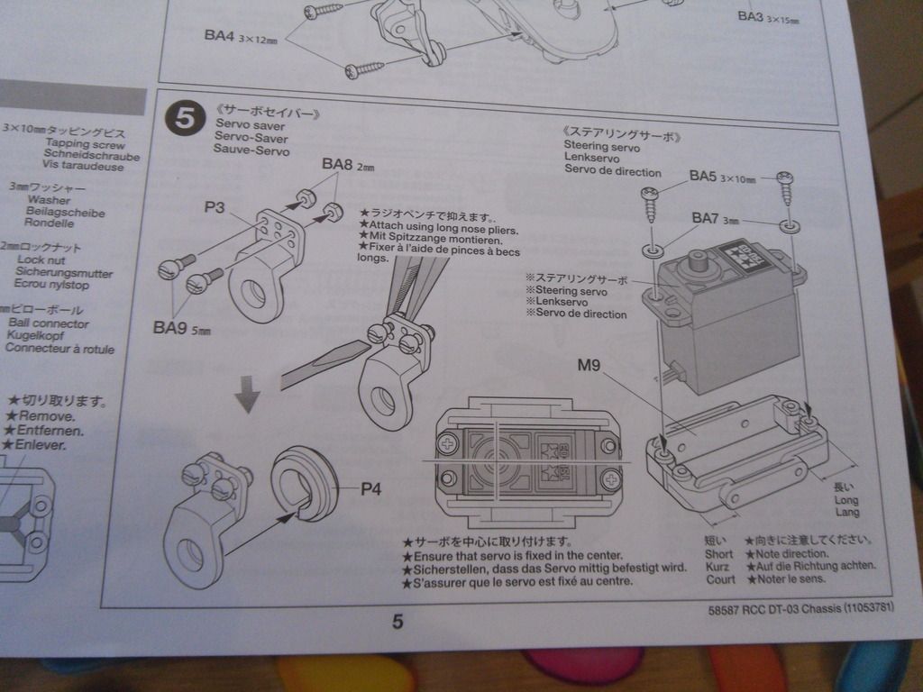

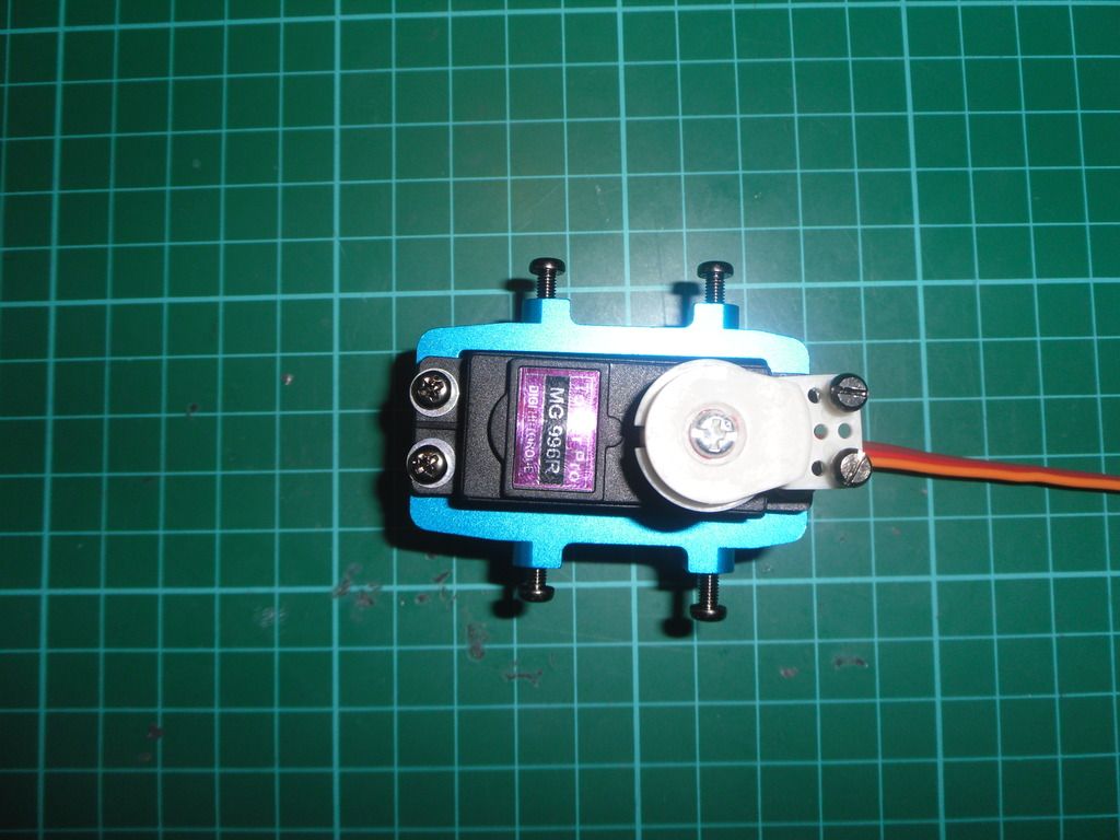

Next, Servo

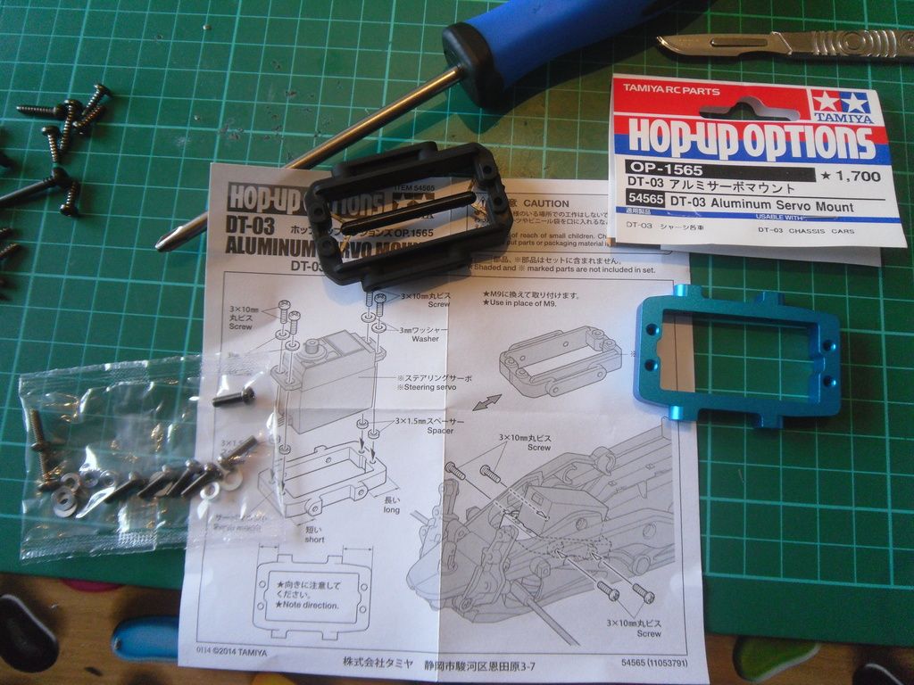

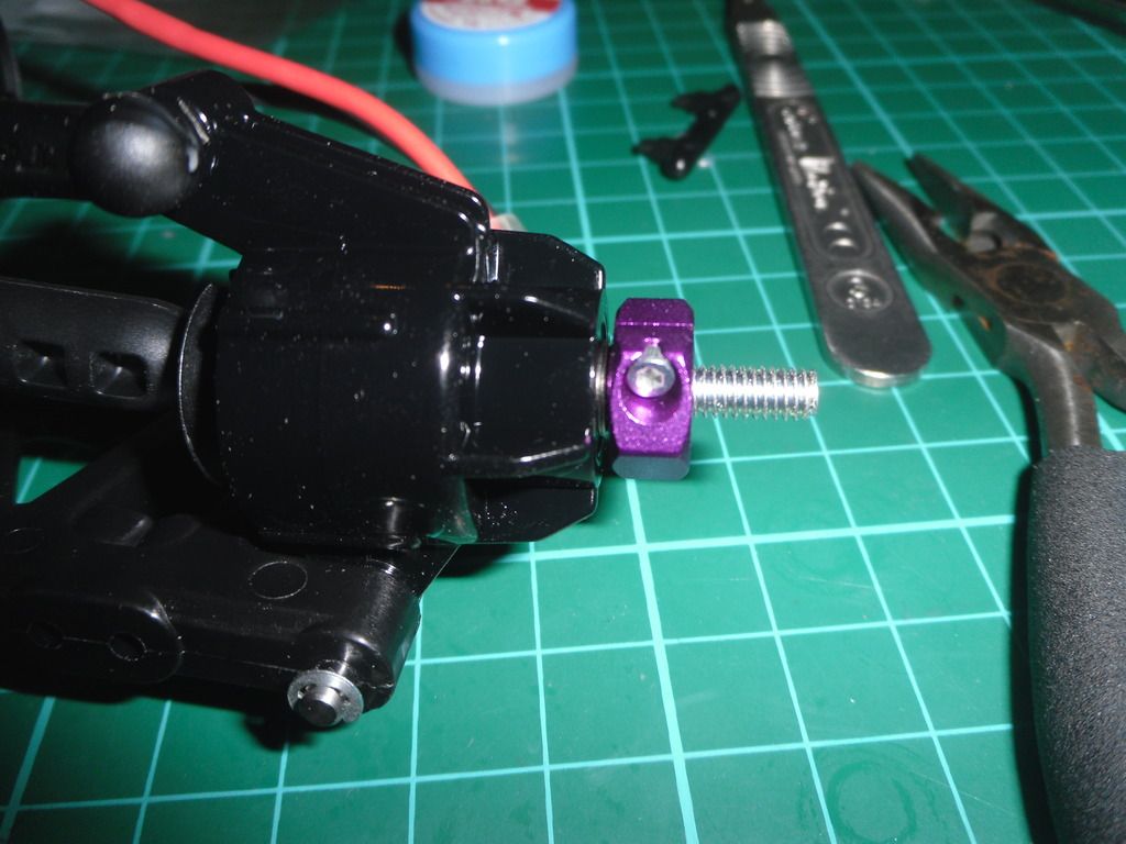

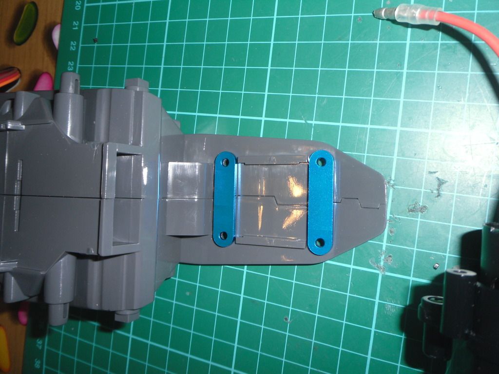

First hop-up. Alloy servo mount

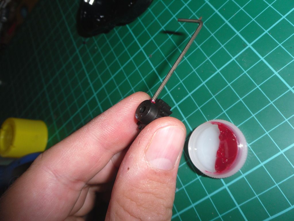

Lets do it again with a bit of thread lock
End of day one.
Lets put the servo mount in

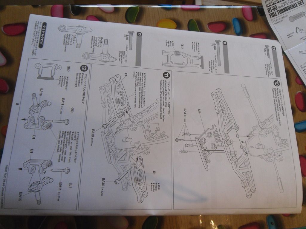

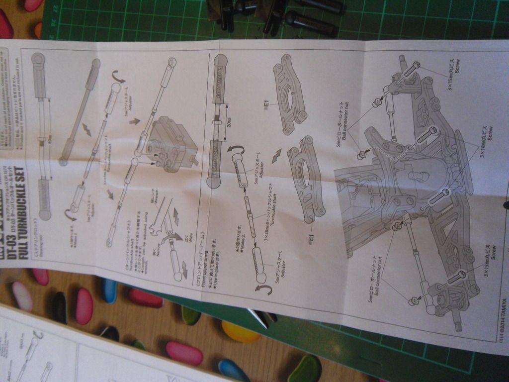

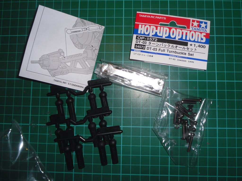

Next hop-up, turnbuckle kit

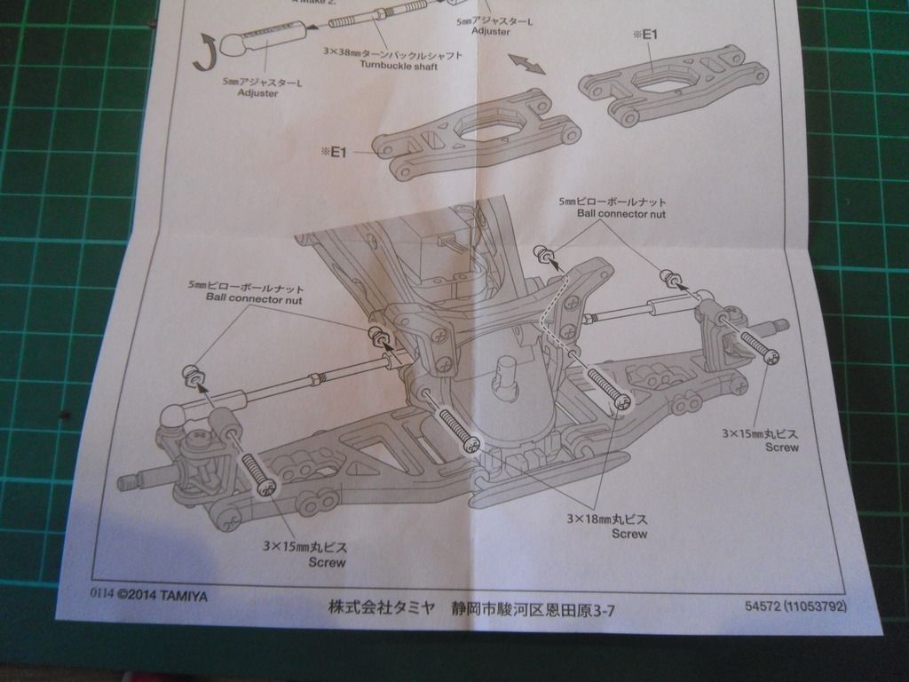

Lower arms

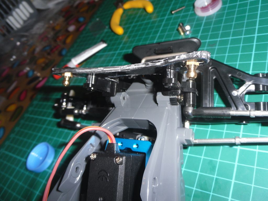

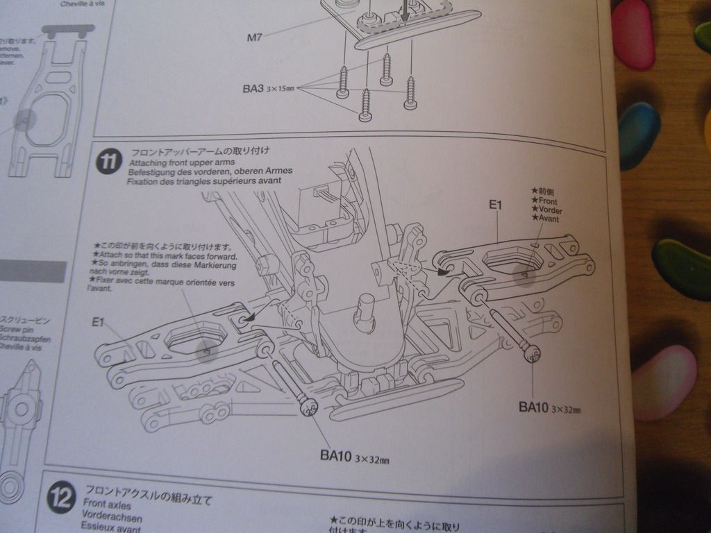

Upper arms not going on
Instead we will fit

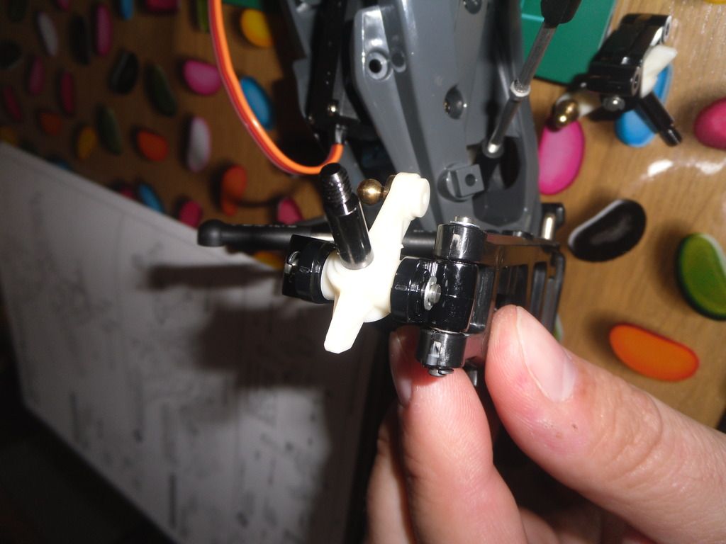

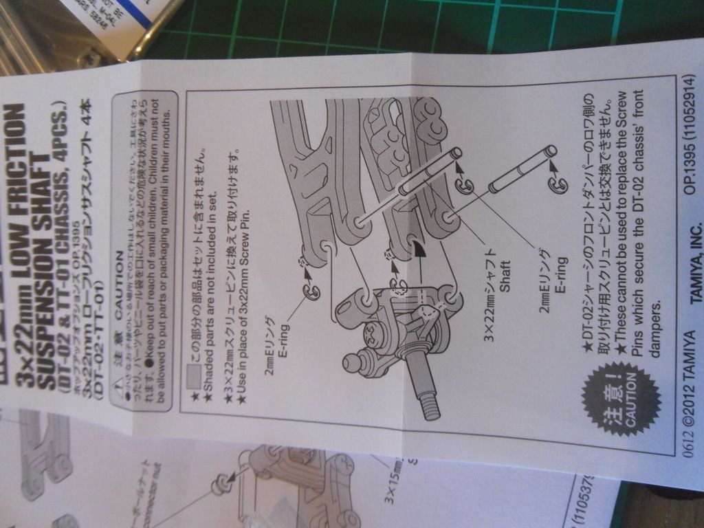

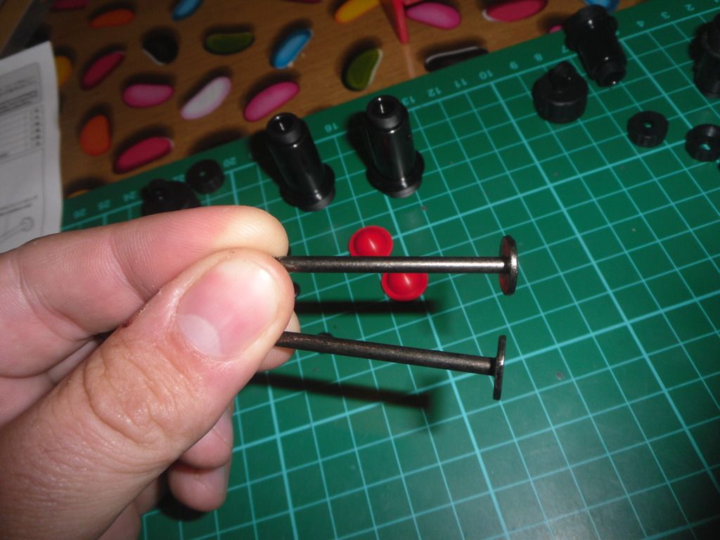

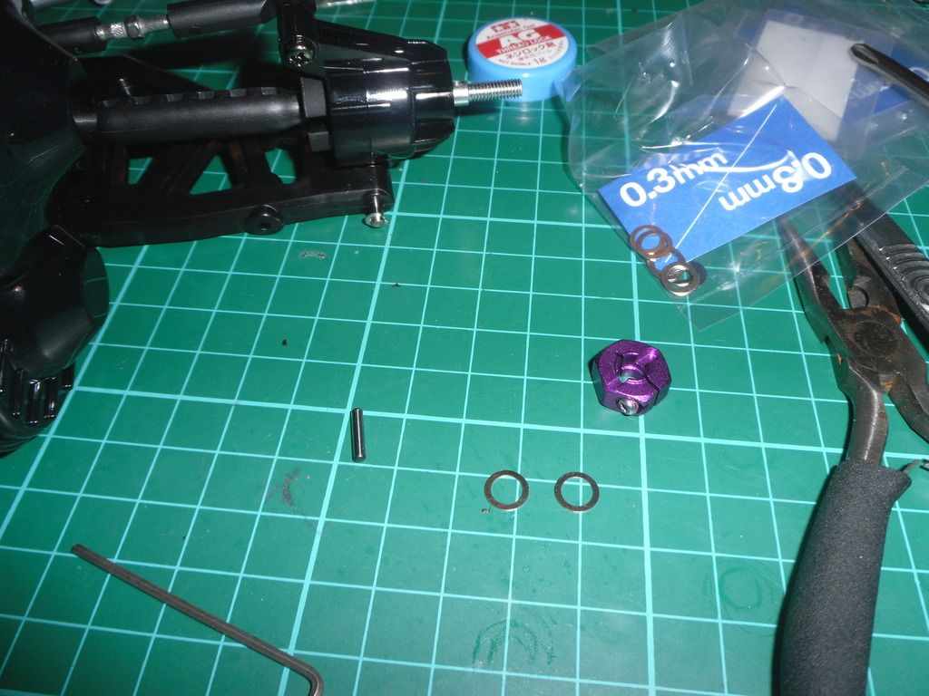

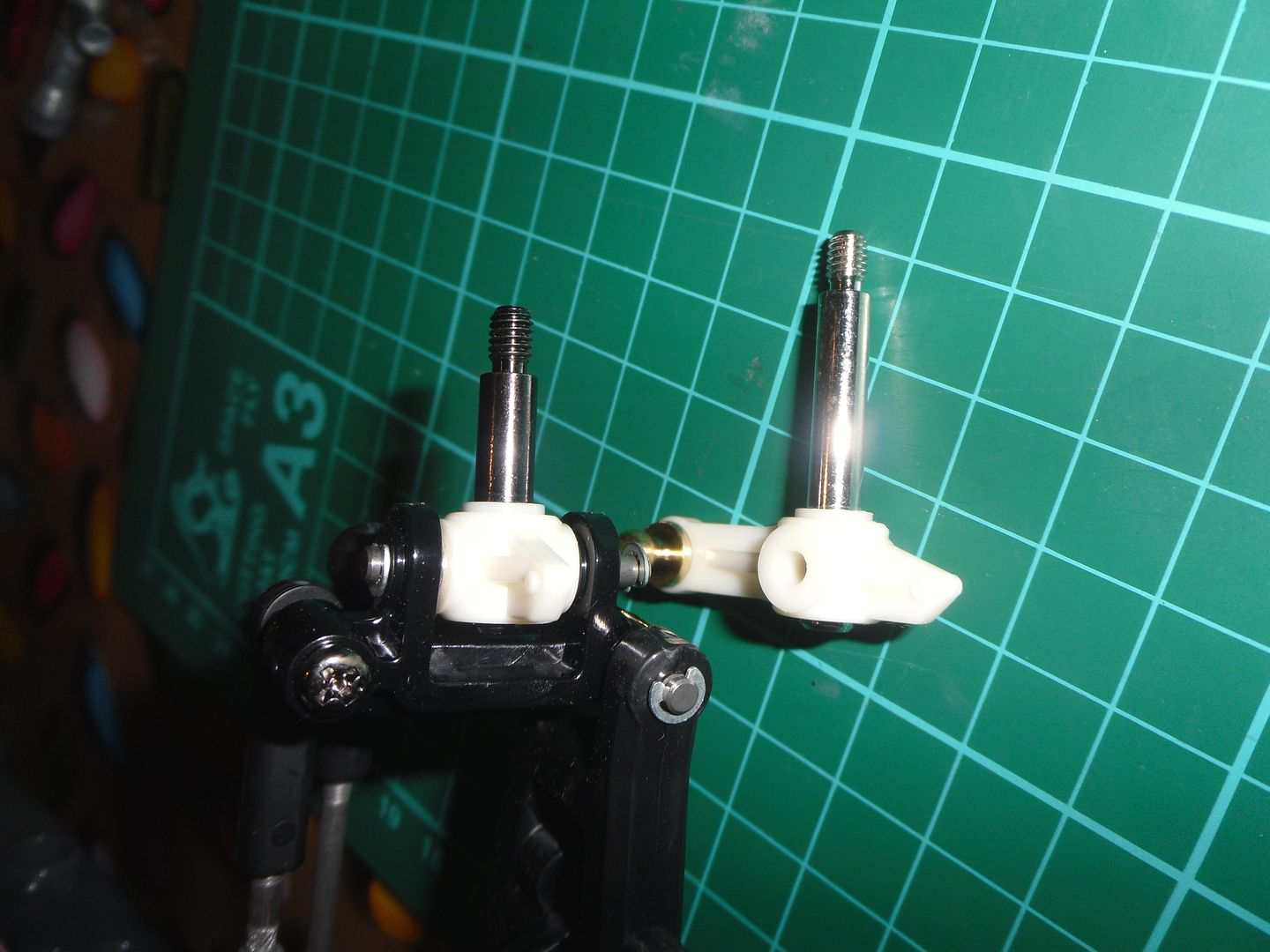

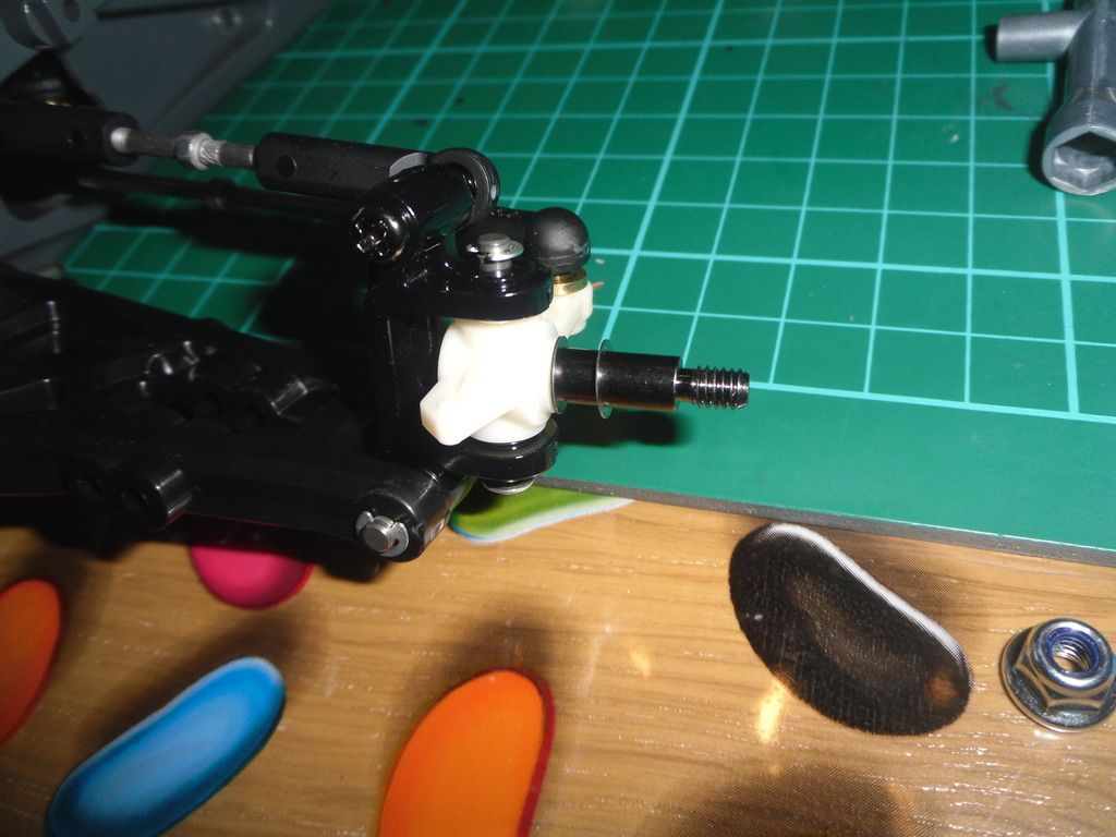

Next hop-up. Suspension Shafts. I will not need the top ones because I am running turnbuckles so I though I would use them on the pivot. Good idea?
Lots of gap here. I remember this from my DT-02.

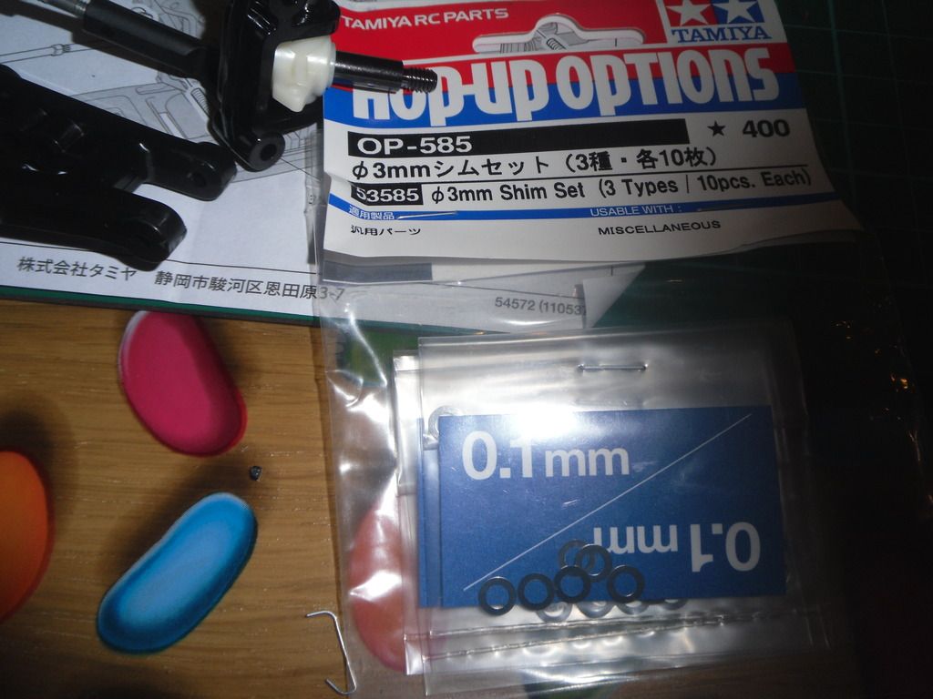

Spacer kit I had in stock. 0.5mm and things are a lot less sloppy
More shims for the lower arm
The only issue is I need to go back to the U shaft on the other end and shim that. I know this is not a top notch racer but I want to take out as much play as possible

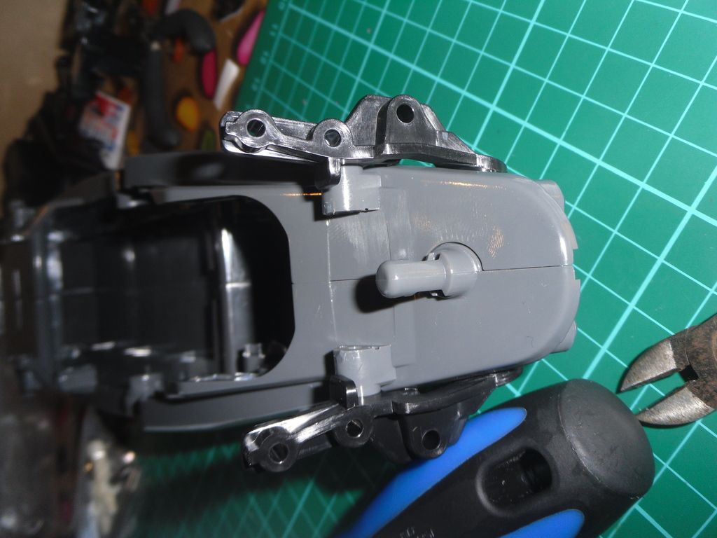

Gearbox next and I have still not decided about Diff or drive shafts
The tub is a very tough plastic. I am thinking it will be much of a muchness on the toughness front. Longer wheelbase is supposed to help handling but I am a bad driver so I will never notice. To be honest I a wasting my time with the shimming but it is fun.

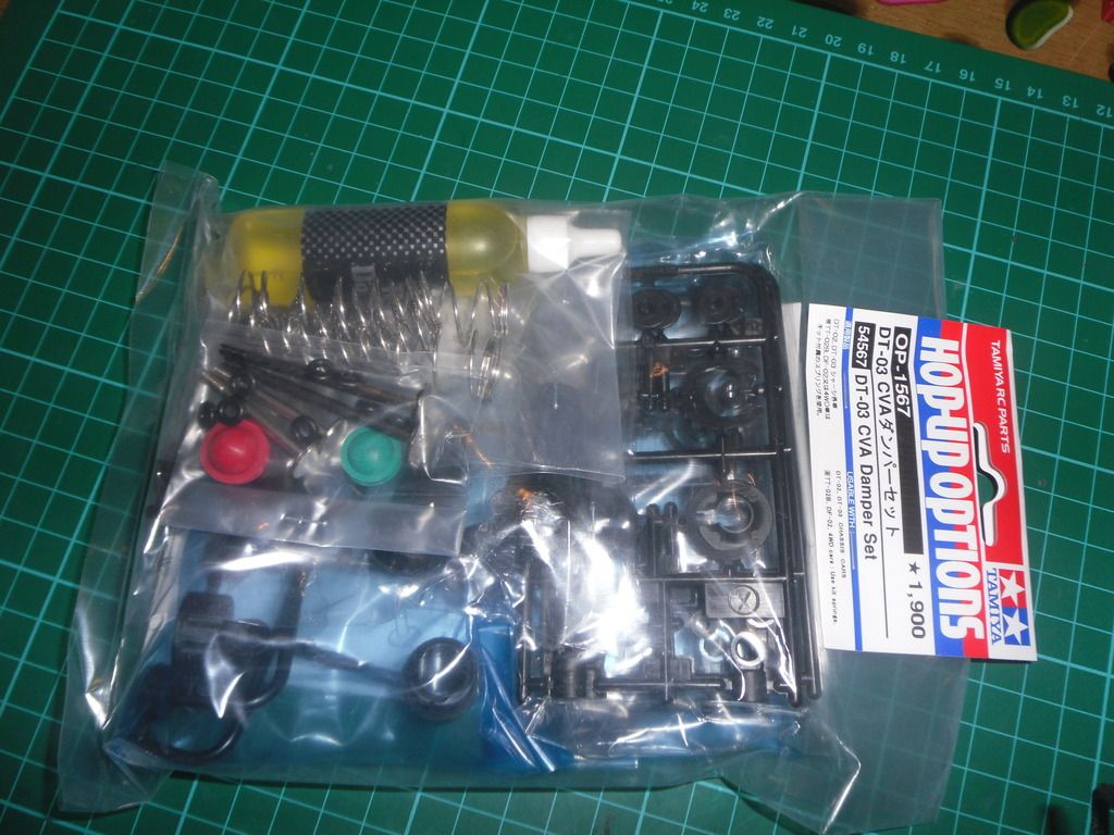

I noticed you bought a CVA hop-up shock kit, aren't they included in the kit??
Nice bodywork.
They are but I robbed them to use on my DT-01. I have a set of Absima dampers I was going to use but I am happy with the CVAs on my DT-02 so I think I will run with them again.

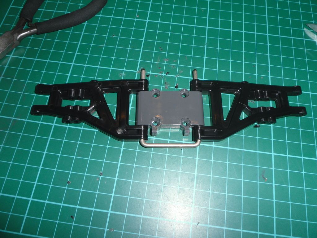

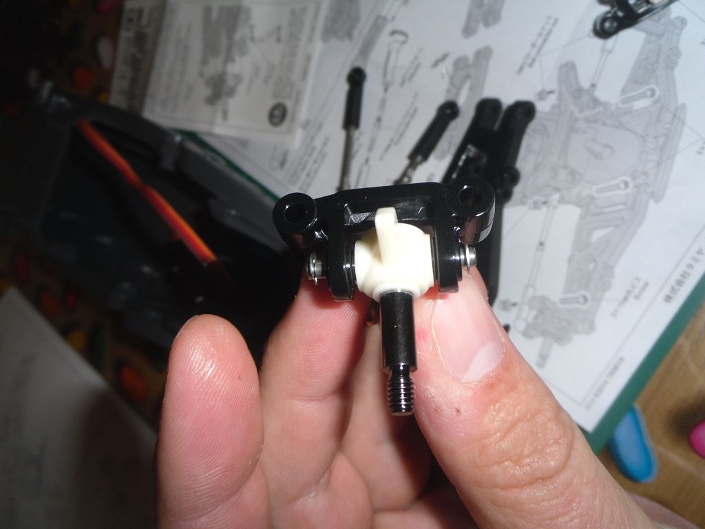

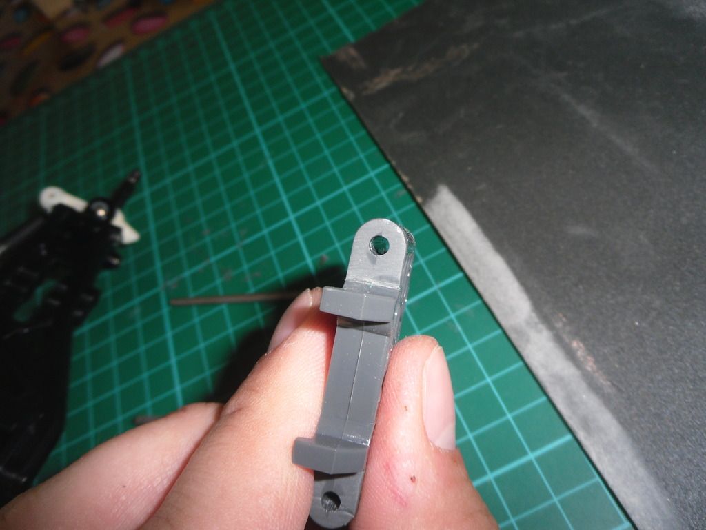

So I had to shim the U fastener to take out all the play.The casting marks leave a little step so I whipped that off with a little 400 paper and put some 1mm shims

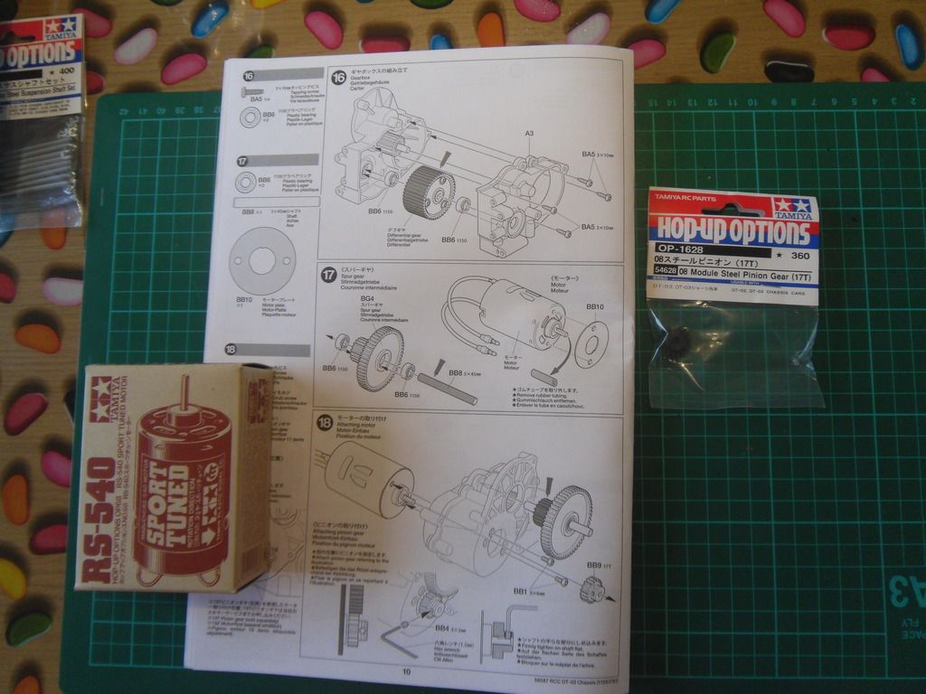

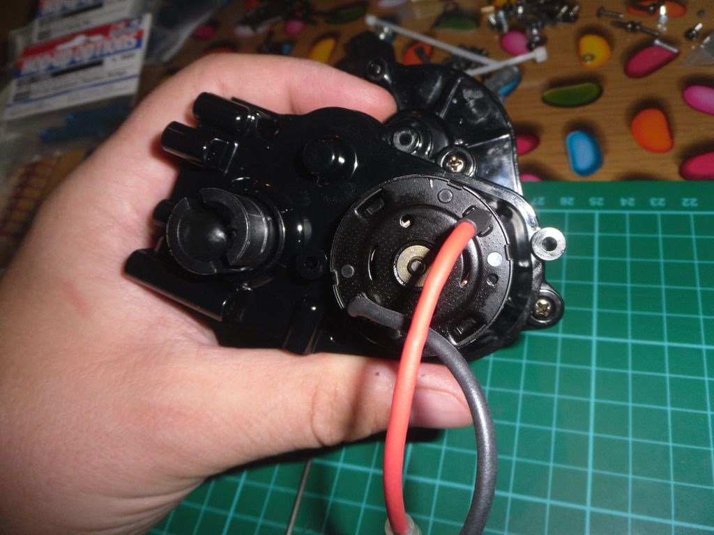

Gearbox next, I am going to build this stock for now with just TRF putty.
Sports tuned and steel pinion

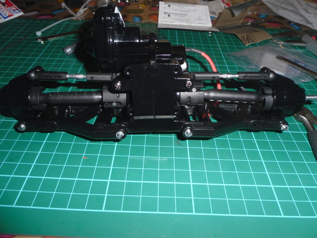

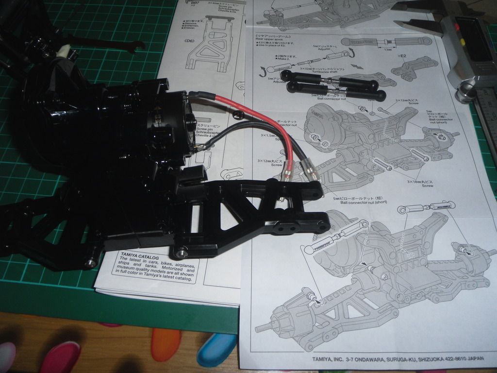

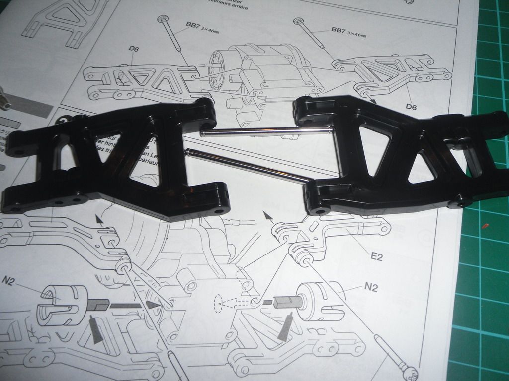

Rear lower arms
Shimmed like front
Done

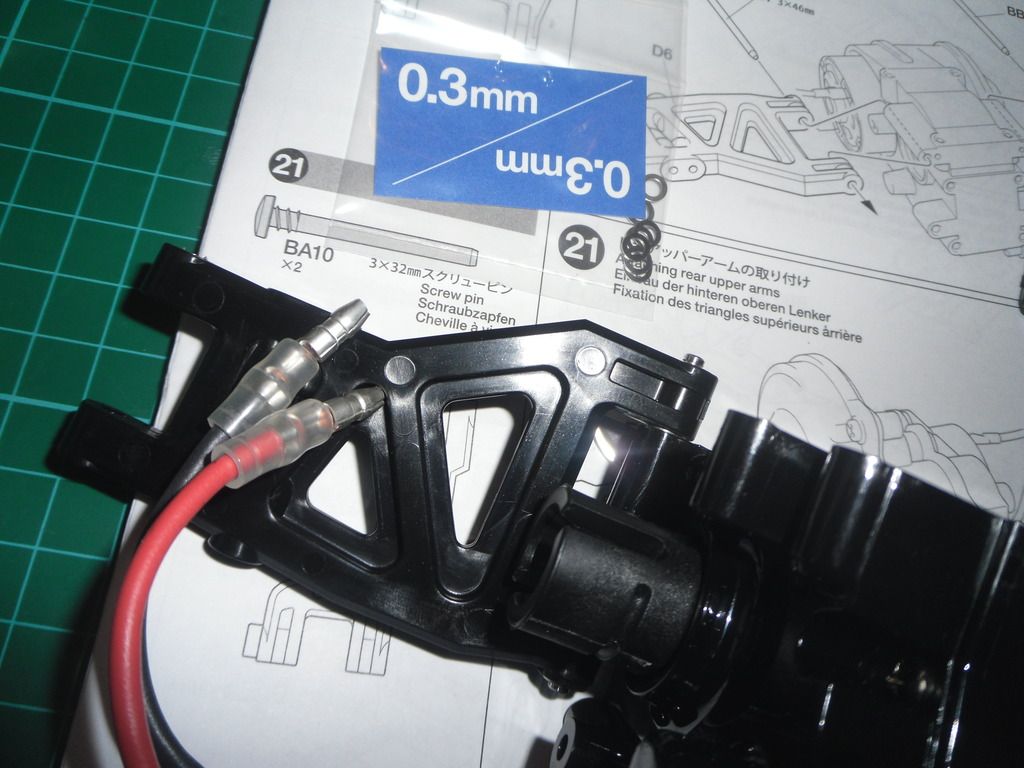

Hexes and more shims
0.6mm takes all the play out

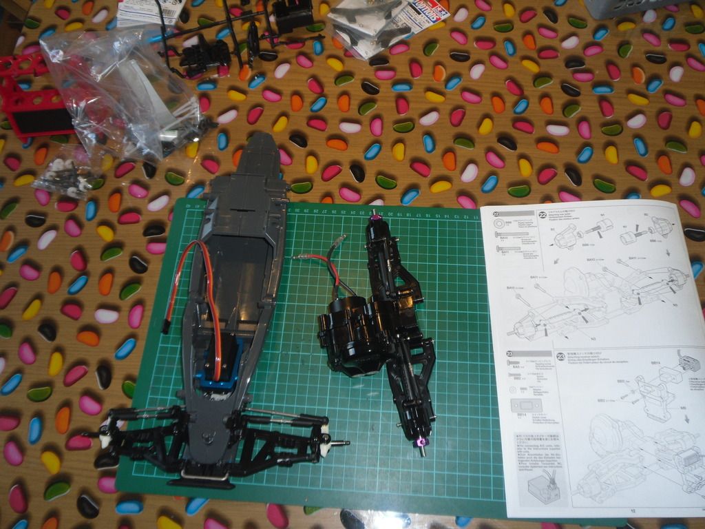

Another day

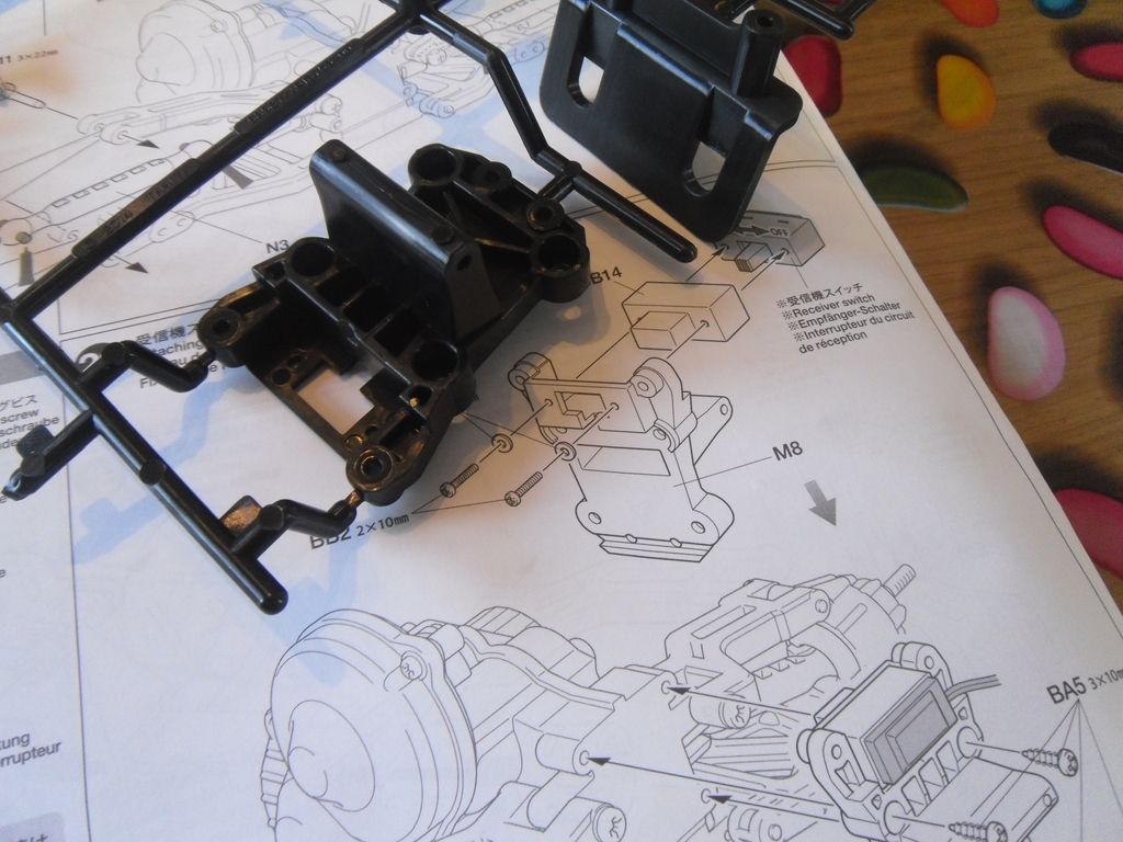

Different mounting for the DT-03 from the DT-02
Another hop up. Not sure if these add value or not
Interesting mounting system.

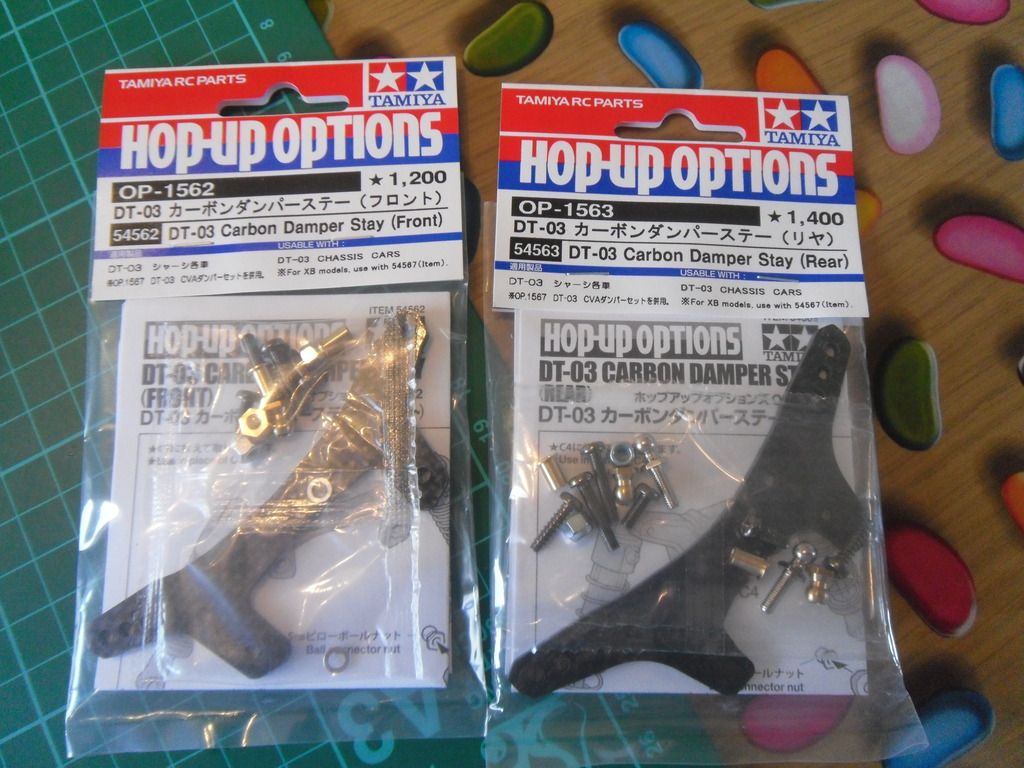

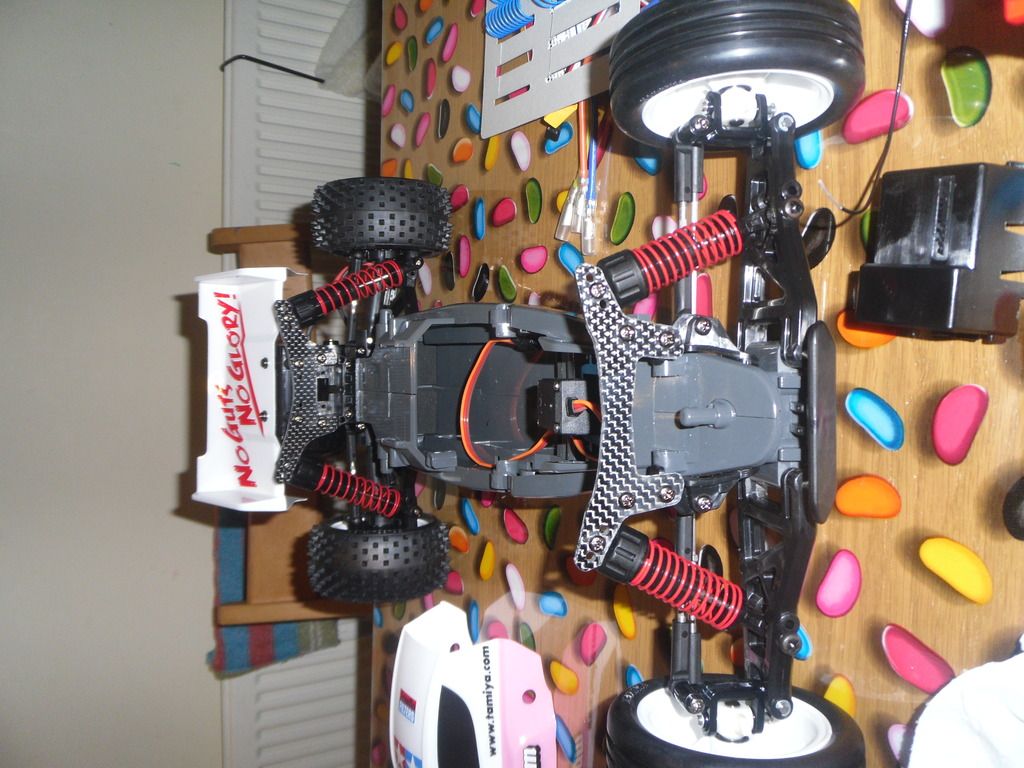

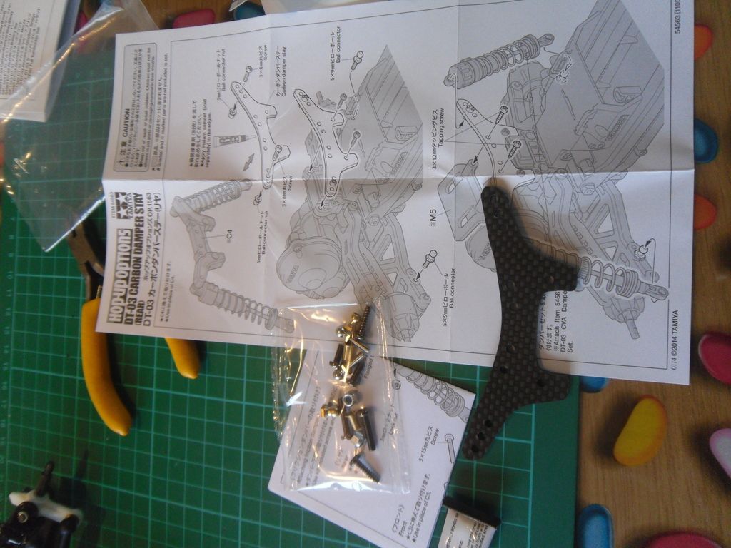

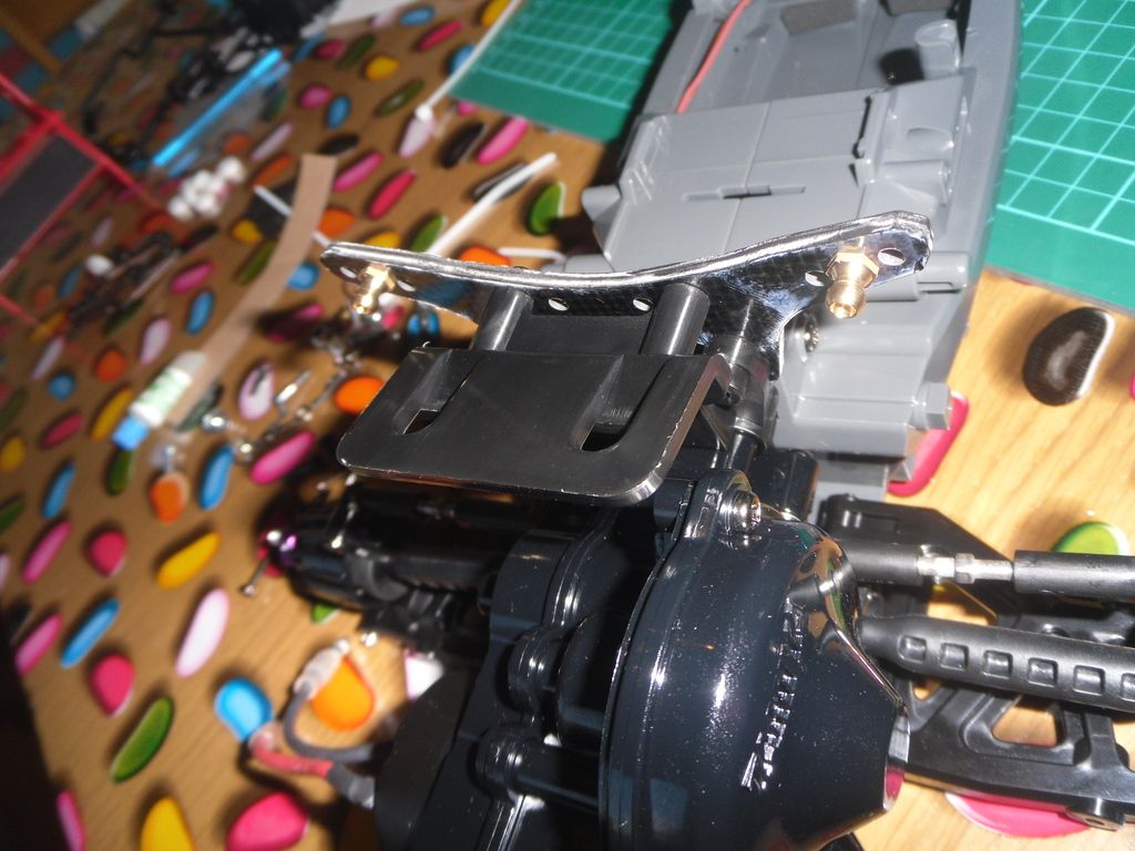

Shock towers next
But not the plastic ones. Total waste of money but looks nice

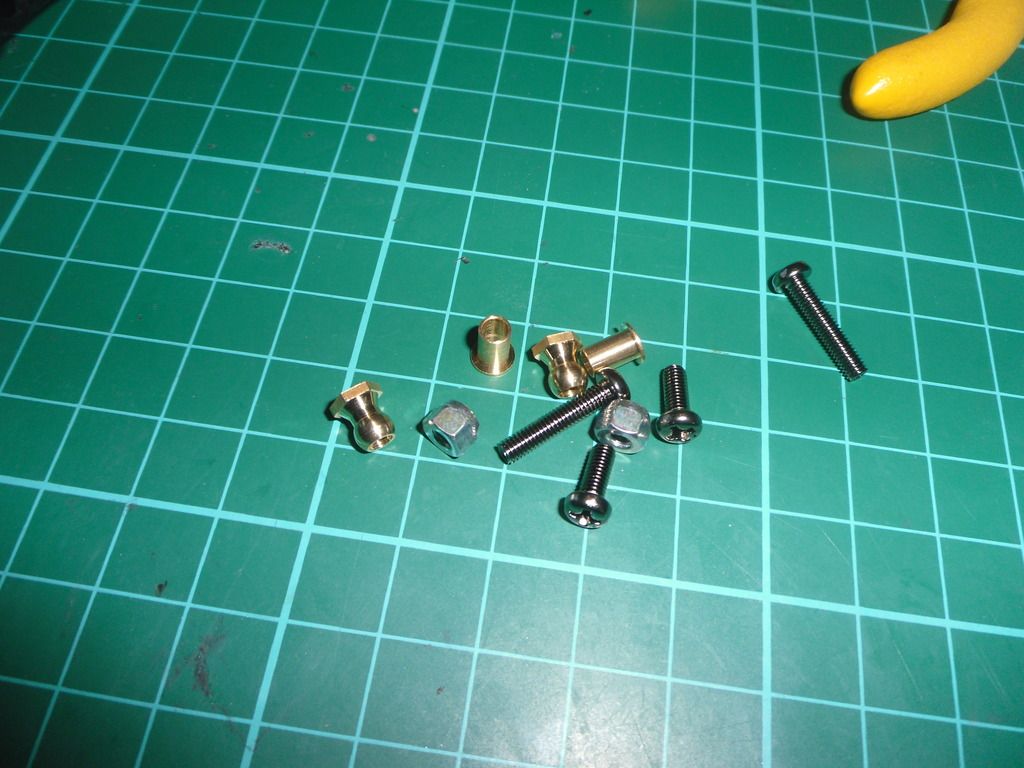

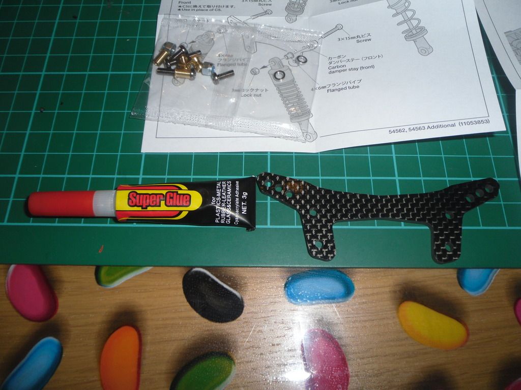

Arrrrgh, brass!!!! WHY!
Super glue needs wiping off but it was not 100% dry
Just like CSI the fumes bring out finger prints

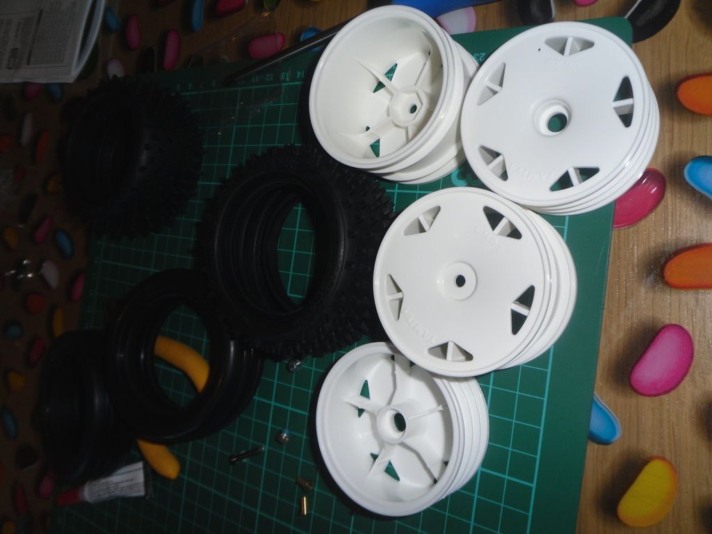

No time to build shocks so straight to wheels
Shimmed
Not finished but had to be done

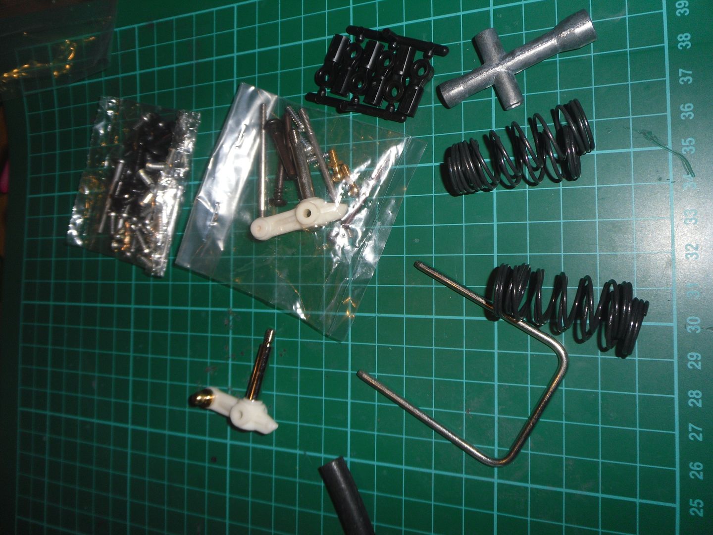

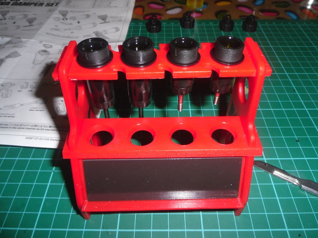

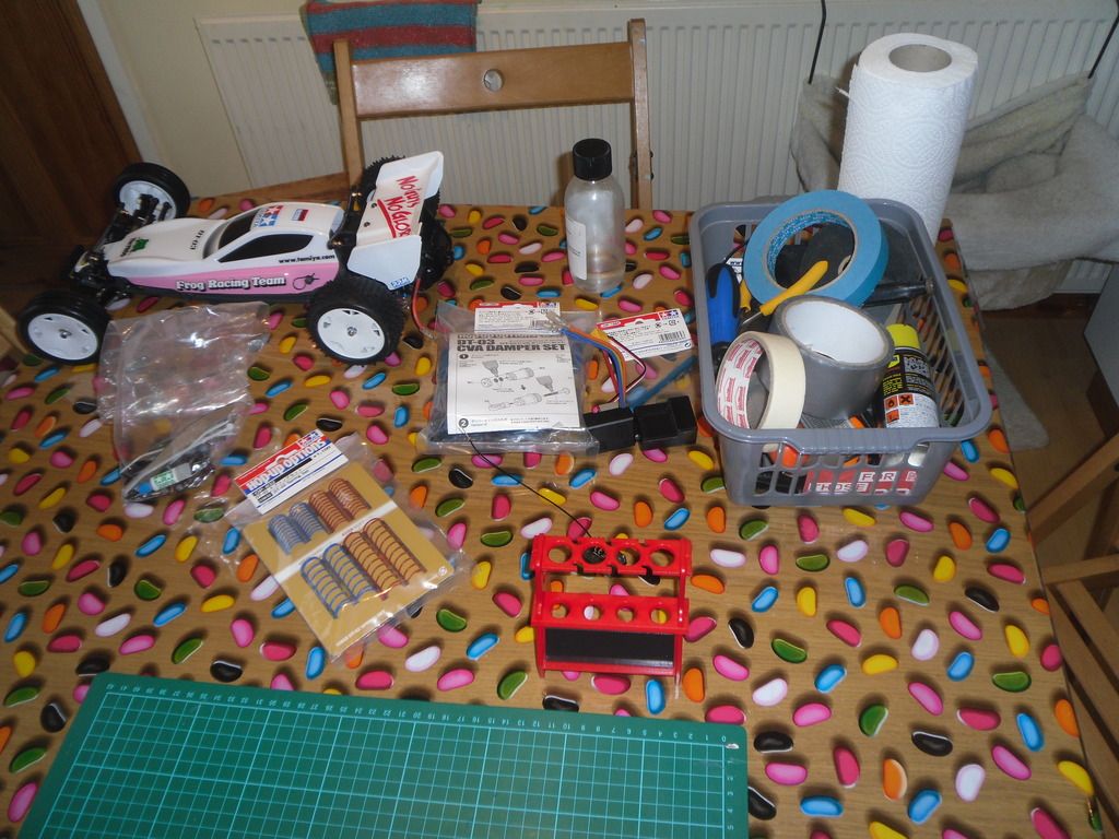

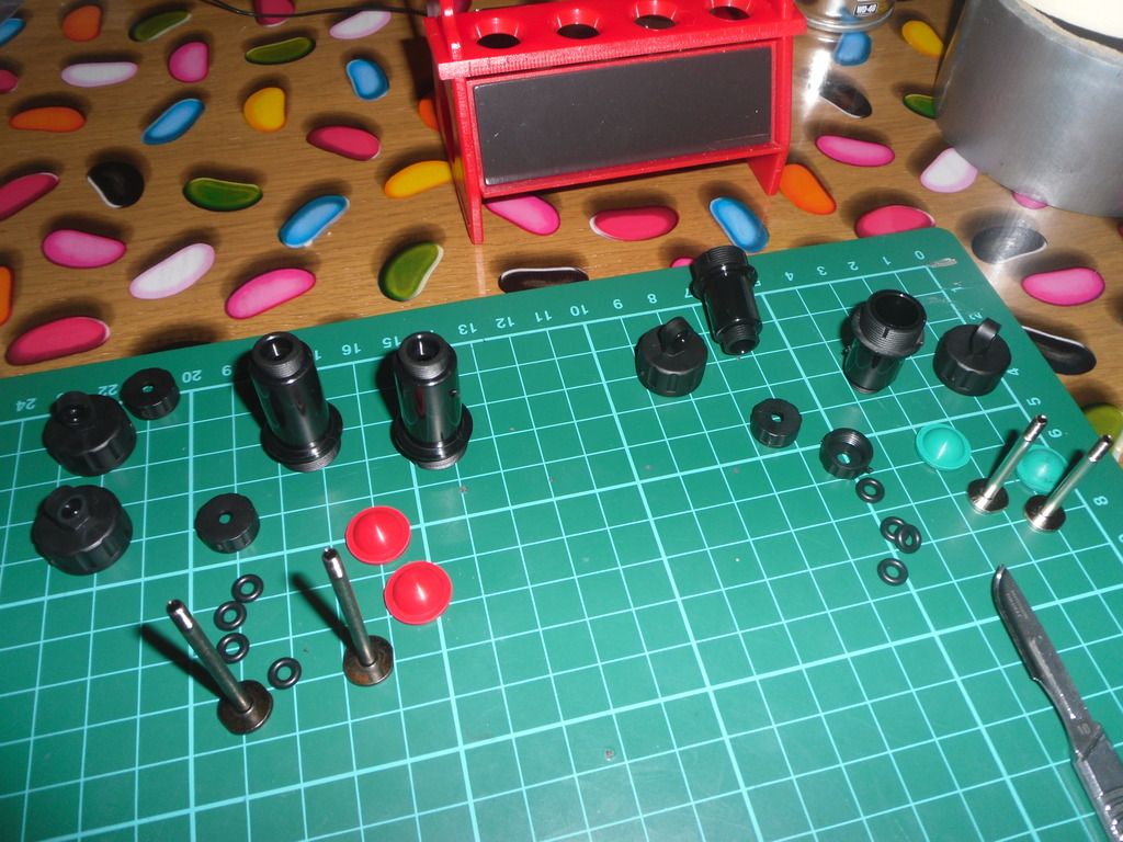

OK just shocks tonight...
Optional dampers, I had robbed the originals out for another build.
I run the red springs on my DT-02 and like them so I thought would start with them. Light LiPo pack helps keep weight down
Everything I need

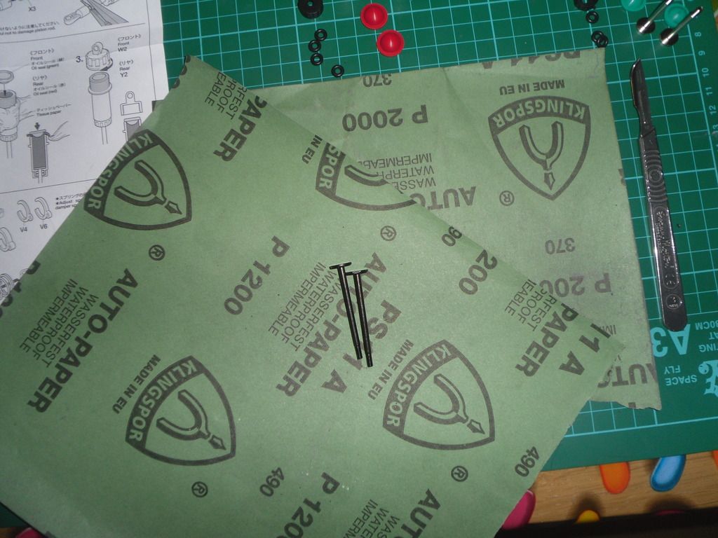

Black coating is not very smooth
Bit of paper for polishing off
Shiny
All filled
Fitted
All filled
That is so much nicer than what I fashion out of a cardboard box every time I need to build / re-build shocks!

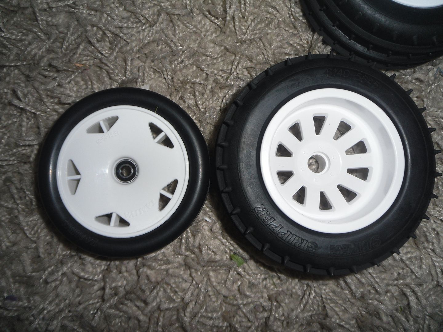

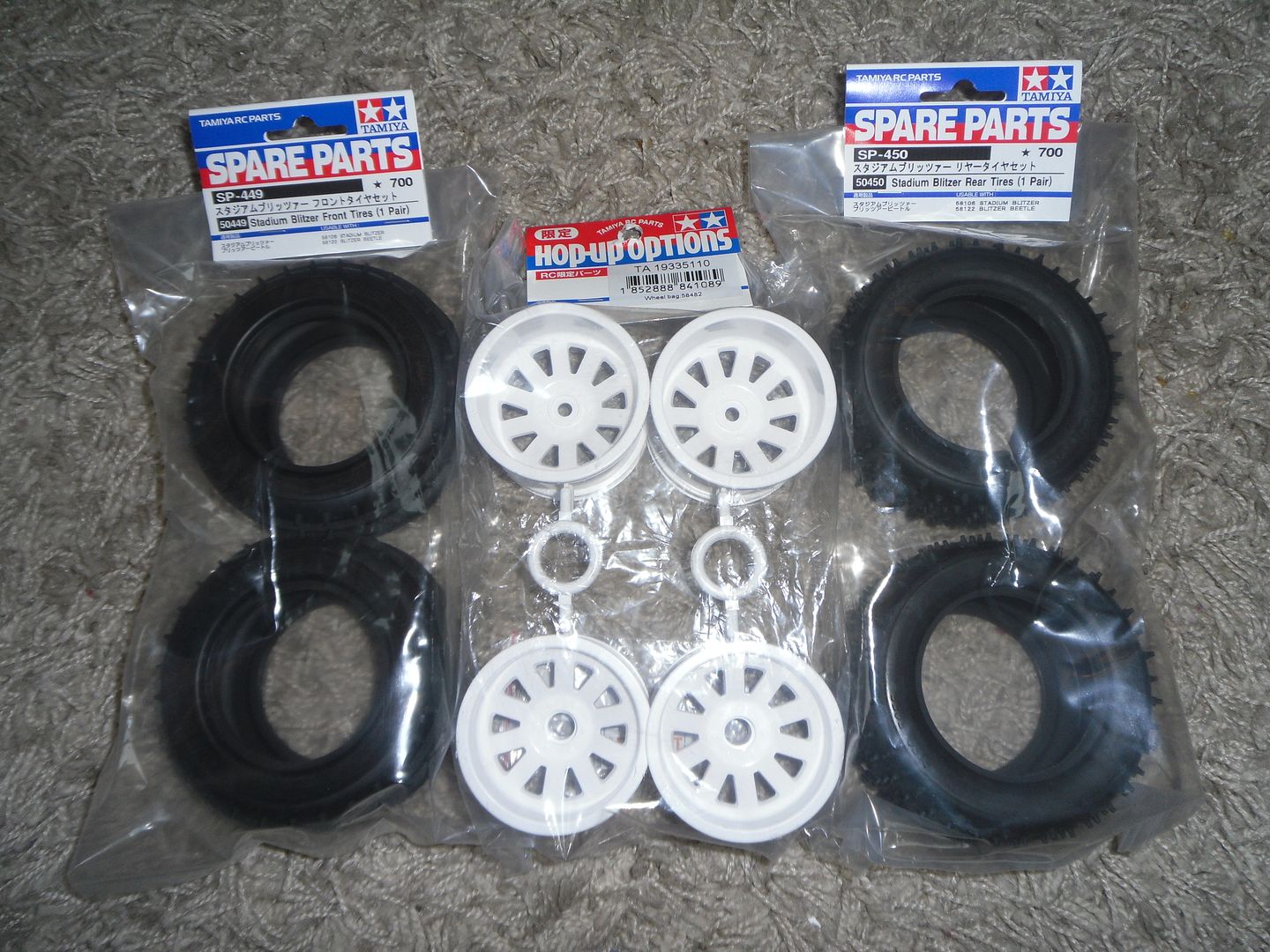

Since that launch of the DT-03T I have been thinking big wheels.
Rears fit great but the fronts need WR-02 axles
progress of time..................................................................................................................

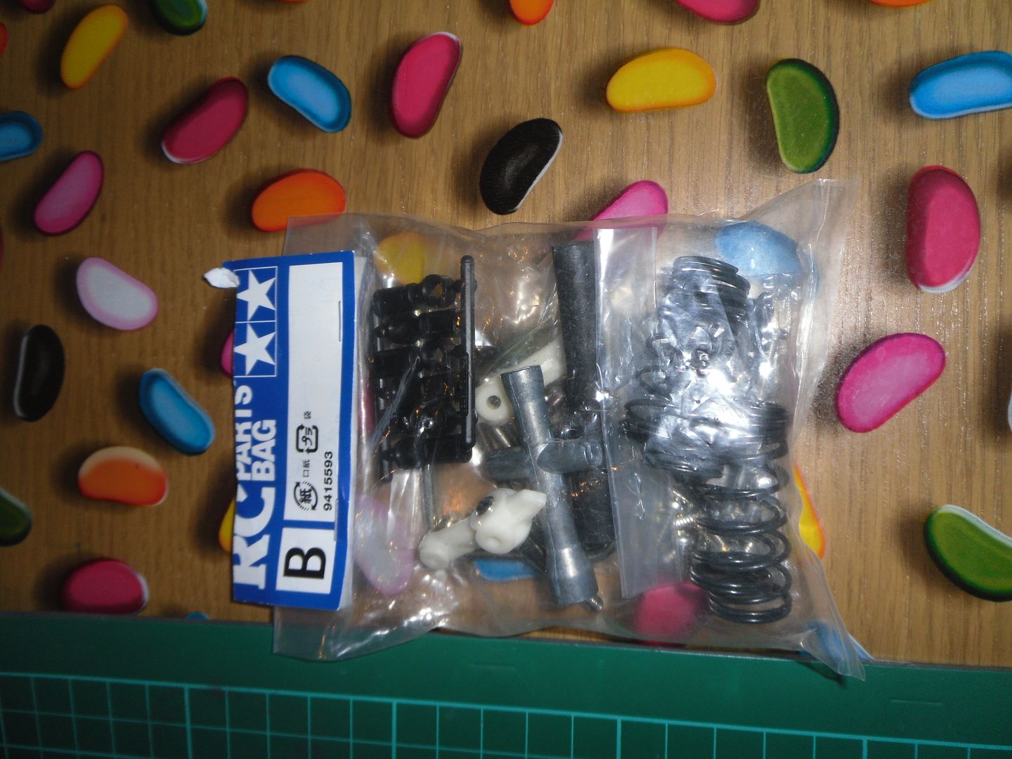

WR-02 parts bag
Anyone need spares?

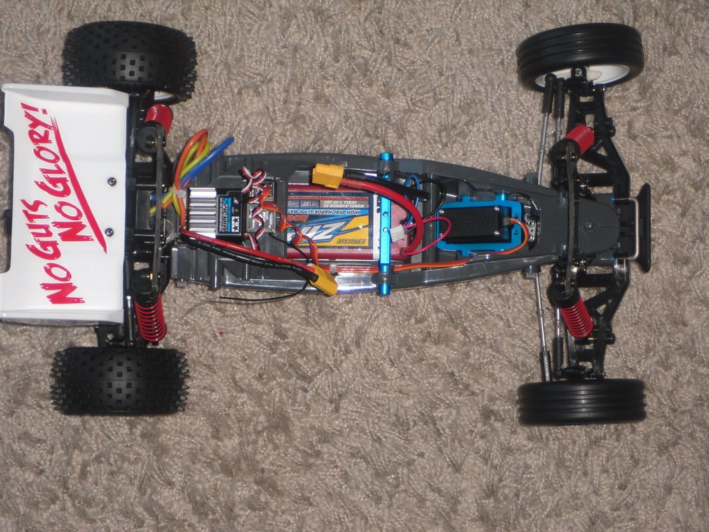

All fitted
How about a classic truggy body?
Opinions?
