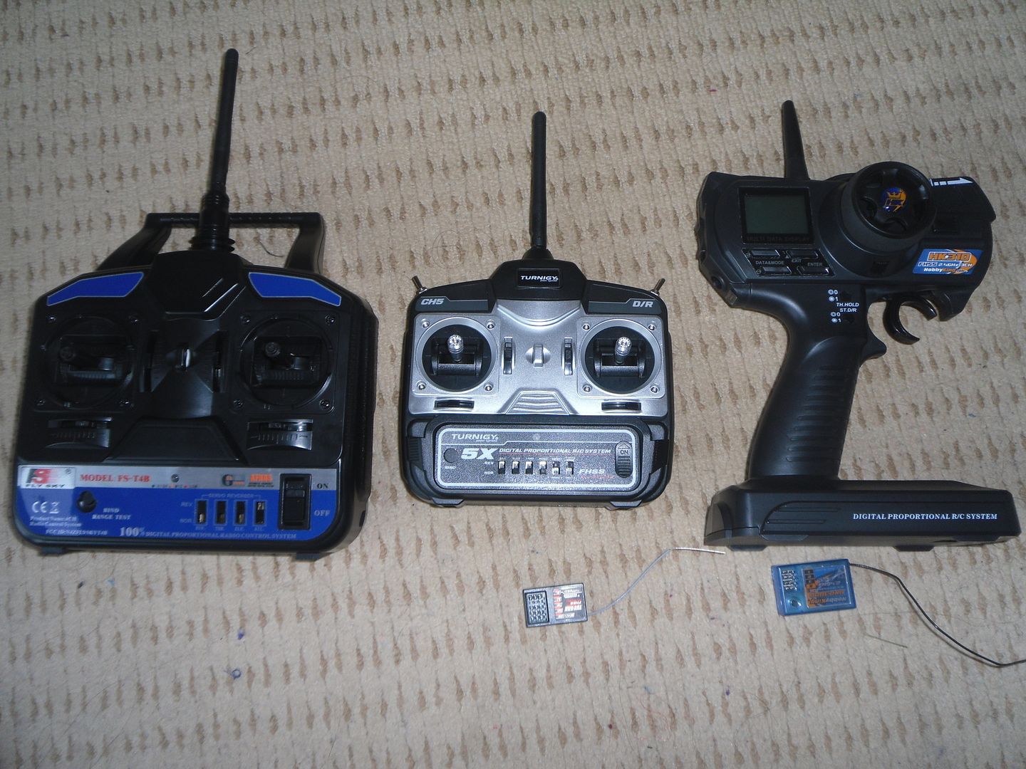

Flysky FS-T4B (£22 posted)

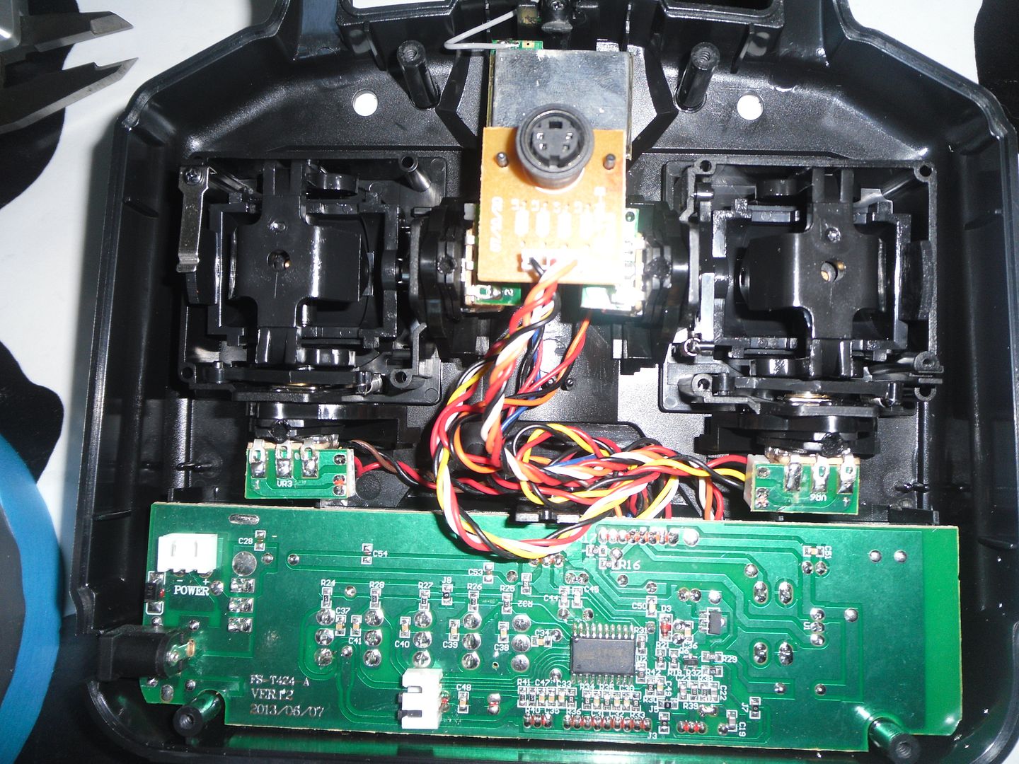

I purchased this a while ago for my son to use. The first issue is that it is a plane transmitter so one stick is floppy.

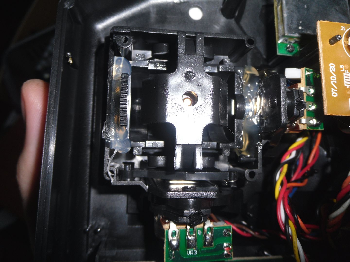

I popped the back off and swapped a few parts around and then filled the sides I did not want to move with hot glue
It works well with good range and response but is a bit big for small hands. Single model only
The receiver is also Flysky and quite small.

Turnigy 5X (£15.99 +postage)
I purchased this one because I thought it might be compatible with the Hobbyking HK3100 receivers I use with my core code transmitter. It is not compatible :(
But lets carry on.
This is a plane unit again so has one floppy stick
Quick pop off the back and it looks like the glue trick will work again. I have run out of glue so that will follow......
This is a lot smaller than the Flysky so will be the boys new TX. Quality is about the same as the Flysky.
Comes with a Turnigy receiver that is again quite small.
Again this is a one only model transmitter

HobbyKing HK-310 (£20.01 + postage)
Hurry one that works with my current receivers (HK-3100)
I thought I would give these wheel things a go and this one looked OK for the cash. The display and menu is the same as the Core Code and it work with the same receivers.
16 Model memory and comes with a not so small HKR3000 reciver.
Not tested yet, need to wait for it to stop raining. Quality is not up to the Spectrum one I played with at the weekend but it is only £20
http://www.hobbyking.com/hobbyking/store/__12181__HK_310_3_Channel_2_4ghz_FHSS_Ground_Radio.html

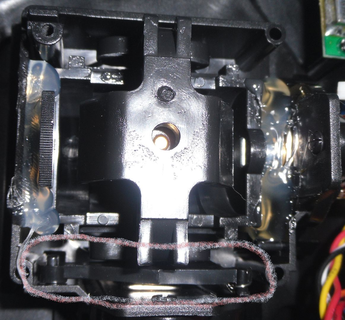

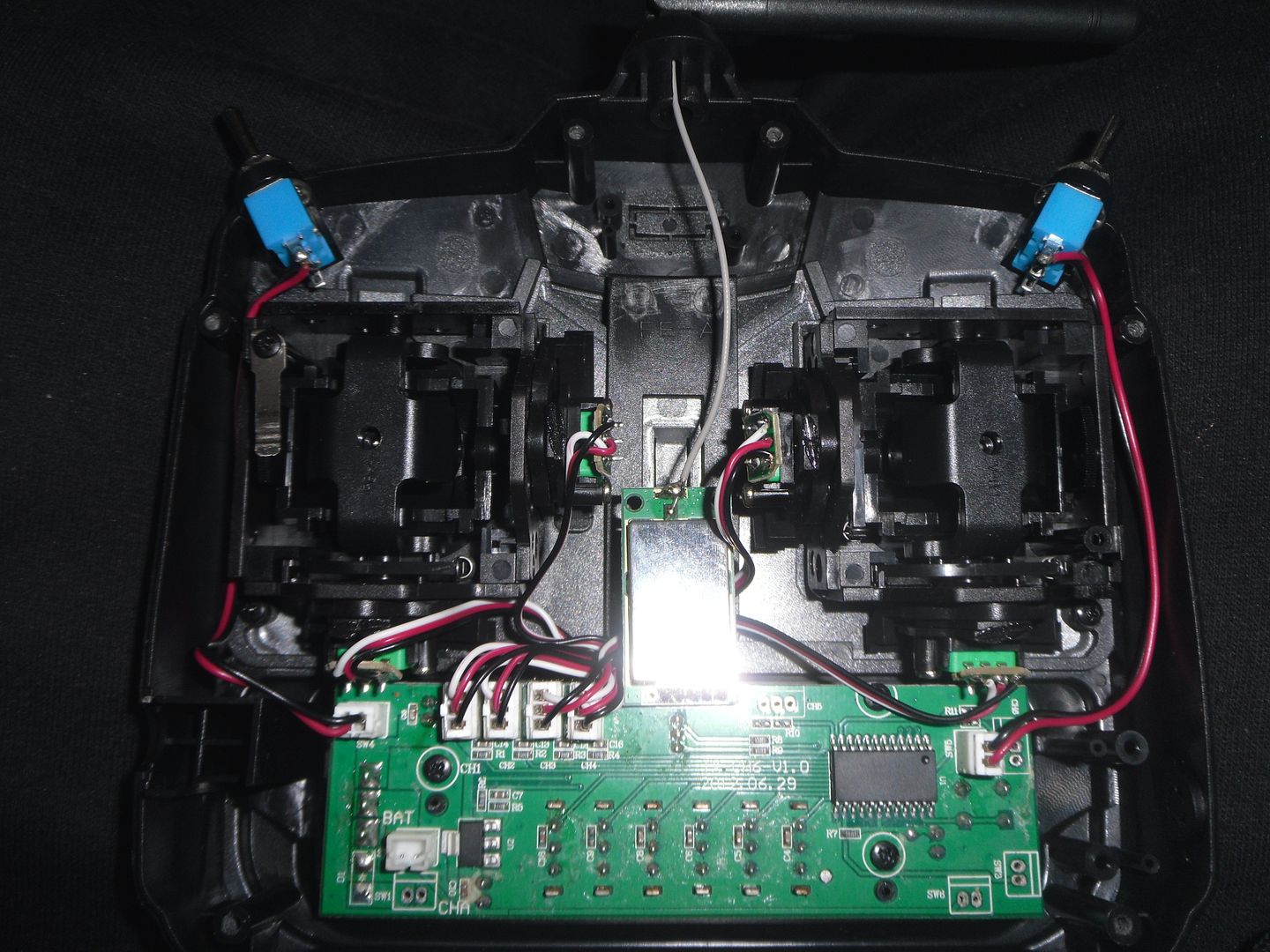

Great write up. I'd be interested to know more about this hot glue trick you did on the Flysky FS-T4B. I have the 6 ch version and wanted to disable the mechanism that holds the left stick where you leave it and make it self centering.
When I did my nephews I think I took more photos but the long and short is you get 3 centring cam plates that are all the same. You can pop these out and pick which functions you want centring and hot glue the other. I am going to make the Turnegy Two channel with hot glue so they boy does not get confused with extra movement.
I will hunt out pic later
The part highlighted above can be put on any axis to self center. You get three, I looked at making a 4th but the work involved was not worth it when you can get a whole new set up for £20 and rob it for parts.

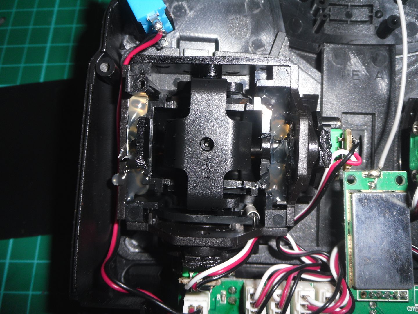

The Turnigy 5X has been the focus of my attentions this week.

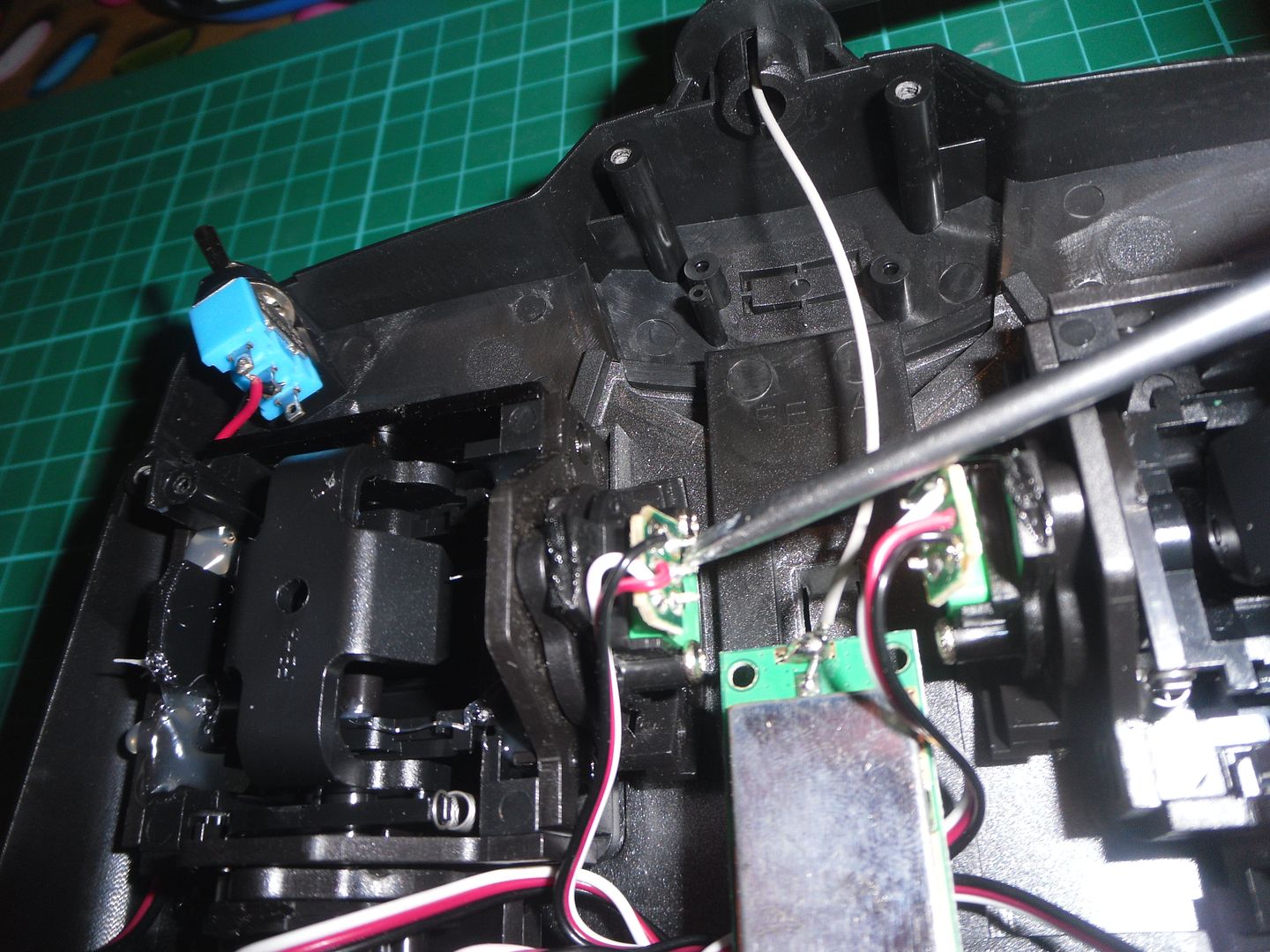

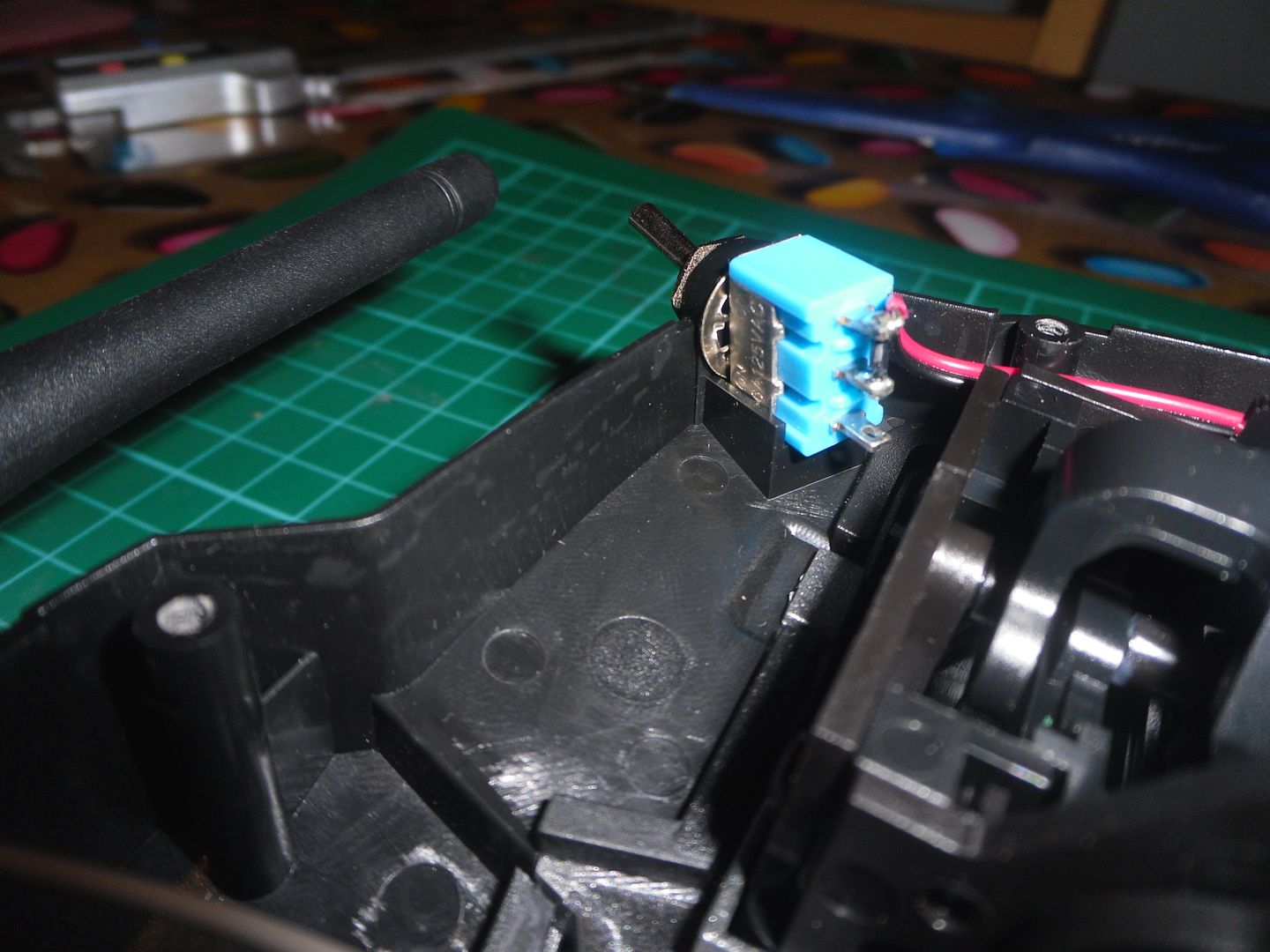

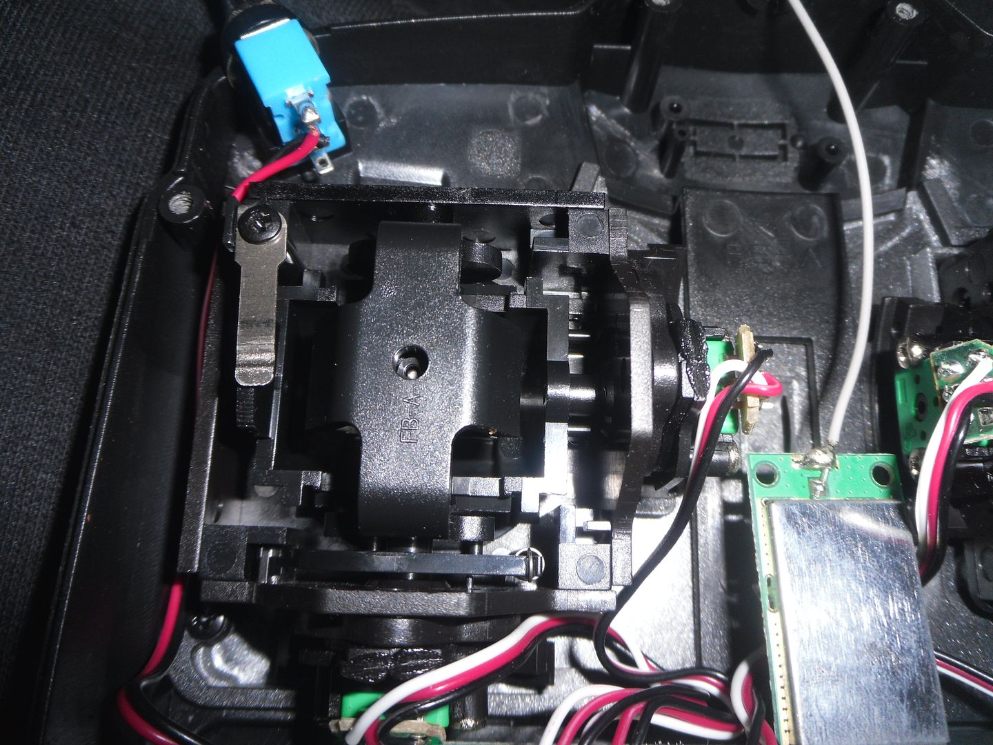

Swapped the spring components over to make the right stick the loose one.
Bit of hot glue to keep it fixed.
I had a thought. It lose one channel I can use it elsewhere. The D/R channel is not needed by me but has a two external switch.
I played shorting the channels to operate the channels and it worked so if I put a three way (ON/OFF/ON) switch in place of the D/R one I can use it to opperate other things (like the three speed in my Tundra)
Anyone know any issues with just switching full live / off / full live?
