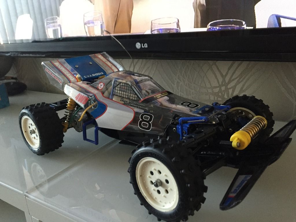

Hi everyone, I've just bought myself what will hopefully be the first of many, Tamiya Vehicles.
First up it the Boomerang. Needs some work, so any tips would be gratefully received
I've wanted many Tamiya models since i was at school in the 80's, remember going into Beatties on the way home and watching the video behind the counter :)
This was described as a vintage Boomerang, so any upgrades to make it a bit better, or rebuild it as it was ?
Thanks.

I see you have an after market front bumper .
Things you need to know , If you use RE RE Gearbox's , YOU need to put E-clips in to hold the out drives ,
As the Vintage Gear box has C-clips to hold the out drives in . Since the re re box has been relieved to add the E-clip ,
where the 1150 bearing is . You will see once you pull apart the gear box's , C-clip is a bug ger to get off :lol: .

Here's a pic of the bumper, So it's not the original?
No it's not , but it is an aftermarket one of that time . As Fried Tyres has said .
