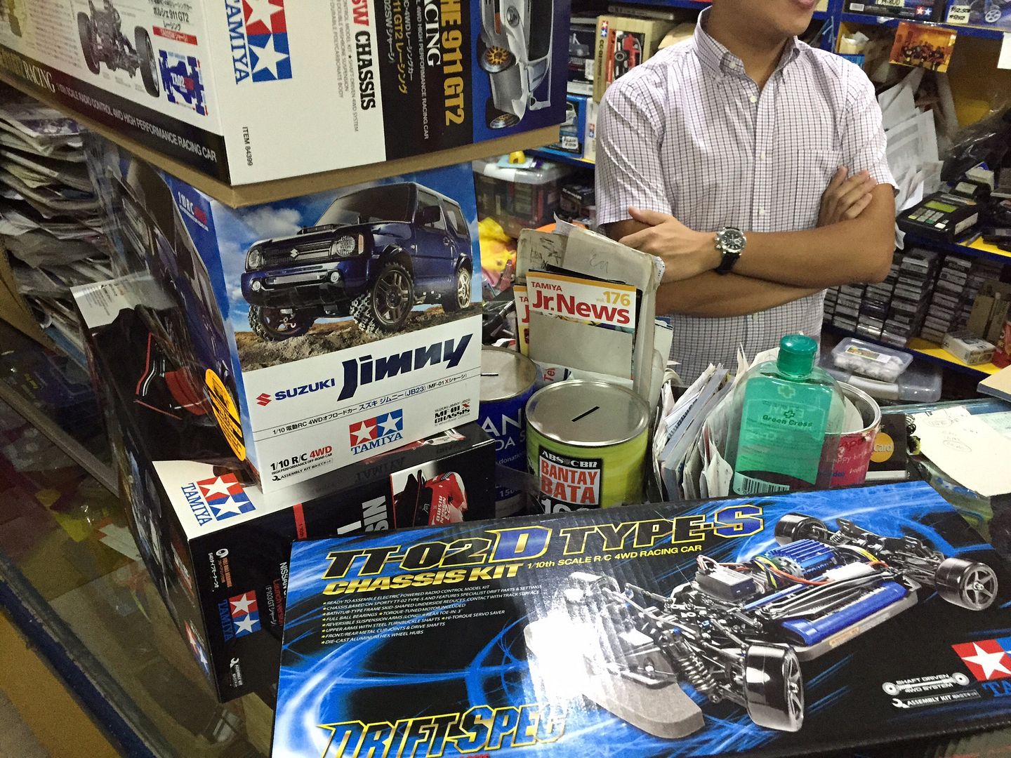

I would get the TT02D Type S like XV Pilot recommended. It's got the most goodies out of the box. They should be arriving at the stores any time now. My local hobby shop took delivery of them in the same shipment as the Jimny, TA02SW 911 GT2, DT02 Kumamon and F103GT GT-R Nismo
Which country is that shop located. All sources indicate that it's September for availability in the UK.
