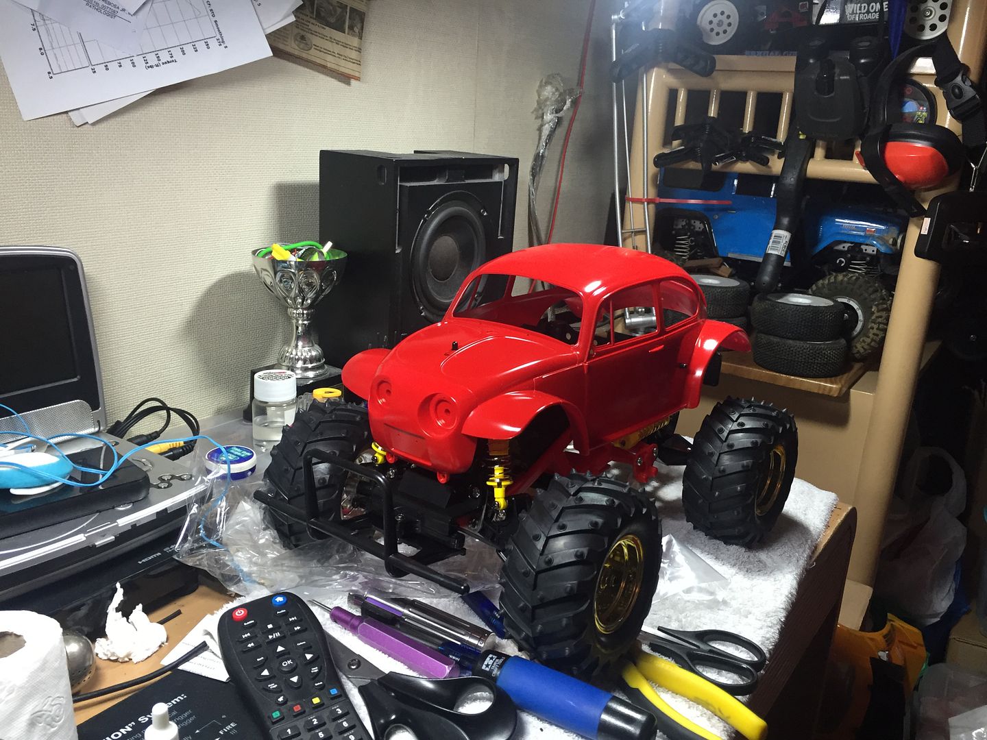

Just finished building mine. Such a satisfying build :) Was pleasantly surprised to see that Tamiya have included universal shafts instead of dogbones
Looking really good, have you sprayed the body?
Yes it has been sprayed with TS-8 Italian Red. I'm going to apply clear over it since it doesn't have the shiny mirror look up close.
Just did a test run inside the house. There is some vibration at the rear like posted earlier in this thread. No vibration if the rear suspension is compressed. Will also fit a high torque servo saver as the stock one is too weak.
