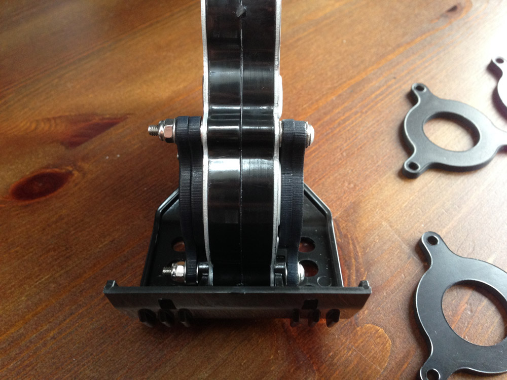

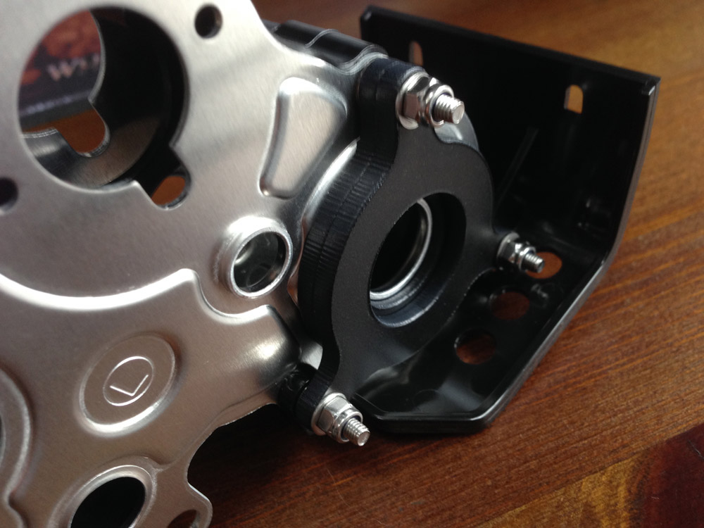

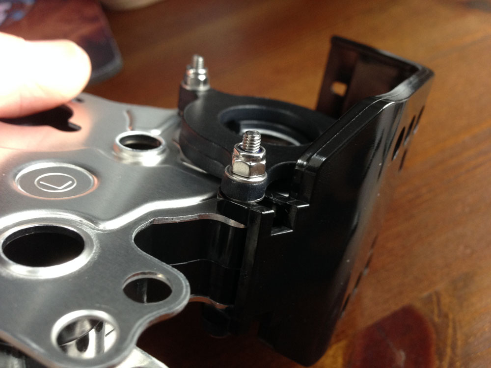

Ooooooook. The prototyped parts, screws, nuts and washers arrived today! I've quickly mocked it up (will build it out fully tonight) quickly just now and its looking like a winner! A total of 12mm of ABS plastic is now sandwiching this gearbox together so by god that diff shouldn't separate under that amount of force.
The first piece (the one with only one screw hole) allows it to be attached and not be affected by the bumper mount (where I slipped up with V1 of this fix). The second piece has a wider opening to compensate for the shafts and then locks into all 3 holes, 2 of which have the bumper mount underneath them.
Looks pretty tidy too I think! It fits like a glove.

I wonder how it will fit around a CRP skid plate and bumper??? I might have to test it our once we get them in production!

Cheers chaps! This wouldn't have happened so quickly if it wasn't for BIGGUS and TWINSET's design, this was based around that. Their design is perfect for any ORV without a bumper, it just needed some extra thought, modification and an extra piece designing to work on the Beetle.
Lets hope it actually works now lol.
