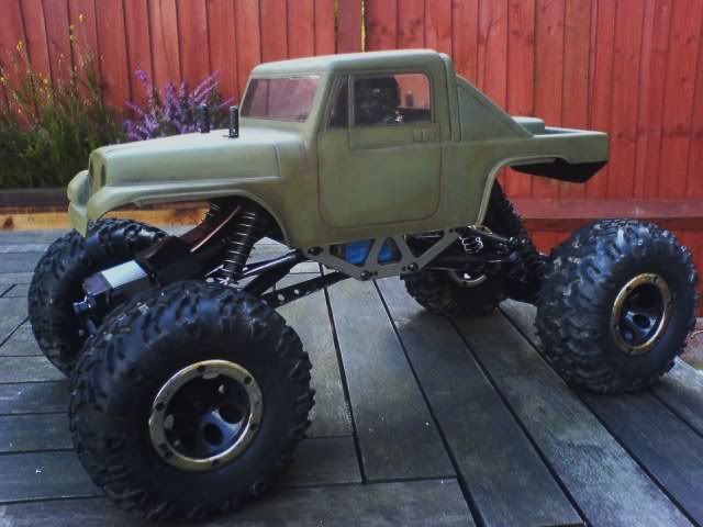

You could easily use the Scout axles, gearbox, motor and electrics (all of which are perfectly good and strong) and fit them to the Axial SCX10 frame rails and chassis with very little modification. An alternative is fitting a better body to the scout and then limiting the axle articulation with shorter shocks or like I did by fitting tubes onto the shock shafts. The Scout is a surprisingly capable crawler with a few minor (free) mods. Mine ended up looking like this;

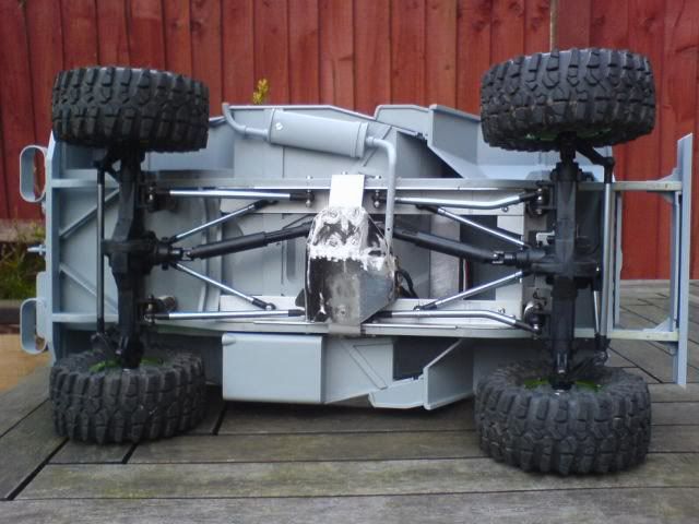

I can't take the dimensions you wanted as I used all the running gear in a 1/6 Willis Jeep conversion;
774B050A-ECA1-4F27-B8E7-70F5CB6E839A-122
If you're interested the mods I did are covered in a build thread 😉
http://www.tamiyaclub.com/forum/index.php?showtopic=63030&view=&hl=&fromsearch=1

That's pretty much how I ended up with mine, scale-ish but able to climb pretty well 😉 Before you take it out get those axles and gearbox thoroughly lubed though! All the ones I've seen came bone dry.
