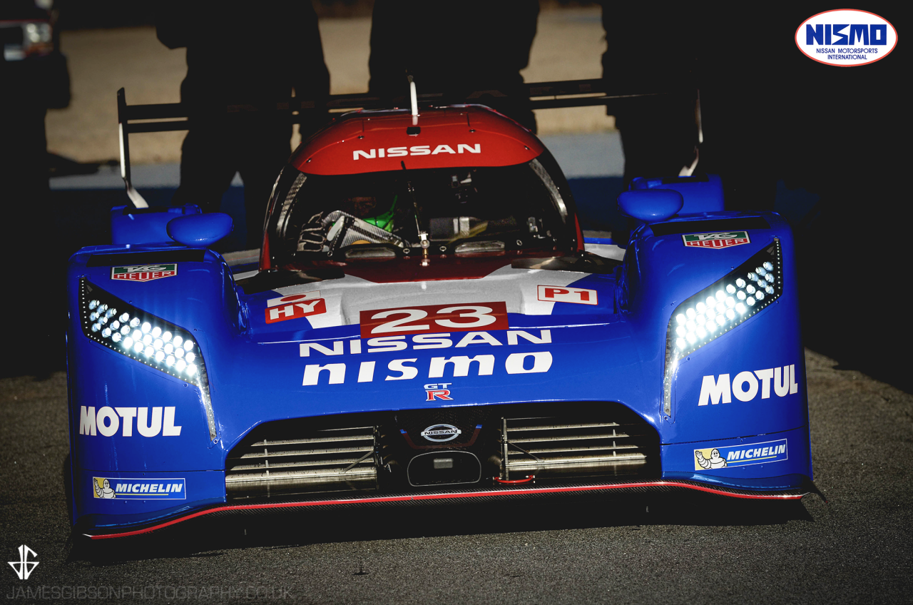

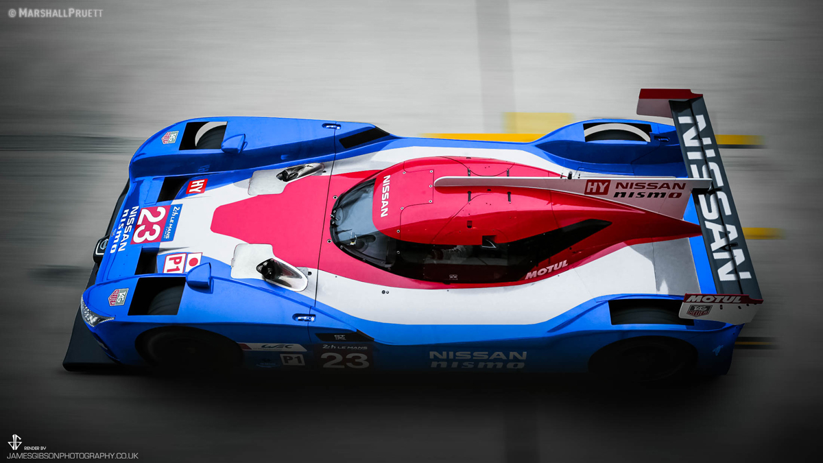

I'm starting to put some thought into the shell. I have no real experience with fabricating things from styrene sheet, but I really want to capture some of the aero features of the real car in more detail. I know the body set is coming available in August, so I could always get a replacement if I mess it up...
I want the front grill, bonnet ducts, rear view mirrors, exhaust pipes, fender cutouts, and rear aero on this shell...

The exhausts should be doable with one of the many aftermarket parts designed for F1 cars. The square cutouts above the wheels should be easy (although will create a weak point obviously) but the rear diffuser is going to be tough!

Color scheme time... I was thinking 1990's Nissan livery, but I've seen some alternatives to consider as well. What do you think?
Current stock color scheme:
Raw carbon fiber; would probably be painted as gunmetal:
Nostalgic livery:
Maybe even stray from known examples and do something Calsonic-inspired?
Food for thought...
Looking great! I am sure however you finish it, the end result will be a stunner!
As for how to finish it - I propose, from one Nismo GT-R LM to another, the following:
The #23 car that year had pink stripes, if you want a little more visual impact ;)
