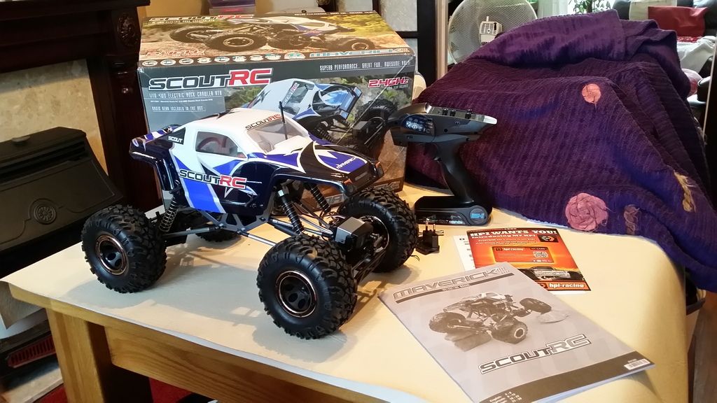

Here's the scout when it arrived. Everything laid out and ready for fun.

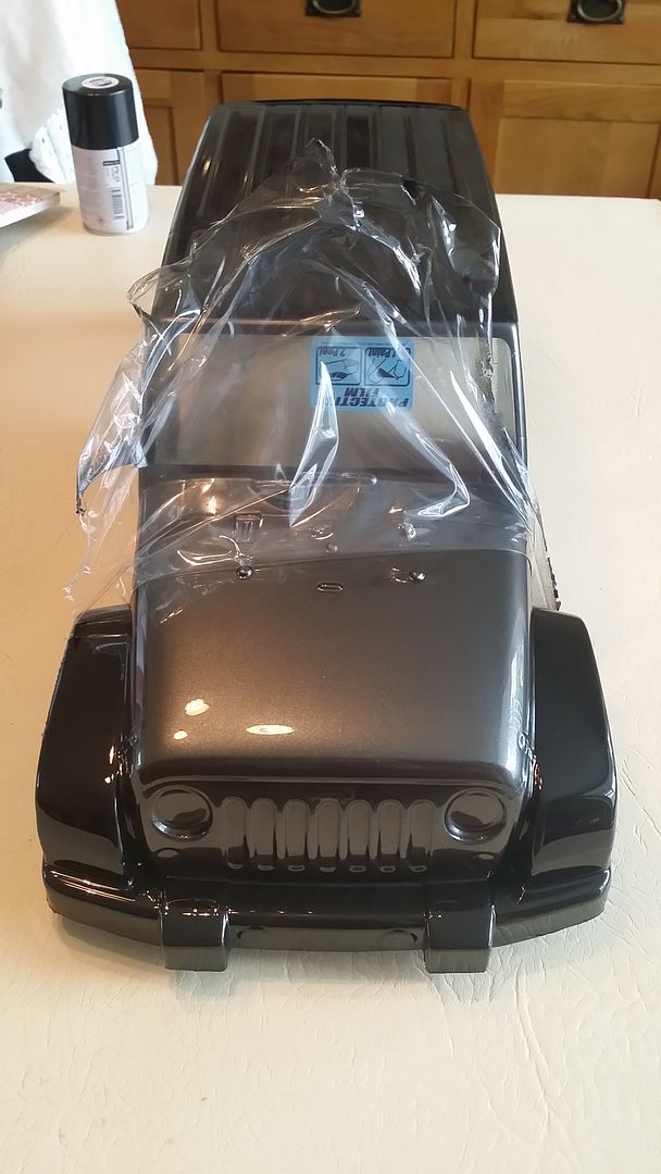

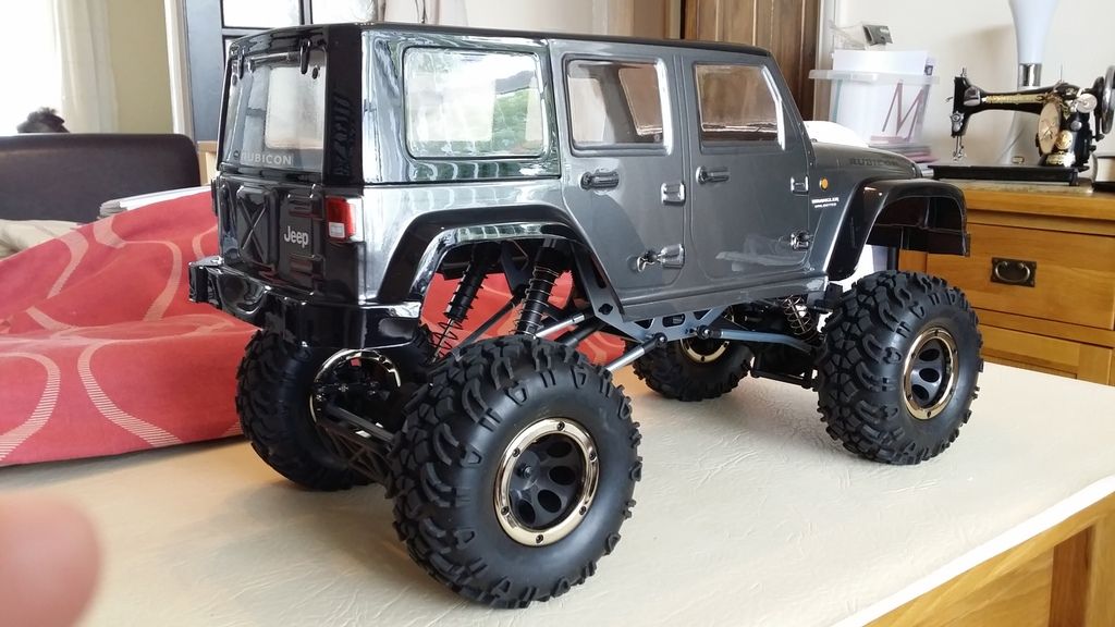

Now I'm happy with how the shell sits on the maverick I masked it all up and decided to do the main body gun metal grey and the roof, front and rear bumper and arches black. Here it is and my favourite part of doing the body work, the removal of be protective film!
And finally the last bit of the body work for the moment which is stickering it up. I'm used to tamiya cutting out my decals. The pro-line ones need you to be handy with the scissors. I think it looks soo much better than the scout body.

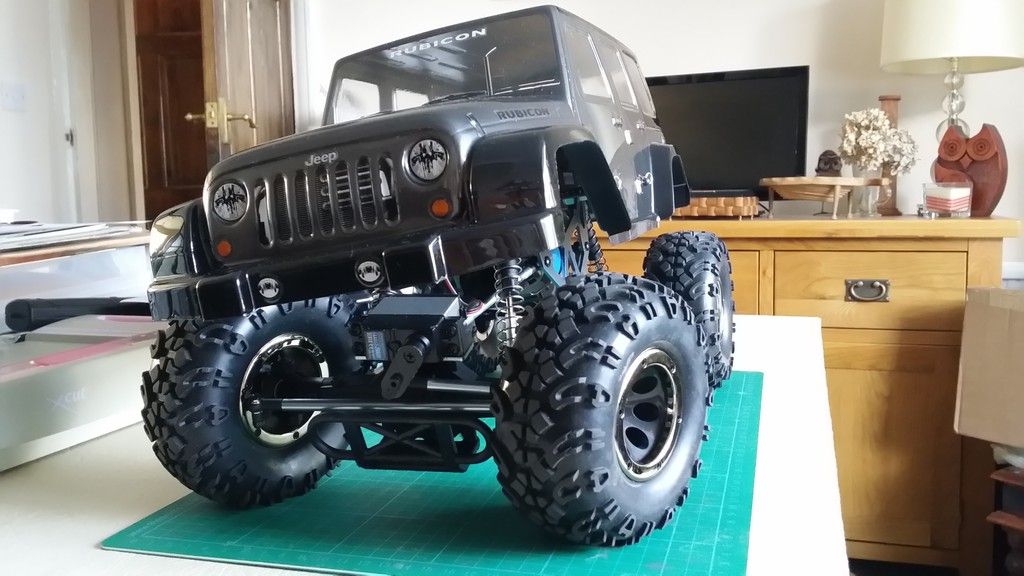

So that's how it sits at the moment. I have to admit when I used the scout I loved the articulation on it. Nothing seemed to be able to get in its way. I suppose it's a crawler after all. I like it so much in fact I want to hold off on the scx10 chassis for a while and have it as a jeep rubicon 'high lift'. So it will have more articulation than a scaler but less than a crawler. I'm going to do this by fitting some rubber tubing on the shock shafts to reduce the shock travel and prevent the wheels hitting the shell.
I've heard there are lots of free and cheap mods which can be done to the maverick to increase its performance and abilities so as I do them I'll put them in this build thread so others can see how to do them. There are also many compatible axial parts so I'll look into which of these work with the scout.
Body wise I'd love some scale items on there such as a snorkel, wing mirrors, spare petrol tank, roof rack etc to make it more realistic. I'd like to do an interior too with driver. I wonder if pro-line do interiors too?? Seats, dashboard, steering wheel would look so much better than a bunch of wires.

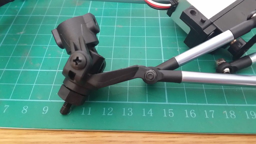

You know the Scout has 3 holes to fix the upper and lower links into. You can move them to the outer holes and get a little extra wheelbase length for free. The drive shafts should be able to handle that ok. Make sure you move both the upper and lower links to the same setting otherwise it'll tilt how it holds the axle compared to the transmission.
I found removing the pointless axle guards and dremelling off their mounting points gave it much better clearance and the axle cases are easily strong enough on their own.

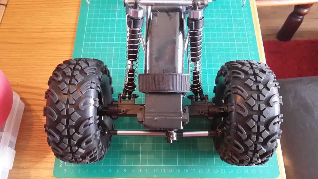

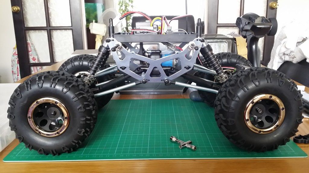

I've just added the rubber tubing onto the shock shafts. I put 25mm tubing on the front and 30mm on the rear. The wheels don't make any contact with the arches now and it takes seconds to remove to get the full articulation of a crawler.
I tried to get it as even as possible....
A pic of the tubing on the shaft
It still has a nice amount of travel left to get over those bumps and dips :D
In the second picture which shows the tubing on the shaft can you see one of the springs is black and the other is silver (the front 2 are both silver too). Does anyone that has a scout know why that is? Does it come with different strength springs? I don't know if I imagined it but the black one did seem stiffer when sliding it up to put the tubing on. I may have just imagined this though.
It is my understanding that the one stiffer spring is there to help prevent the axle twisting relative to the chassis when power is applied.

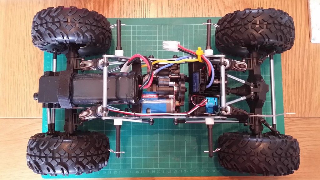

So after reading about the free mods to do on the scout and other things which could improve its performance I thought I'd tackle the cars COG first. On the maverick scout all the electrics and worst of all the battery are on a plastic tray which sits on top of the the chassis which I think is the worst place for it weight distribution wise for a crawler. It may be the best place to keep it out of the wet stuff but I'm aiming for the lowest COG I can get so the battery, esc and receiver had to be moved.

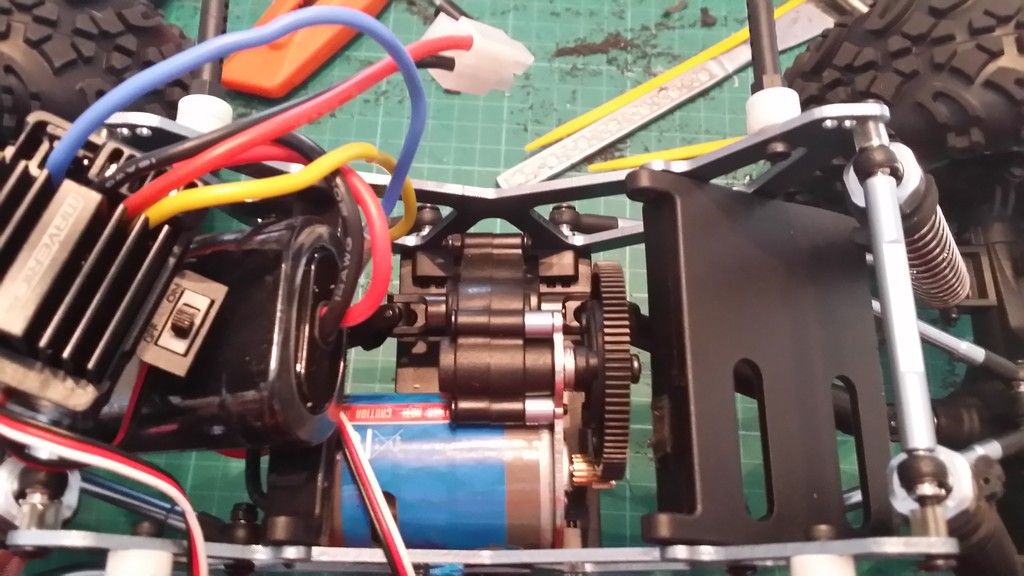

Here's how the battery and electrics sit originally (I forgot to leave the battery in on this shot :rolleyes: . It goes next to the receiver and esc).

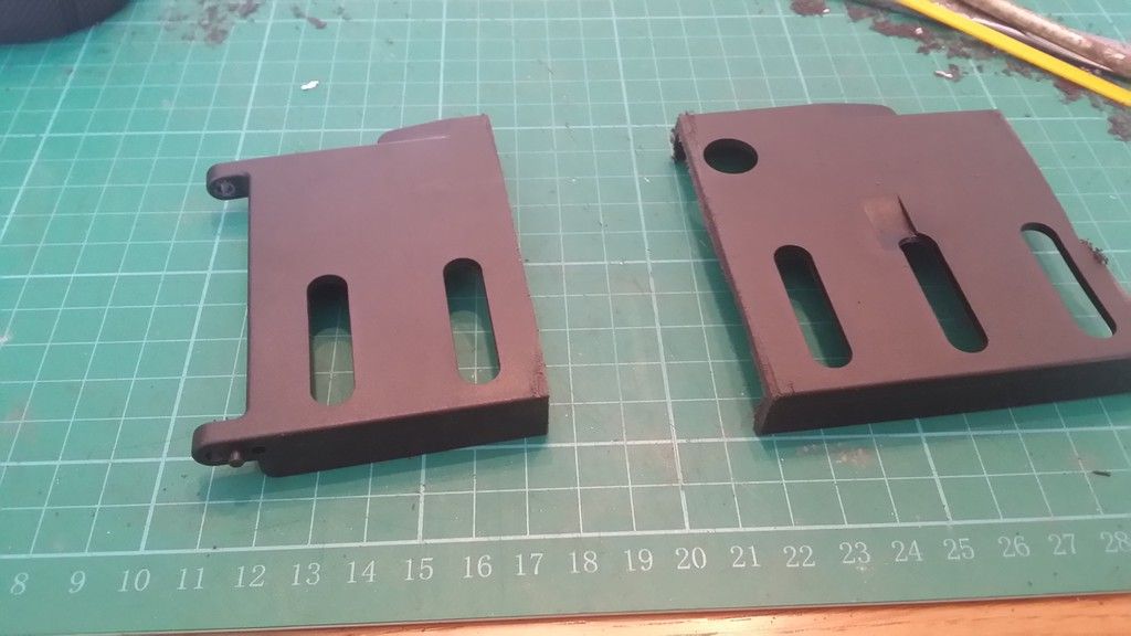

There are already some pre drilled holes in the chassis so I cut the tray holding the battery and electrics in half and it fit nicely in the middle of the chassis with the lower half resting on the upper drop links.
Here is the tray with all the electrics fitted. It still has full articulation and the electrics don't come into contact with anything. Which is good! Lol
I used the other side of the electrics tray and cut the other side off and fit it into the conveniently placed holes in the chassis. It was a much smaller section as it just needed to support the battery. Thanks for this tip mr crispy! ;) This is how the battery position is now. It's placed much lower down in the chassis and is nearer to the front axles which will help with traction too.
So after all the cutting and moving this is how it all looks with the repositioning of the battery, esc and receiver.
And finally a comparison shot of the battery, esc and receiver, before and after. In the before shot you can see they are all located in a tray above the top of the shocks. In the after shot all the above are now positioned below the top of the shocks. The battery is also applying more weight to the front axle which in turn should provide more grip as well as lowering the COG.
Before...
After...
So I'm really pleased with how that all turned out. Everything was free to do, it just takes a little time and makes it even more capable over obstacles. And we all love tinkering with our rc's so it was time well spent :) .
More updates and mods are on there way.

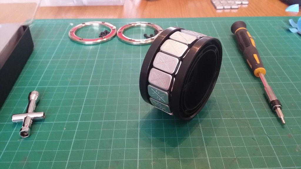

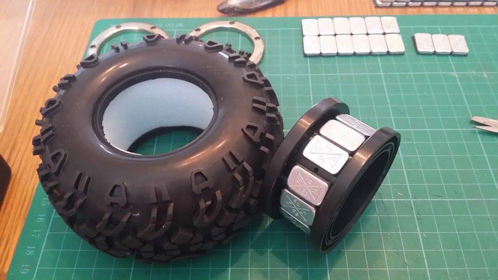

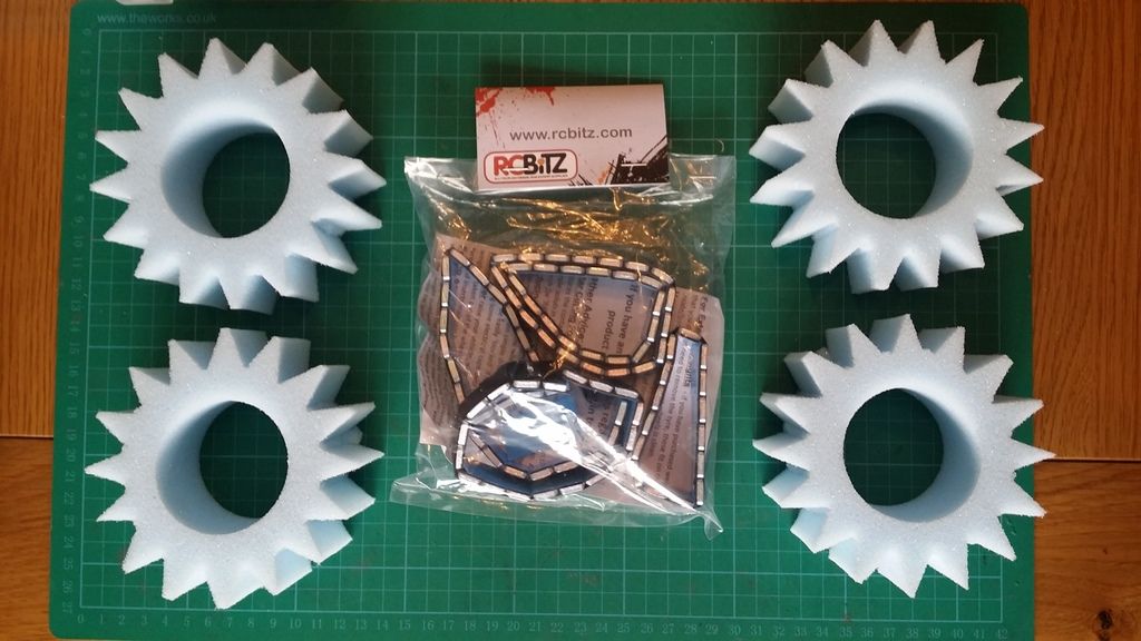

This is what recently arrived from RcBitz :)

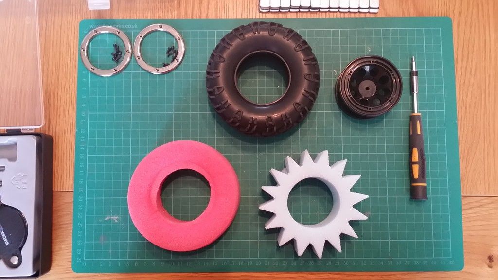

I dismantled the beadlocks to put the weights and star cut sponges in. I'm really impressed that they are real beadlocks too, to say the scout cost £119 rtr including delivery.
Before I fitted the star cut sponges I used one as a template on the original pink sponge so when it eventually wears out I can just cut out the wedges and install these.
I then added the weights to the front and the back wheel rims. I was careful not to cover the air holes in the rims so they can still deflate and inflate quickly while climbing the terrain. After looking around for info about weighting the wheels it seems that it's best to have around double the weight in the front wheels compared to the back. I'll see how these perform and may add or remove weights to improve the balance if needed. This is just a starting point really.
Rear weights attached - 70g (2.47oz) each wheel
Front weights attached 155g (5.47oz) each wheel
So that's the latest update. The COG is much lower and the tyres should get much more grip with the wheels weights and star cut tyre sponges. More to come soon.

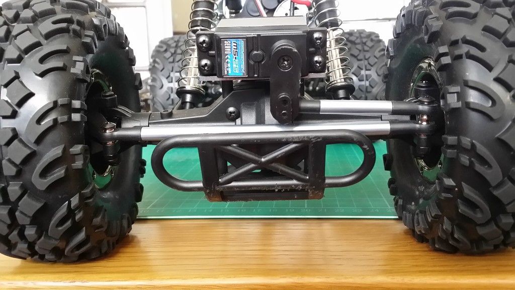

I also removed the axle guard and it's fixing points which will give me some more ground clearance.

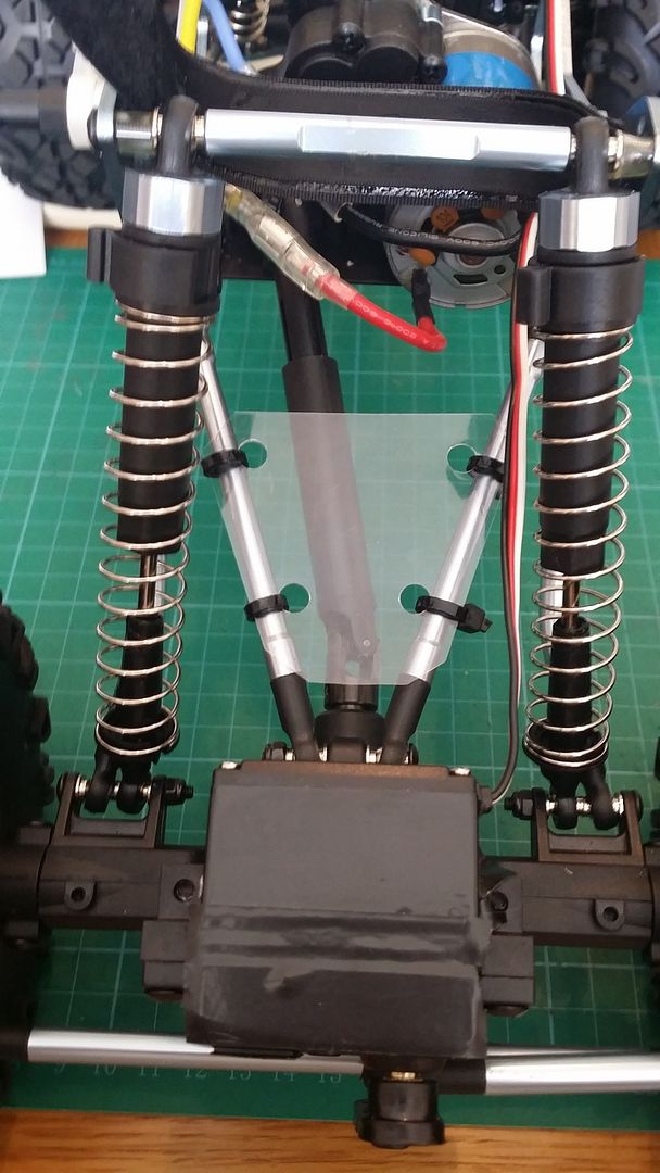

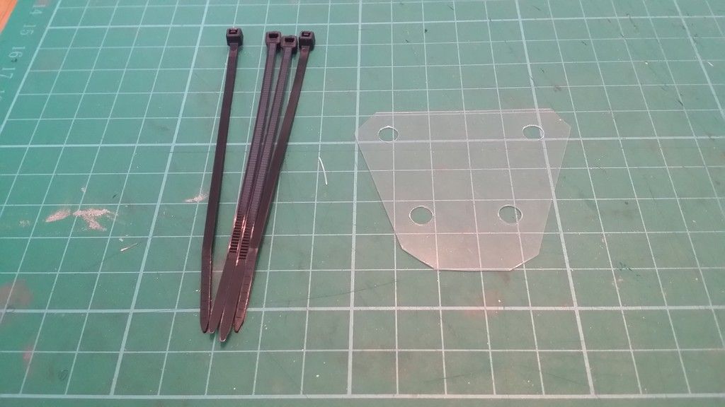

Finally I saw a battery plate from axial which is a piece of plastic and some cable ties. This is to support the battery when it's resting on the upper links. I can't remember how much they cost but it was around £5 or £6. I thought I can make one of those so got some plastic packaging, a blister pack and cut it to shape from a paper template I made. Then using a hole punch I punched some holes for the cable ties and then fitted it to the upper links.
Just like the axial one except totally free. :)
Here it is fitted waiting for the battery.

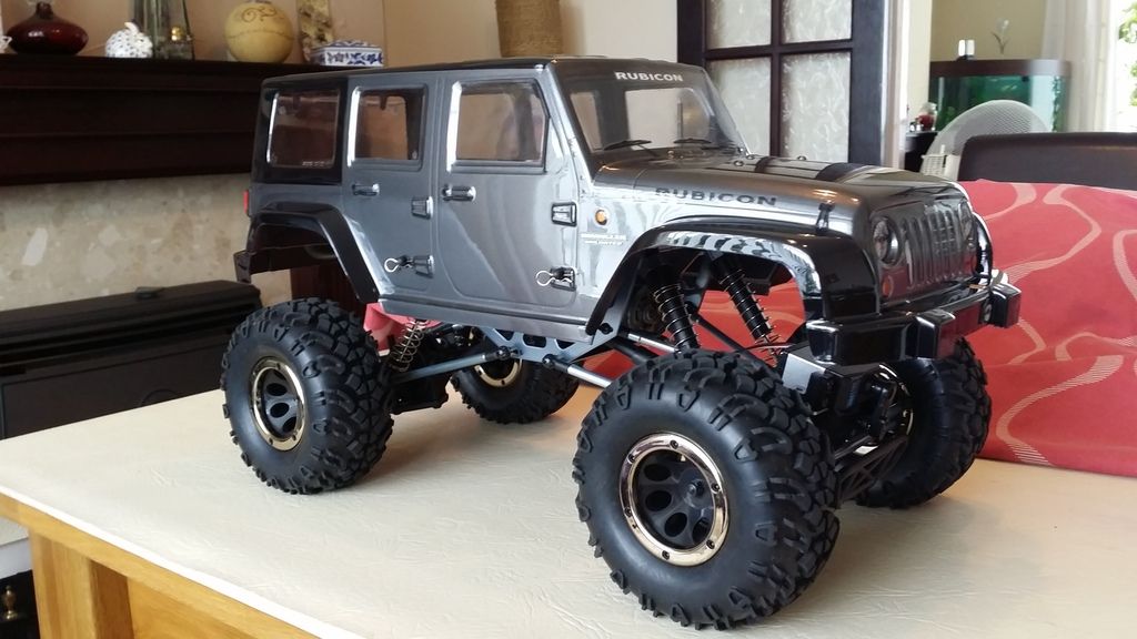

So with all those mods in place here's my first proper run. This is the first time I've done any crawling. The first time I've used a pistol grip transmitter and my first youtube video. A lot if firsts! :lol: I just threw objects down, drove over them, filmed it and then edited it all together. I'll plan things out next time. Hope you enjoy.

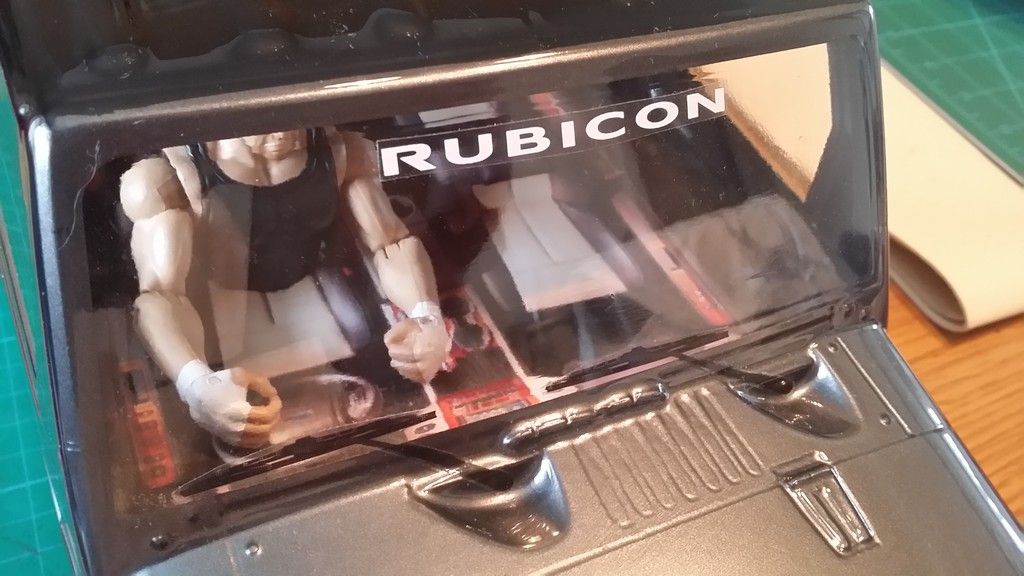

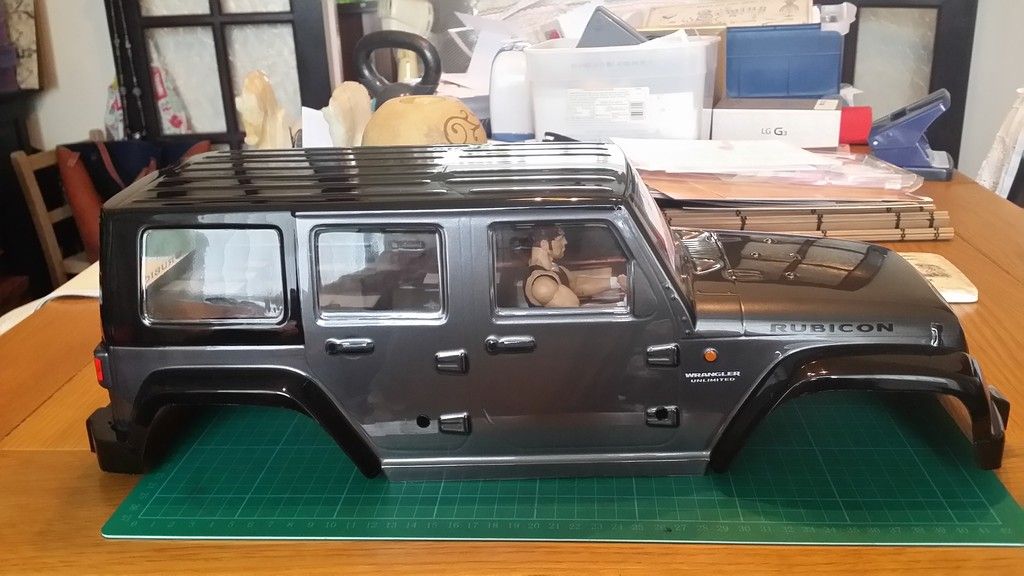

So here's Deane near his new ride. Scale wise he's nearly spot on.

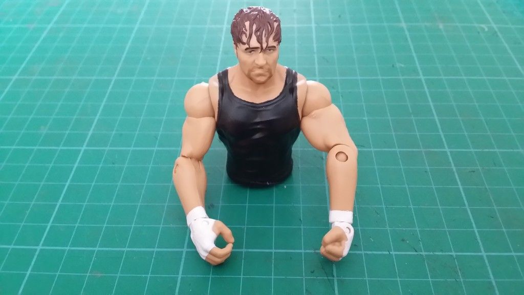

I knew he'd have to be a torso up figure so here he is after an encounter with a hacksaw which he totally lost.
I then had to make him an interior to sit in. After looking around I found a lexan pro-line interior which would fit the pro-line jeep wrangler body but at £25 excluding delivery and factoring in paints etc it would have cost between £30 and £40. So I didn't pull the trigger on it. Instead I found some old blister packs (the transparent plastic sealed packs they use for packaging stuff ) and set about making a paper template so I coukd make my free interior.
When I perfected the paper template I cut up the blister packs and shaped them to the shape of the inside of my jeep interior. Here's the bare interior. Not exactly pretty but it's going to be completely covered.
I then wanted an interior to put on top of this. So after a few google searches I found this birds eye view of an interior. Which when printed out on photo paper ended up like this...
I then glued this onto my blister pack interior support panel and after attaching some flaps and adding velcro for quick removal I fitted it into the jeep wrangler shell.
So that's my guy in the car and his interior. Much more fun doing it my self and so much cheaper. As in free. The best price.

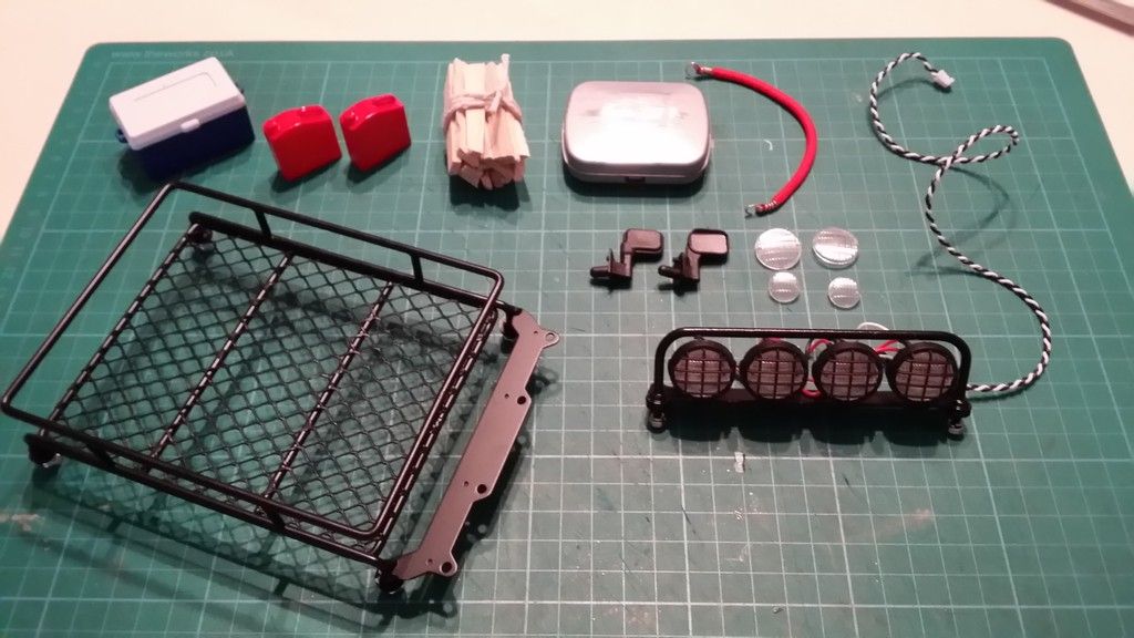

I'm getting near to finishing off how I'd like the shell to look. I had some nice packages arrive in the post....

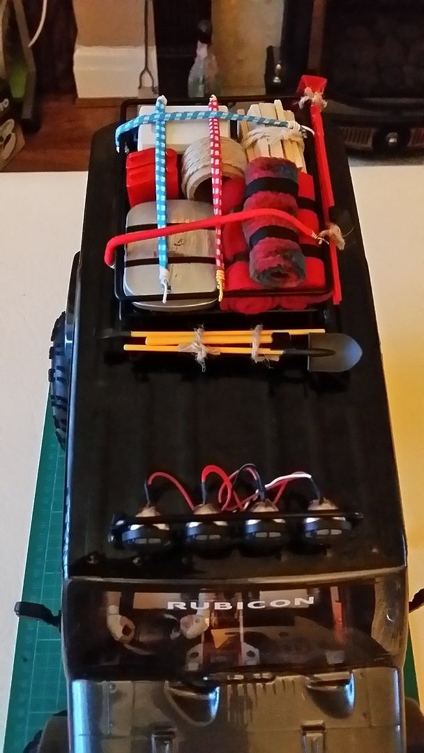

Roof rack, light bar, wing mirrors, jerry cans, cooler box, shovel, hoe, axe, snorkel, front and rear light lenses and light control unit.
Then the fun part of placing them all on the jeep. I did a little test fit on the roof rack.

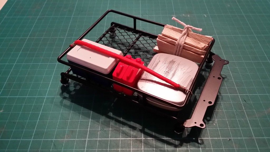

So here they are fitted to the jeep. I made paper templates so the when I drilled the hole for the roof rack and light bar it would be straight and true. As well as the purchased accessories you'll notice the home made ones there too. One because it's fun fo make and secondly it'll bring the cost of the build down too. You could easily spend into 3 figures accessorising your scaler.
Home made stuff includes the bundle of wood made from balsa wood packing and tied with some string, silver suit case which was a sweet box with straps added. Plastic handle will be added soon as will some travel stickers. 3x sleeping mats made from old fleeces. And finally the bungie cords holding everything on the roof rack were made from hair elastics with coloured paper clips twisted around each end and then curled into a hook.
I've got to paint and fit the snorkel and a tyre and cover will be fitted to the rear door. Also foot bars will be fitted to each side.

Great work there Terz, really good imagination with printing off that interior, looks really effective. It seems to crawl pretty well too, I know nothing about crawling really but it's done well getting up those massive steps!
Good job on the vid too, the only thing I don't like is the wires all showing on the light bar, maybe put some black heat shrink on them so at least they are all the same colour.
Rgds
Nito
Thanks nitomor. I thought the exact same thing regarding the wires, they need to be hidden. So did a few people I've shown. I thought with it being Fastrax they would have provided some black heat shrink to make them less noticeable.
I plan to make an enlosure for them. If the enclosure I make isn't up to the job I think like you said heat shrink will make them less obvious and will be easier to do.
