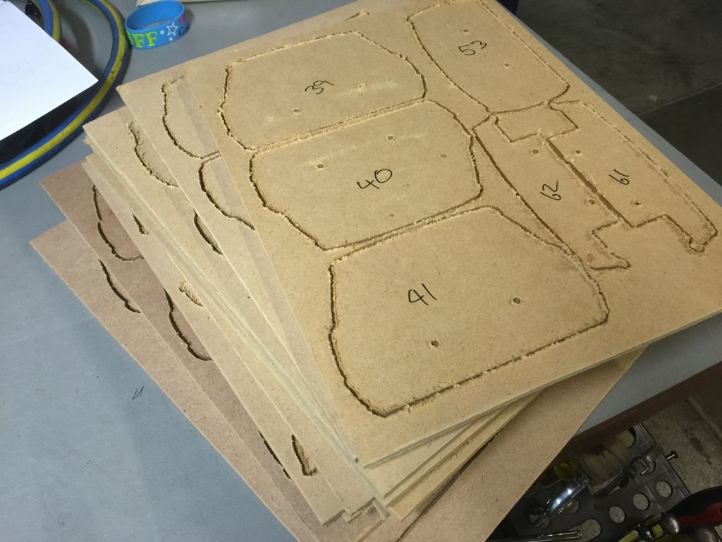

I then used Autodesk's 123Make program to generate 6 mm slices of the car. These slices I tidied up a little and then imported them into Cambam. From here I can make the appropriate g-code and cut them on my cnc machine out of 6 mm MDF.
Below are some of the slices in Cambam.
All up there were 68 pieces to cut.

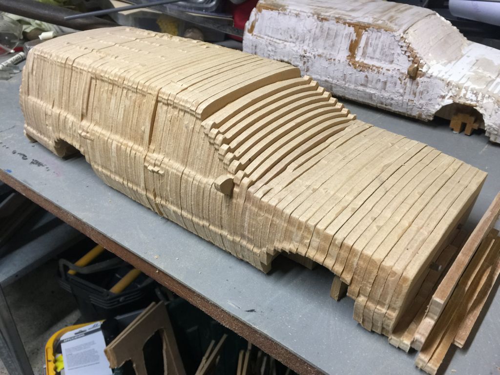

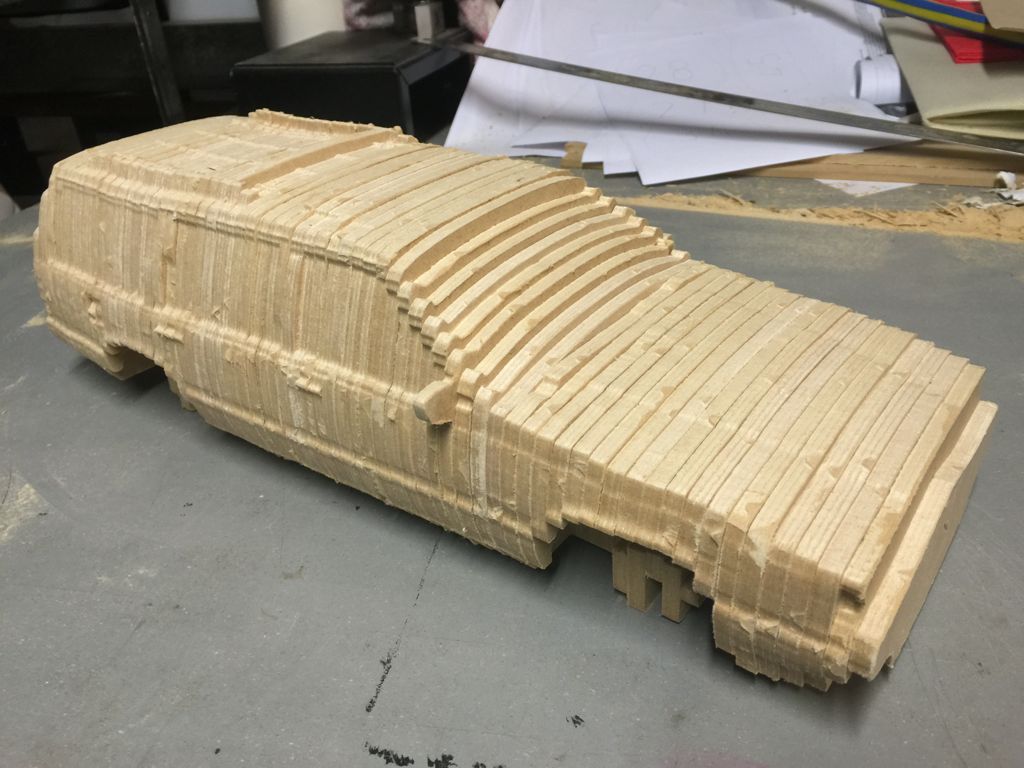

Once cut, I then had to trim out the pieces and put them together.
Here you can see a test fit. Once in position and securing together I think this will give me good base from which to start. Although next time I am tempted to use 3 mm MDF instead. That will double the cuts, but should make finishing a lot easier.
Also once the pieces are in place, the car will sit up off the ground.

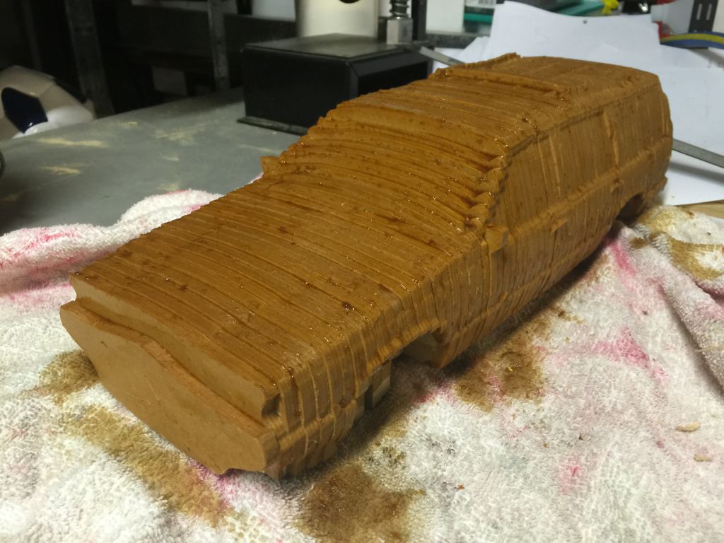

The next step after cleaning up and joining them all together is to cover the whole lot in shellac. This will make the mdf much stronger and also lock down the fibres so I can create a smooth surface. Then I can start bogging (or model clay undecided which to use) and sanding to get the final body shape.

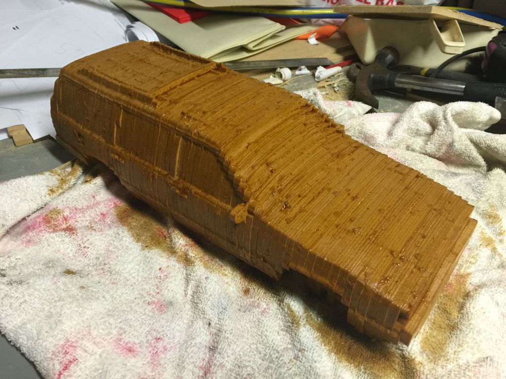

ok, minor update. I stapled the pieces together, and yet again discovered that hindsight is a wonderful thing. When I made the slices, the software also generated alignment holes. In my haste I decided not to drill them, which was silly as I just program the cnc to do it. So the final shape is ok, but it would have been a little better with the two alignment rods I think. You can tell around the rear wheel arch is sags a little.
Then I covered the whole car in shellac, which is just a cheap lacquer that my mum had :rolleyes: . This will give the MDF some extra strength, hopefully help get a smoother finish and protect it if it gets wet when putting the clay on.
I let that dry one day and started to apply some air dry clay so I can smooth out the surface a little before sanding. I was initially going to use car body filler, but then I thought the clay might be easier to sand and it was cheaper. What I didn't count on was the clay doesn't seem to want to stick the newly lacquered surface very well. So as a test I just did the windscreen and bonnet.
I'll let that dry and then will try and sand it down, along with the roof racks off at the back of the car that I don't need.

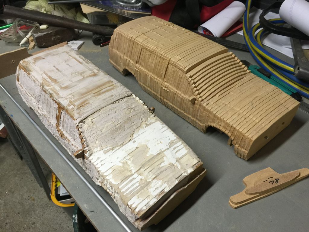

ok, a rather embarrassing update :wub:

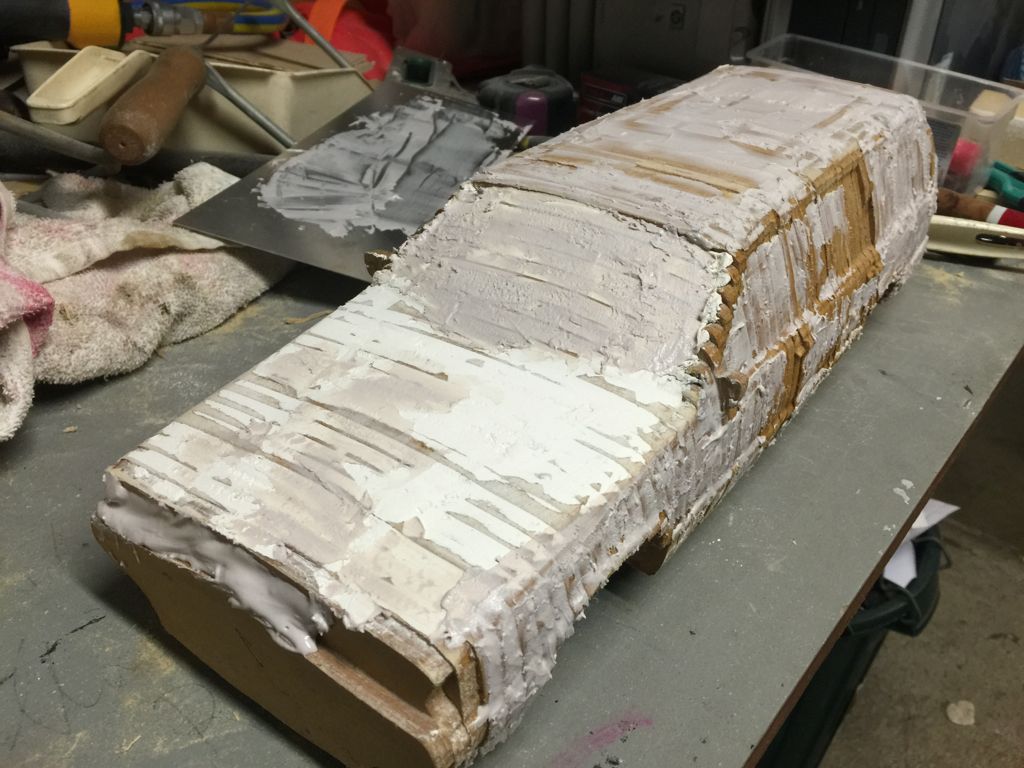

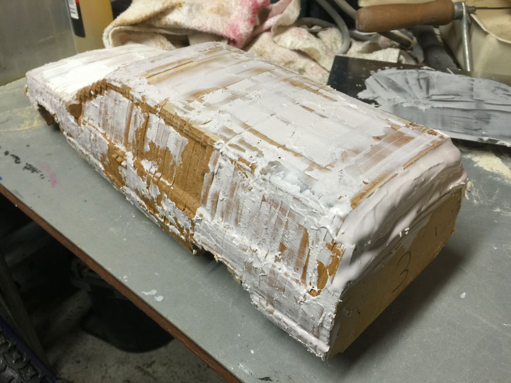

so I ended up using car filler to smooth out the bumps. The mixture was 50:1, and you only get a tiny tube of harder, so I just guessed it. Turns out I didn't use enough hardener and it tools weeks to harden, and even then its still not quite hard! Plus I put it on too thick in places.

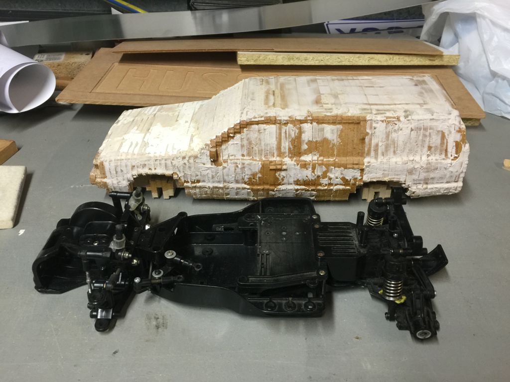

But thats not the embarrassing bit. While waiting for the filler to harden, I cut some paper templates so I can get the curves on the windscreen and bonnet right.
I overlaid them to match up the position, and they didn't fit, being way too big. So I placed the body next to my FF01 chassis and darn it, I made the body too small!
Too small to use, I will have to start over. Which I am actually happy about in some ways. Not only is the filler an issue, I'd nail gunned the body together and it wasn't the best, as well as the body not being perfectly lined up. So I've resized and re-cut all the slices. I was intending to go down to 3 mm slices as well, but the Autodesk program I am using to make the slices wouldn't let me. I also included two alignment holes and I will use 6 mm aluminium rod (because thats what I have!) to help align and hold the slices together. I'll still keep the first attempt to test on too.

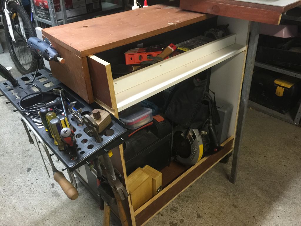

14 sheets this time and only just finished them today. I would have been done earlier except work got in the way and I needed to also tidy my workshop. To help me I made a tool cart from scraps I had.

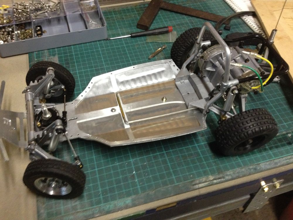

Still I felt the price was worthwhile, as it will not only give me decals which I can copy, it will give a template for a roll cage, dash and chassis. The second part to the project will be ditching everything bar the front suspension and motor mount and trying to make a scale chassis and rear suspension (or as close as I can get). I intend to use 0.6 mm aluminium to make the panels and brace it with 2mm or 3 mm segments. I've done this once before for a sand scorcher.
more pics of the sand scorcher here:
http://www.tamiyaclub.com/showroom_model.asp?cid=122224&sid=35302
but I will need to upgrade my cnc machine before I can really get into this part of the build. I can cut Aluminium on my cheap chinese cnc machine, but its only 200W and it struggles a lot!

ok, now back to square one :rolleyes:

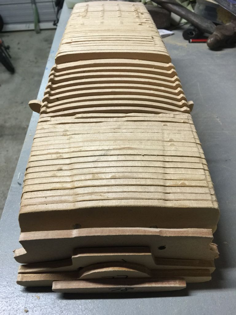

have cut all new pieces, 78 in total (except have to re-do two at the front), with alignment holes. I'm thinking I'll glue each piece together this time, and then they'll be mounted onto 6 mm aluminium rod. I've also found a better modelling clay that is softer to work with, yet still dry hard.
Cheers Trini2DBone, the roof and sides I think will be pretty straight forward. Sculpting the front and rear bumper bars should be a good challenge!
