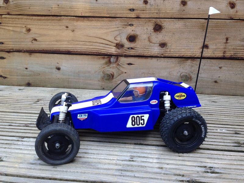

I've run my DT02 with Schumacher front tyres on the standard 2.2 wheels. On the rear I've gone as large as 96mm Ansmann Kongs which were great on soft sand.

And I've currently got Blitzer Beetle front tyres fitted to the rear standard 2.2 wheels.

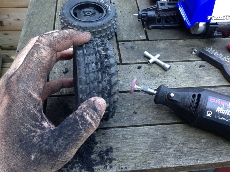

Although I did grind slits into the Blitzer ribs for better grip, without them they perform like drift tyres... which was fun 😜

Didn't have any overheating issues with either of those but they've mostly been driven in loose gravel on a sandy beach.
The Blitzer tyres didn't need foams as they're quite tough but give good grip off road. Super Grippers as you'd find in a TL01B also worked very well off road. I'm not much of an on road driver, I'd say the best I've used there are the carsons. Maybe you could fit foams into them?
