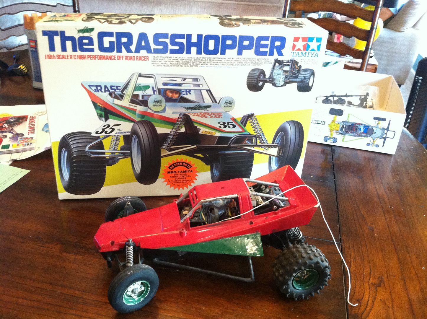

Well, here she is, in all her glory. The last time I checked (~15 years ago?), it was in running condition:
No bumper, bad paint job, wheels, etc.

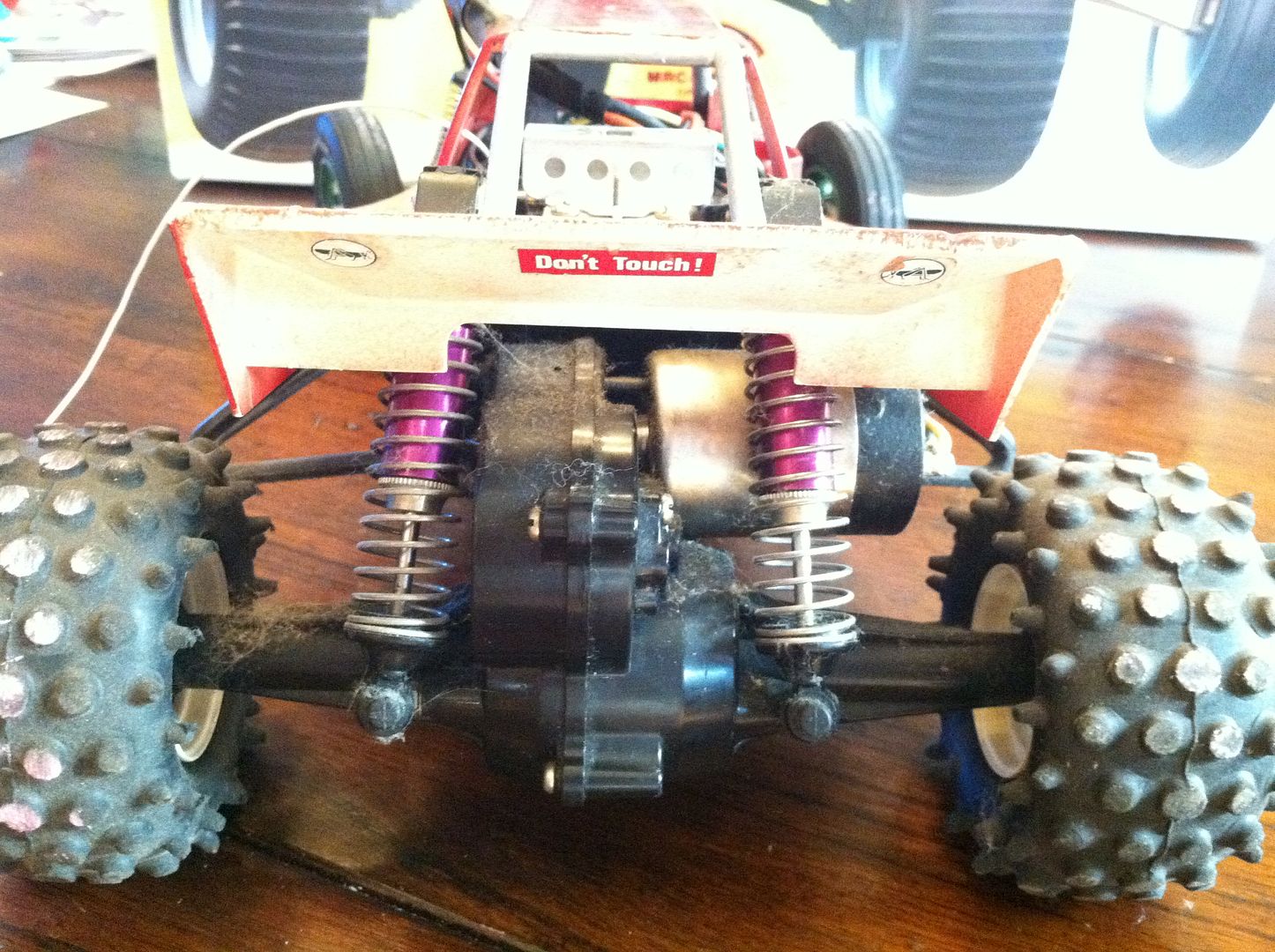

Rear end:
Some huge oil filled shocks that don't really fit and a large gap between the motor and gearbox!
Close up of the above atrocities:
The burn marks are from taping fireworks (Ground Bloom Flowers) to the body for a moving fireworks display.

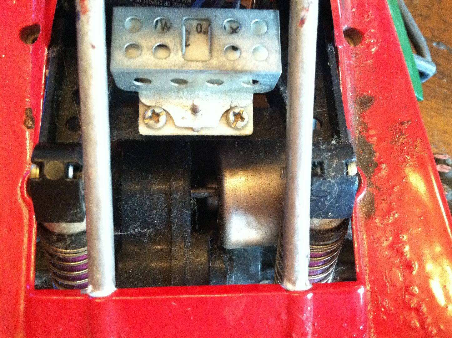

Inside:
Receiver/transmitter still works - as I gave it to my son for his Re-Release Grasshopper we built last week. :D

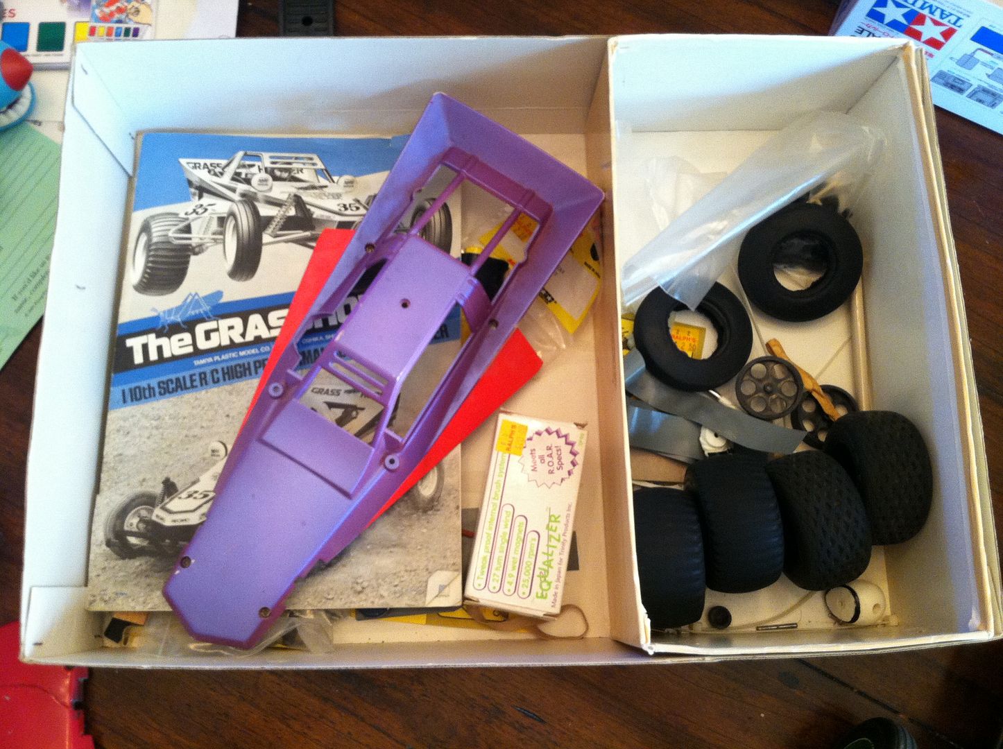

Box contents:
Extra body, manual, original tires, spares, tools, etc.

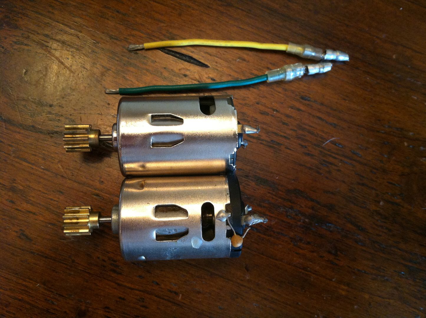

Motors:
For some reason I have 2 RS380 motors. One is a Mabuchi, the other is a Johnson.

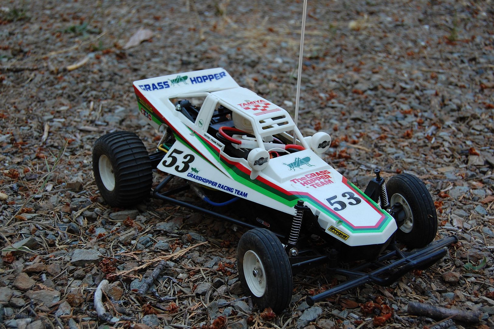

For comparison, my son's re-release:
We were on vacation when we finished it, so we didn't have a chance to paint the bars/driver/etc. My younger son (5) is not yet ready for a Grasshopper, but we've already planned to have 3 of them, all with different numbers. :)

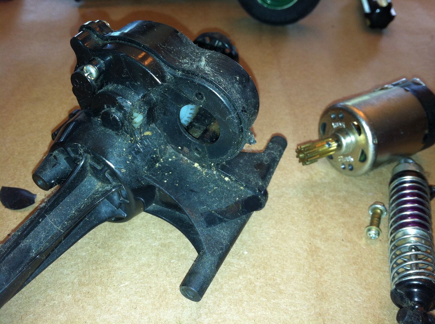

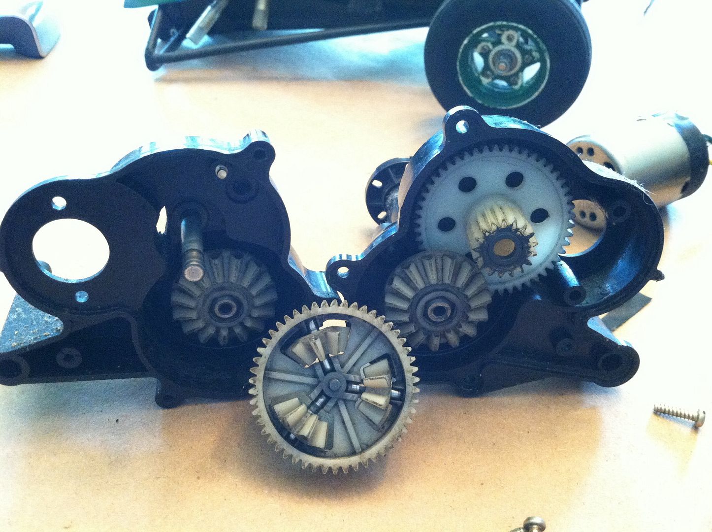

Tonight I went ahead and disassembled the gearbox. I figured, if that's the first step in building, then I should probably start there!
Gearbox:
You can see the section I cut out to the left of the mounting hole to make the 540 motor fit.
Opened up:
Bone dry as expected.
This thing. I remember buying it and explaining exactly what I had to the salesperson (Grasshopper, 380 motor, etc.)...when I got it home, it did not fit. So I made it per above pics.

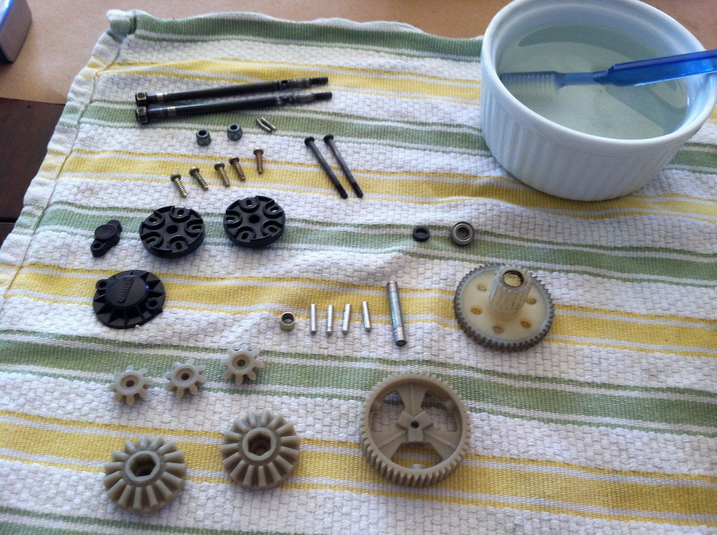

I cleaned everything up with a mix of Simple Green and water - let it soak for 15 minutes or so and went to town with my 30 year old toothbrush that was in the box!
I scrubbed them and put them in the clean water dish you see in the picture and scrubbed them once more in the clean water.
The "counter gear" on the right (with bushing and bearing above and pin to the left) is worn/chewed up pretty well so I think I will get a new one of those. Let's just say the pinion gear probably didn't line up too well. It's also a different color than the rest and the pin does not fit tightly in the bushing any longer, nor did it clean up well.
I don't have a good way of getting the bearings out of the gearbox axles other than using a flathead screwdriver and punching them out - but I think this damaged the one I did. Any suggestions?
I use a Phillips head screw driver that fits through the bearing snug, then I move the handle in a circle motion that wiggles the bearing out of its housing gently :)
That is an interesting approach you took to mounting the 540 motor back in the day. I don't think I have ever seen that done before!
Are you going to try to replicate it during the restoration, or go for a conventional mounting with a 18t 0.8 module pinion?

Agreed, definitely getting a new gearbox. When I ordered on ebay, the listing for the gearbox sold out a day before (it was only $4)! I installed bearings years ago. :) Just not the smaller one in the counter (spur?) gear. Though since I damaged one or two getting them out, I might just get a whole set; they are around $12 here in the states and I could have a few spares on hand for my son also.

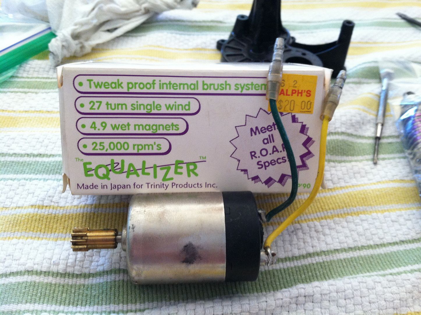

Now that makes sense about the 540 and pinion combo I had back in the day! Thank you for explaining that. I got a little confused and now understand the different combinations with the 540.
Safe to say, I will NOT be using that old 540 and pinion. :blink: I think I'd like to stay more "original" with the silver can and even go with the 540-J instead of the Sport Tuned when I upgrade.
I am glad that you have no plans to re-use that pinion, but might I put forward an argument for re-using the Equaliser motor? (Assuming it still runs?)
Points in favour of the Equaliser:
- It is a period-correct hop-up, and not exactly a common one either AFAIK, so it has a measure of historical value. Plus it is part of the car's history with you.
- It should be quick but not over-powered. (Being an early ROAR 27t motor, it ought to have performance in the same ballpark as other good 27t motors such as the Sport Tuned, Dirt Tuned, etc, which have been used successfully in Grasshoppers and Hornets by many of us here.)
- It might be nice to see how your car could have run back in the day had the hobby shop sold you the right gear.
Even if you choose not to use it, please don't discard it. You might change your mind at a later date, and if you don't, I am sure there are other Grasshopper fans on here who would love to add a period-correct hop-up to their models, and would happily buy it off you.
