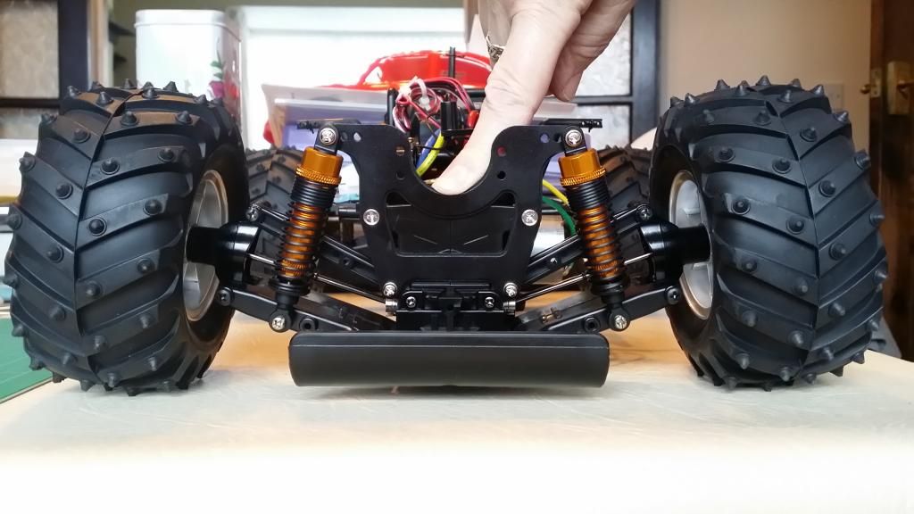

When you mentioned the shock lengths and difference it makes here's a picture of the standard suspension under full compression and after with larger shock towers and 100mm length shocks. The difference before and after is night and day, much better.
Before with standard shocks fully compressed...
After with 100mm shocks and larger shock towers fully compressed....

Hi, what brand are these dampers please?
Are them gold or orange?
Max
Hi max. They are either a very deep gold or orange. I can't remember now, the colour in the picture looks pretty accurate to how they really look. I think I bought them from a place in the uk called blacksmithproducts. They also sell on ebay too. After a quick look I found these which look very similar. Hope that helps.
http://www.ebay.co.uk/itm/orange-108004-HSP-RC-1-10-4WD-08041-Aluminum-Shock-Absorber-Upgrade-100mm-/151708626041?hash=item235289ec79:m:mGH01u3VmrbVeCxmapzVBmQ
