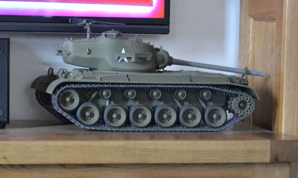

Here's how she looks as of Sunday afternoon, mint condition and built/painted very well.
Decided messing about with cheaper projects was daft as you spend as much money as a full option Tamiya in the end.

The finished article! Did a burnt ember wash tonight on raised lines etc and finished the figures face. Helmets added to stowage.
Don't think there's much more I can do...12ca87d30dd015f25cb75befcf633322.jpg
Very nice indeed, loving the grubby look - it's making mine look far too factory fresh, how did you get the bare metal effect? Did I need to do something before I painted it green or can this be achieved after?

The tank was in Tamiya Olive Drab, ts-62 I think and factory fresh, I decided to weather it by using the following:
Tamiya thinners
Tamiya buff acrylic
Mig pigments (sand I think)
Mix together, needs to be loose, not lumpy. Apply with a stiff brush into the wheels and suspension/lower hull. Wipe of the raised areas with a cloth and leave to dry.
Do the same with the upper hull but not as much, focusing on where the mud/dust would flick up.
Turret in similar places. Again, wipe off with cloth.
If you apply too much wait until it's dry then brush with neat thinners and then a cloth.
I highlighted areas with a small brush and burnt umber and then chips with humbrol silver.
Think that's it :)
The pigments won't wipe off when you touch it as the thinners/paint help it to stick.
