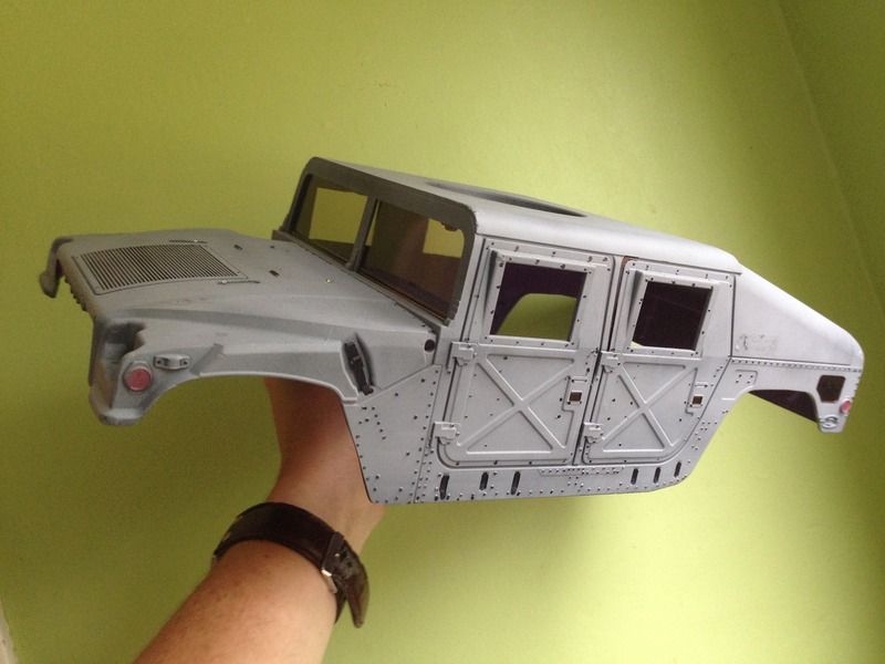

As luck would have it Adam was replacing his Hummers body and a quick deal later I had his old shell. It's a bit damaged but it'll do for me, we can rebuild it!
So as it arrived, fresh glass and all 😉

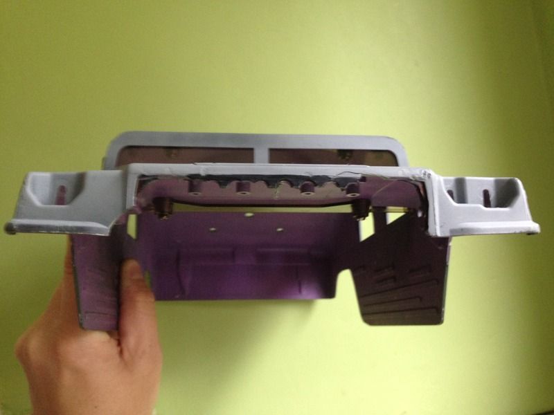

Bit of a dent in the grill... but it'll T-Cut out!
3ADCF8FC-53BD-4044-BC0C-2B87160B8E51_zps

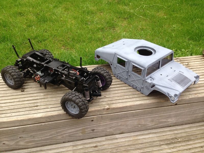

And yes it was painted purple in a past life! So first things first, how does it look on the WT01? Well TBH I was so eager I'd already set up the body mounts and drilled the bonnet holes before I could get a photo...
It fits great!
69506820-A100-4F18-8D58-153247BE911F_zps
FDBE454A-4EB7-4972-8AD1-A6E427EC0E5E_zps
It reveals a lot less of the chassis too thanks in part to how narrow the WT01 chassis is.
EE902FE5-CFC5-4233-854B-934299A2F3AA_zps
I'm very happy with that 😜

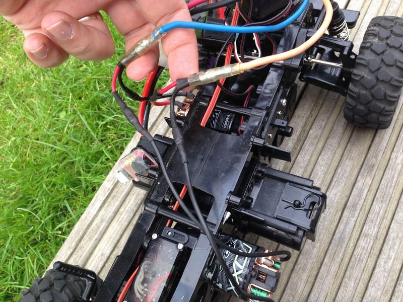

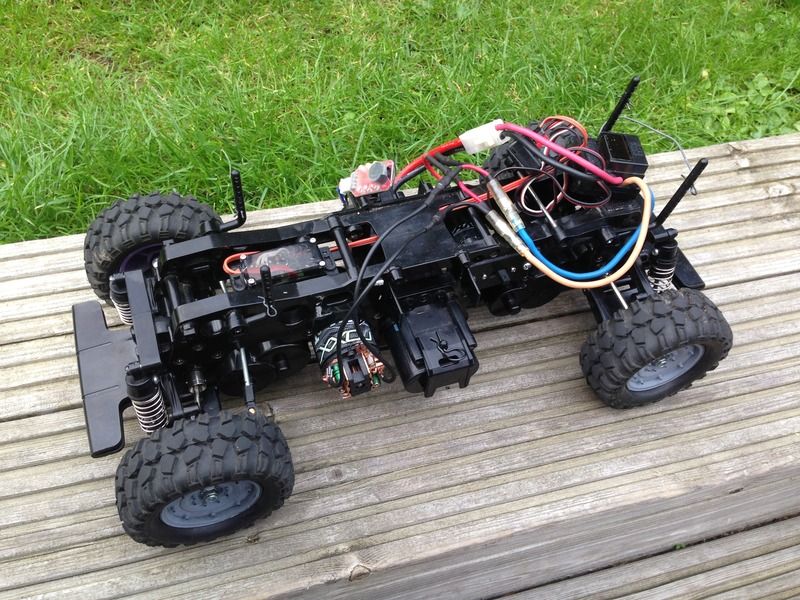

Well today I've stolen the gearbox from my WT01 Monster Beetle project (Lord please forgive me) fitted a matching 55T motor and made up a Y link for the ESC power cables.
73459A2E-FD65-4253-B7D6-991E81DF2054_zps
E87C4CCA-876D-405E-8DBB-2F4E558ED1B2_zps
So it's now a twin motored 4x4 beast and it's flipping heavy! I hadn't thought of that but the extra weight of the front gearbox and motor is in just the right place and makes it behave in a very scale looking way. I was going to lightly weight the wheels but I wonder if it's necessary now?
I adjusted the shock ends and was able to get a decent amount of ground and body clearance just from the friction shocks it had.

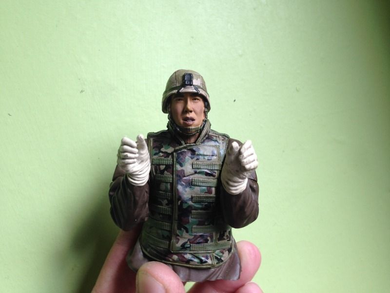

So like AdLav I have the McFarlane Coast Guard Gunner figure left over from my earlier Hummer rebuild (the 50cal is still with that truck!) and I found with a little trimming and repositioning of his arms he should work nicely as a driver in this build.
ACD92744-25C7-437E-BE56-5F630B416F79_zps

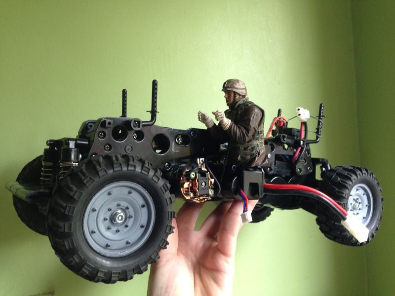

All I did was trim the folds in his jacket to allow his arms to move further part and rotated the wrists a little like he's holding a steering wheel. I'll make a bracket to mount him directly onto the chassis above the battery.
99FA56E1-720A-4847-B7C8-B49377D3F982_zps

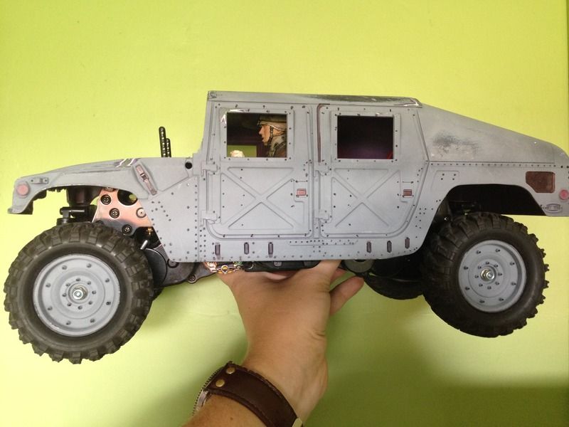

Mounting him on the chassis rather than the bodyshell helps keep the COG lower as the weight of this solid vinyl figure isn't going through the body mounts. It puts him in just the right spot too!

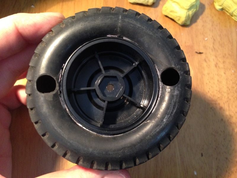

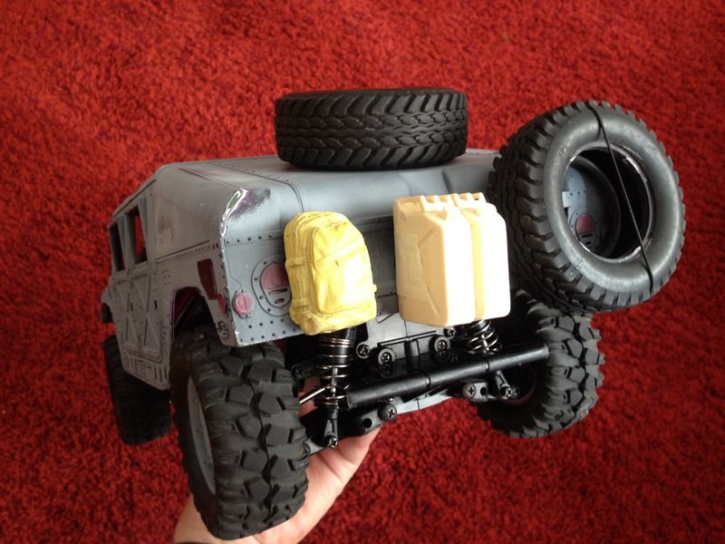

Ive also started working out how to arrange the stowage in the rear panel. The body came with some old Hummer tyres and an extra wheel. I'll mount one in the usual spot on the slanted rear hatch. To make it easy Ive drilled through the tyre walls so it will fit over the rear body mount R clips, holding itself in place and hiding the clips.
1B778F9C-9166-41E3-A0E5-A03C11F86D44_zps

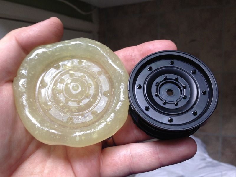

I'll mould the wheel face to add to the 2nd tyre and mount that on the rear right hand side. I've already got a couple of lovely resin fuel cans but I need another 2 to fit next to it, and I'll add a moulded back pack next to them to fill it out.
15E1B5CC-FE43-4741-ABD0-FE03E12CD10D_zps
Thanks Nitomor. I've moulded the wheel face, this is the 2nd attempt but this reusable compound isn't quite filling all the recesses. I'm gonna fill it with milliput tonight anyway and see how it turns out.
D03EDB53-DF27-4EC1-90FB-4550A33660F0_zps
If that fails I can always put a cover over the tyre as you often see them like that. Or find some more wheels I guess.

I gave up trying to fit the tyre to the boot lid as I couldn't work out how to fix it properly on the clips.
