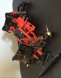

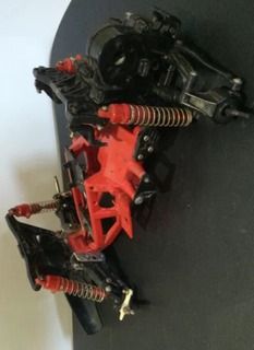

Anyhow. I got these stripped down the other day, they both look like they have been driven hard. One has had a few superglue repairs and the other has been burnt with a soldering iron. So I have one good chassis, one unmolested gearbox and one front suspension upright, and a box full of bits
I also printed out the manual
I will need to chase up a rear suspension mount, servo cover and a few other odds and ends.

This leaves me with 2 good frame pieces, frame joiners, suspension arms and uprights, and a few other pieces ready to go back on.
The chassis and suspension pieces have had their second run through the wash and started putting the chassis back together

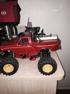

I had a bit of trouble getting super blackfoot hex drive wheels, but managed to get some earlier blackoot ones. I had to change the drive cups to re re frog ones, got a few more odds and ends tidied up, put the wheels and body on
At this point it's still waiting on dogbones, and for me to fit a Motor to run this thing, but I think it is cool as, with the original body (not a fan of the super blackfoot decals), so decided to post it up.

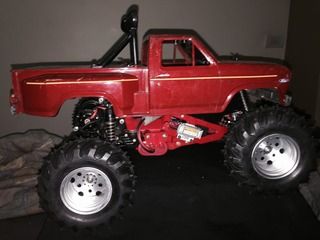

I managed to find a better body to go on this chassis, so I dug this thing back out to finish off a couple of things. I put the (new to me) Blackfoot body on, fitted the dogbones and finished the electronics, and a sport tuned motor.
There was still a couple of things to tidy up, namely the front bumper, and longer rear shocks, but I drove I around the house, so I guess it's a runner which was my original aim.
It sat a bit rear down, and was really dragging its bum under power so I fitted the longer rear shocks, lifted the back up some, looks heaps better now.
Makes a good remote control holder too :-)
I also changed out the steering servo and drove it some more, it's really toey with the sport tuned motor. Steering is pretty awful, but you get that I guess. All in all I'm really happy with how it turned out.

I have been eying off some alloy hex drive wheels, not really in keeping with the originality, but with limited options, non original paintwork and a few other items, I decided to get them.
So I converted it back to hex drive with super blackfoot bits and fitted the alloy wheels and new tyres
I also managed to get an original tree, with servo cover and a couple of other bits to finish it 100%
So that's pretty much it up till today, although it cost more than I thought, it turned out pretty good, and got me back into rc modelling.

Took it it for a bit of a spin today, gotta say I love the retro feel of this thing. Definitely needs some work on the shocks, really notice the weight of the body when cornering.
I have some new shock mounts coming to hopefully sort out most of the cornering problems
Pretty stoked with this build
