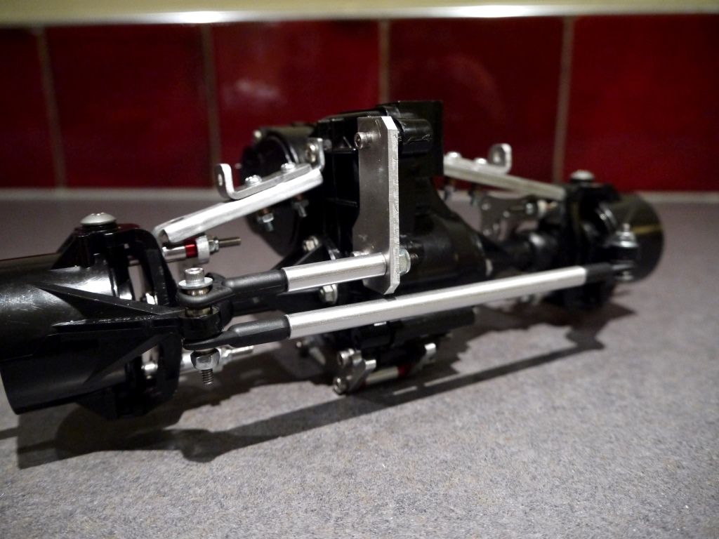

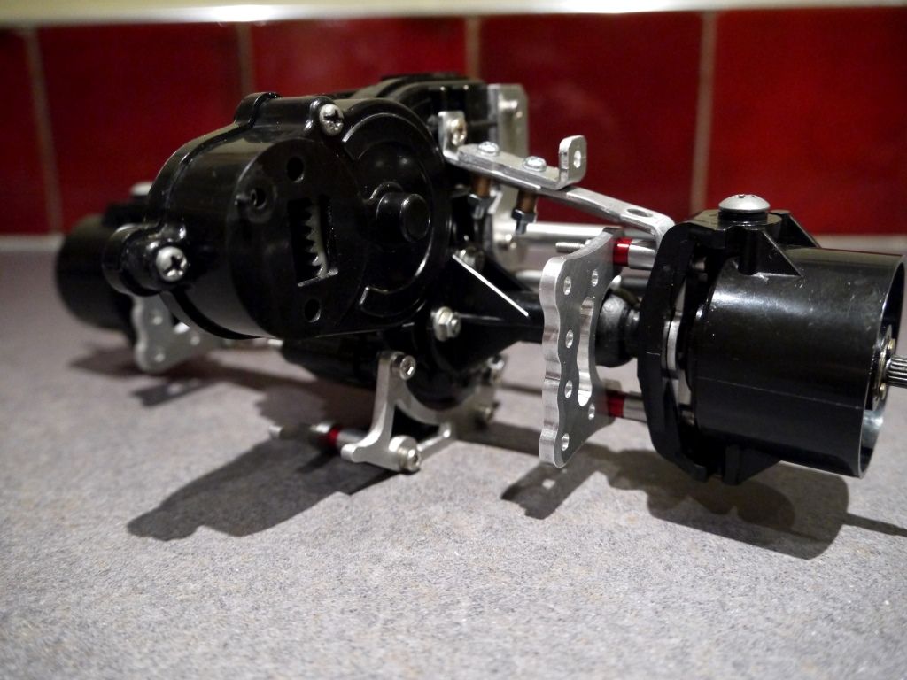

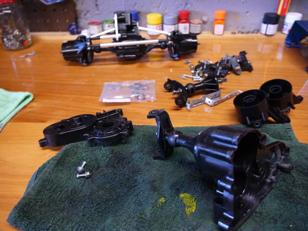

First job was to strip, clean and rebuild the axles, while they were i pieces I replaced a couple of worn gears and added some axle extensions and bash guards. Then the CPE rear steer lockout was fitted and also the axle mounted servo and steering system. Trimmed the wee plastic stops on the hubs and we now have full and controlled steering B)

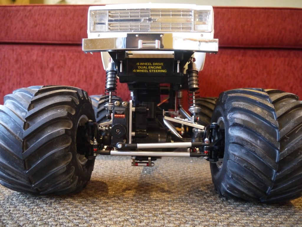

The chassis was in great shape so after a quick wash and clean a chassis brace was fitted along with a four link system for a longer wheelbase and better articulation. I didnt want to run eight shocks so fitted a single shock conversion and four Gmade 90mm zeros.

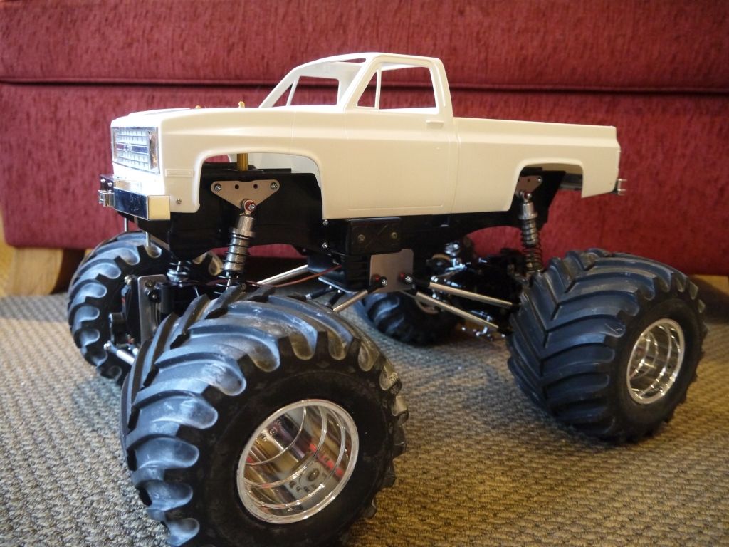

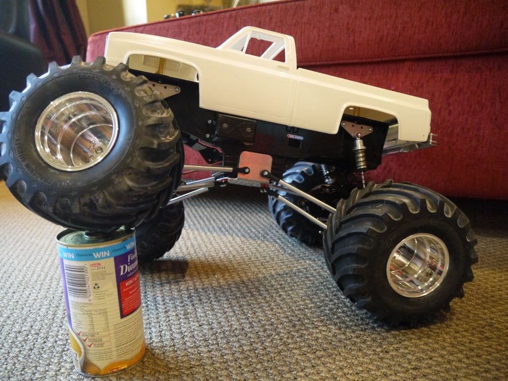

Next with the help of Chris (backtomyroots) I brought a body and tires along with some wheel wideners. As soon as they arrived I couldn't resist fitting it to see what it looked like :D
The extra width and length looks fantastic!

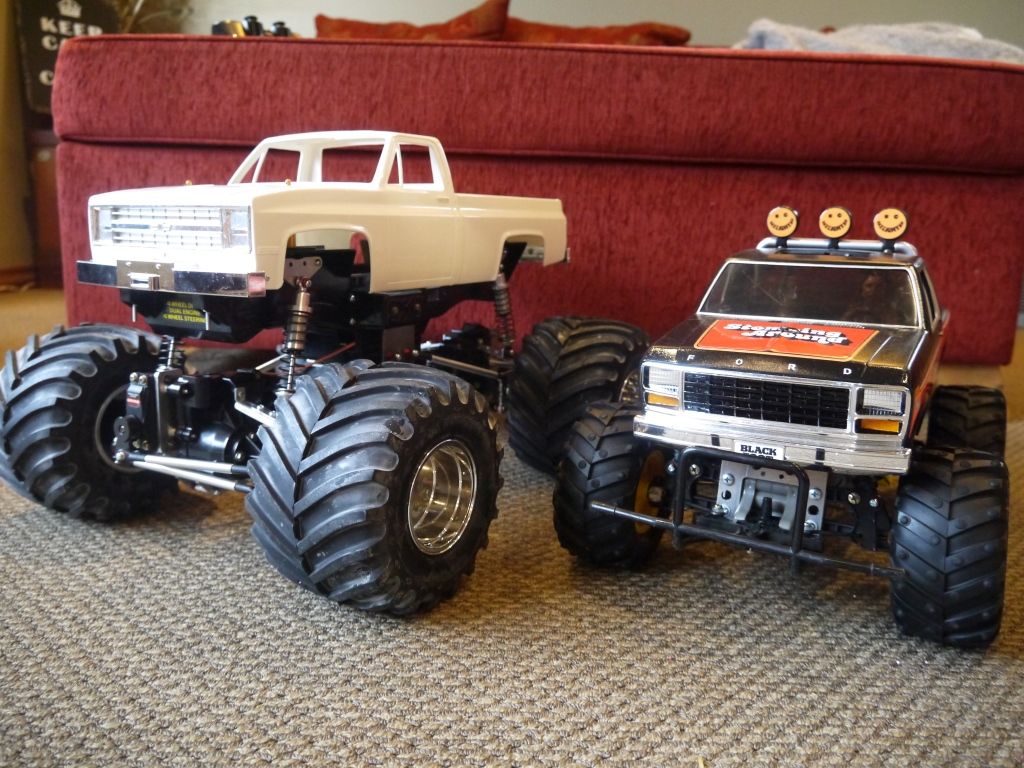

Having just finished my blackfoot build I couldn't resist seeing the size difference :P

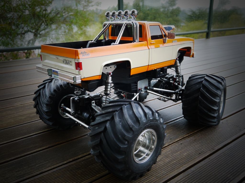

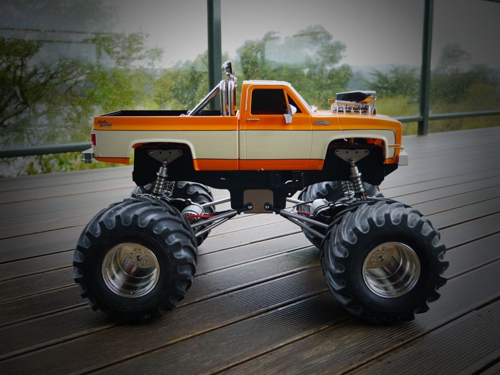

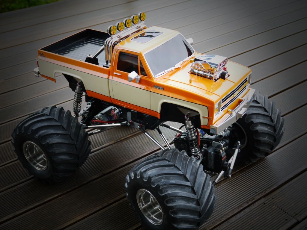

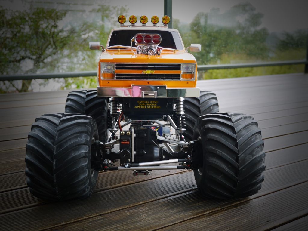

This clod will be run a lot so it will have a display body and also a lexan basher body. The next job was to start on the display body. I had a list of things I wanted to do to this shell and the first was to fit a 1/8 muscle machine motor. Ive seen a few of these on clods just screwed to the bonnet but that didn't spin my wheels so I ordered some plastic card and modded the body so the motor sits lower making it look better in my opinion. It was a little freaky taking a dremel to the body but it didn't turn out to bad
I wanted something a little than box art as this truck is far from standard so I went for a bright orange and creme. Added a few extras like wipers and mirrors and also painted the deck black to make it stand out a little more. Its far from a perfect paint job as painting isn't a strong point of mine but I'm pretty happy with how its looking at the moment :D

I really like the single shock per corner and the articulation is amazing. The proportions look great being slightly longer and wider. Mine looks a bit squashed now.
I've got a vintage blackfoot and when I put it next to my clod I'm always surpised how small it is in comparison.

Cheers Mark, when I was deciding on the paint scheme I simply googled 80's Chevy pickup and was bombarded with two tone trucks, all I had to do was pick a color

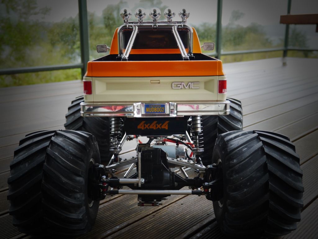

Why does it have a GMC tailgate though?
Thanks twinset, I was wondering when someone would mention that lol. I have a 4x4 x4 grill that I have modified to fit a custom billet grill that I'm waiting on for delivery which will have a GMC badge on it ;-)
