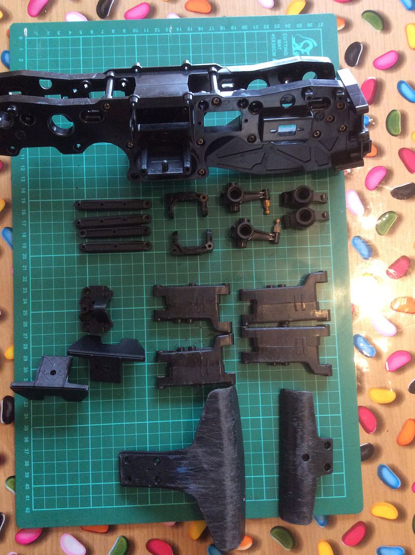

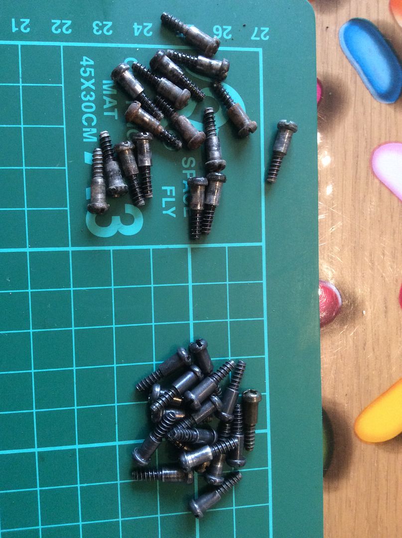

So as few screws removed as possible to free the arms and the gearbox. 384a4979e40344ee0c7182e91d487dab_zps7w35
The gearbox was not ballraced but the hubs were.

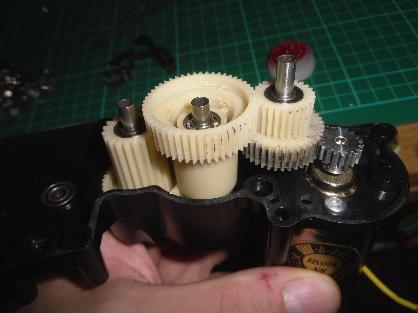

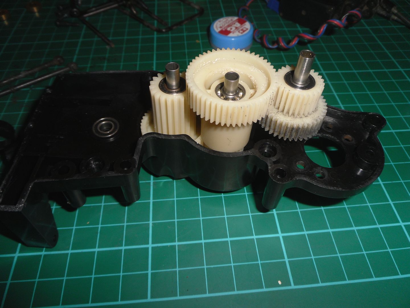

Everything was put in the dishwasher while we had a look in the gearbox
c83f3e615abf8e51a660bb5b21fa578e_zps4i2p
There is a little ware on the cog the pinion runs on but I can put the new pinion a little further on the shaft to get around that.
I do not know if I will add bearings, I have bushes coming out my ears and the rear of the shafts and cogs are serviceable but not great.
The drive shafts are OK but the cups at both ends are dead, will have to do some digging.
The shocks are also dead but I have two or three sets of the awful standard ones. I am thinking of M05ra hubs because I have them in stock and they will add a little ride height without longer shocks.

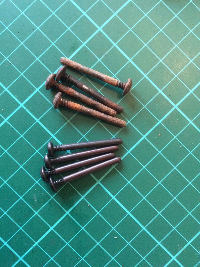

Lots of sand on top of the gearbox and the screws definitely point to it being run by the sea. The wheel bearings have help up well and might be reusable.

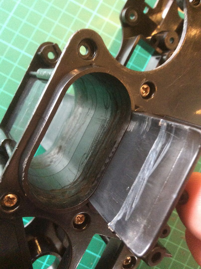

After my stuck LiPo in the same chassis I thought about opening up the battery area. Looks like someone had the idea before me. I need mor thought on the before I do to much grinding

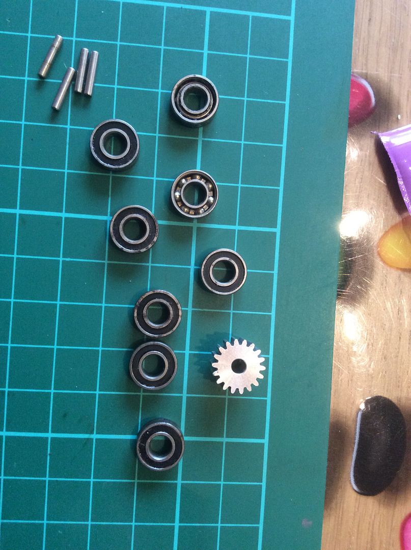

I found a new pinion, alloy but it will do for this build. The bearings are smooth but the seals are failing or failed so I will run them in the box.

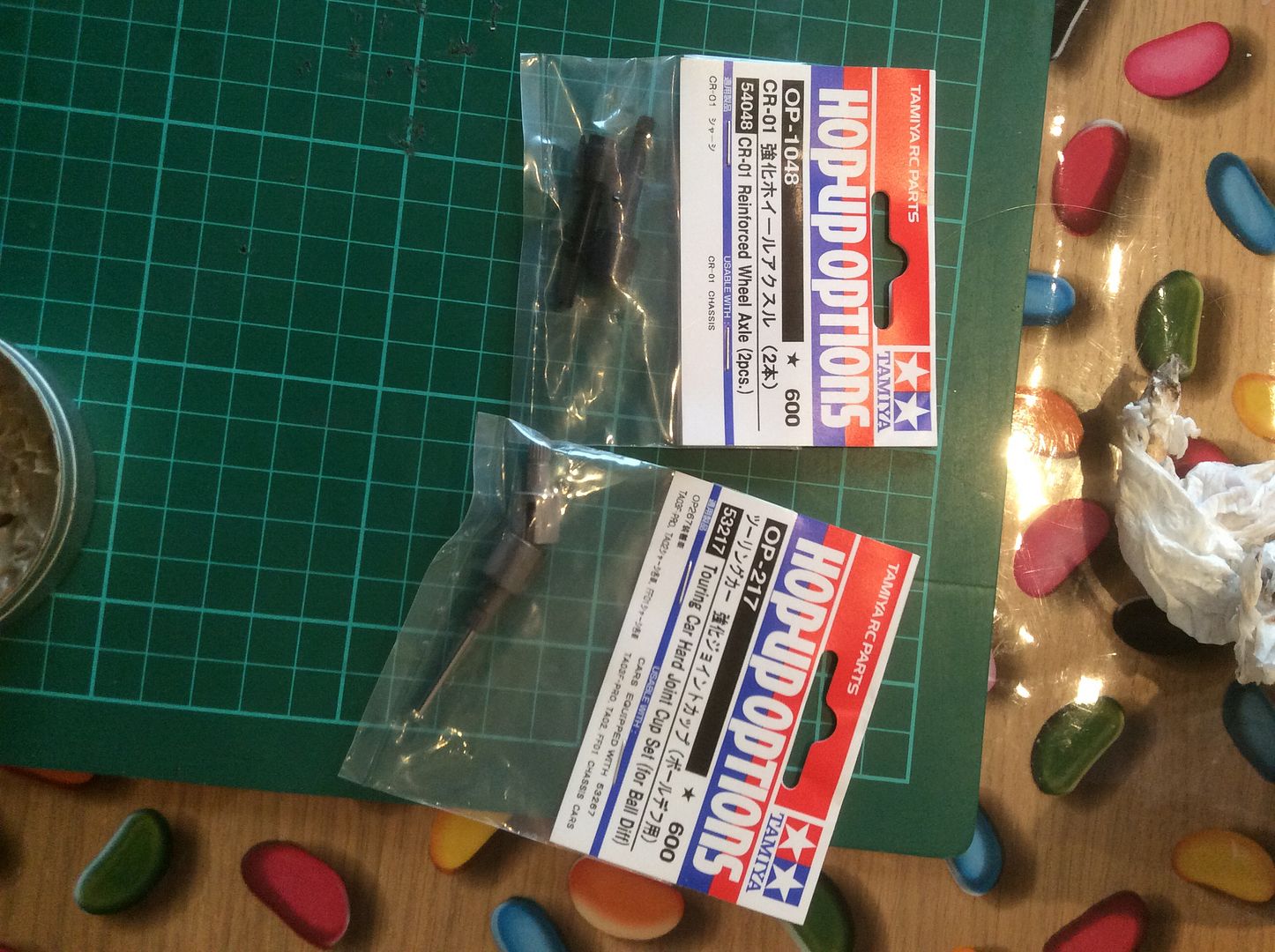

These will get replaced with
ceb6c3bb2458845cbcf3fd6ecc77d6aa_zpswvht
These
a9f9dad7b59ecb82ef82f47584cebaff_zps4ser

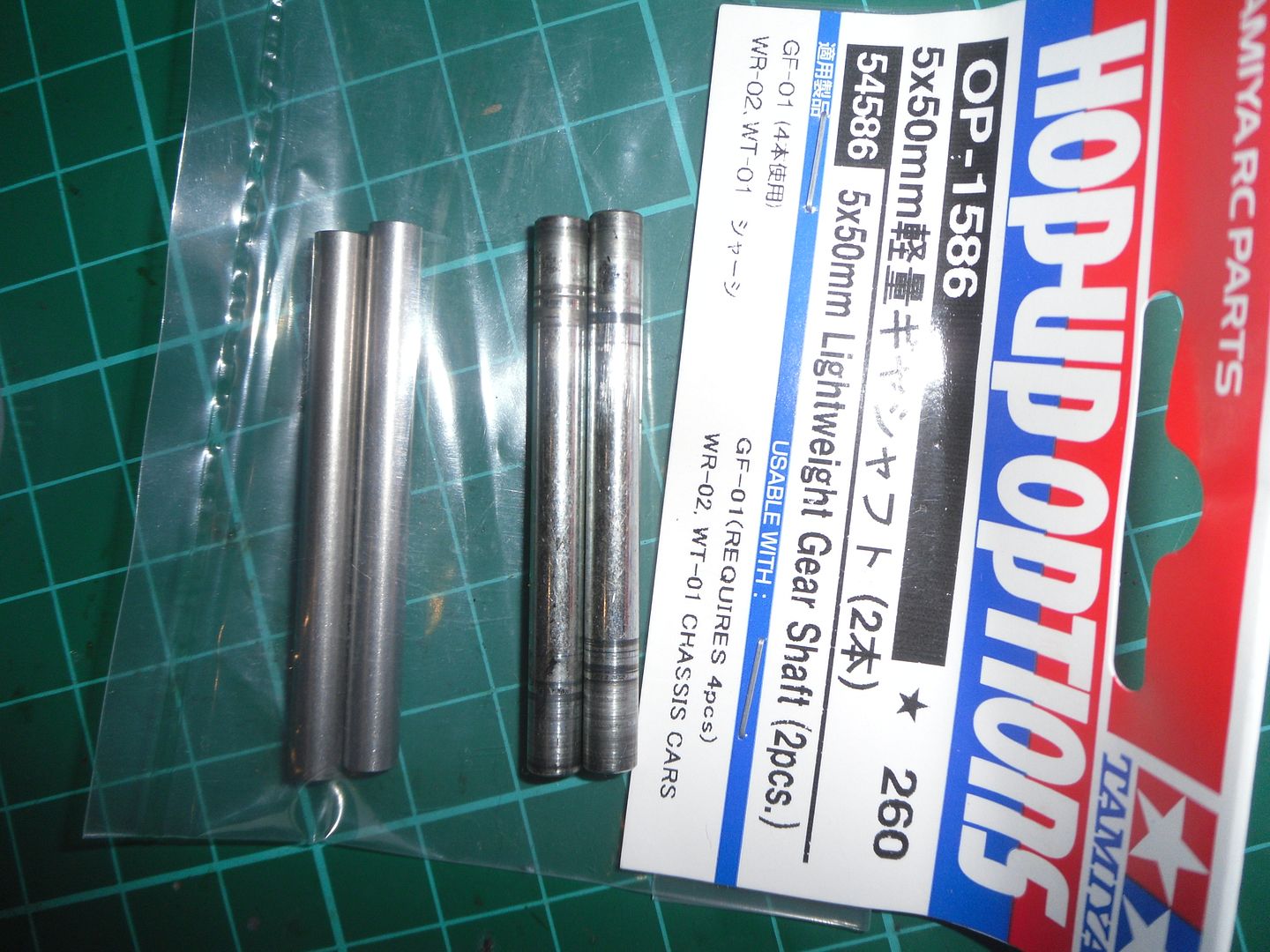

I cannot find any spare shafts in my box. I am sure I ran hollow shafts in my others so I should have three. I know the drive cups are for a ball diff but I am sure they have enough splines to hold up.

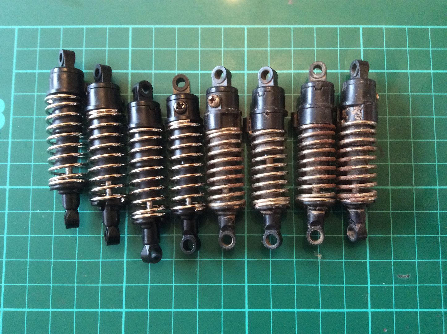

Set of spare shocks found, hope not to run these for long but free is free :-)

53217 will work, but it could be a weak point. 53218 would be the correct diff outdrives, as these extend into the splined diff bevel gears much further, so can take much more torque.
I would offer a straight swap because I made the opposite mistake as you but can only find one half of the outdrives I bought.
Coming along nicely though.
I got two of each because they were pennies from Banzai. I am not sure the spur gear is going to take much use so there are lots or weak points. I will forget this a budget project by he time they fail and then do it correctly.

I could not run the damaged shafts, my brain would not let it pass
Assembled
I bolted in a motor and set the pinion to the best part of the gear
I then took it off and fitted a hardened one from my stock, again I just could not let it lie.

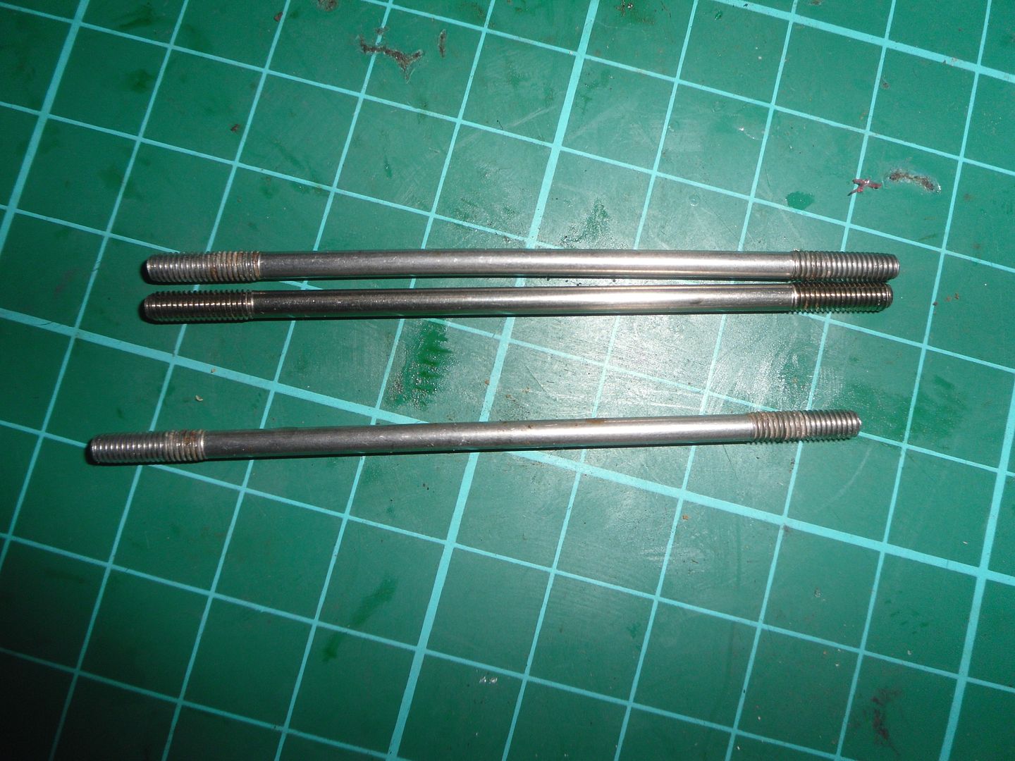

Damaged ends and a bent bar but again I had a bar and loads of ends in stock

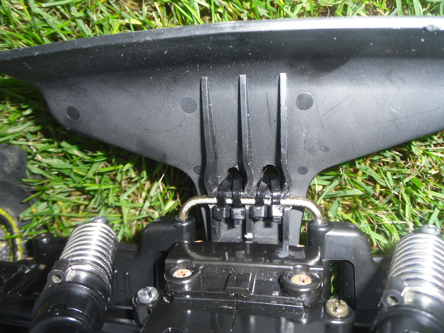

Bumper repair, it was bent and not holding the U in place.

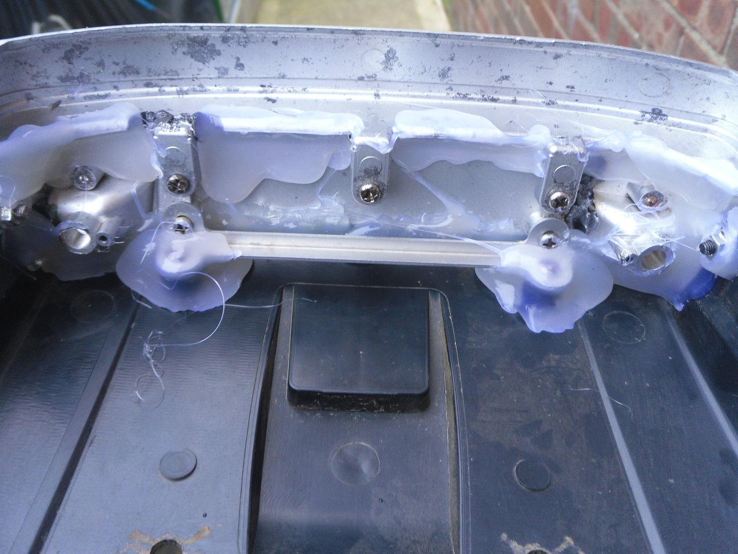

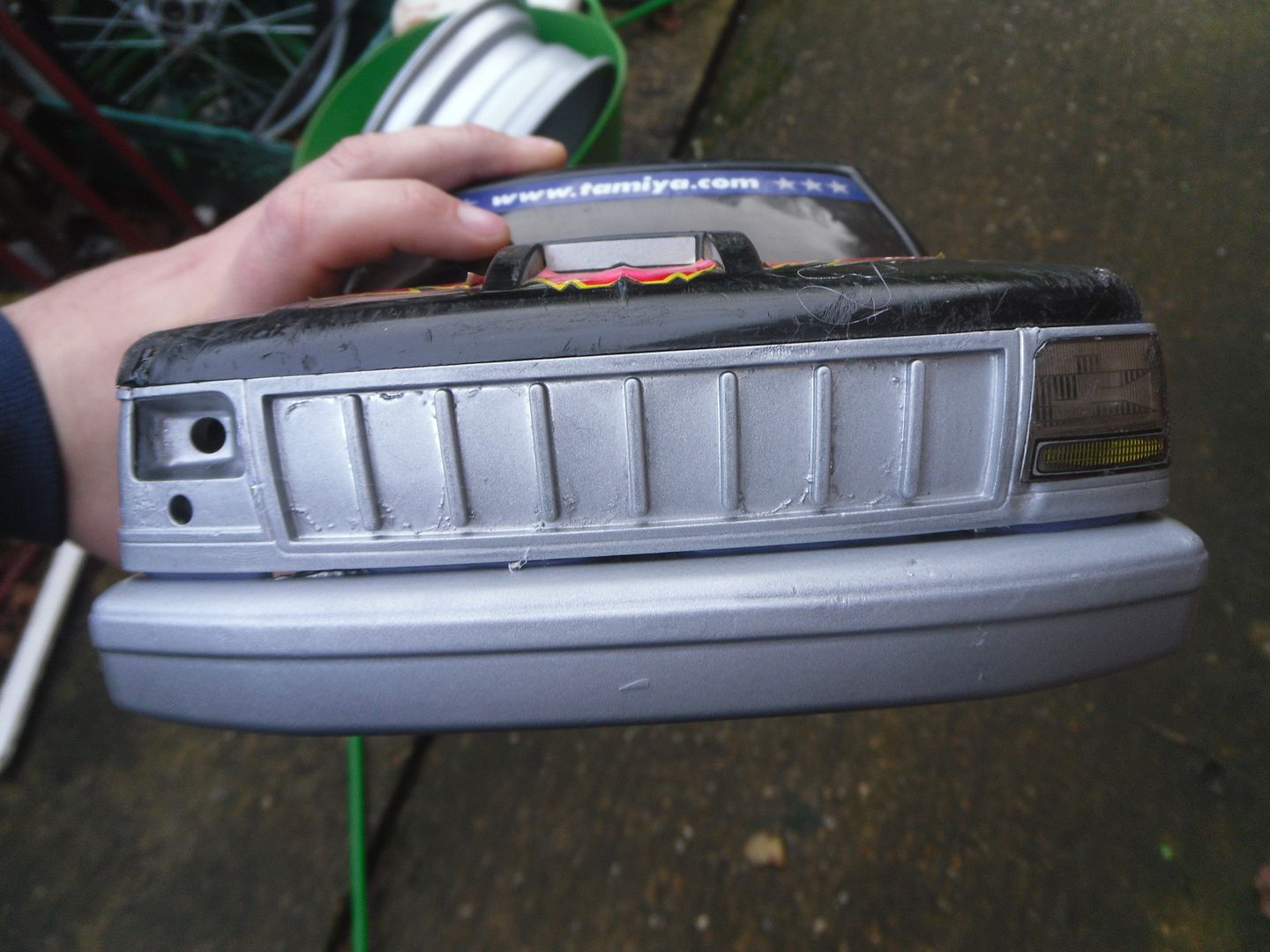

I did a load to the body. Attacked all the cracks and broken bit with a soldering iron and then hot glued up all the gaps to try and give a bit of shock protection.
Forgot to take pictures so will get some of the finished article when the weather is clear again.
few more images I found on camera

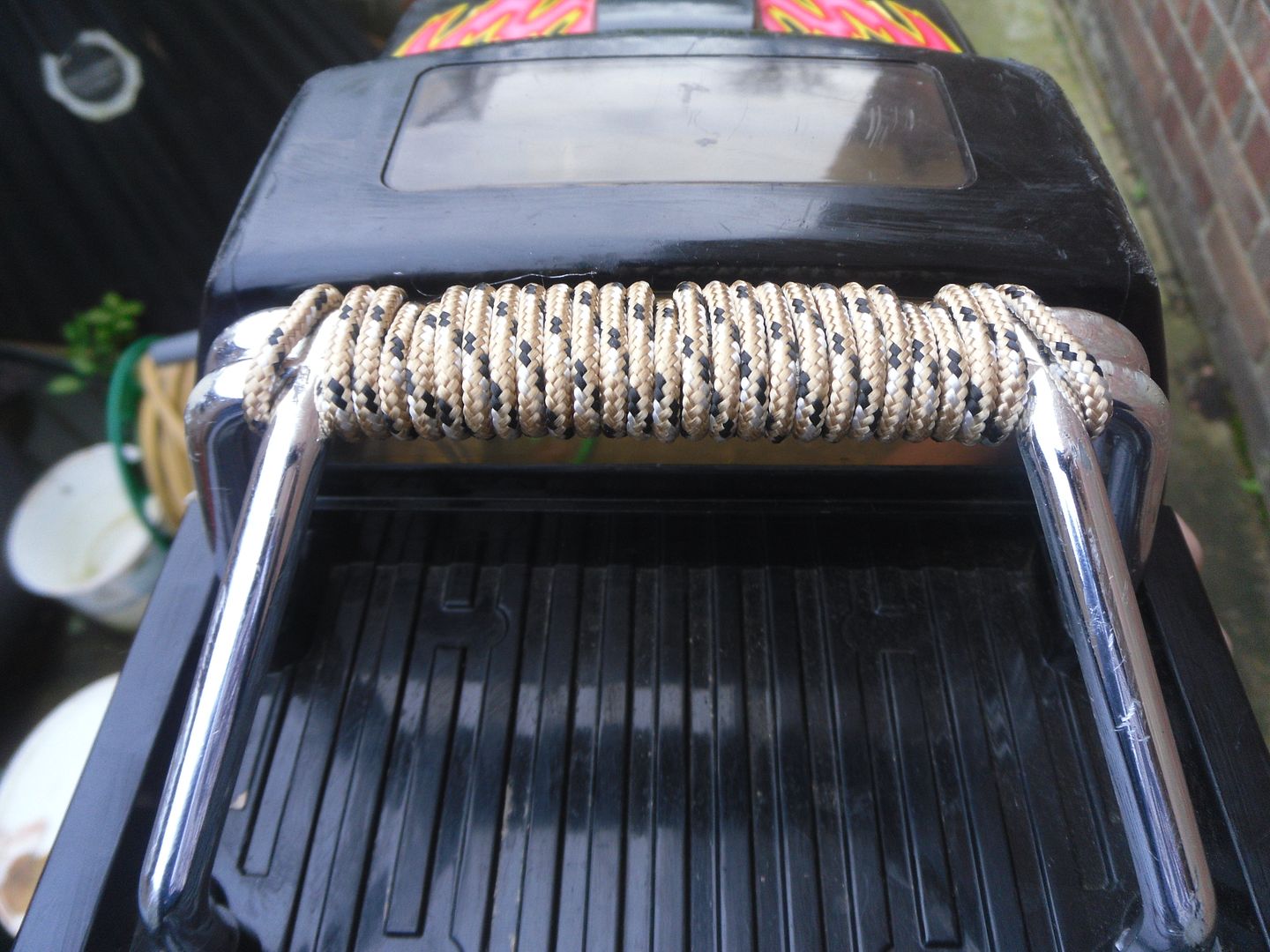

Roll bar was snapped so in put in a couple of flat nails in the grooves underneath and then hit it with a hot iron and cable ties. para cord to look like rope and cover the repair
Front end held on
Chrome flatted back and given a coat of silver
