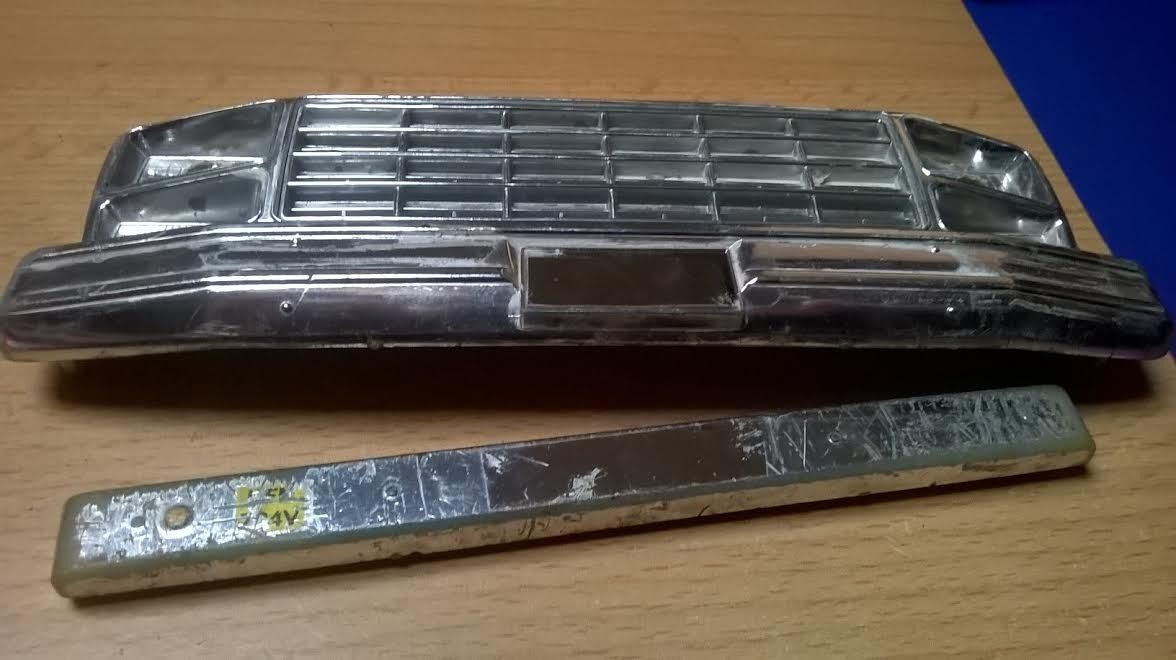

Chrome looking tired
Primed
A quick blast of chrome paint
